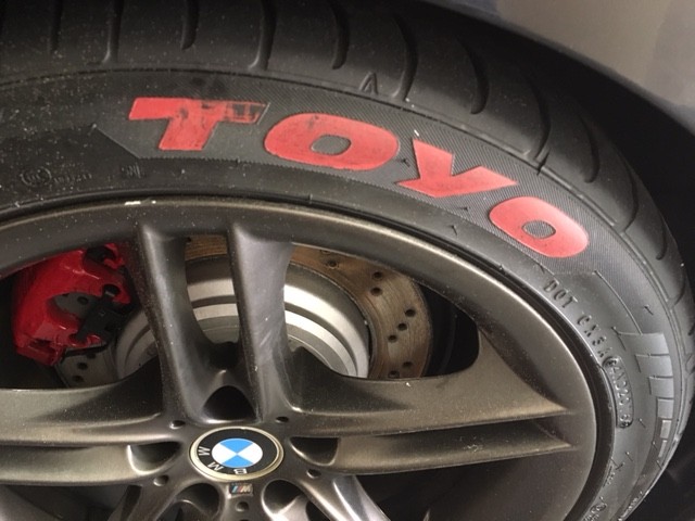

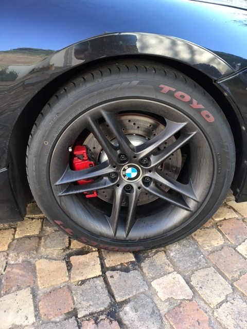

I remember doing the white lettering on my Yamaha R6 with those white paint pens, the outcome looked amazing but it was hours of work. I bought those pens again and started doing the same to my tires last night, its a big job if the tires are on the car, I think I might just take the wheels off one at a time and paint them off the car instead as its proving to be a mammoth task.
Did you use paint pens or did you use an actual brush? I tried using a fine brush and it seems a bit better/easier.

What paint are you using?
Wonder what will stick the best to rubber because it's a job you really only want to do once for the life of the tyre, apart from little touch ups.

Thanks bud, I used the Pen marker and not a brush... Did them while the wheels where on the car, just left the handbrake down so i can roll it forward or back.
Thanks Bud, it was a Normal Tyre Marker... They sell them at Auto Accessory shops..

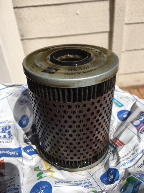

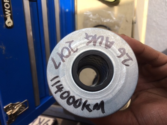

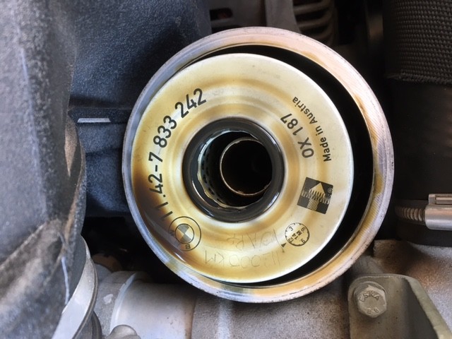

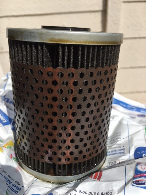

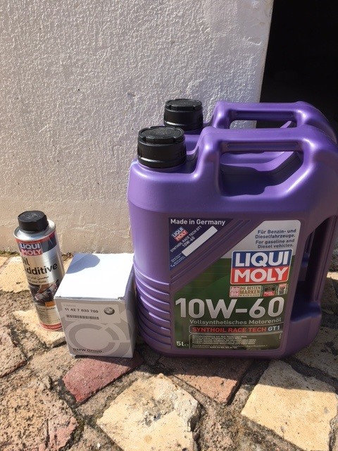

I had done an Oil change in April this year but since I had 10L of Liqui Moly racetech Oil and Antifriction Additive in the storeroom, i decided it would be good to do a quick oil change just incase any Throttlebody Cleaner/Carb Cleaner or injector Cleaner got in the oil and contaminated it in any way. I went to BMW and got a new Oil Filter which was fairly cheap (R275).
And so the oil change began:

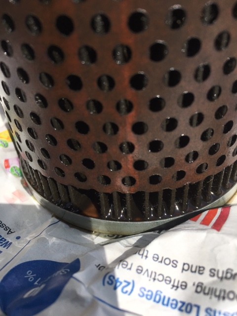

Old filter (Put in on 10 April 17 @ 112000km's)
Looking very Dirty for 2000km's

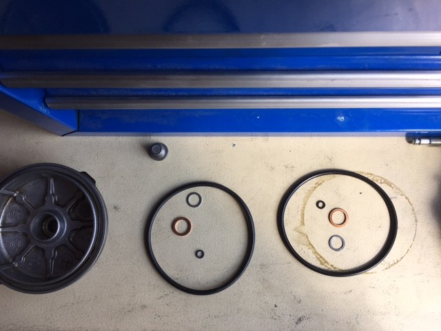

Swapping out the old Seals for new ones

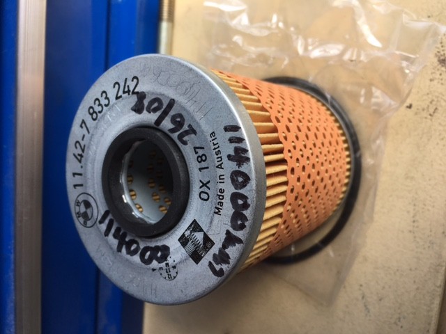

New Filter marked and ready to go in
Oil Filter and Oil added, everything cleaned and closed up… Checked oil level and all was good… Started it up and it idle'd smooth...

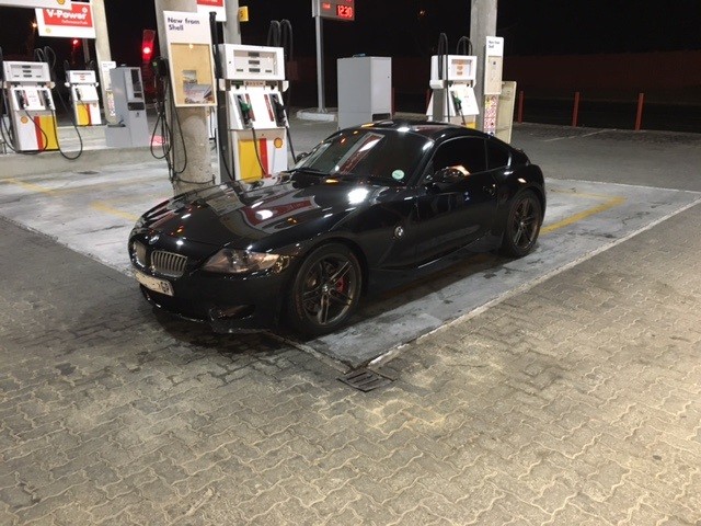

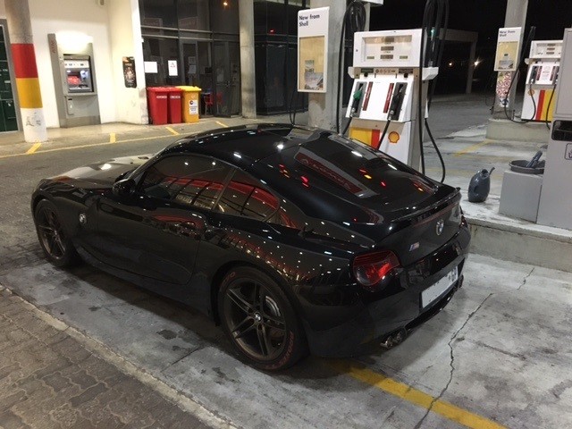

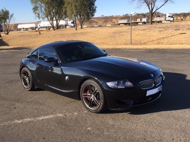

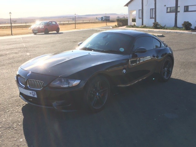

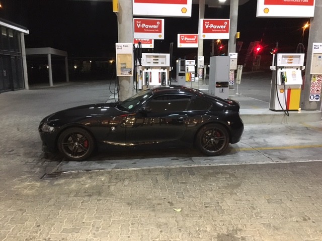

We then decided to use the Z to KZN, on the open road its a pleasure to drive... Power available on a Tap of the accelerator, Handled really well on the Twisties... at that point of travelling to KZN, the diff had done about 1000km's and settled in nicely, no funny sounds/vibrations.... the drvietrain was smooth as butter... at the coast this car was an absolute nut job, Traction off and sport on meant you end up drifting everywhere lol... even with some sideways action, the diff really performed well.. I really enjoyed the power it had down there...
Some pics on the way:

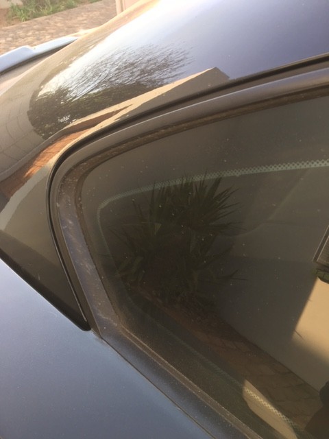

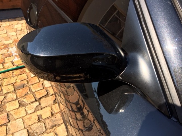

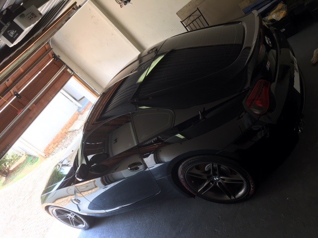

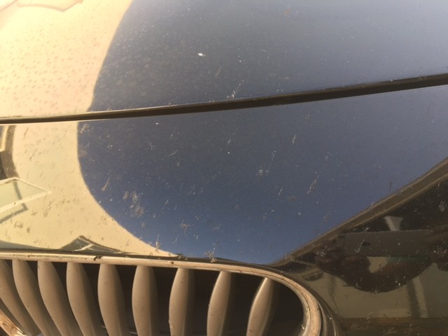

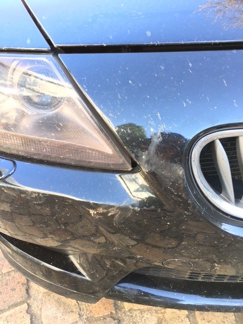

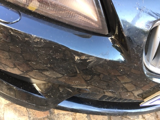

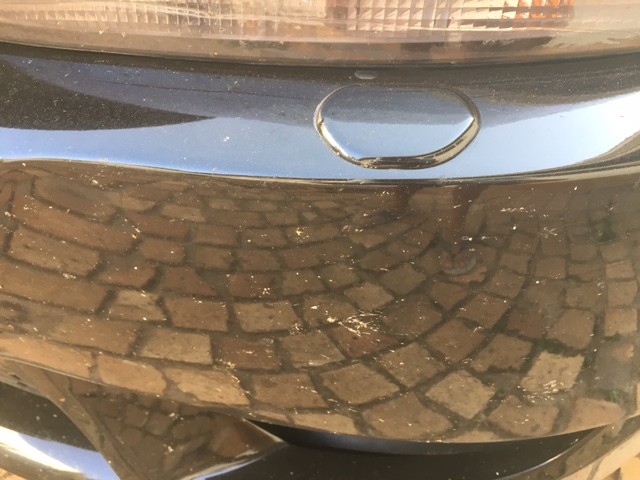

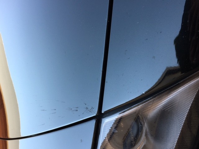

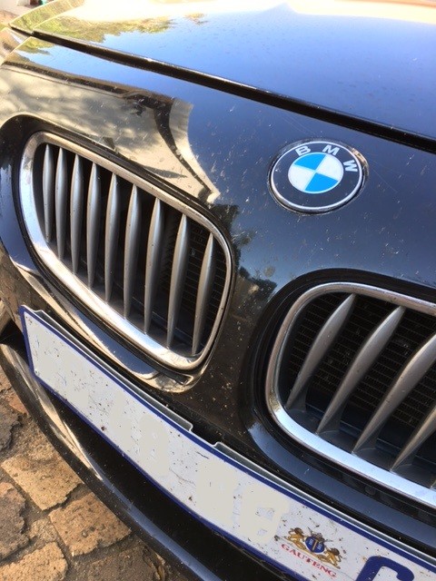

While I was down in Durbs, I didn't wash the car for the week and since I don't use car wash's as they scratch the paint, I decided to leave it dirty and then clean it properly when I got back...
But Damn it was filthy when I got back home

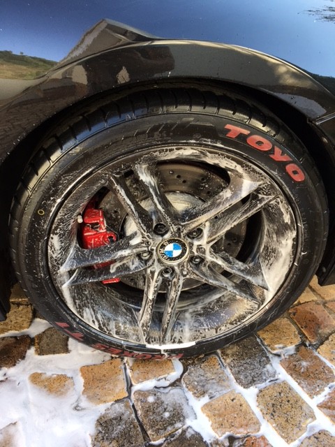

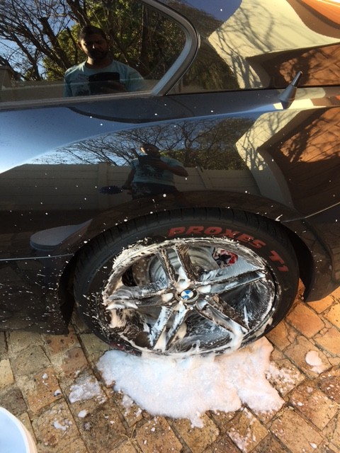

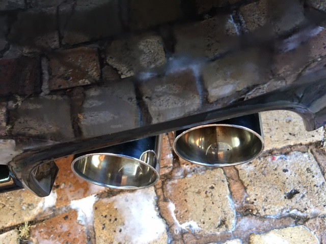

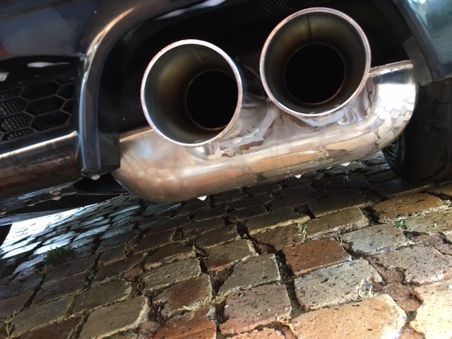

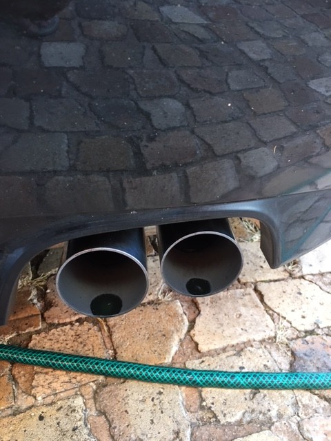

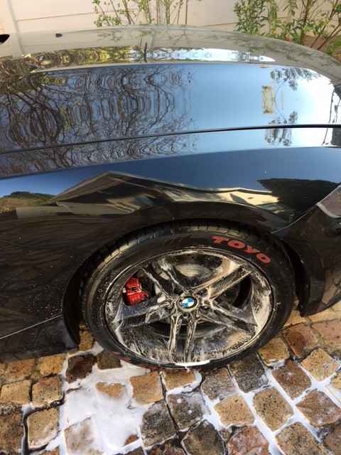

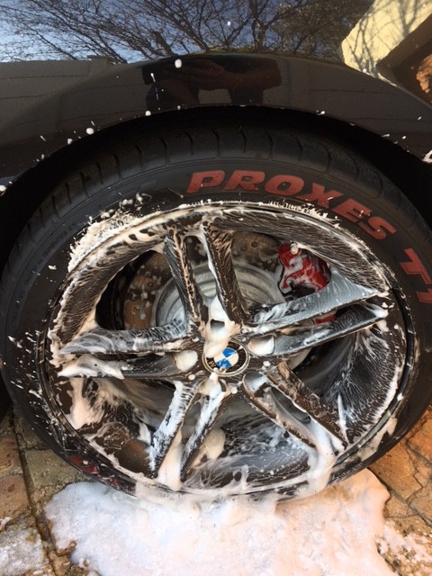

Started with the wheels and exhaust...
Wheels sprayed with APC to break down the dust and dirt then gave it a nice good scrubbing..

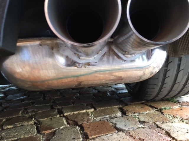

Exhaust back boxes and tail pipes was also filthy
Had to be Sprayed with APC and then scrubbed... Now looking clean again...
I then washed the car and Damn, it was still dirty :rage:

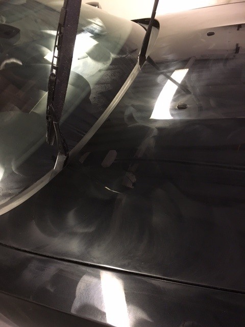

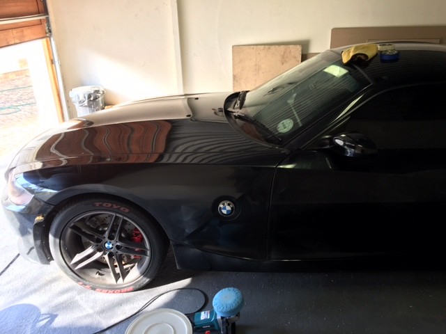

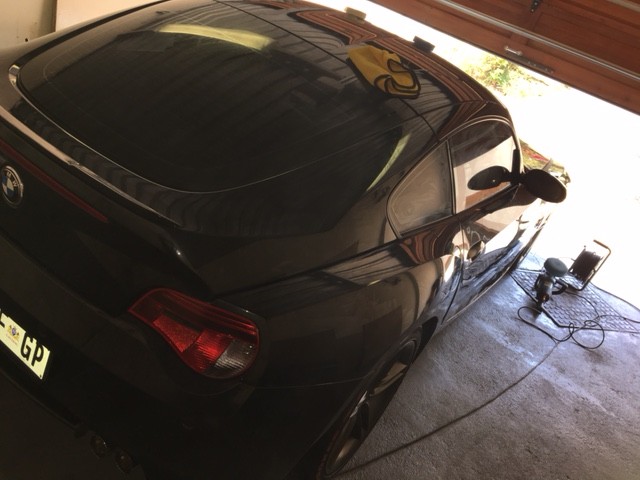

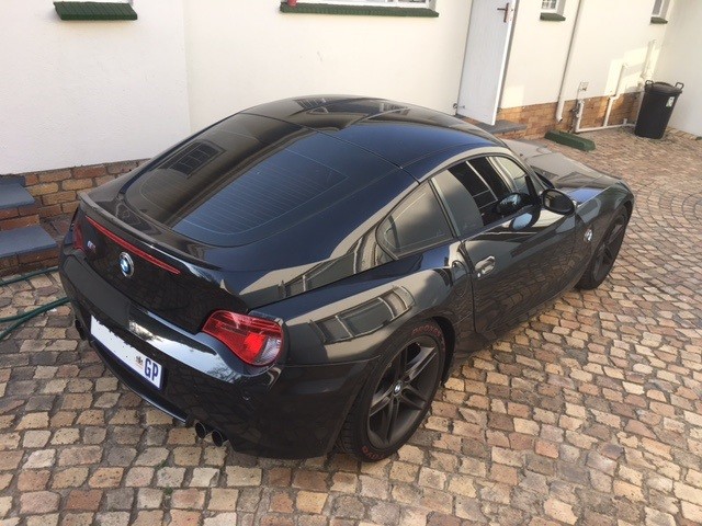

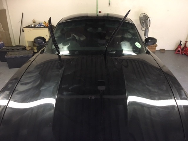

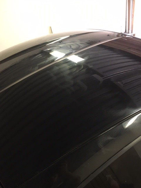

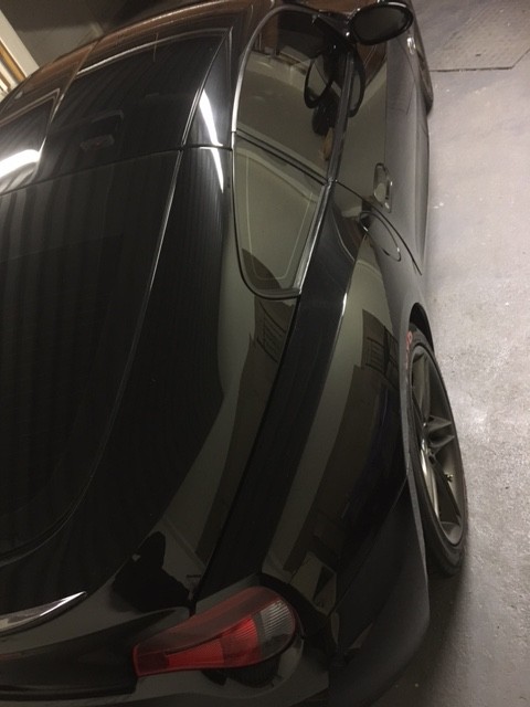

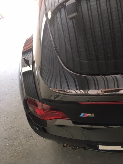

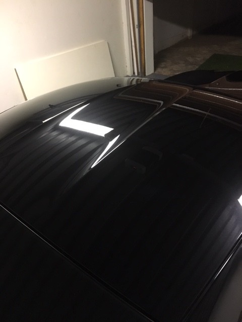

I ended up washing it again and at that point decided with the rainy season coming soon it would be a good idea to detail the paint again so it will be nice and protected when the rains come...

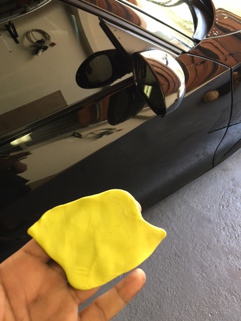

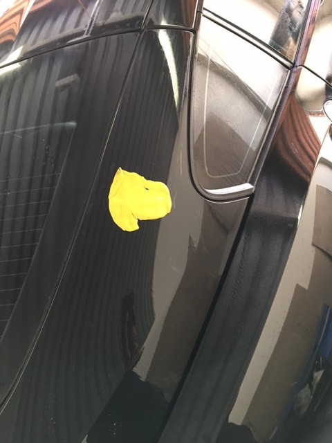

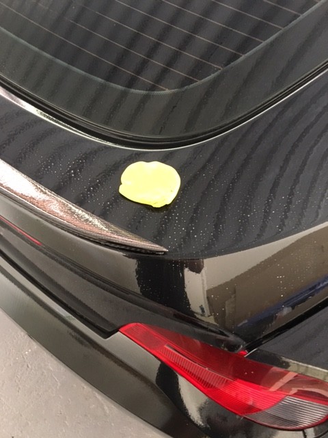

Entire car was Clayed to remove all dirt and contaminants in the clear coat..

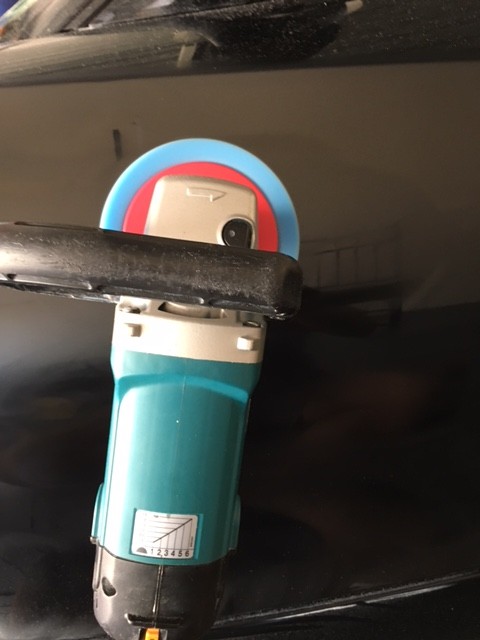

Once the paint was smooth and clean, I brought out the Rotary Polisher with Medium Cut pad and Menzerna Medium cut polish to cut the top layer and remove swirls/scratches/marks.
It took me Between 15-20 Hrs just to machine Polish for paint correction..
Once the Paint correction was completed, it was then machine polished again with Super Resin Polish on a softer white polishing pad... this took another 4-6 hrs

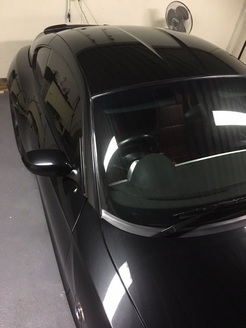

After the super resin Polish, the entire car was Glazed with Poor Boys Dark show car Glaze, also applied by machine with a soft finishing pad... Took another 4-6 hrs...
Extreme top coat Sealant was applied by hand and left to cure for a few hours.... another 2 hrs
Lastly the entire car was waxed by hand using Dodo Juice wax which i imported back in 2009 and still going strong. another 2 hrs.
Wax on
Wax Off
The Paint work is now deep black and full of gloss... I am happy with the outcome…

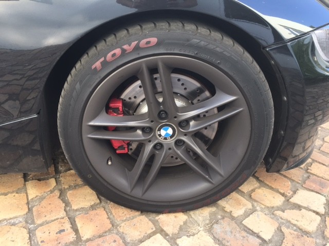

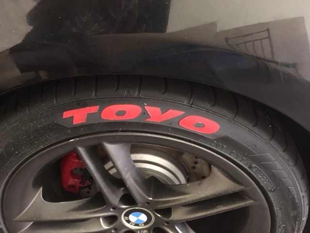

Tire Paint touch ups where needed as well.

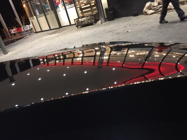

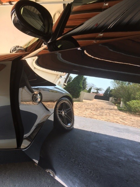

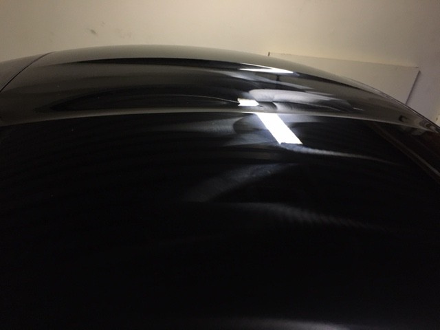

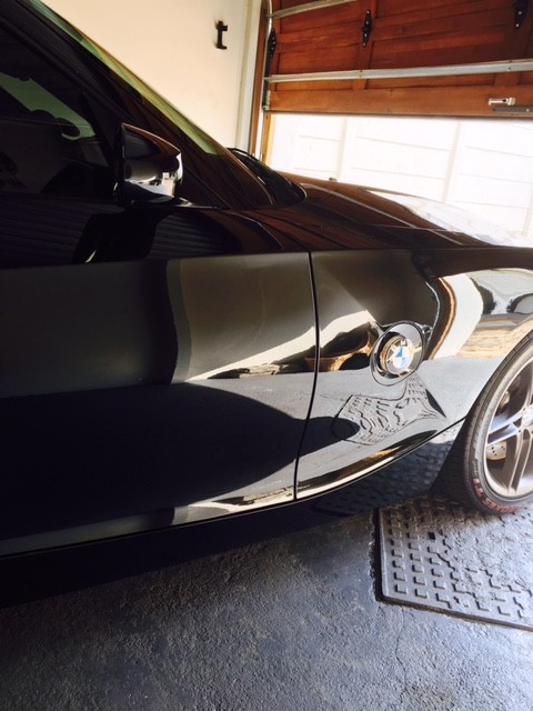

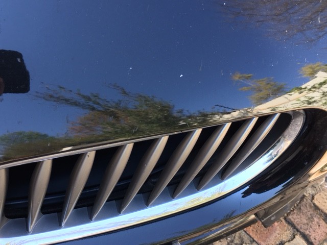

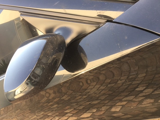

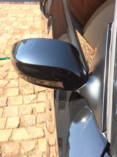

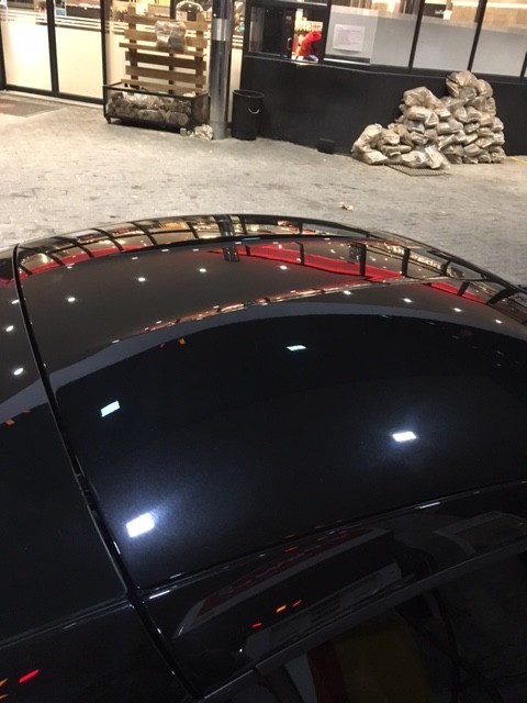

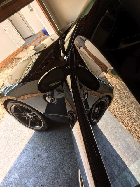

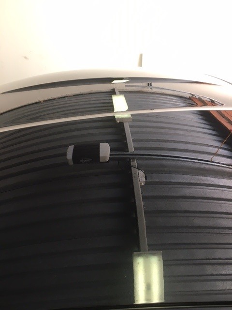

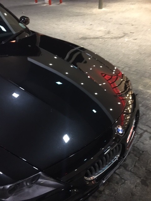

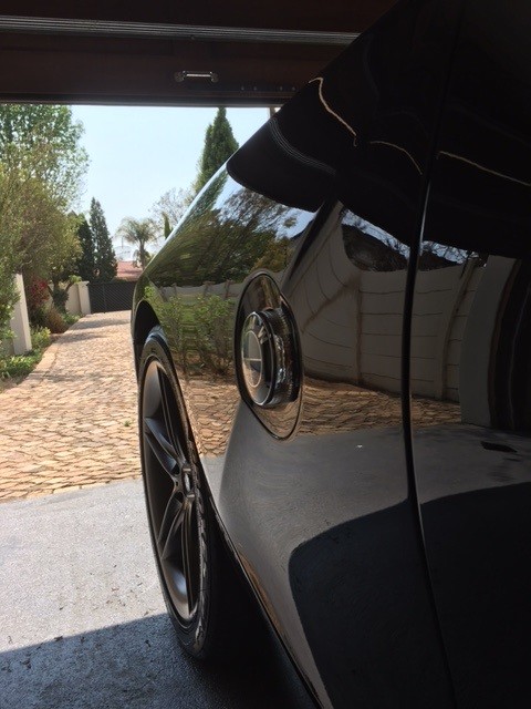

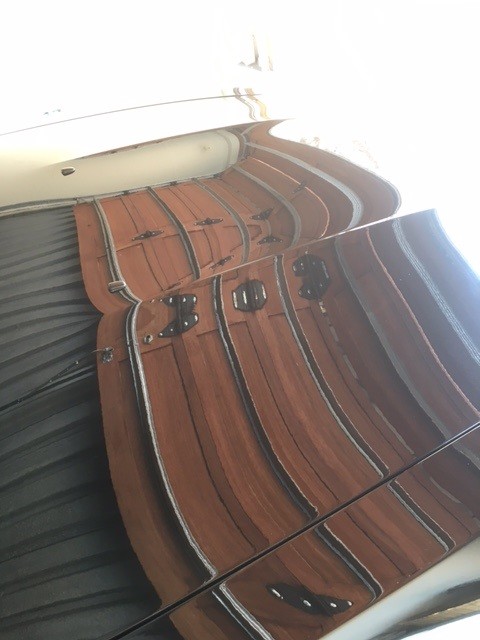

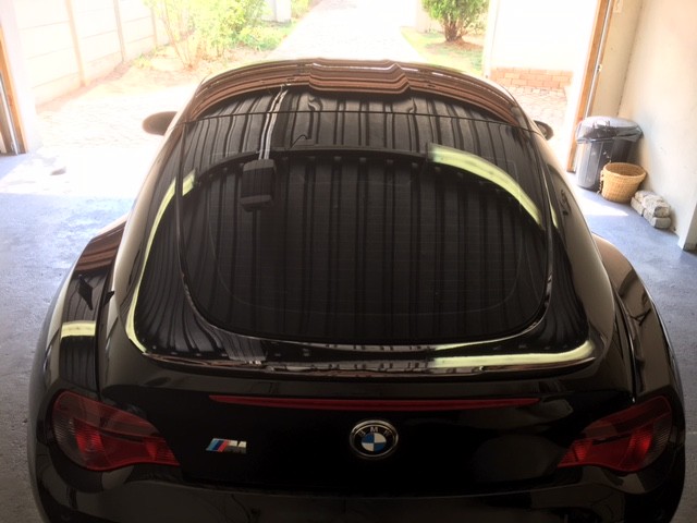

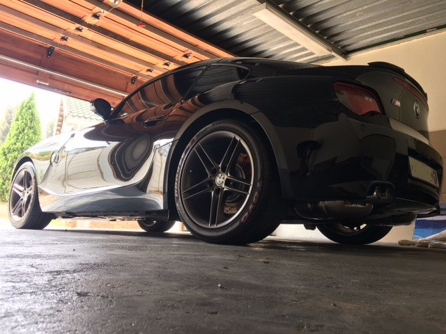

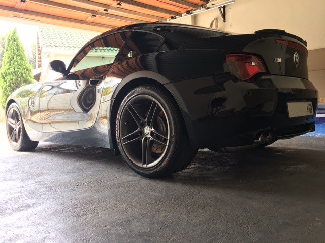

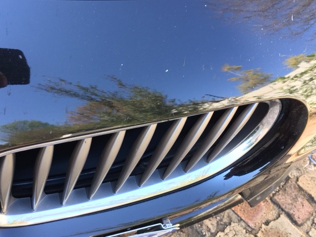

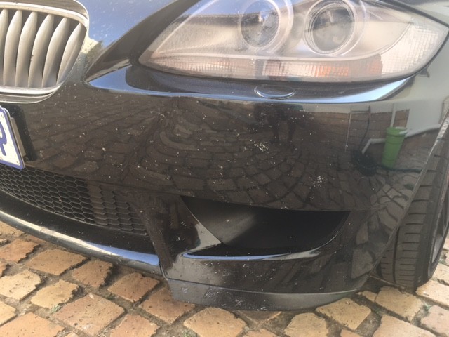

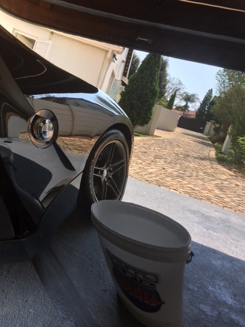

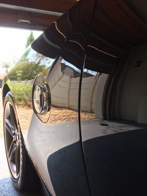

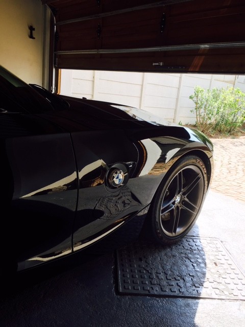

Managed to get some reflection shots after the detail... Hard to capture the Colour,depth and gloss with my iphone but here's what i got.
This is the reflection of the fendor shown on the door :=):

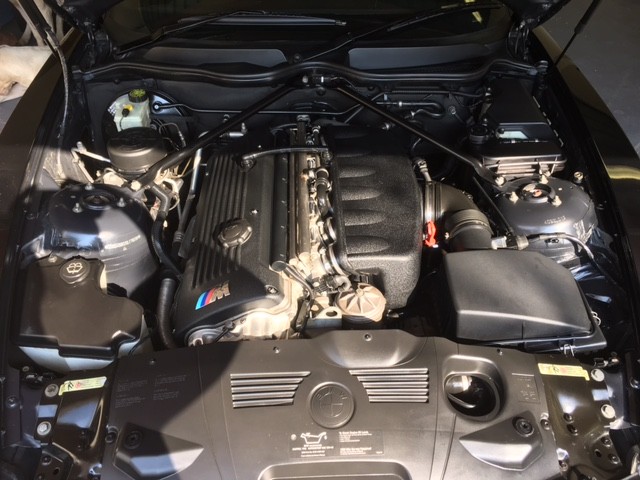

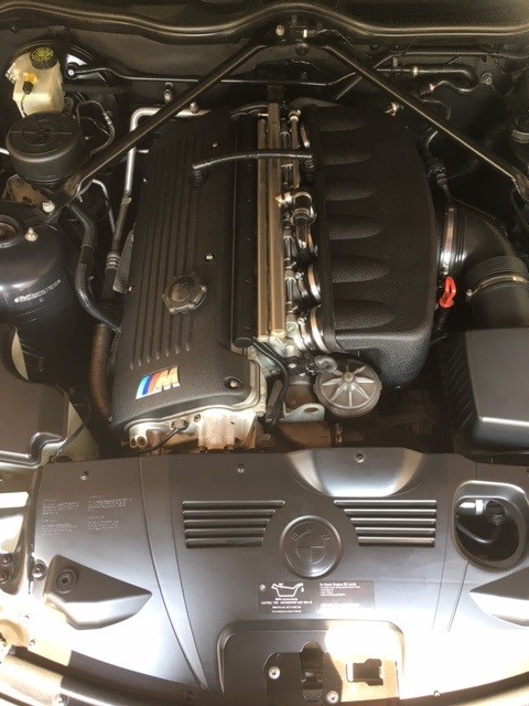

Engine Bay

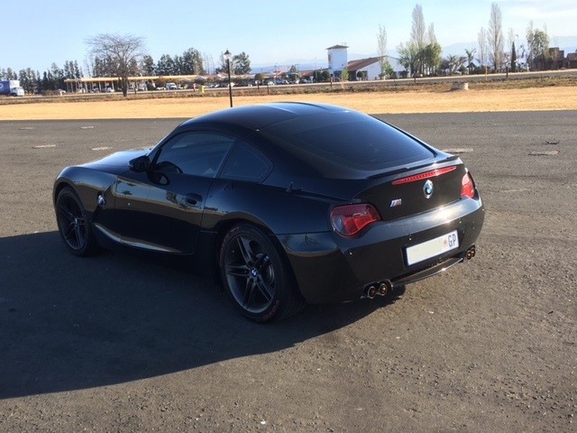

More Car Pics

Wow! Car looks amazing. Black is the hardest colour to look after/keep clean, but I think it is also the most rewarding when it is clean and shines the way yours does. Look at the "Blackfire" sealants are amazing and very easy to use. Best product I've found for black cars.
Clint@MMS AUTO
Thank you sir... heard all good things about blackfire also , Will check it out when i need to get new products.
osiris
That looks so damn beautiful dude!
When a black car shines like this it is just something of beauty! :praise:
