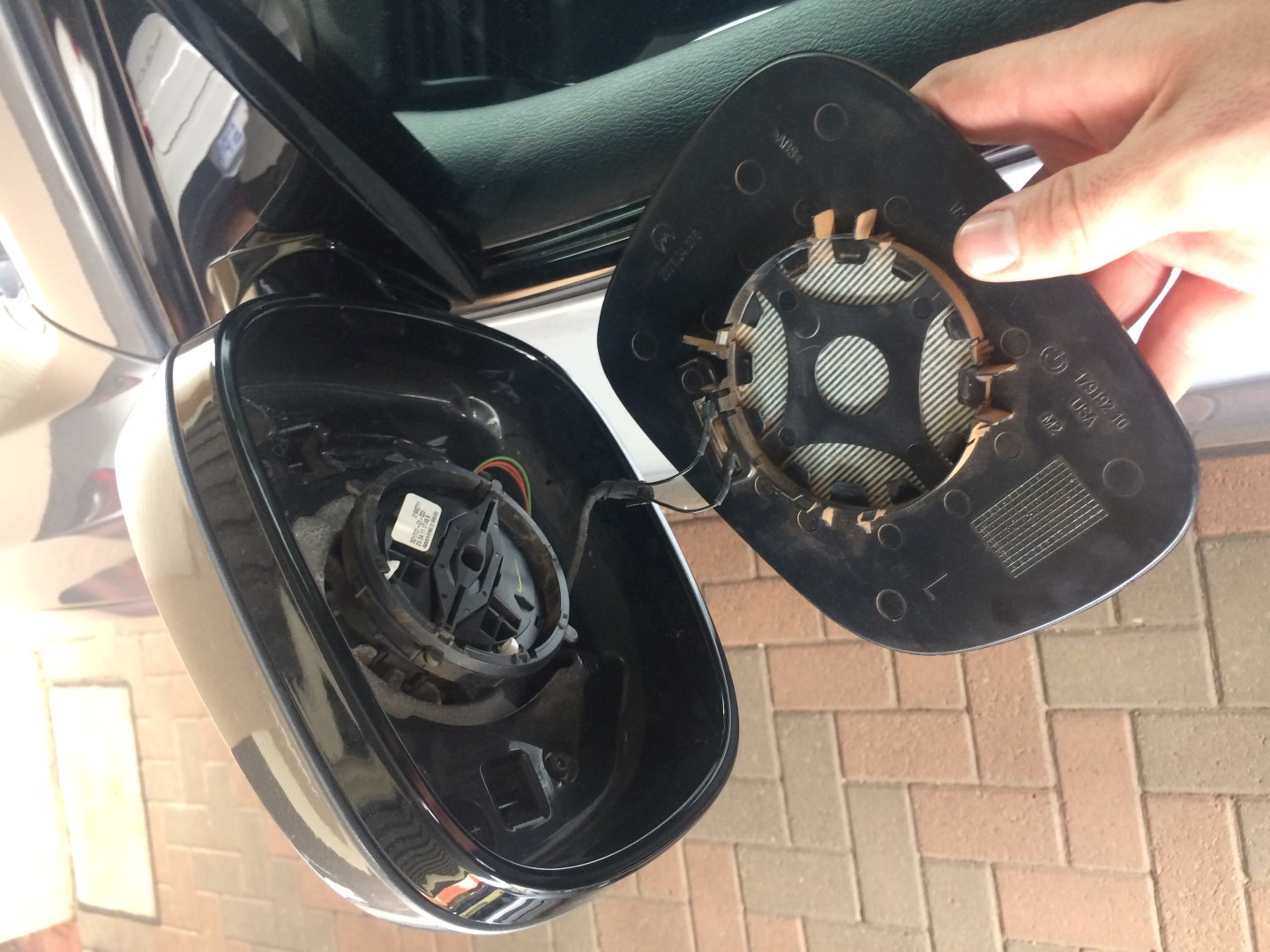

Managed to source a glass from an X3 sitting at a scrapyard. R900 vs R2200 from the stealers for a new one. :thumbdo:
Fitting it here, you can see the 2 wires to connect up for the heating function, and then the glass has this plastic backing which then clips into the motor itself:

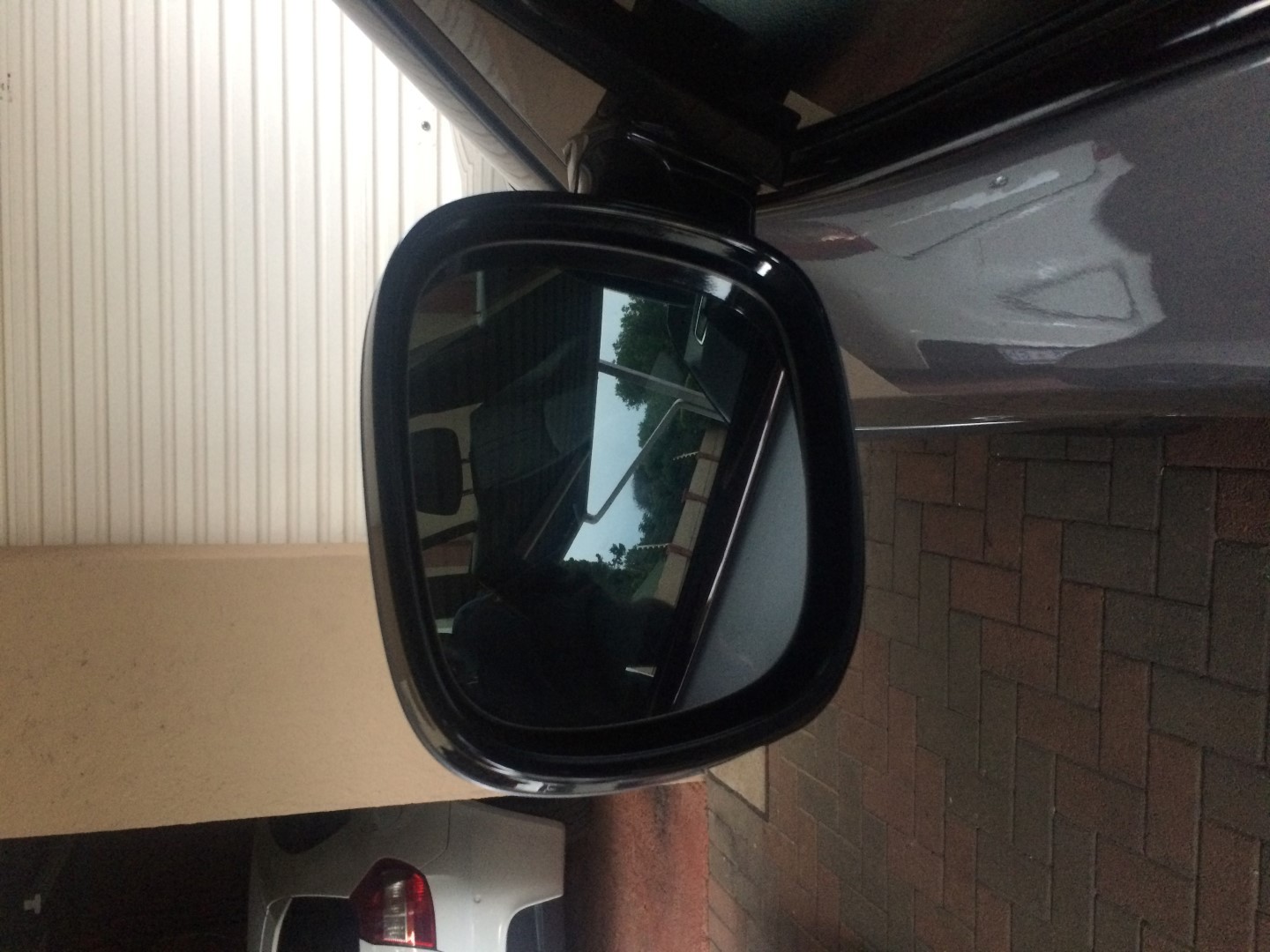

All fitted:

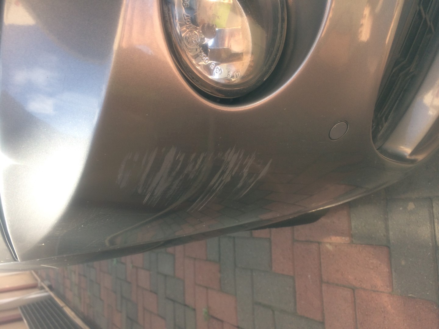

But alas, our encounters with Twats continued into the festive season. Following my wife's trip to a shopping centre, I noticed this when she came home:
Thankfully, I managed to polish most of the white/grey paint off, so now there are only some hairline scratches into our car's paint:

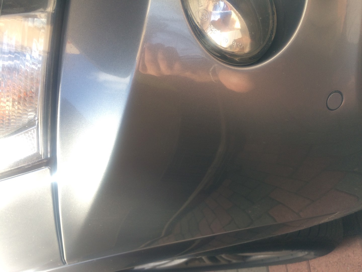

I also forgot to mention in a previous update, that some Twat opened a door into the side of the car, denting the fender on the crease just behind the front left wheel. I suspect that won't just push out, and will need repairs and a respray. Unfortunately that will have to wait for a bit.
