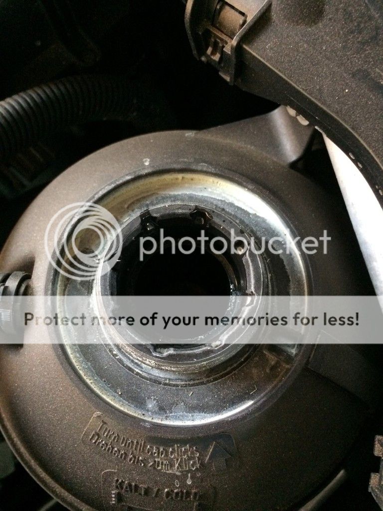

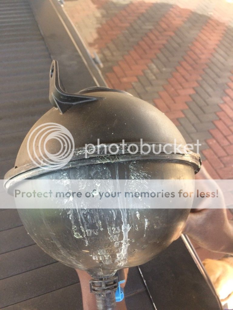

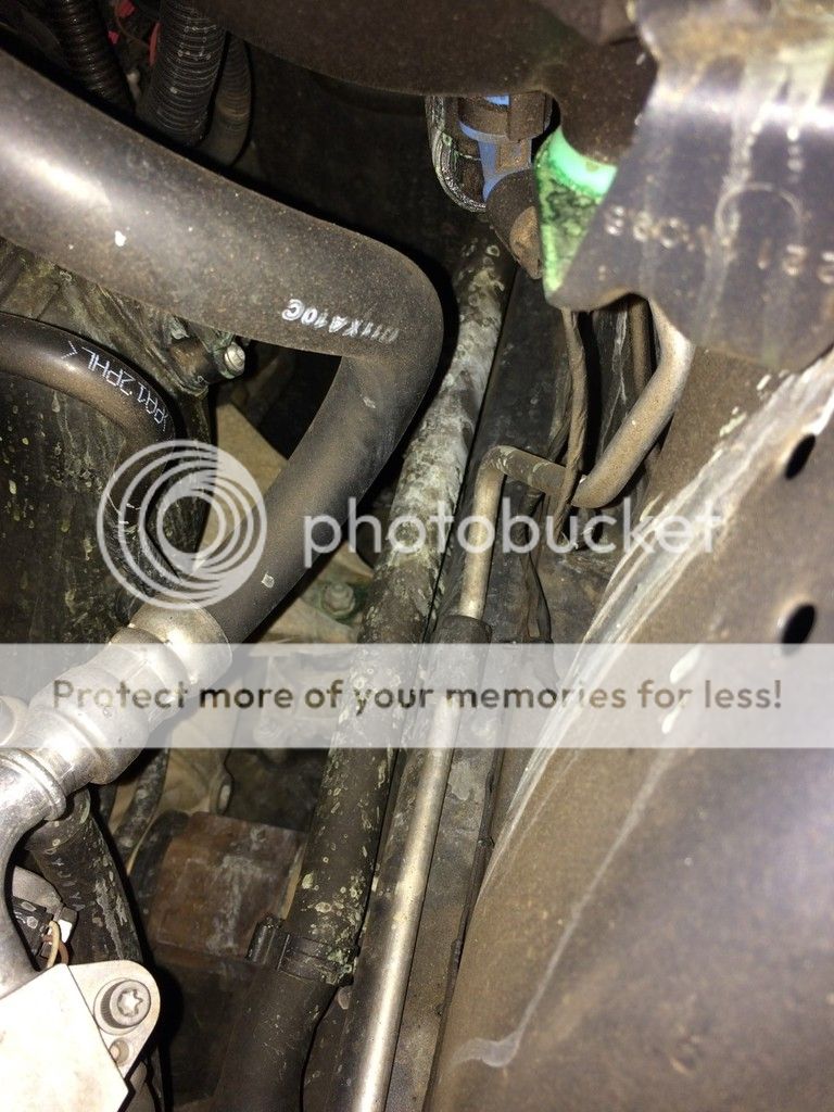

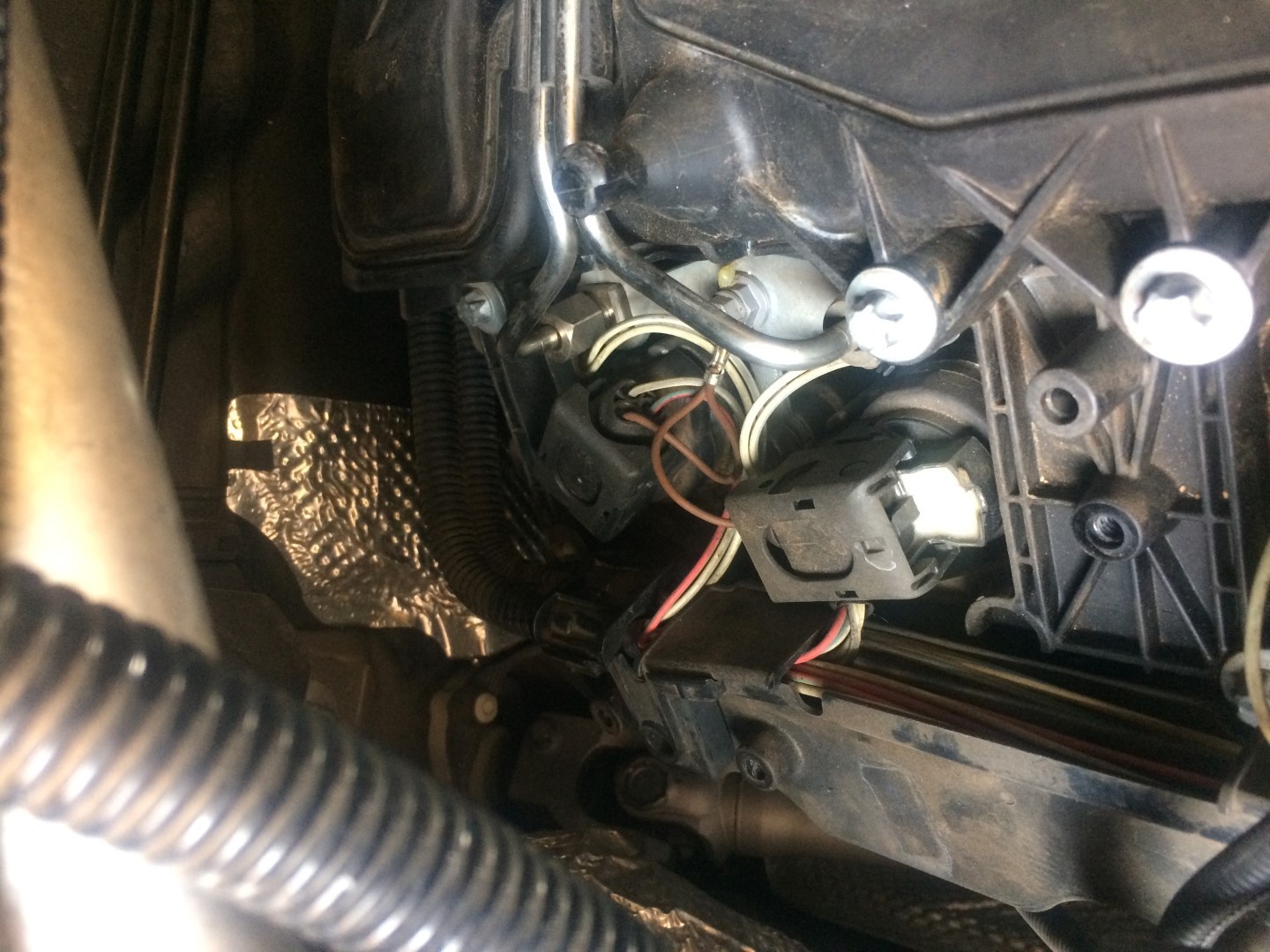

So a couple of weeks back, my wife calls me to say the X3 is complaining about low fluid. Later that evening, I arrived home to find a crime scene in the driveway - a pool of fluids lying underneath the X3 - not good.
Some poking around in the engine bay and I noticed the damage:

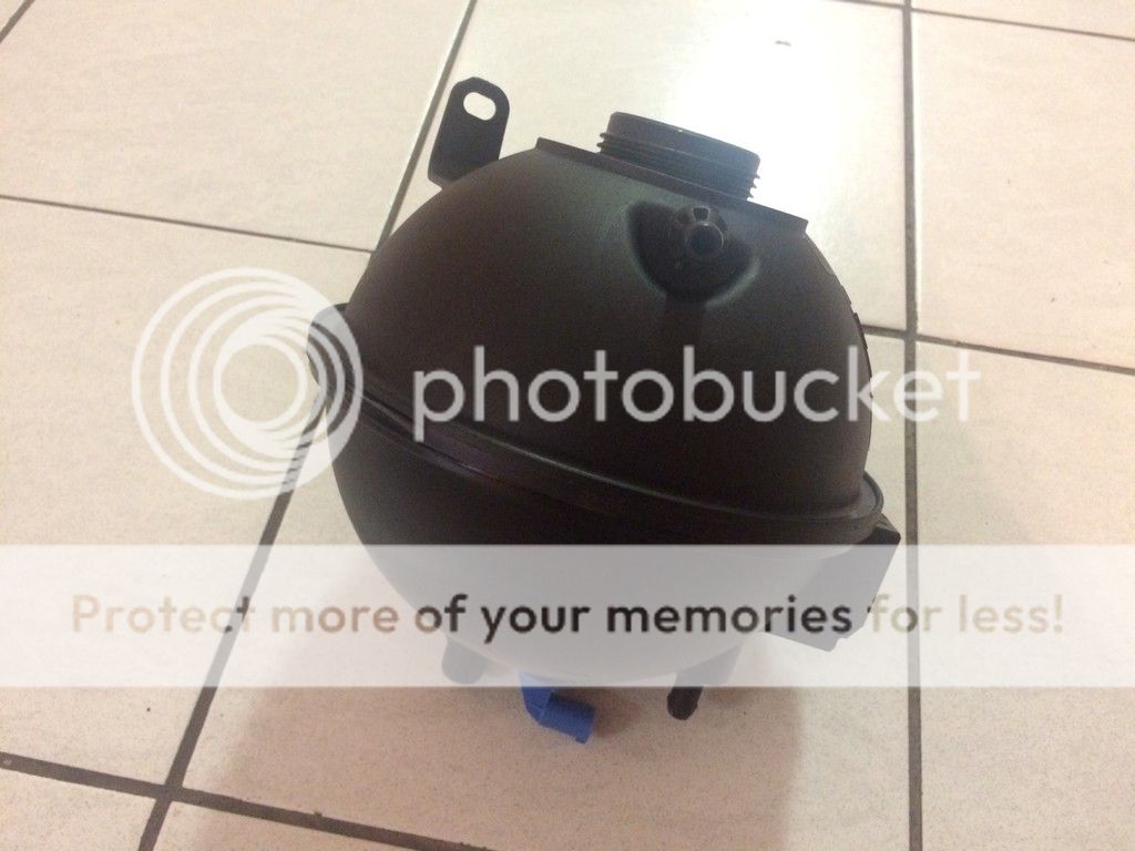

Now in October last year, it was at Bruma Auto, where I mentioned that the expansion tank cap was not clicking closed. I was concerned that it would leak and may cause significant damage if not caught in time. I had also read up that these expansion tanks warp over time - which disrupts the seal of the cap (i.e not clicking closed etc.). Their response to me was that it was only necessary to replace the cap (which they did), and that the water bottle was fine.
Anyway - 1x new expansion tank purchased:
This is what the old one looked like after removal:
In case anyone from Bruma Auto reads this - This is the cap fitted to the new bottle. Notice the click when it closes and the arrows line up? (As per the manufacturers recommendations on the cap/bottle itself, and as per the owner's manual). Just saying.....
[video=youtube]
Following fitment of the new expansion tank, there was a mini-incident where I ended up losing a circlip off the breather hose. Thankfully I managed to source a spare from MD House. Thank you guys.
Once everything was connected, I carried out the coolant bleed procedure. For future reference of others, this involves switching the ignition on, then pressing the accelerator flat for 10seconds. You will then hear the electric water pump engage and begin to cycle through a process to circulate the coolant. This carries on for about 10-12 minutes before completing.

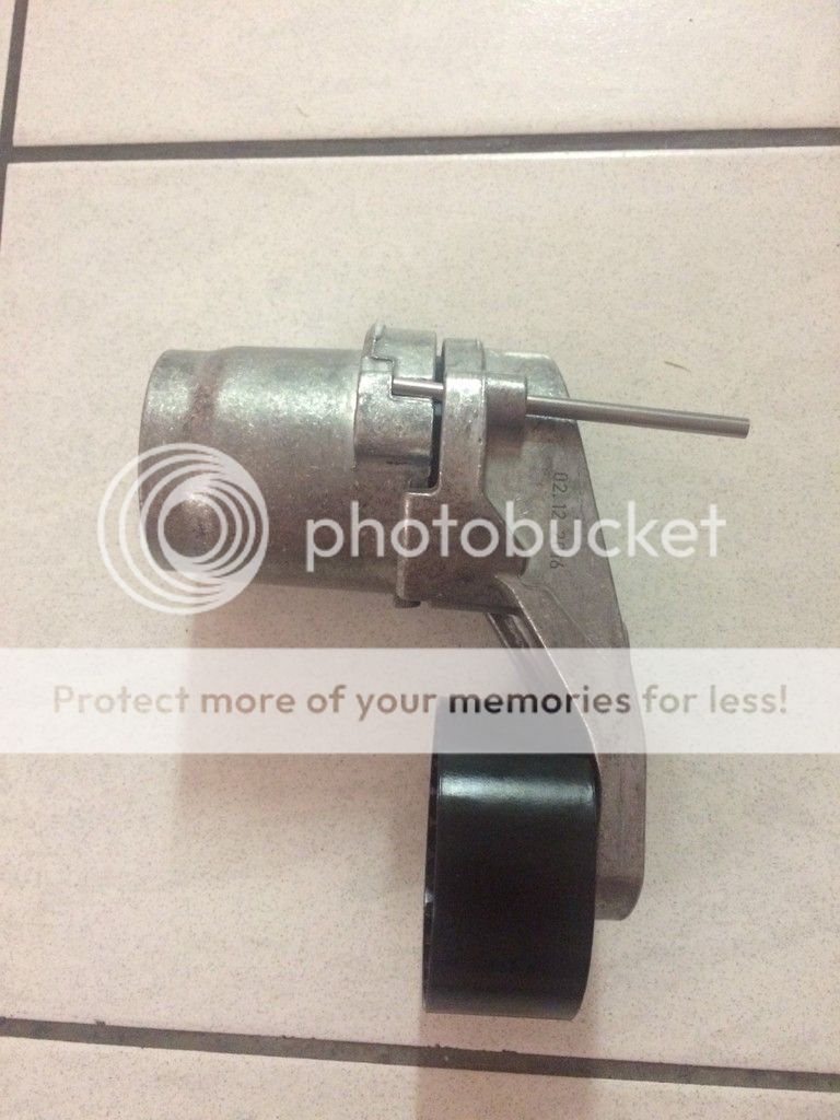

Moving on, you may recall where I posted earlier about a weird clicking noise just off idle - where it almost sounded like an actuator or solenoid of some sorts. Well I managed to troubleshoot it myself - it's the tensioner for the v-belt which is on it's way out.
[video=youtube]
So, 1x new tensioner purchased at the same time, together with the aluminium bolt:
I fitted this relatively easily. What I can say is that this tensioner provides plenty of tension. I was worried about the spanner slipping off and me losing some skin / fingers, but thankfully all is well.
For future reference, from what I found on the interwebs, is to tighten the bolt to 25Nm, and then 90deg.
The new tensioner pulley requires a firm action to rotate the pulley, whereas the old one could be spun fairly easily with little effort.
I'm also pleased to report that the annoying sound has disappeared completely. It's actually remarkably pleasant how much quieter it is now when pulling away etc.

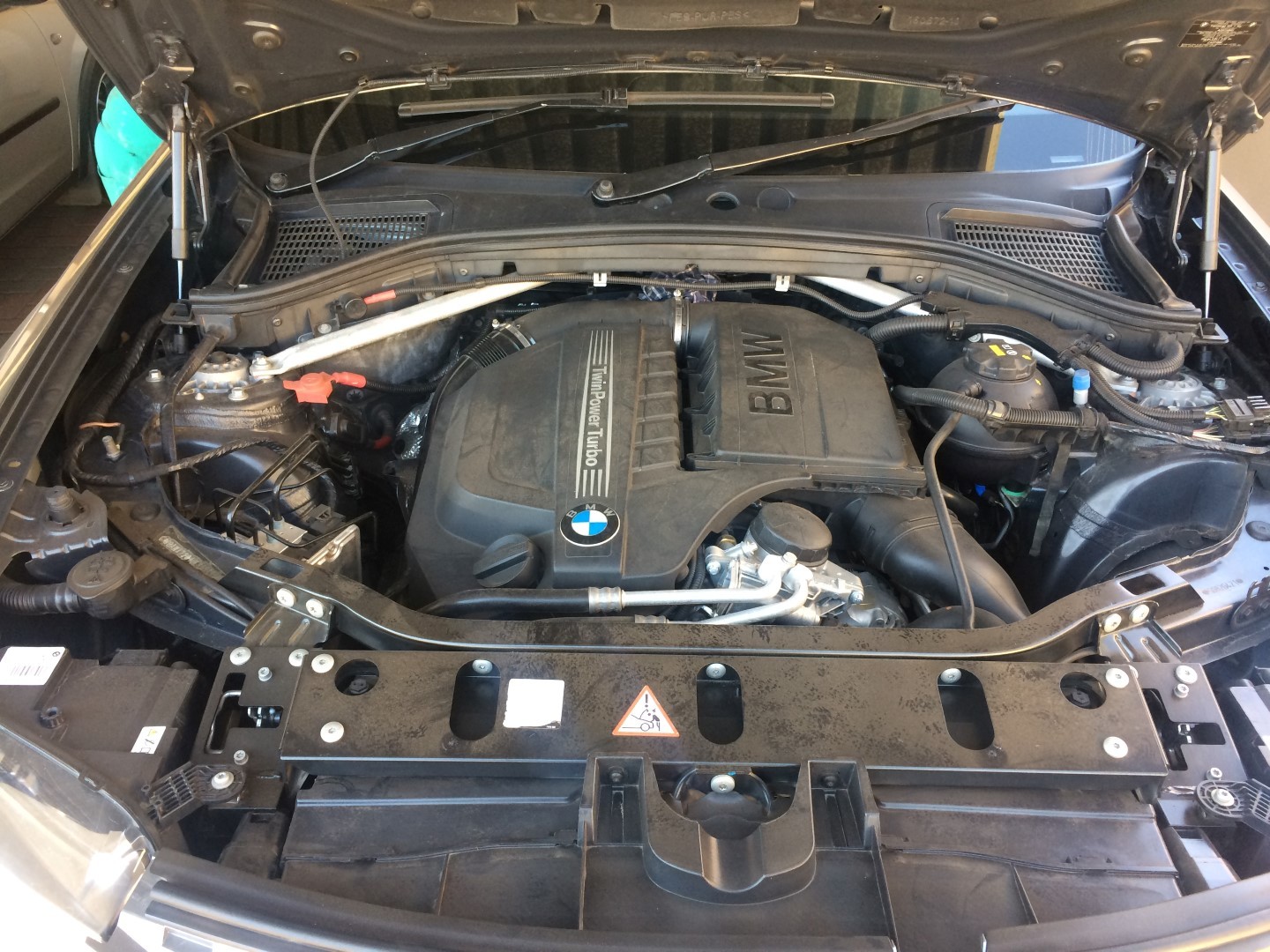

Engine bay was very dirty:

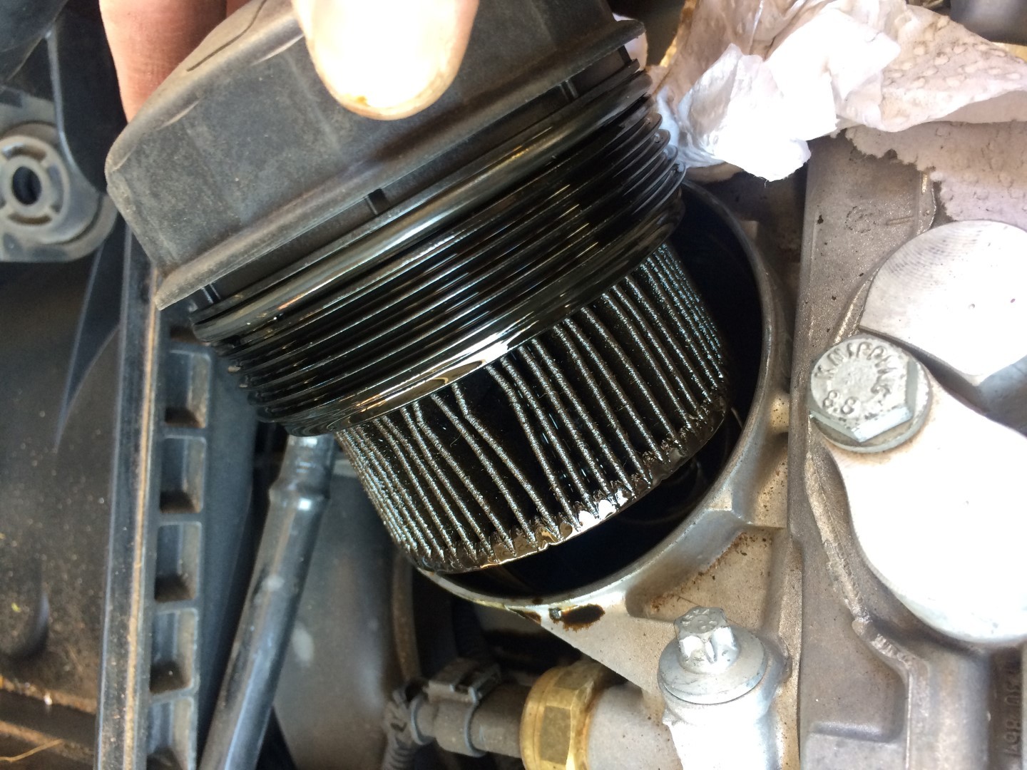

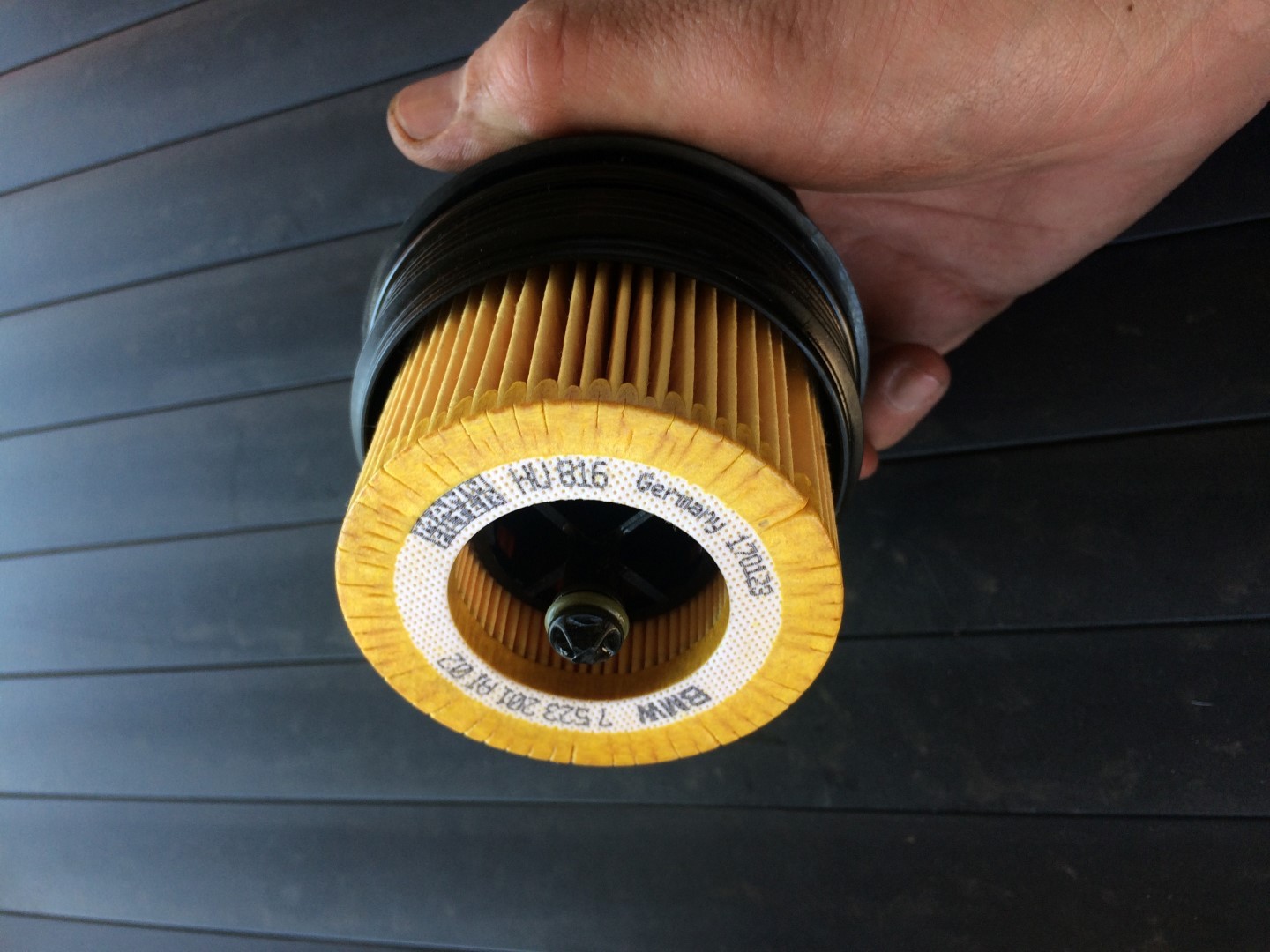

Starting off with the oil change, old filter being removed:
New filter fitted:

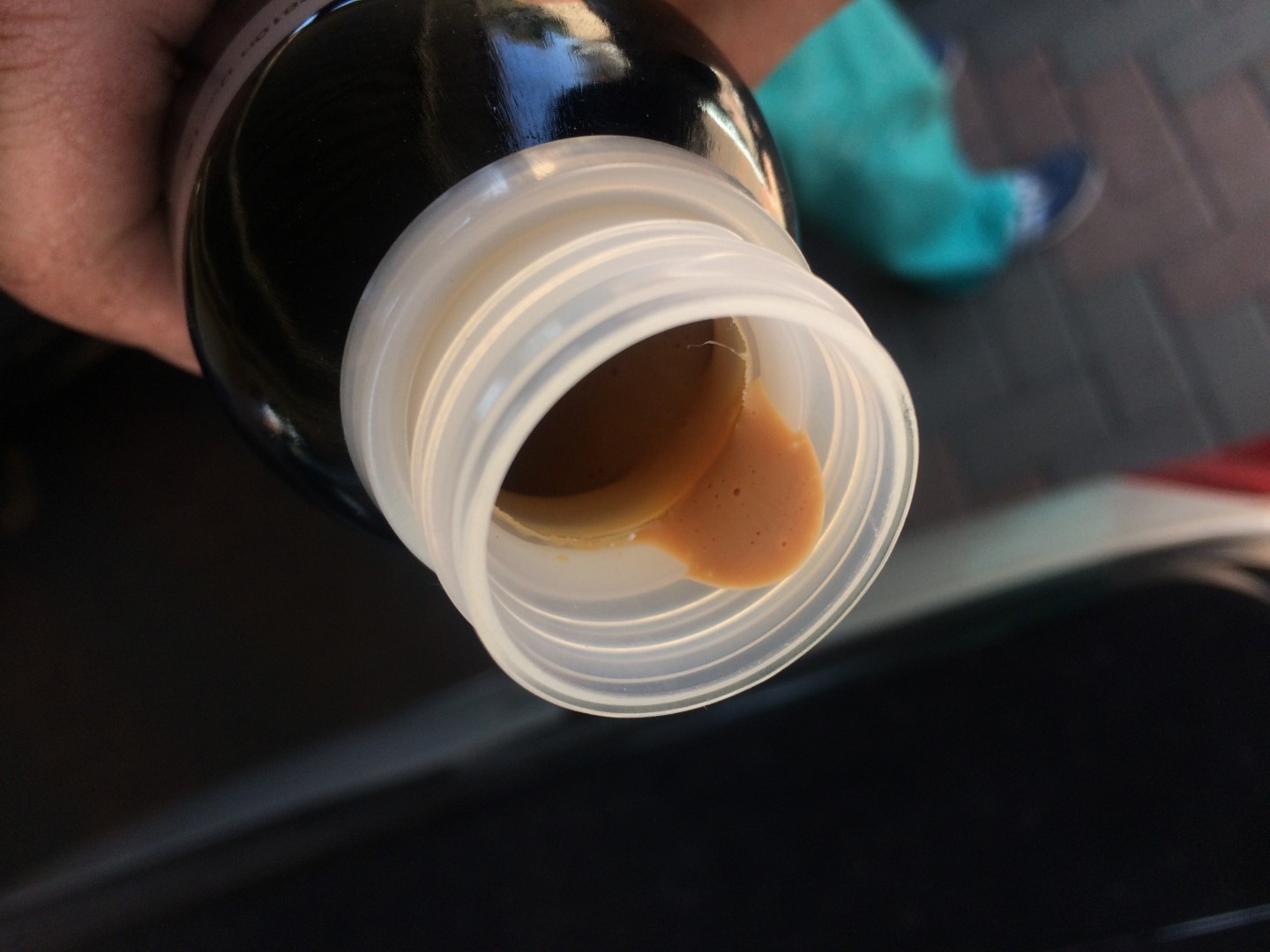

I also decided to add some Liqui Moly Ceratec, I must say it looks odd pouring this stuff into a 'clean' motor just filled with fresh oil:

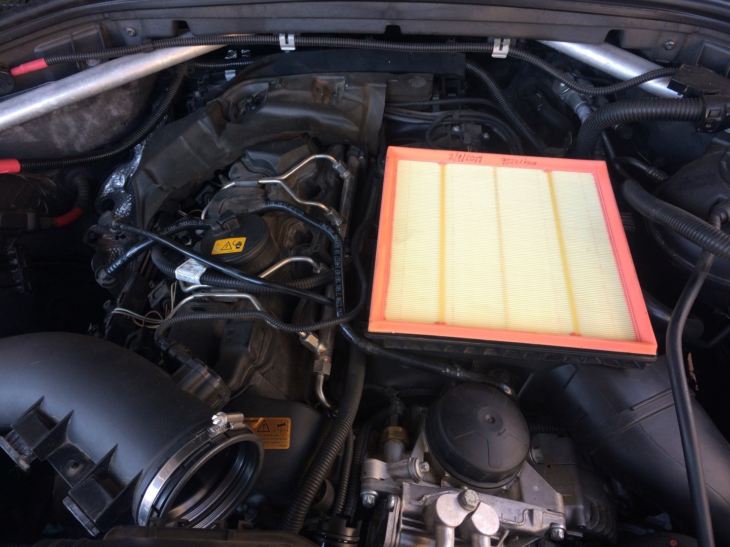

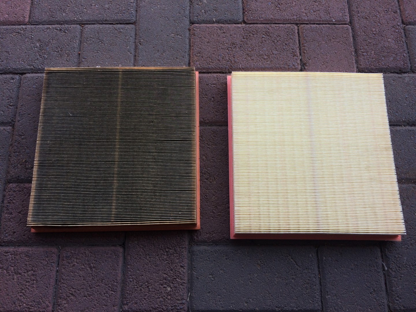

Old and new air filter:
New air filter fitted:

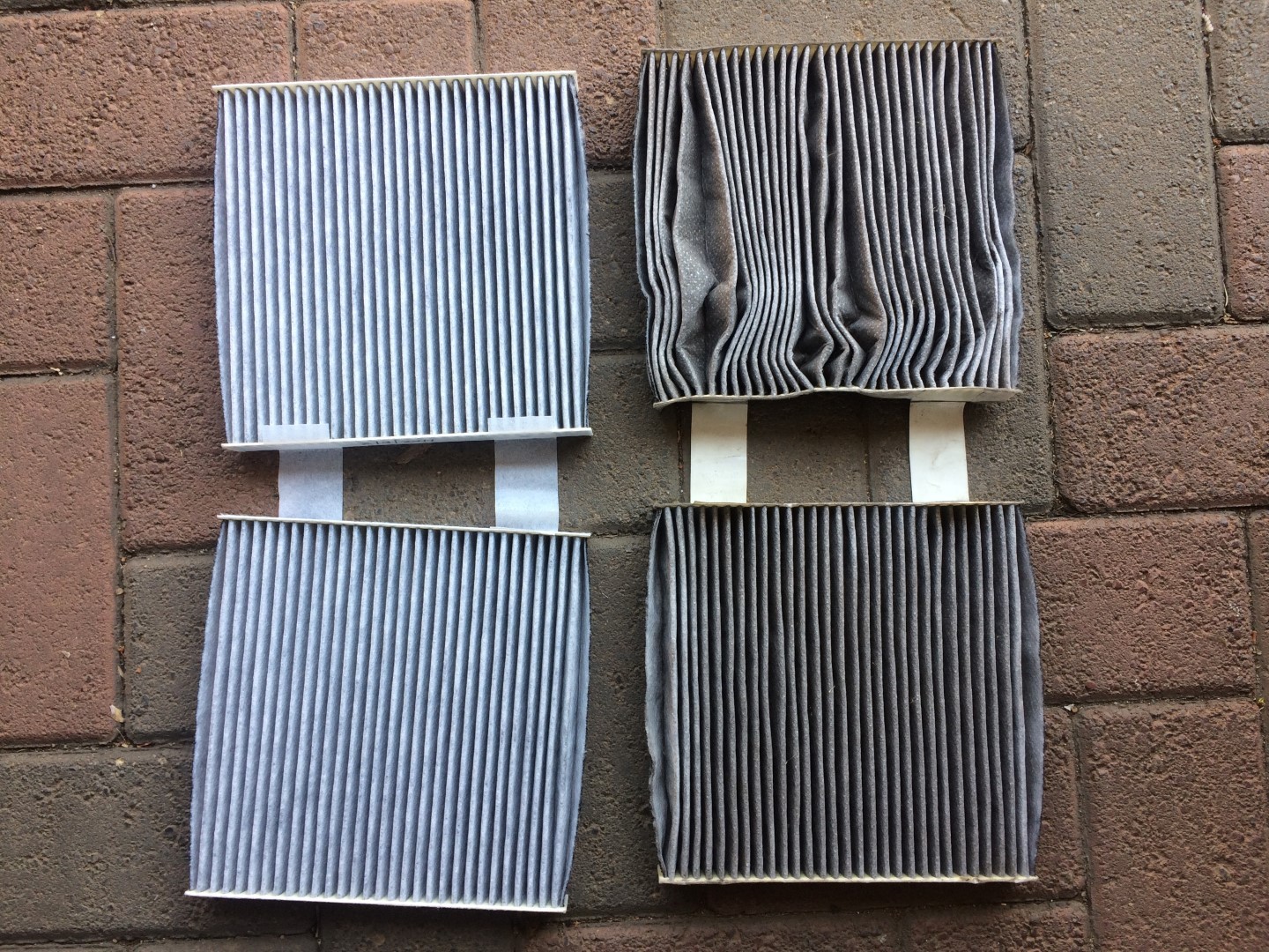

I also changed the main cabin air filter which sits below the windscreen cowl panel:

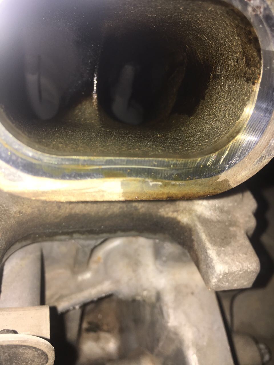

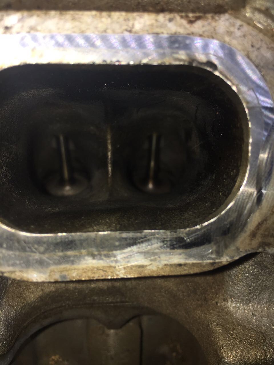

A couple of days after the service, I had the car booked in at Dark Artz Performance in Boksburg for a Carbon Clean.
Arrived bright and early, met up with Yosh, very nice chap. He had been fielding many of my questions leading up to the date, and explained in more detail on the day of the process to be followed.
We started off with scanning the car for fault codes, there were some old ones stored from a while back, but nothing serious. I then left, and would return later in the day to collect the car.
About 6 hours later, everything was completed. He shares pictures of the before and after of each cylinder. The pics below are for cylinder 5:
Before:
After:
All the others were similar. Yosh also explained that on the N55 motors, the design / location of the oil breather pipe is different to the N54 motors, resulting in less build-up. Also, any build-up is drier / harder, as opposed to the N54 which has more of a wet and sludgy build-up.
The car was also scanned after the clean to ensure that all is well.
Overall I'm happy with the service received. I can't say that there is a noticeable difference. My butt dyno may be enjoying the placebo effect. But the motor is as smooth as butter (again not to say that it was a tractor beforehand). I'm monitoring fuel consumption over the next few tanks as well to see if there is any difference.

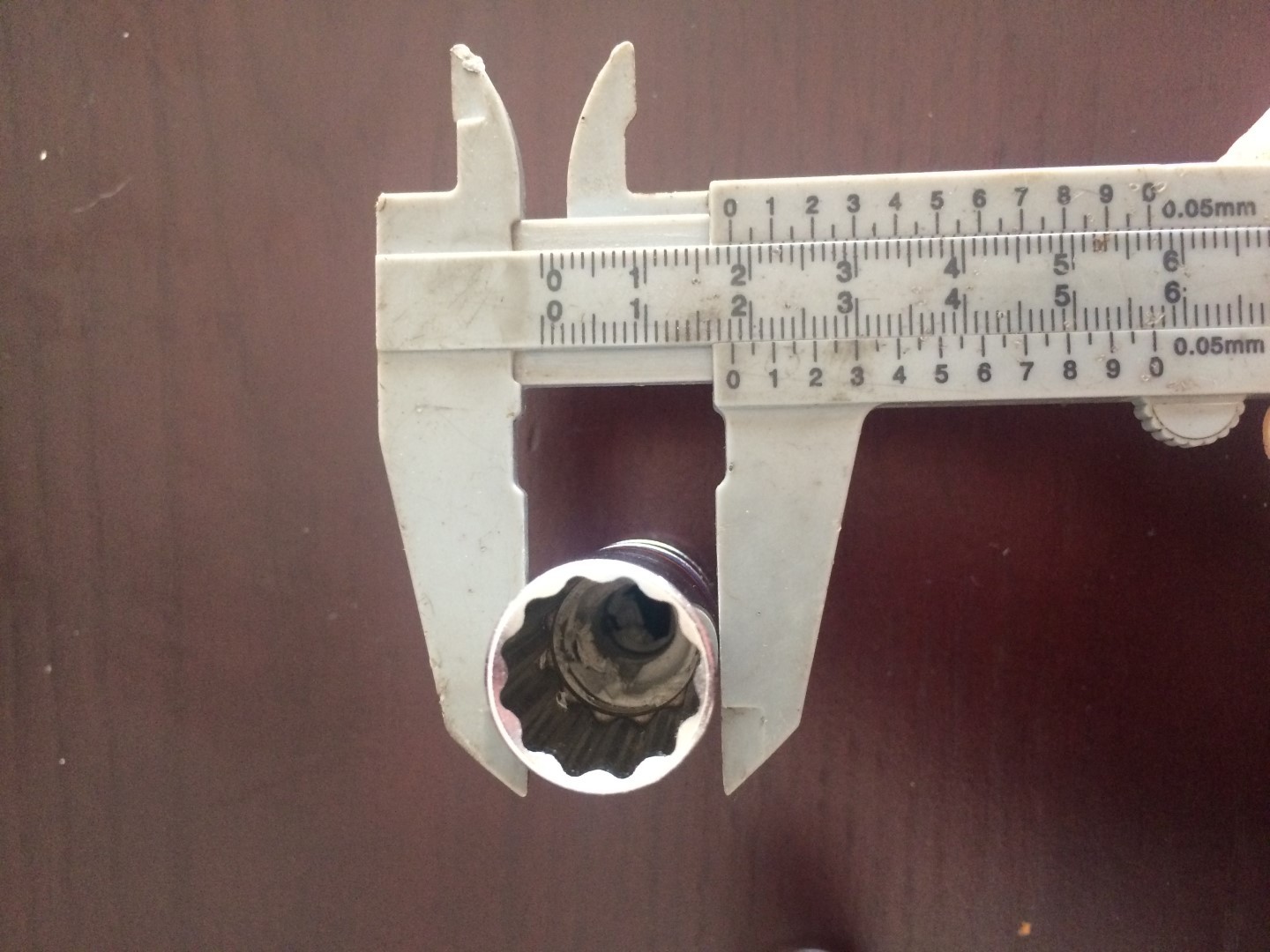

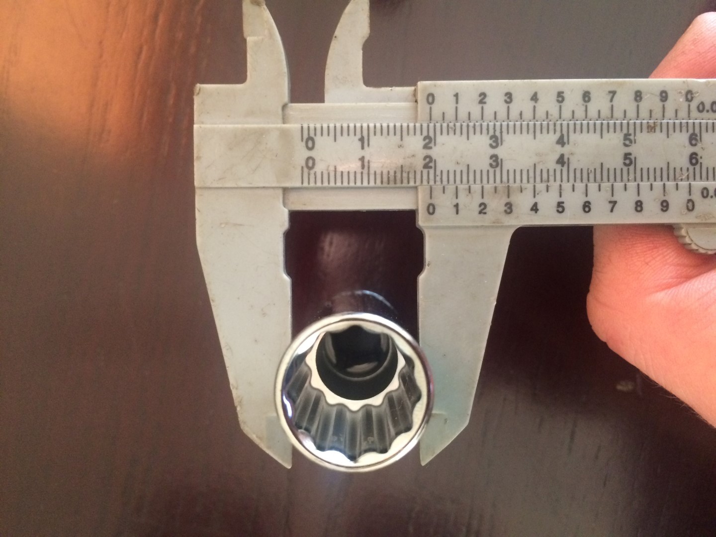

So, back to the service items. I had met with Pete to borrow his plug socket. For those who didn't see the posts elsewhere, here's the pics.
Mastercraft 14mm thin wall socket, 19.5mm:
King Tony 14mm thin wall socket, 18.5mm:
Literally a 1mm difference, but that was enough to stop me from doing the job in the first place. Thanks again Pete.

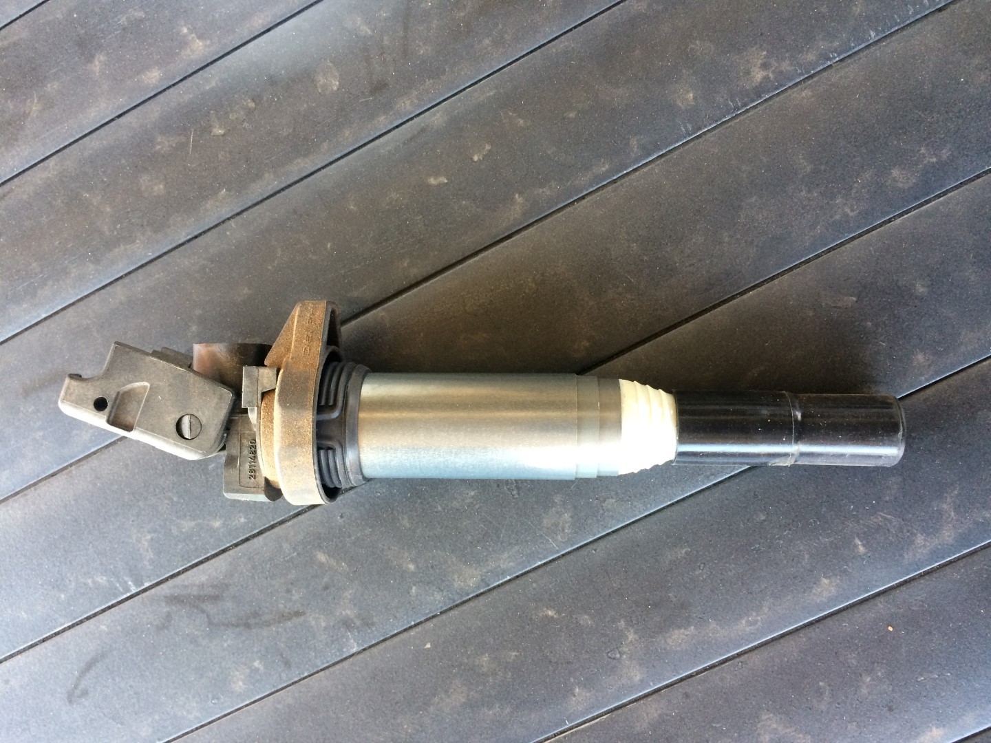

Just a quick pic of what the coil packs look like:

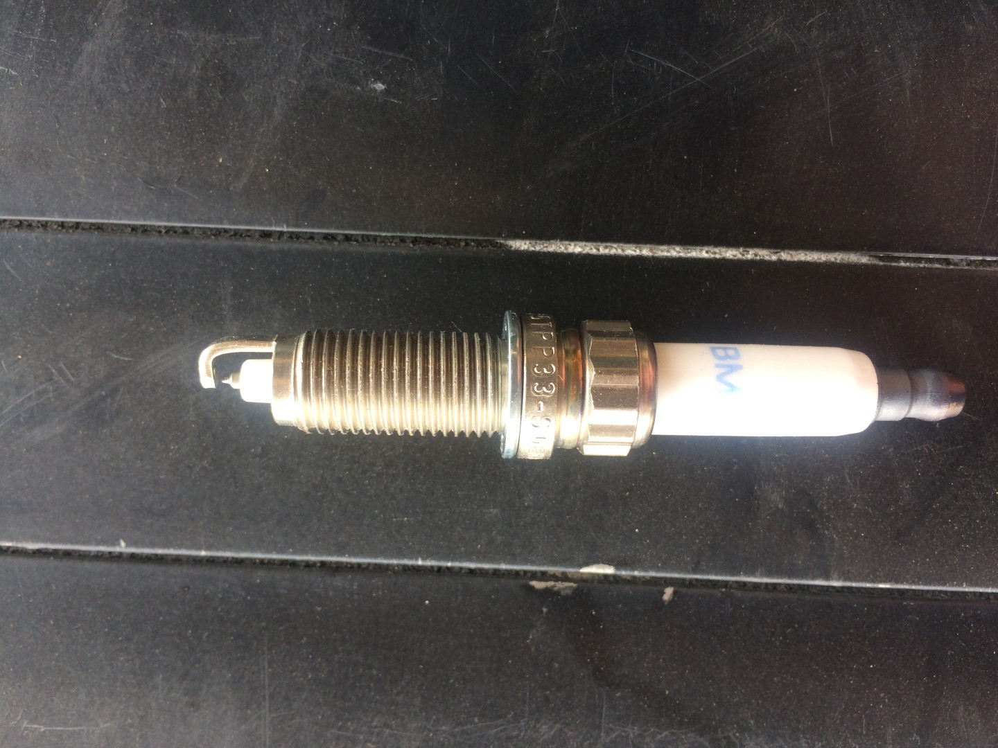

New plug:

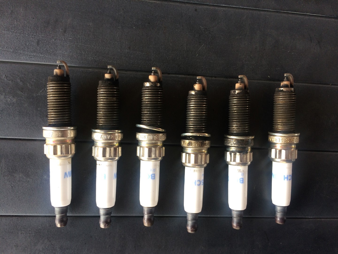

Old plugs, approx. 50000kms old. Cylinder 1-6 from left to right:
Getting to cylinder 5 and 6 was a challenge, I ended up going to buy 2 different length extensions, to make a length that could fit in the gap with the ratchet:

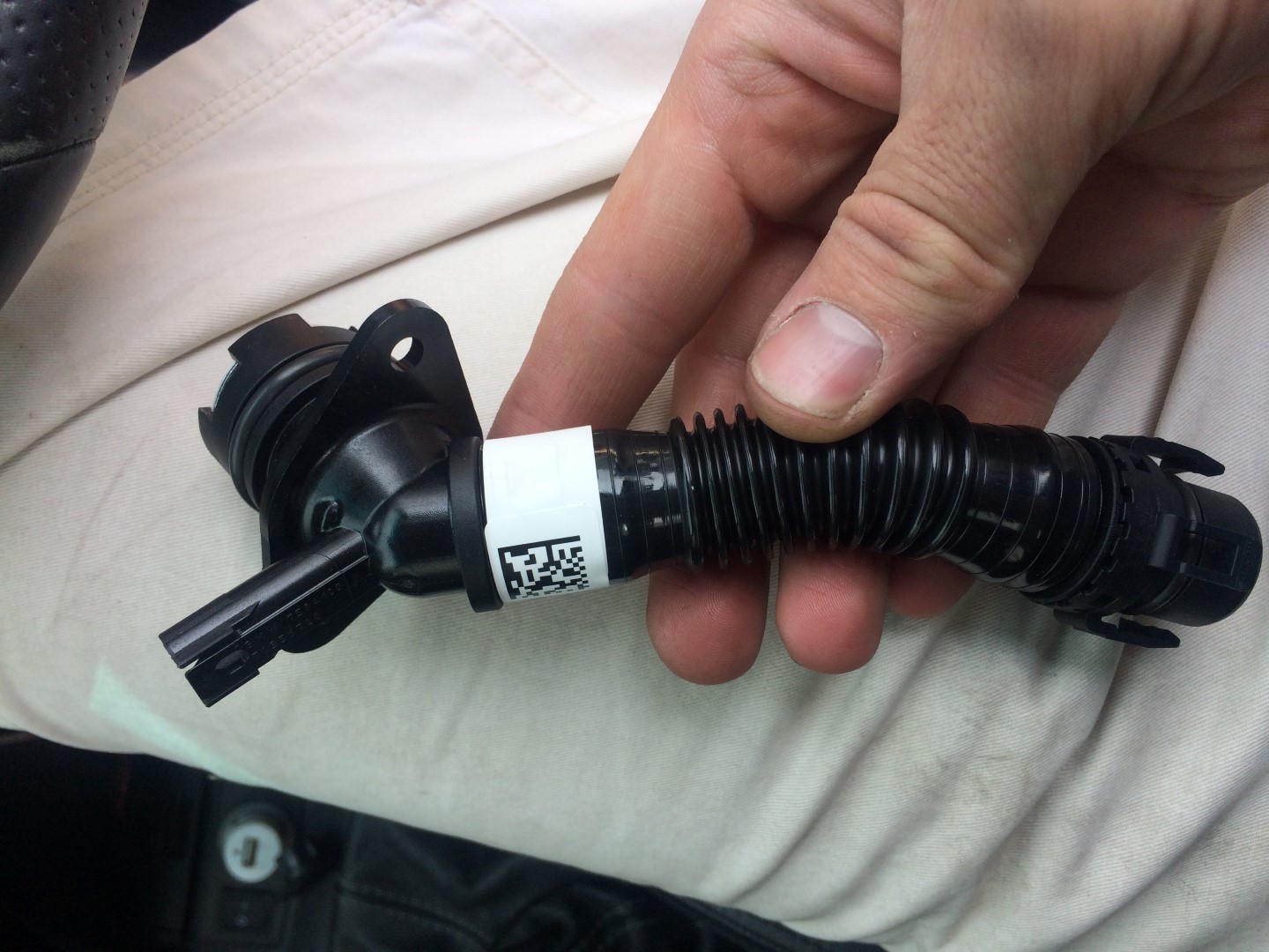

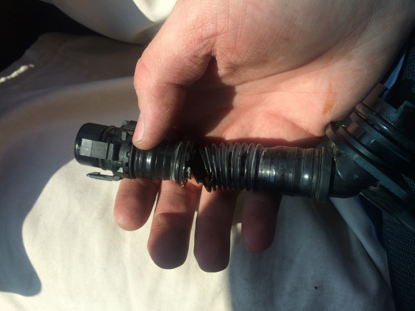

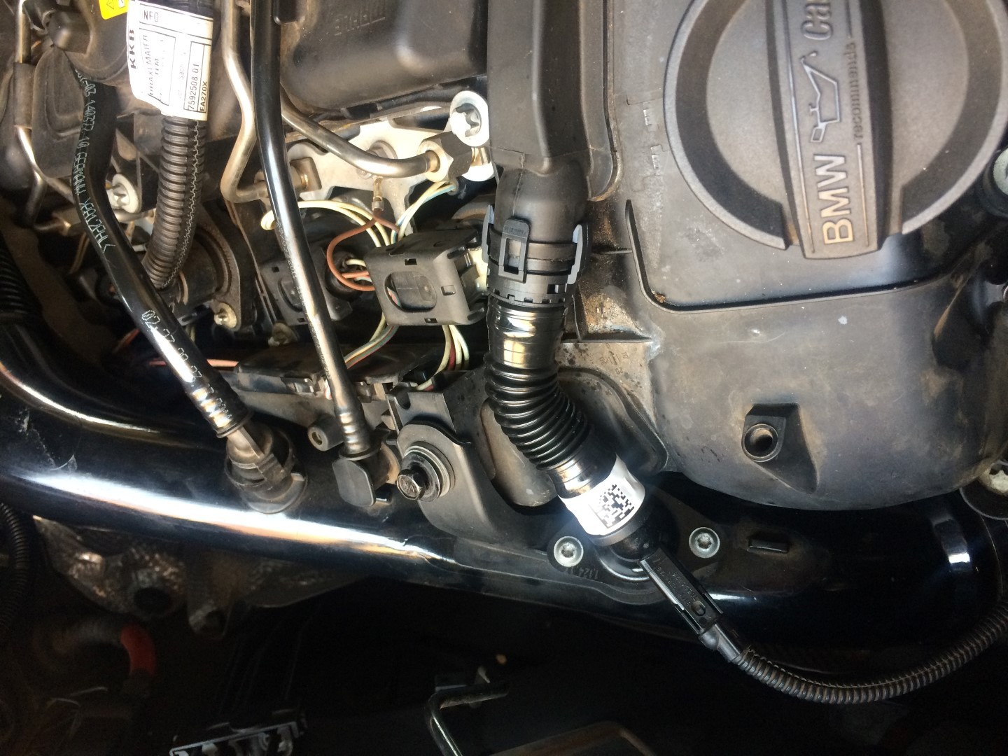

It was inevitable, but my oil breather also cracked when i was refitting it. The plastic gets hard and brittle from the heat. I ended up having to trek to Zambezi in PTA to collect the new pipe.
Old pipe:
New pipe:
Fitted:

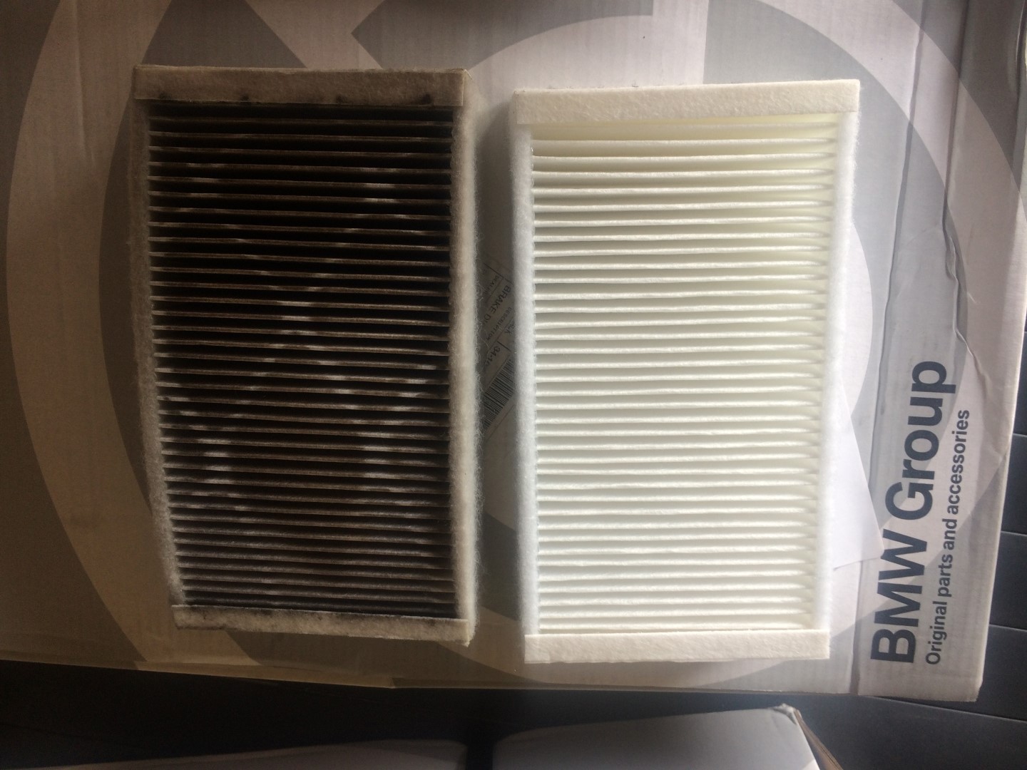

Pete also pointed out to me that there was a secondary cabin air filter which you access through the glovebox. Strangely enough, it's tricky to source these things. The part number listed for the X3 is no longer available, but there is a part number for the E70 X5.
Old and new filter:

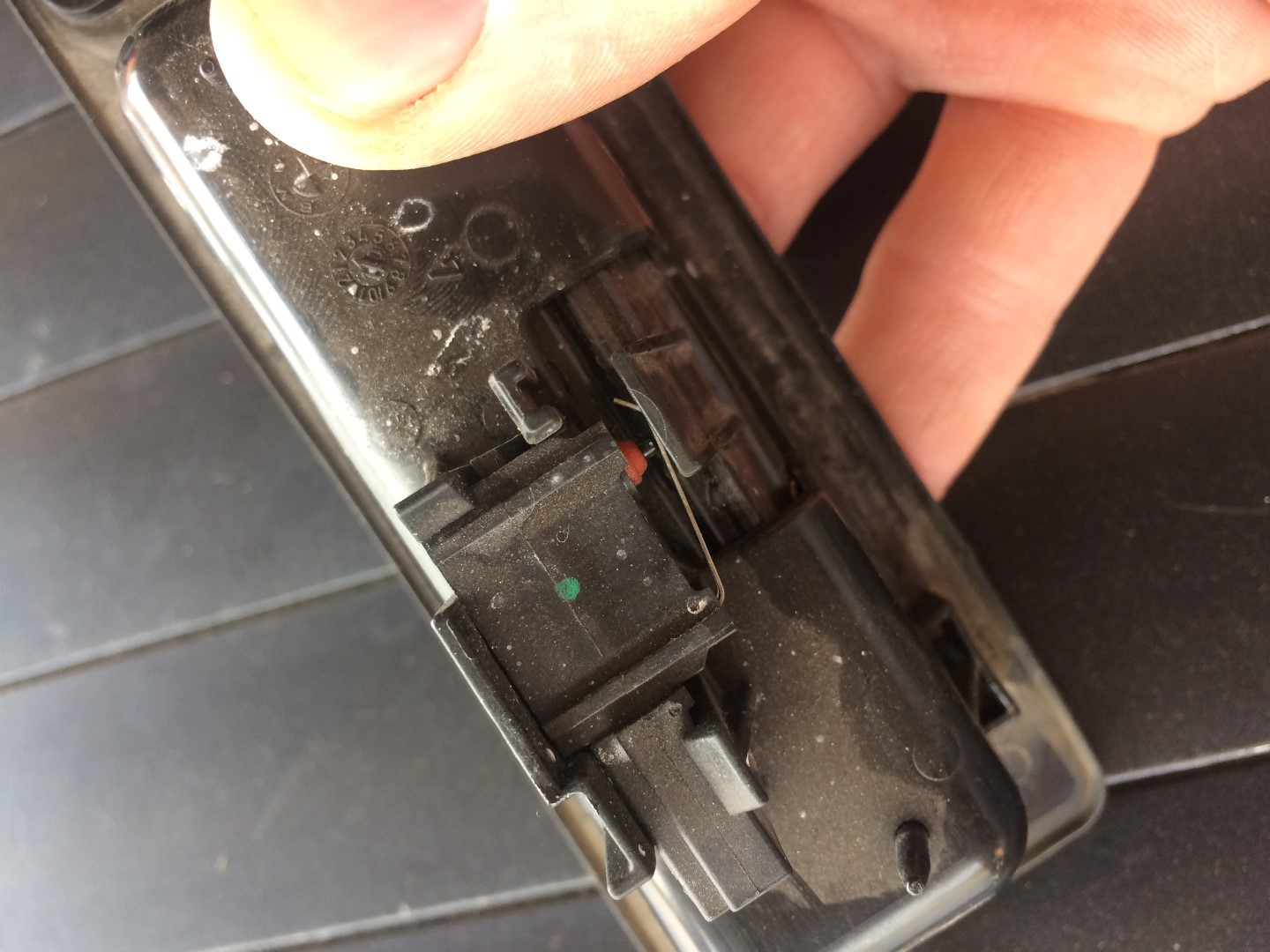

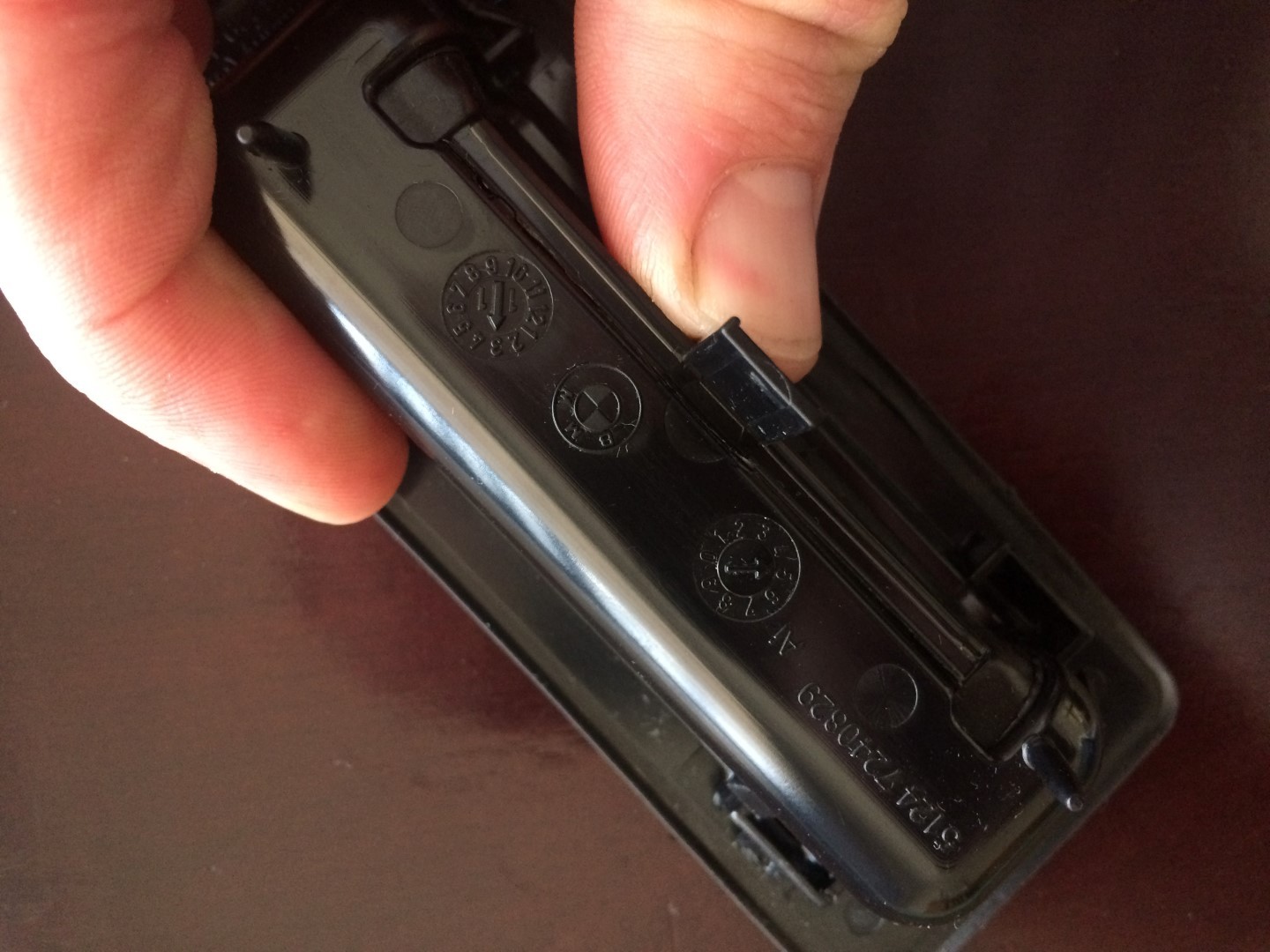

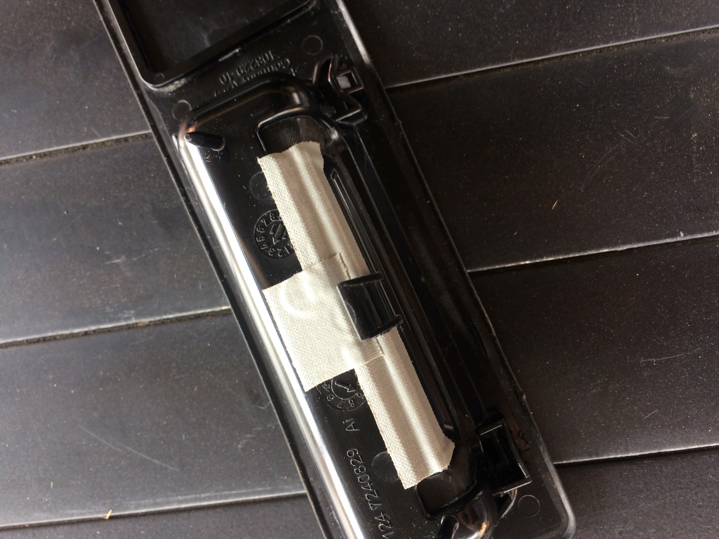

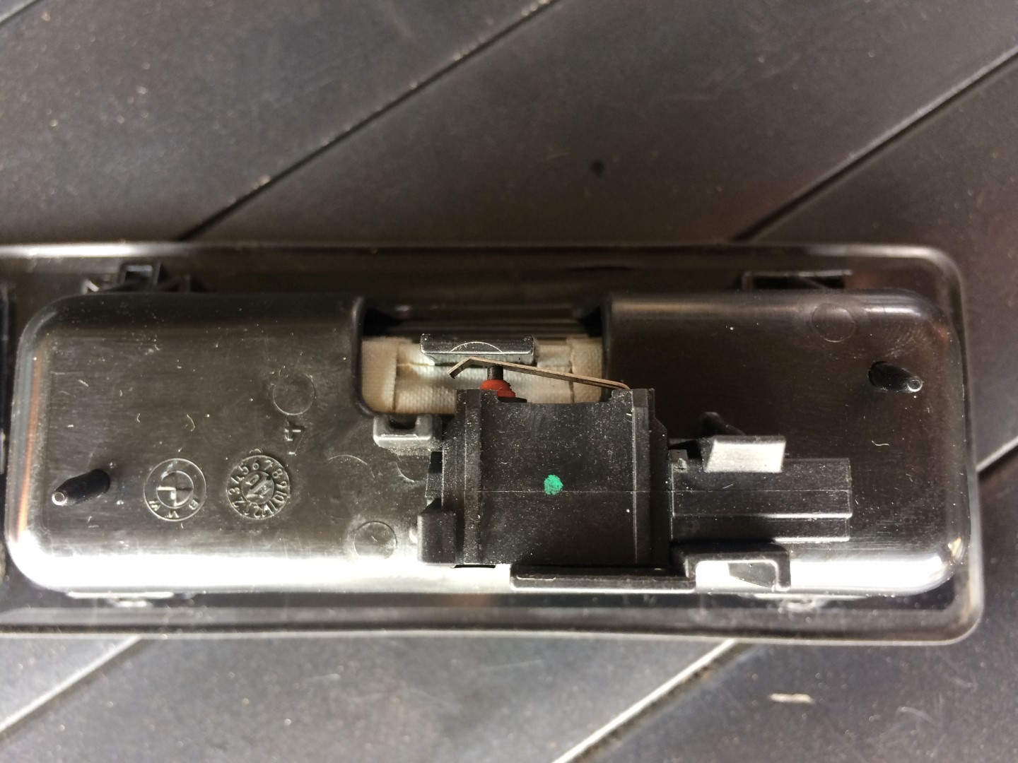

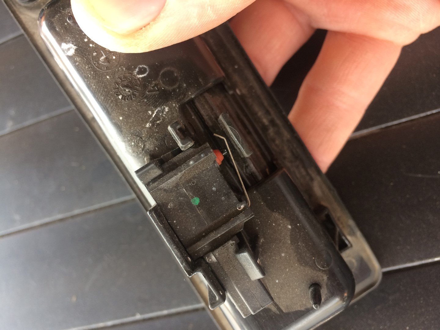

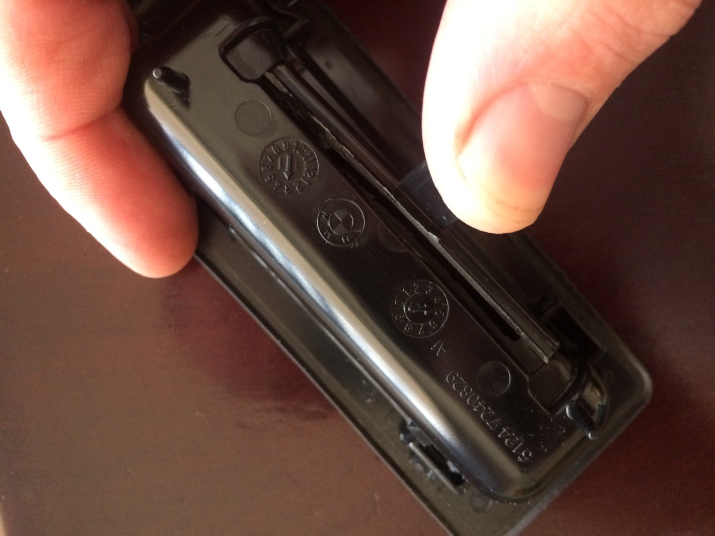

Then, the boot lid handle stopped working. There are a number of threads and discussions elsewhere on this (for various models). I had some free time on a sunday morning so I decided to strip it off to take a look.
I had to remove the number plate and holder, in order to get enough access to remove the handle. What i found, is that the handle itself had broken off on a hinged side. As such, when pressing the handle, it wasn't activating the microswitch. Pics will show this better.
Handle at rest:
Pressing the handle (note it doesn't touch the microswitch):
Here you can see how the handle is cracked on the hinged side:
Here's a quick video of the problem, there is no click / activation from the microswitch:
[video=youtube]
I scratched out some Tessa tape which I use on my bakkie's Armadillo, and proceeded with fixing the issue:
Fitted back into the handle housing:
And a video clip of the repair working:
[video=youtube]
All has been operating well since then, glad my fix has worked.

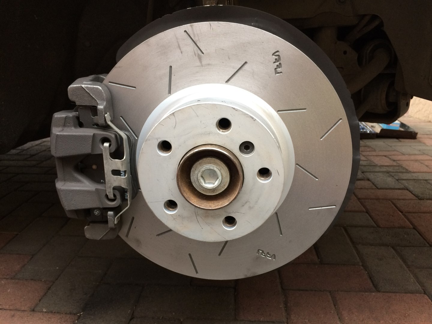

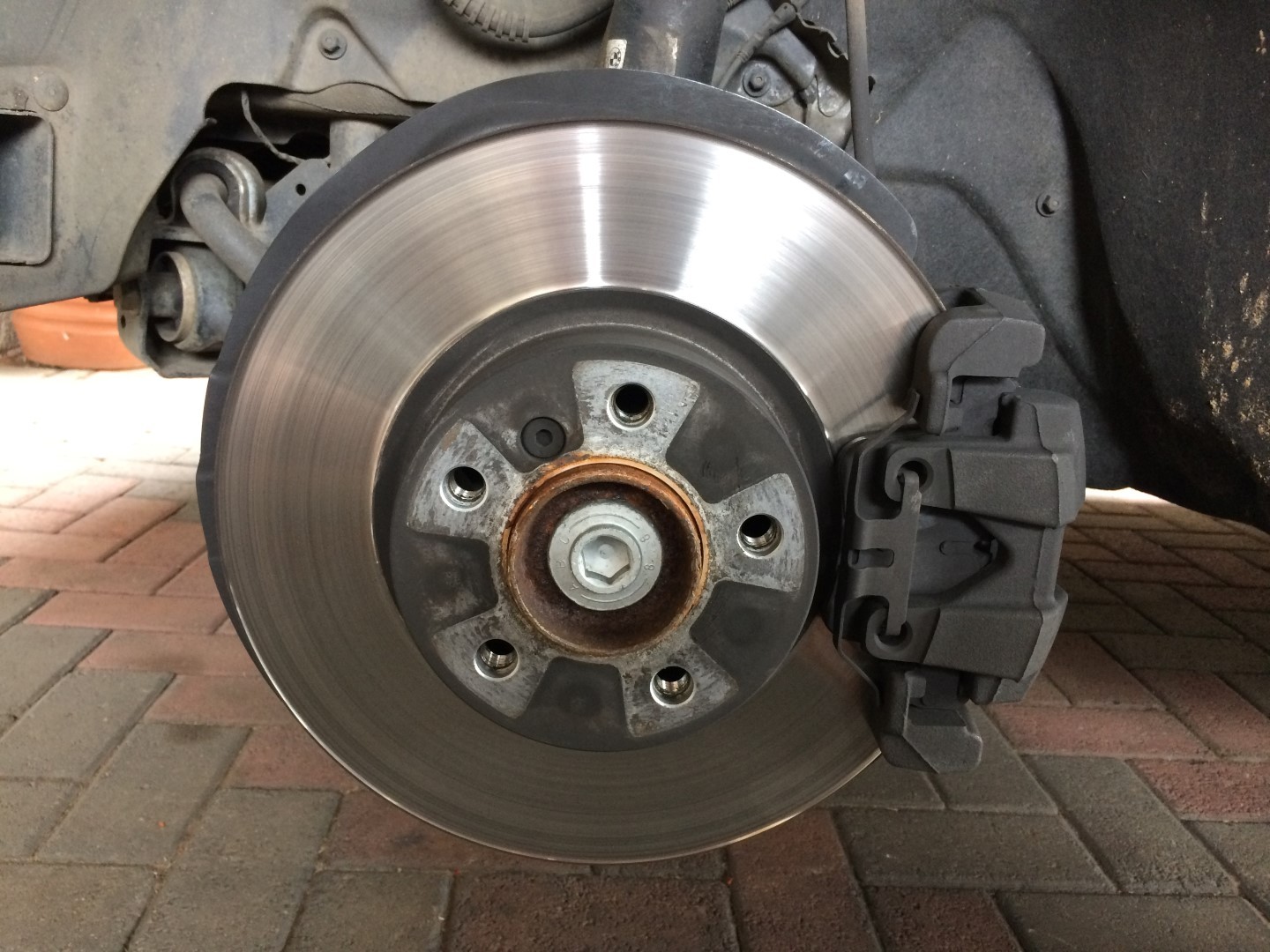

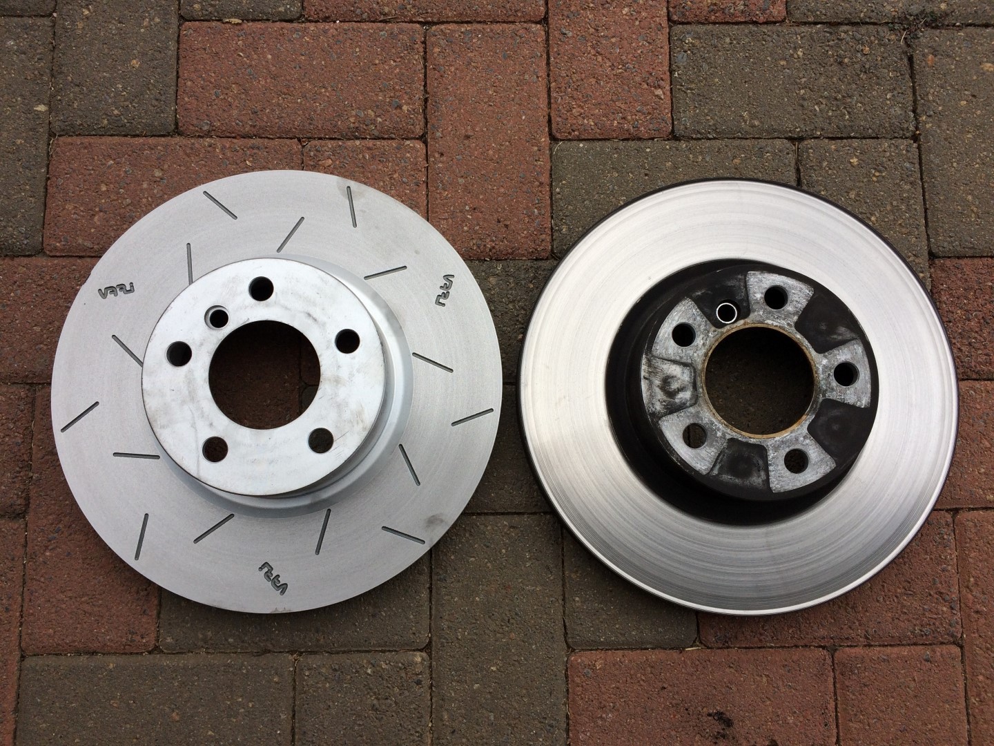

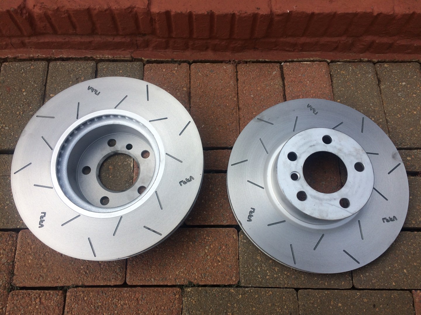

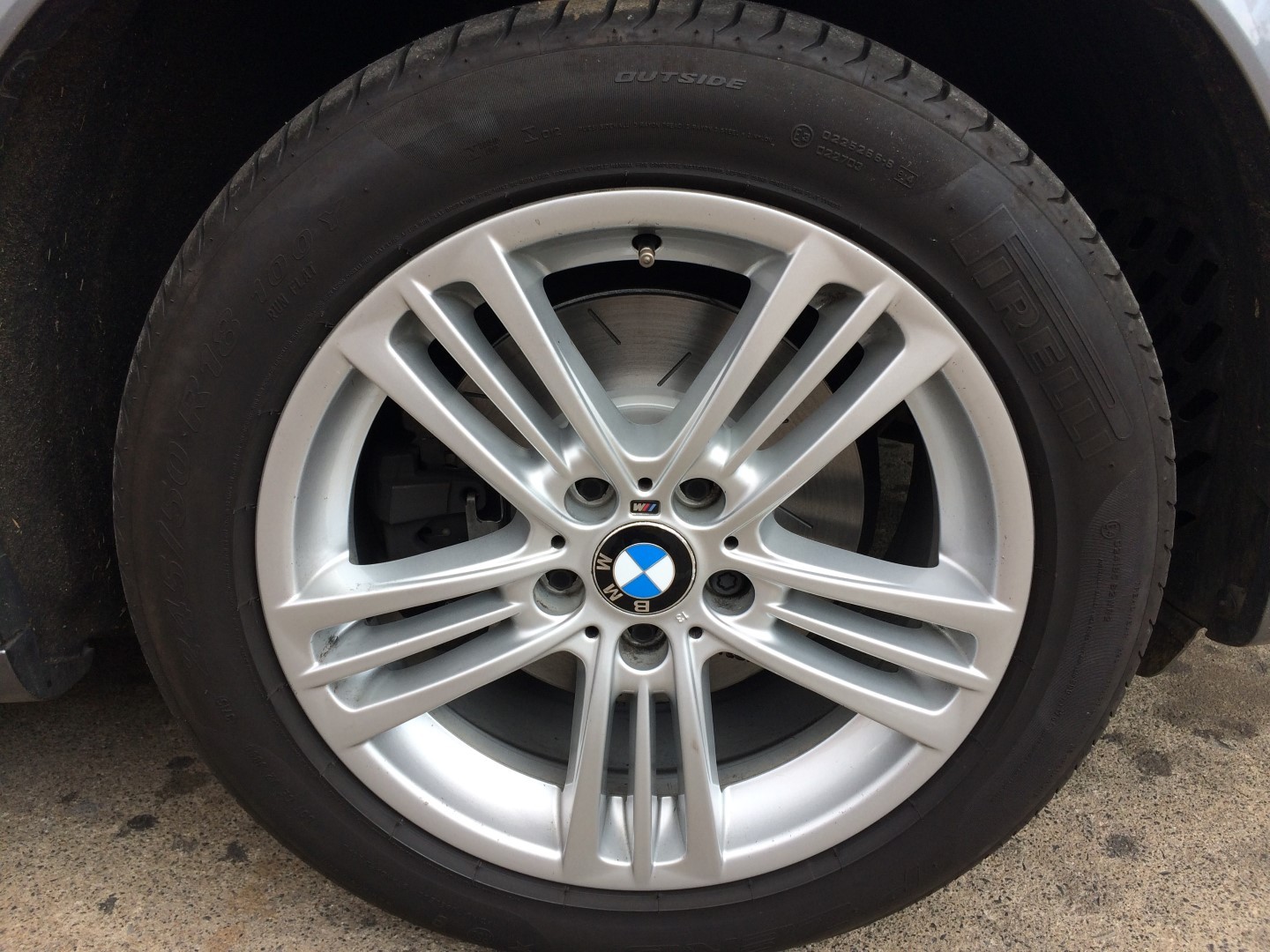

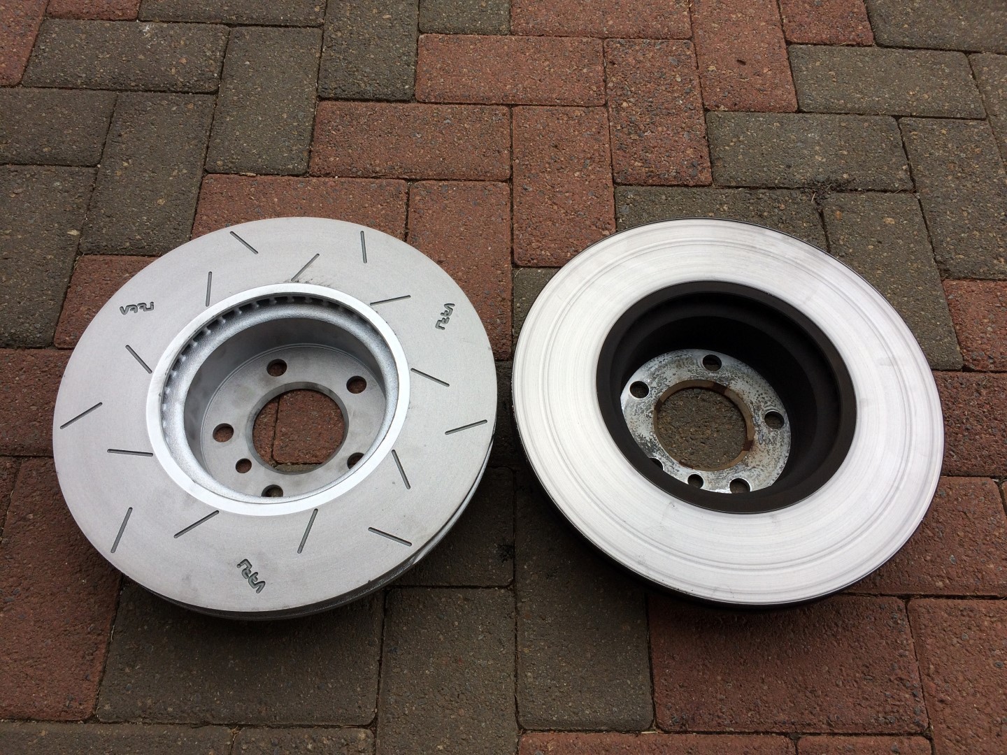

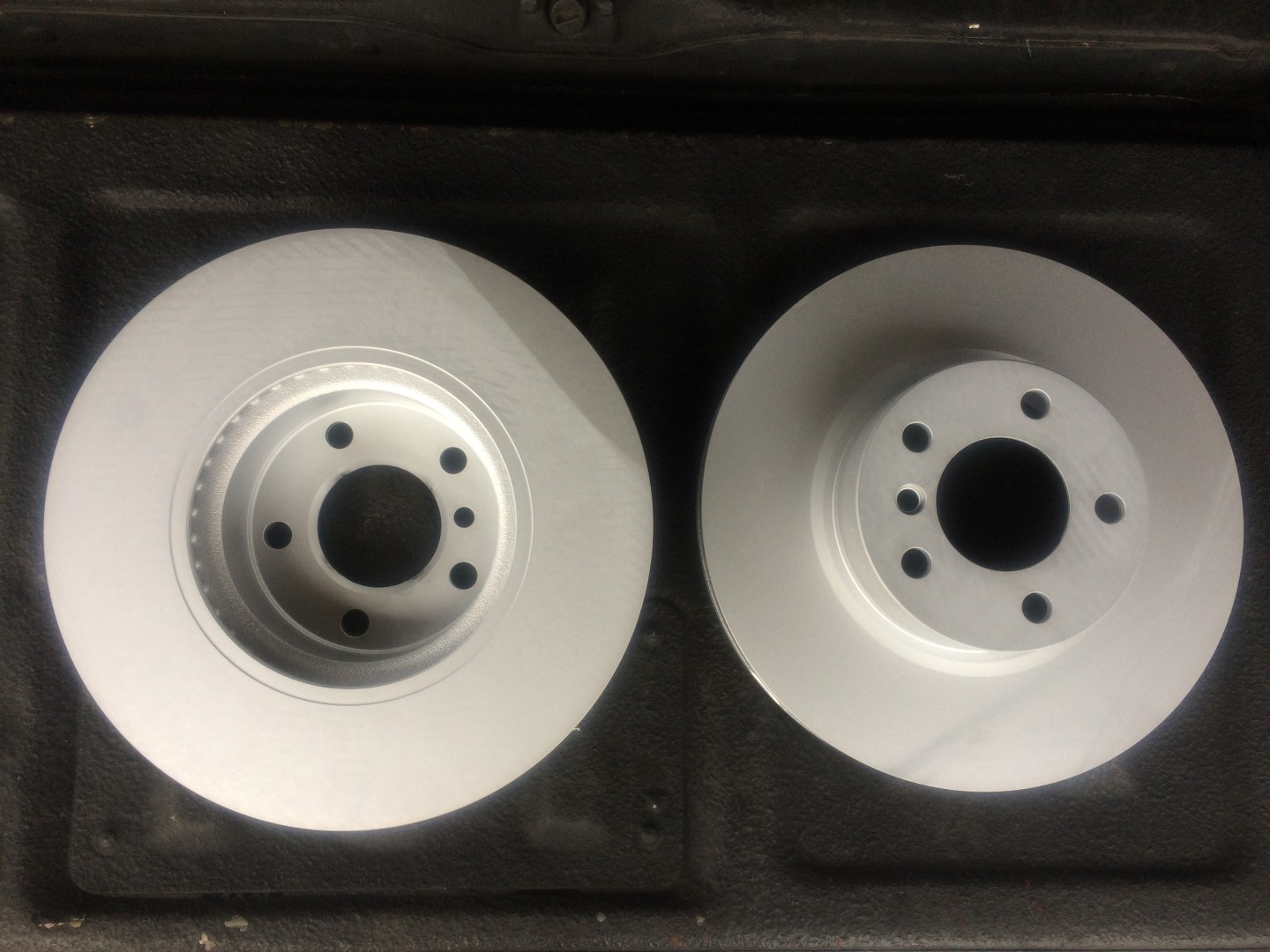

The front brakes were also due now at service time. To me it looked like there was still some decent life left on the pads, however I didn't really want to keep driving the car with it complaining constantly to proceed with caution.
The discs also had a bit of a lip. This car also seems to chew up discs and pads (not sure if it's because of the weight?). Currently it's on 95000kms, and this had been the 3rd set of front discs and pads on the car. The rears are similar, will replace these next year sometime.
So, I purchased new discs, and sent these off to Vari racing for heat treatment and slotting. I'm keen to see if this will improve the lifespan at all. On my Ute, I've done about 35000kms since fitting the big discs up front, and there is hardly any ridge on them. So time will tell I guess.
New front discs:
After heat treatment and slotting:
Pic of the old stuff before stripping:

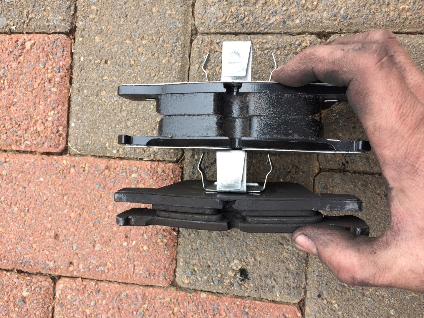

Old pads and the new pads:
Old and new discs side by side:
New stuff fitted:

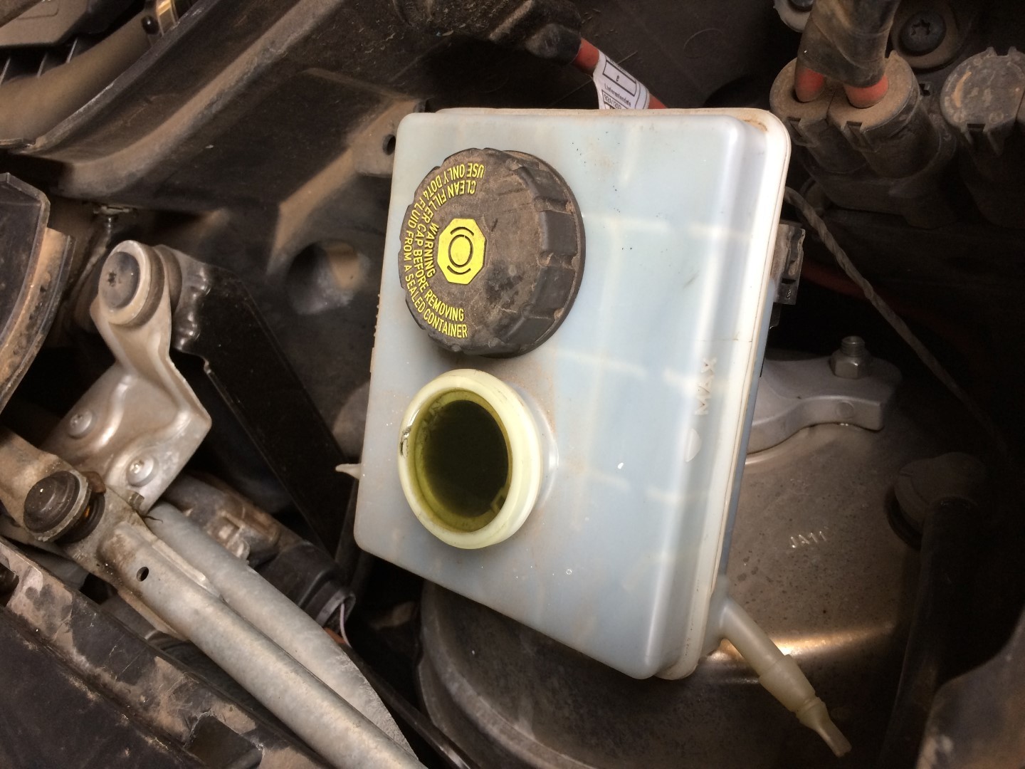

Brake fluid already looks a bit dirty? (allegedly changed in Sep-2016 at BMW):
A quick pic with the wheel back on:
