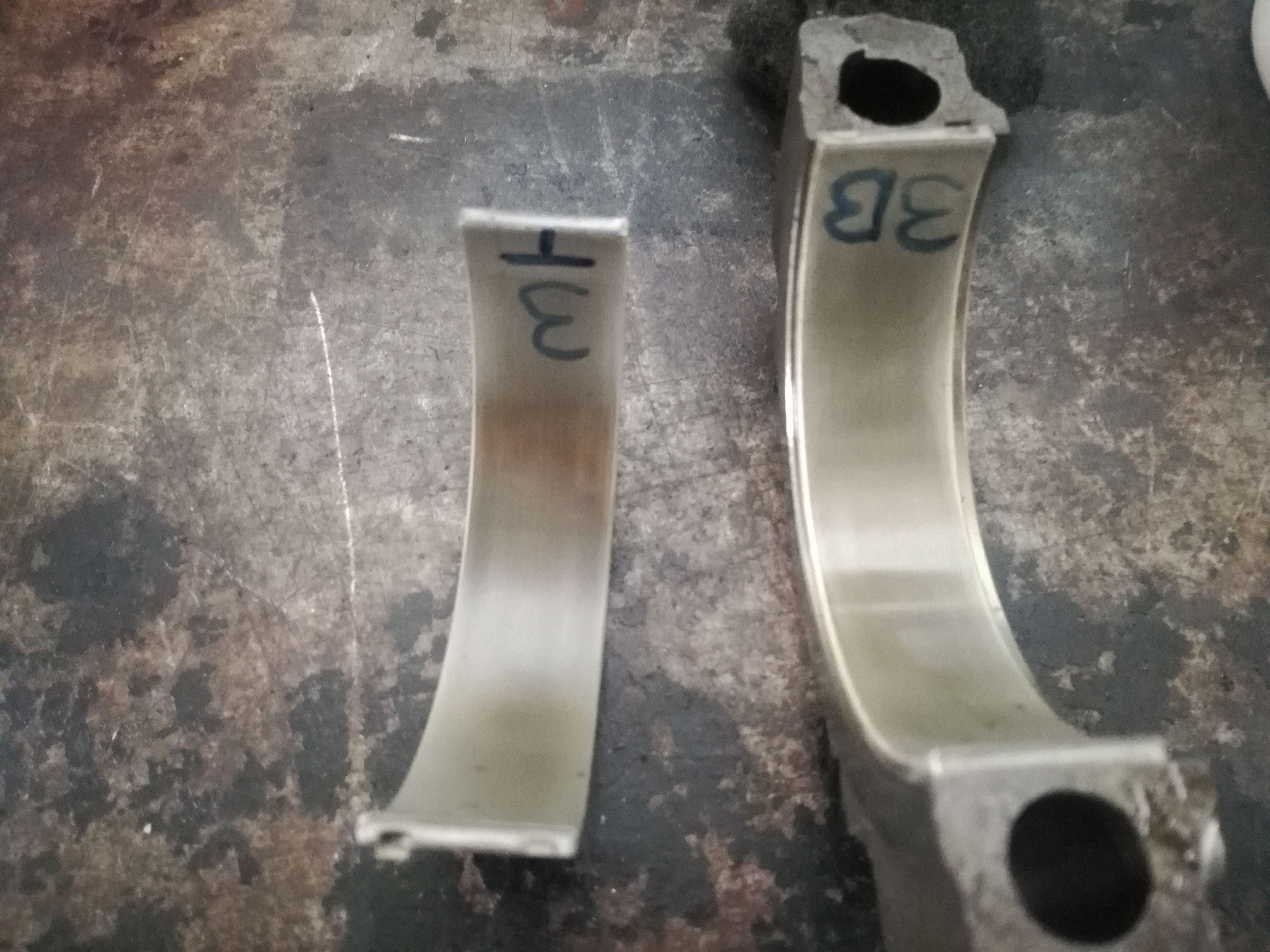

In answer to your questions I would propose that the engine was not driven cold and that oil changes were regular and not as per BMW intervals.
I imagine that this engine was never driven under high load and low revs conditions either.
Given how this engine is I would buy a car from the previous owner no questions.
I would say the first owner also requires a pat on the back. He did 90% of the mileage and while it was under plan he went the extra mile and did the right things.
The bearings look to be in great condition! Well done!
You are absolutely correct.
First owner is equally to be commended for looking after this engine.

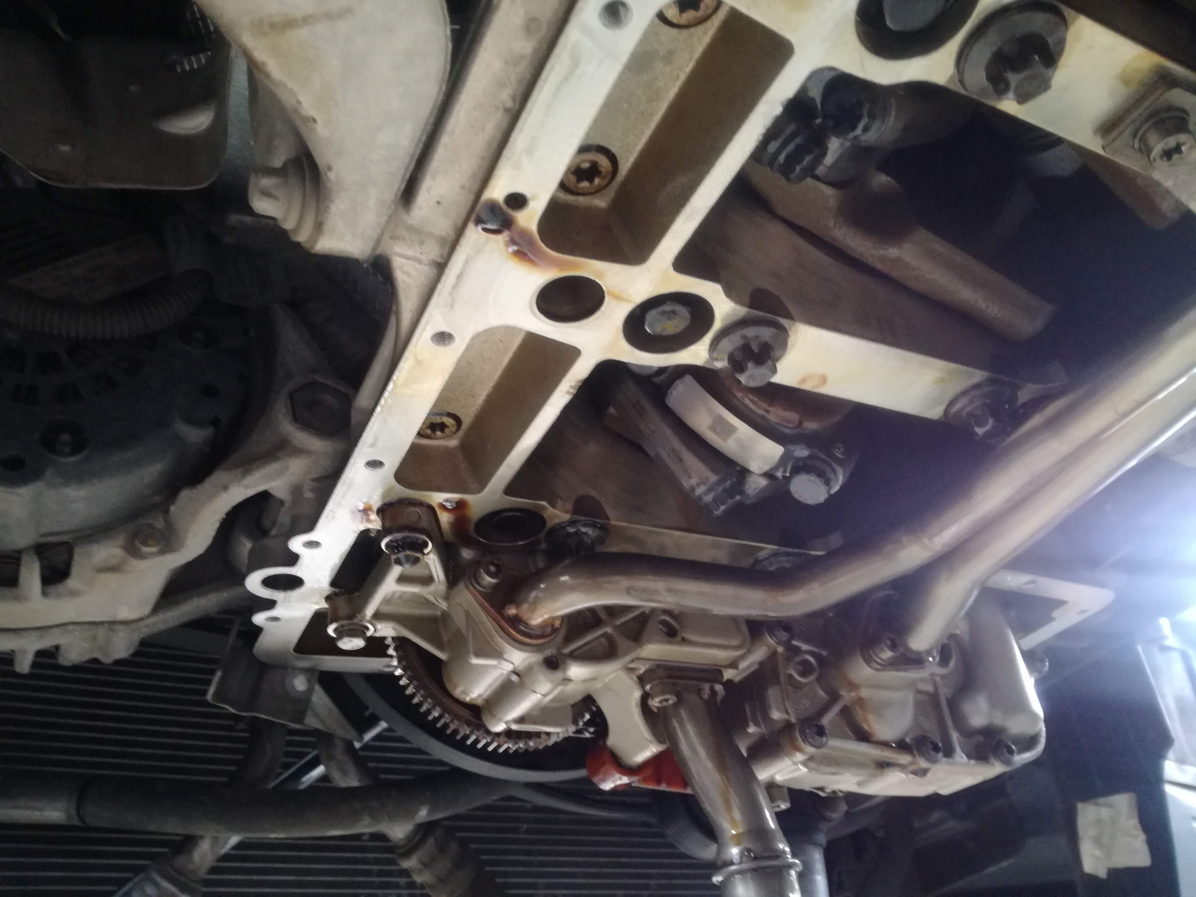

Closed up the engine and did some cleaning.

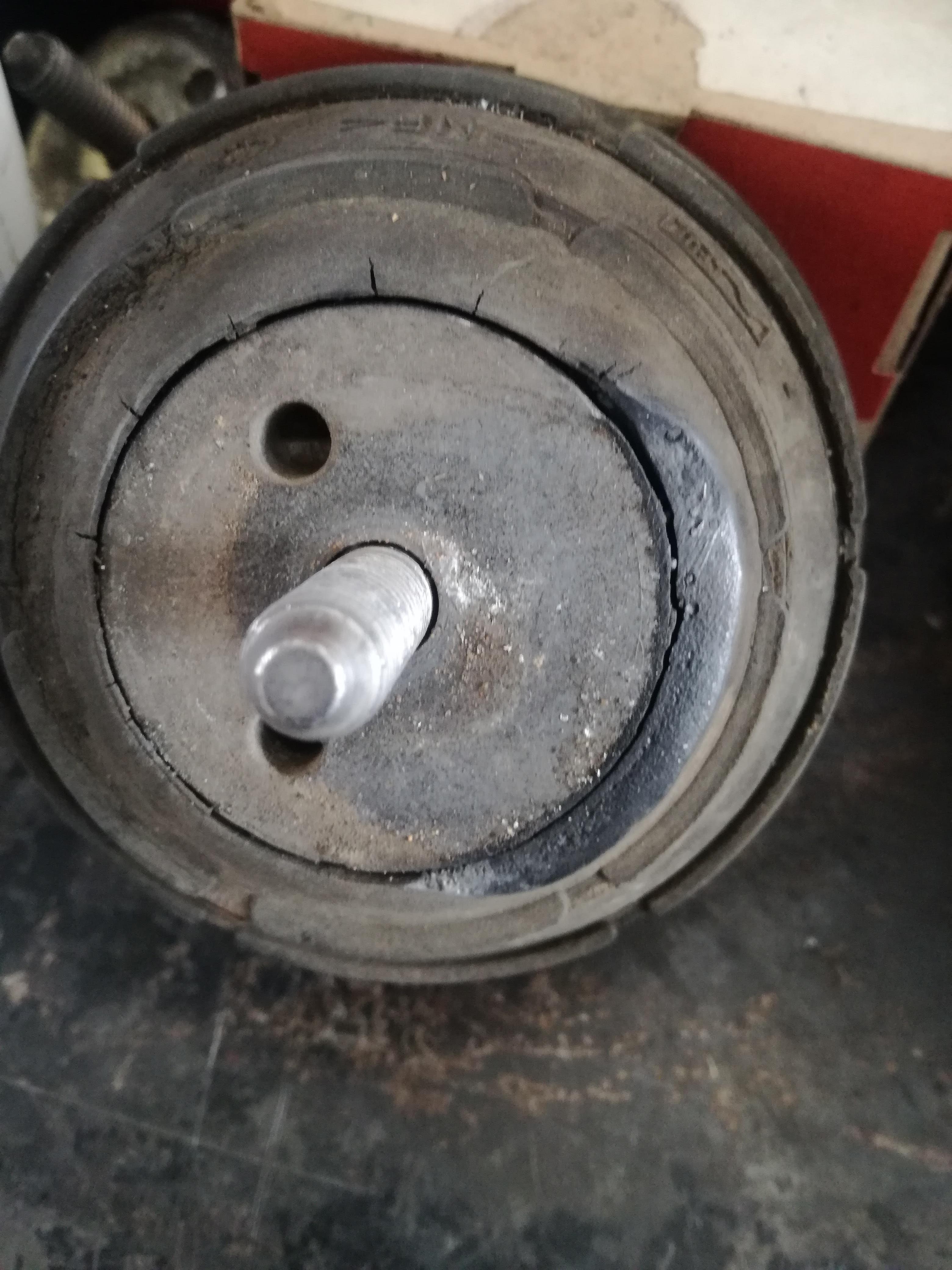

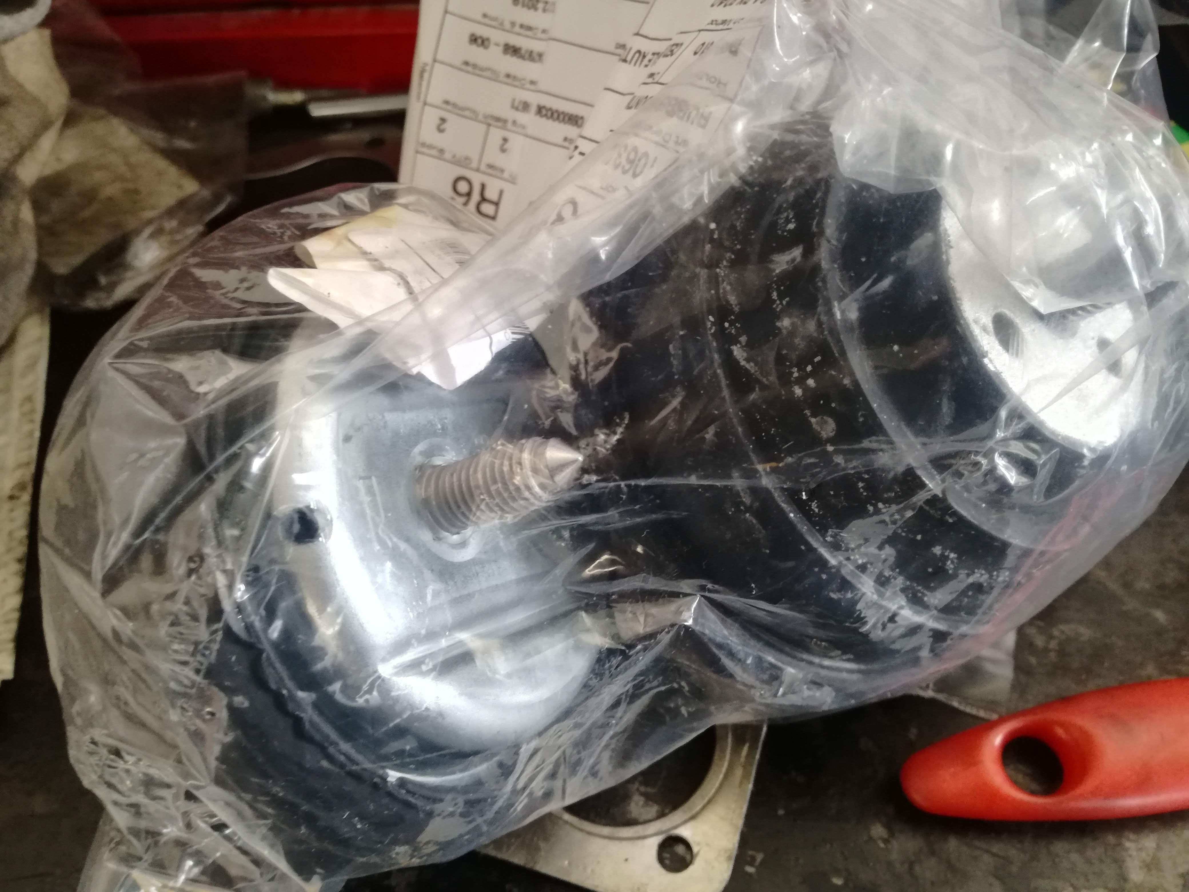

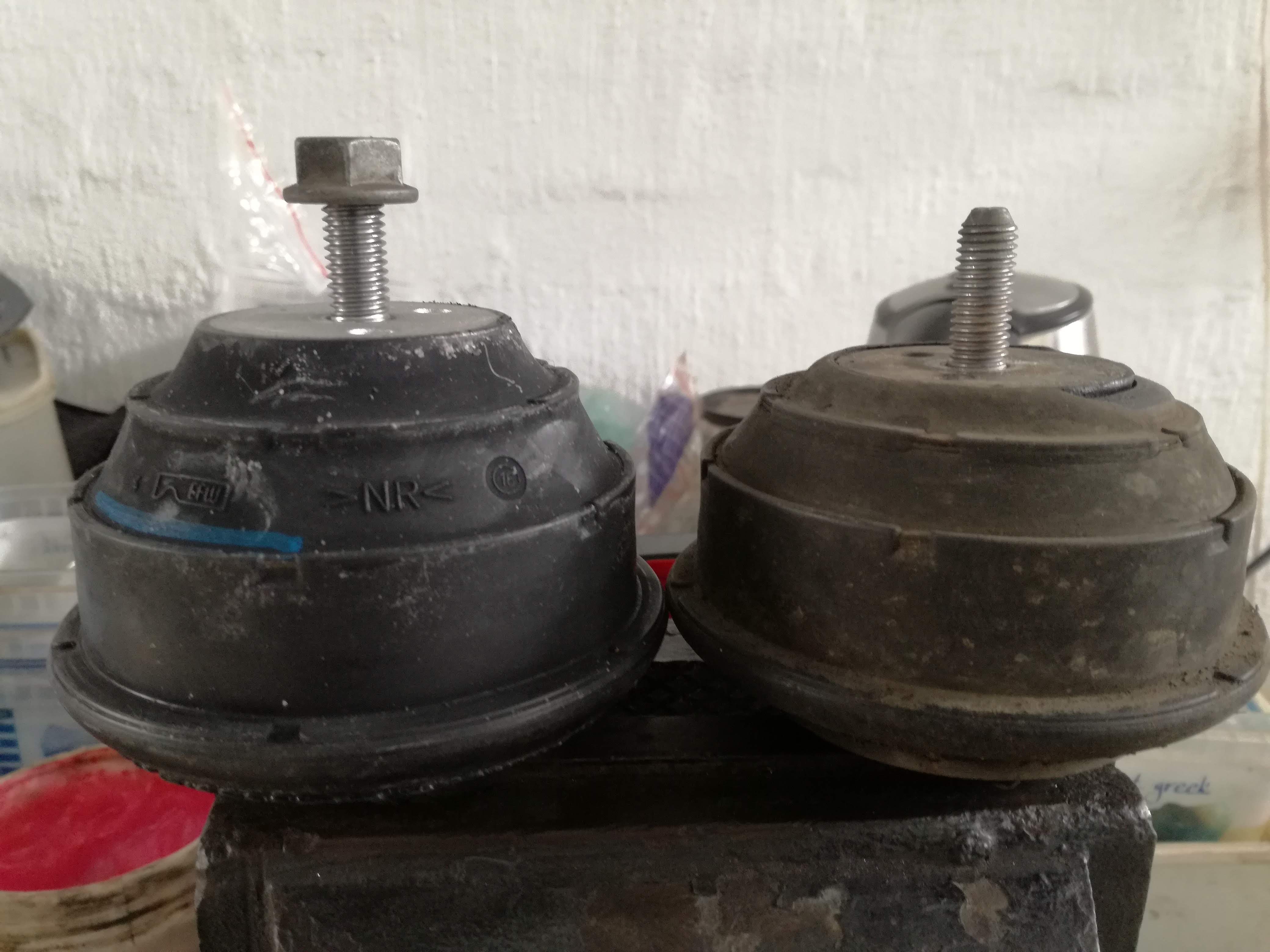

We also ordered new engine mountings given that both the old ones were broken.

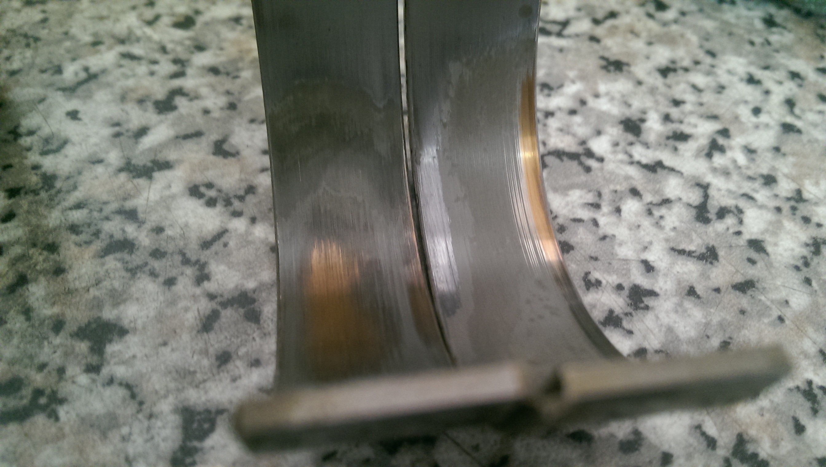

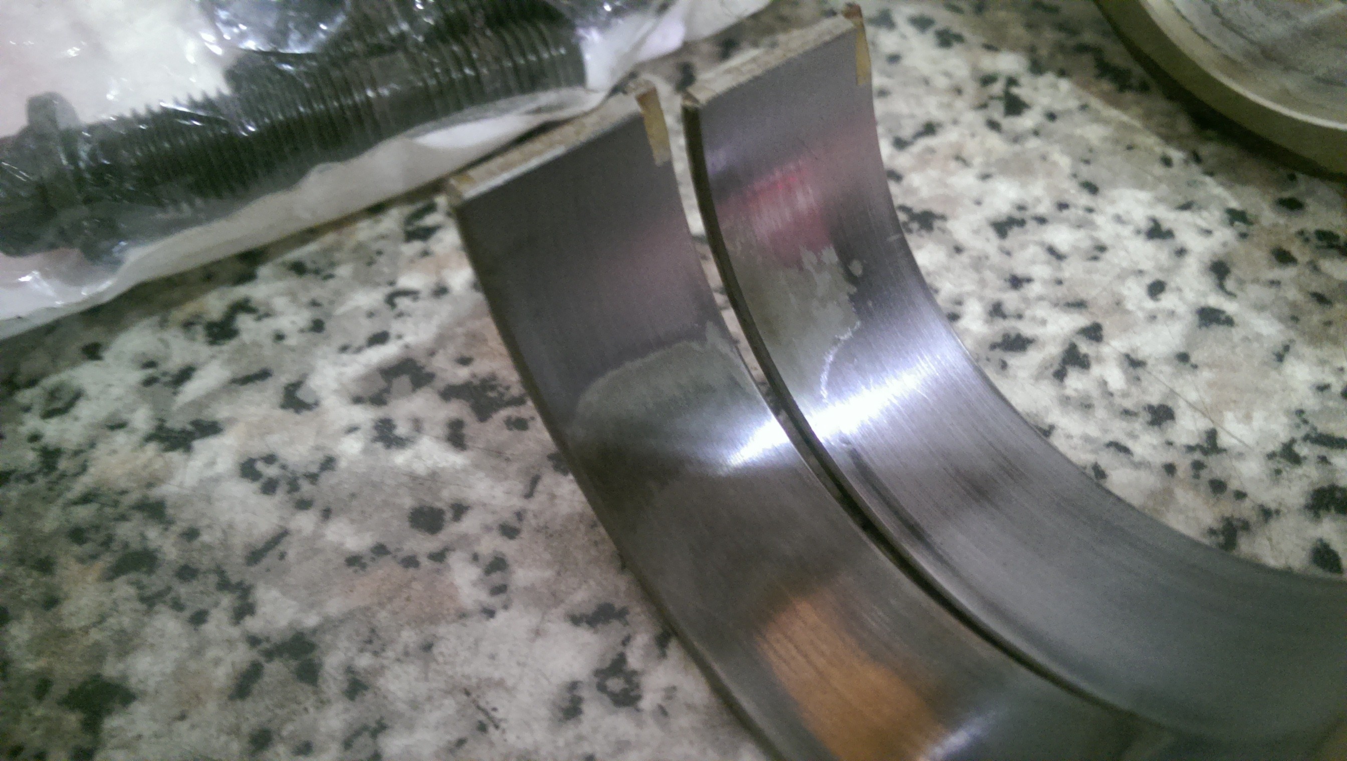

@Peter@AEW been thinking about those bearings:
It seems like the Grey ‘Coating’ later has just about depleted, and the copper layer is starting to show.
When you say it’s got 70 000km still to go, does it mean that it can safely deplete the copper layer too?
Peter@AEW
Not at all
The bearing surfaces are uniform with no divets and the coating is starting to wear.
Look at this by comparison
Compare these photos with the ones below
Arbee
Peter@AEW said:
@444YYY look at Arbee's thread on what 80k bearings look like and compare to the bearings here
https://www.bmwfanatics.co.za/showthread.php?tid=89114&page=6
Good job Shiroo and previous owner, those bearings look brand new compared to not only the ones out my car but in general at that km.
Thanks for posting Peter. Gav, im sure the piece of mind knowing that you not only have a gem but a gem with new bearings is substantial!

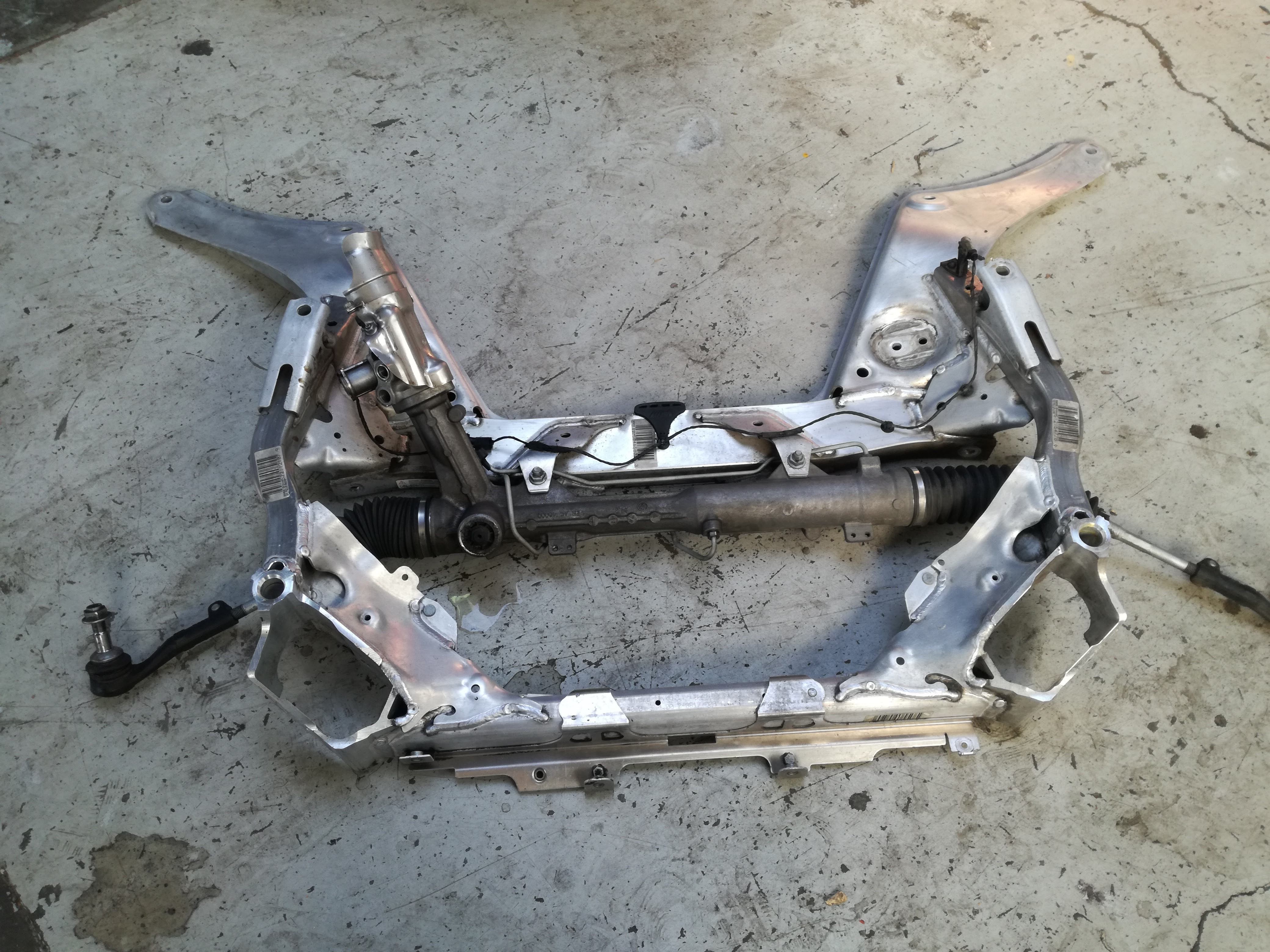

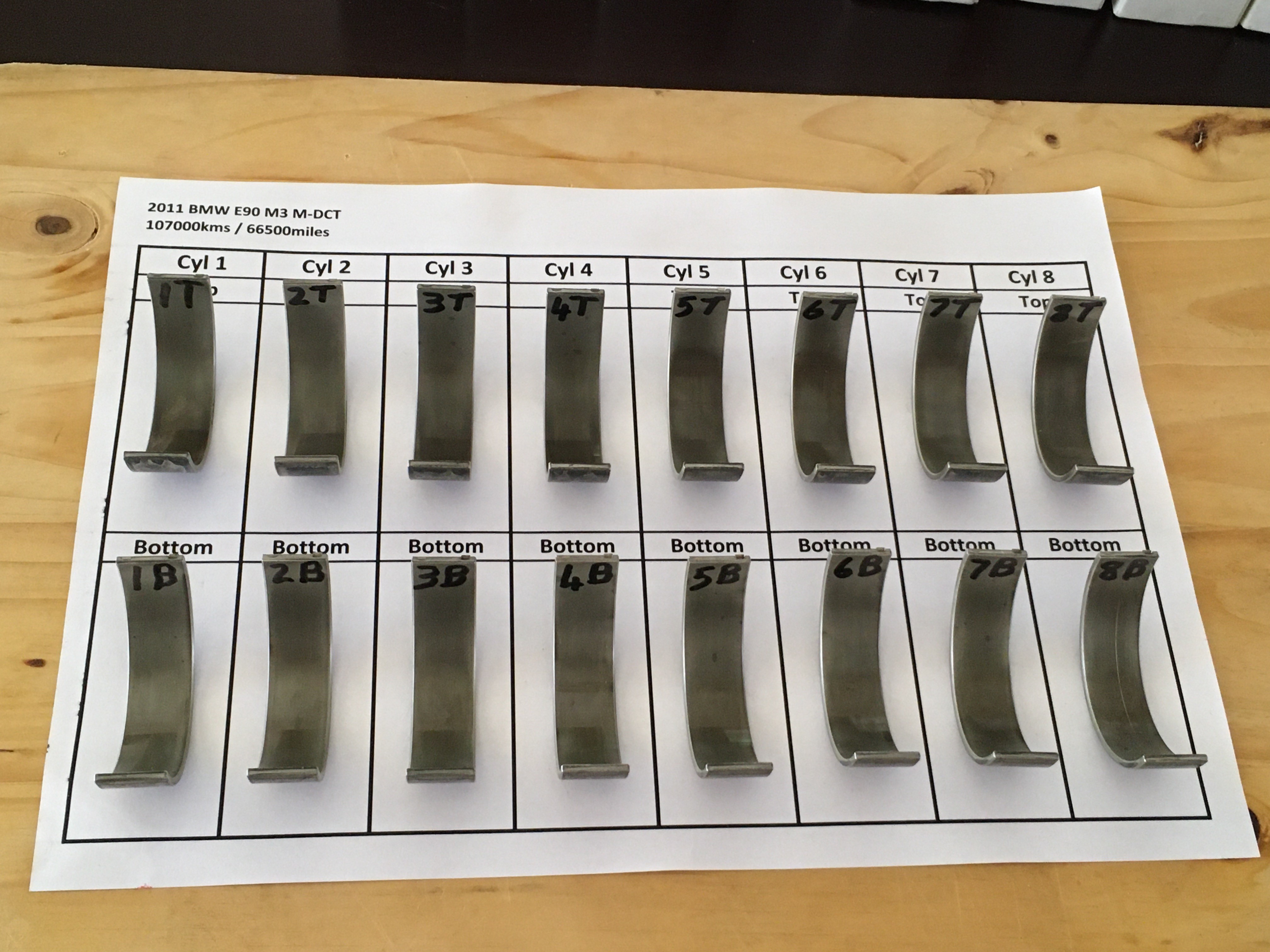

Over and above the rod bearings. I had my suspicions about replacing the engine mounts (also seeing as the sub-frame comes off anyway), but didn't order beforehand. Once stripped down, one mount was KO and the other was also looking a bit sad and collapsed slightly. So new mounts were ordered and installed. There was also a plastic bracket missing which secures the oil cooler pipes, so this was also ordered and fitted. In it's past life, the radiator must have been removed at some point and installed incorrectly (skew), but this was rather easy to rectify, and minimal financial outlay - let's say things came to fruition.
Here's a summary pic of all the rod bearings:

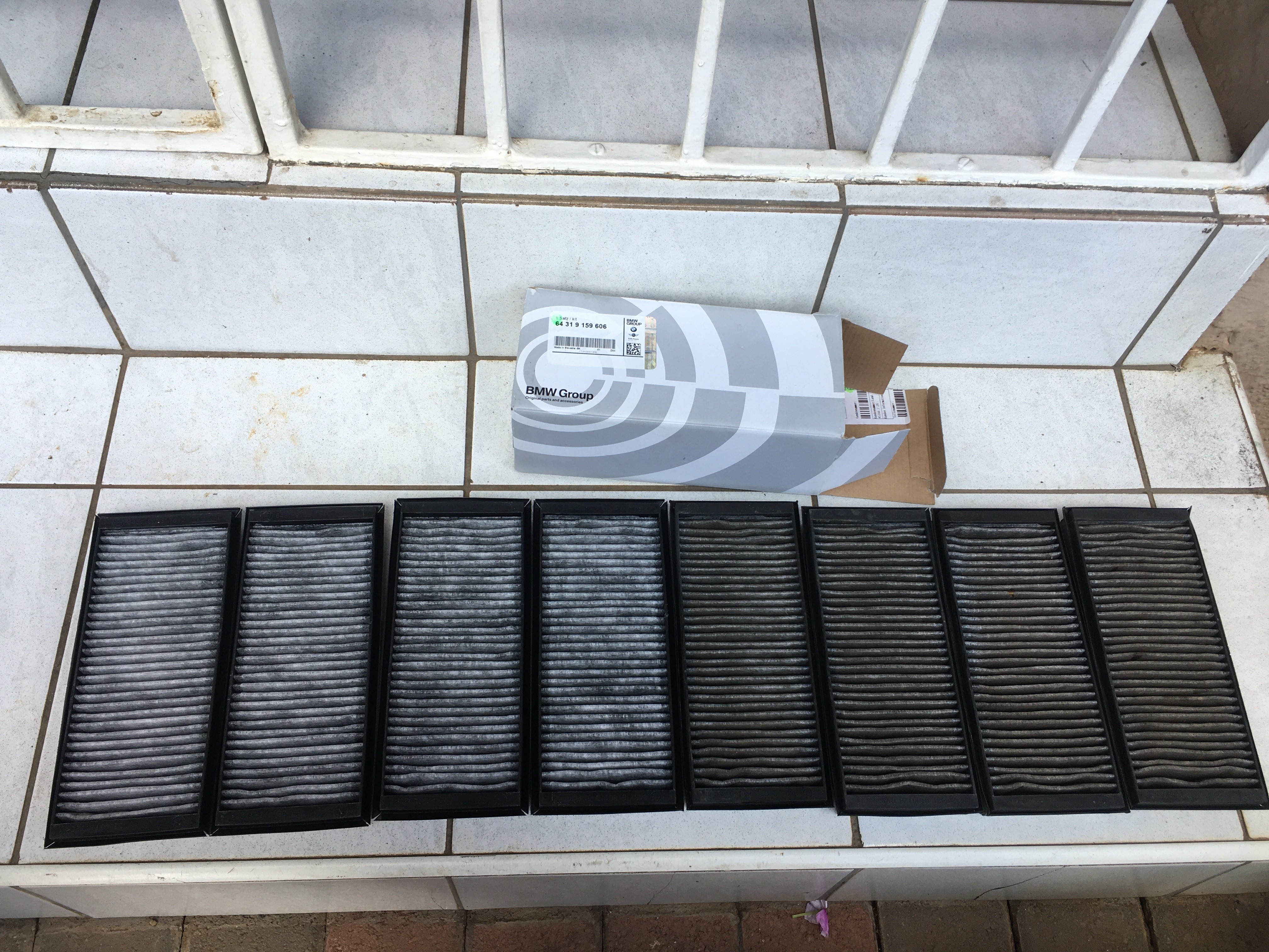

Also, shortly after getting the car back, I replaced the cabin air filters. The ones which came out had done approx. 20000kms:
Other than that all is good. Will post more updates again soon....

Lovely stuff!
Those bearings actually look pretty damn decent considering, but I am sure you are chuffed that is now done!
Pretty much every e92 M in existence now is just about in need of this soon. Peter is in a great business haha
Kyle
Awesome stuff bud... Those bearings look amazing, perhaps those were the newer bearings with the more resilient material?

Yes correct. I don’t know the exact composition but from what I’ve read the earlier bearings were copper and lead, and then the newer bearings (2009 onwards) are aluminum and nickel.
