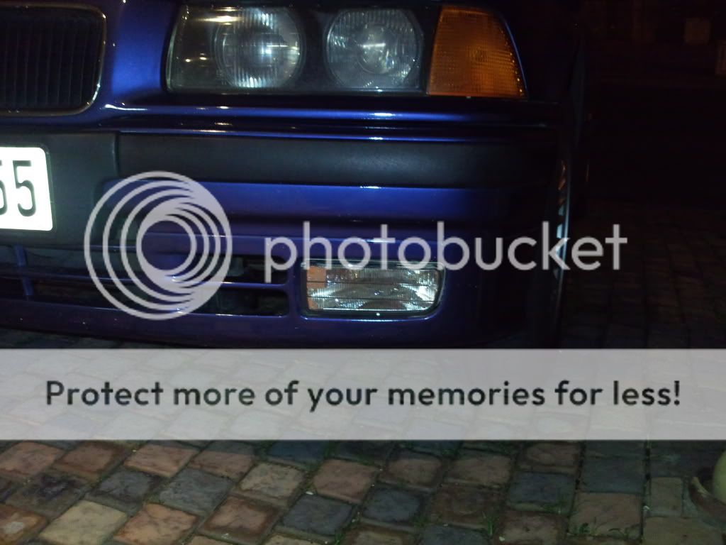

Ironblaze94, I got the switch from Motorem in Parow industria. You will have the 1 button switch next to the headlight switch, you pop that out, and plug the two button switch in. The car is pre-wired for it, so you will have no difficulty.
If you run your finger along the bottom edge of the airvent/ switch, you will find a star screw. Take that out, and the whole vent with switches will come out. You will then be able to disconnect the wireplug, pop out the 1 button switch, pop in the 2 button switch and voilla.[/align]
