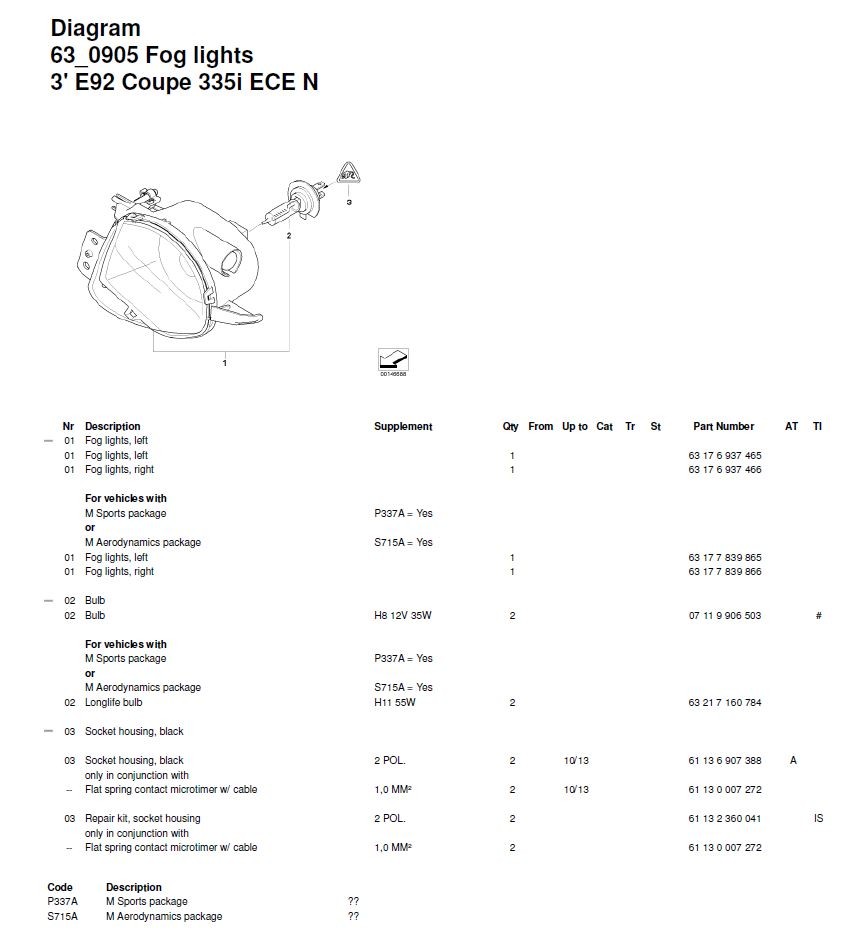

JG_RSA said:
Don't know if this helps you out at all.
I have no experience with this whatsoever, but this is from the parts diagram.
If you PM me your last seven digits of your VIN, I'll run that and see what's on your actual car from the factory.

I noticed H8 and H11 Listed.
my last 7 digits are PY13984

If my memory is correct than I think it is a H11/H8, If you can post a closeup pic of the fog showing the bulb then I can advise you ,
NB , you can take a pic from the front of fog and don't have to strip it off
Woodies
H8 or H11 will both work, same fitting. I changed mine. Just a straight bulb swop. Get the Phillips or Osram. The cheapy China town ones only last a month or so. Paid R750 for a set maybe about a year ago.
