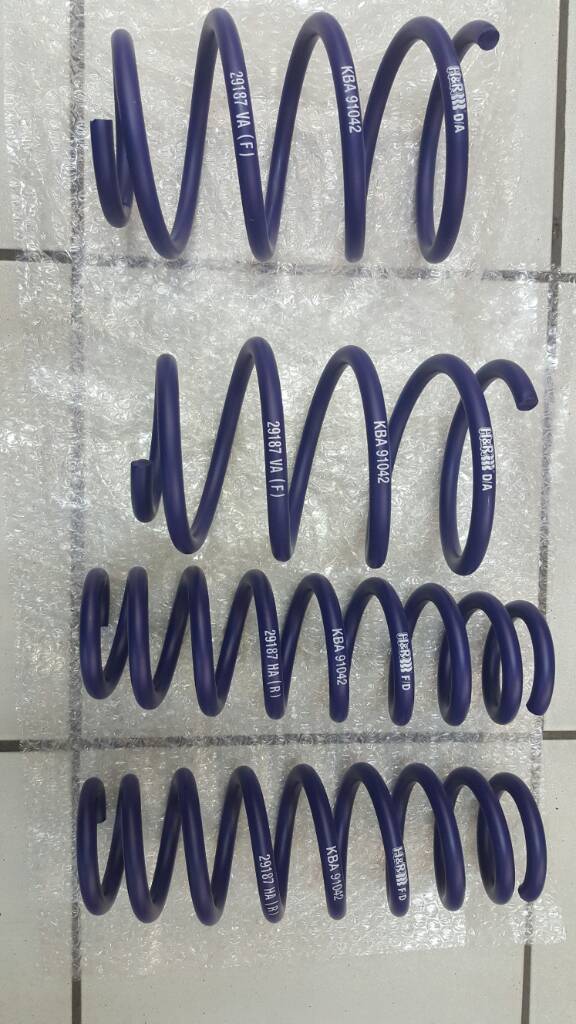

Finally pulled the trigger and decided to get some H&Rs for the car. Erks me that it sits so high.
Will install in this coming week

So keen to see how she sits after the springs are installed. How much did you pay and where did you get them from? I wonder what difference it will make from the M Sport suspension.

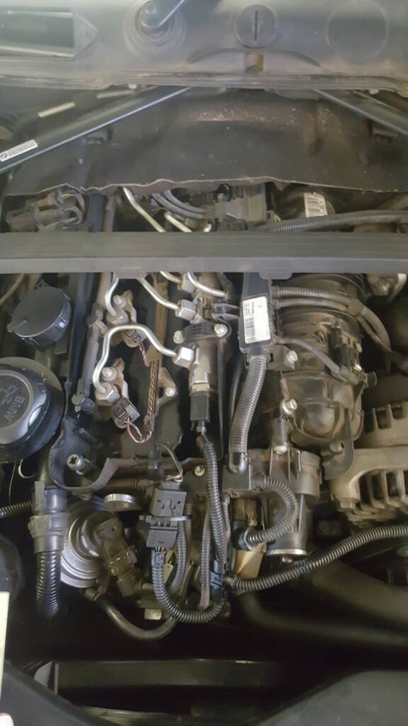

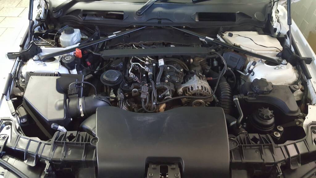

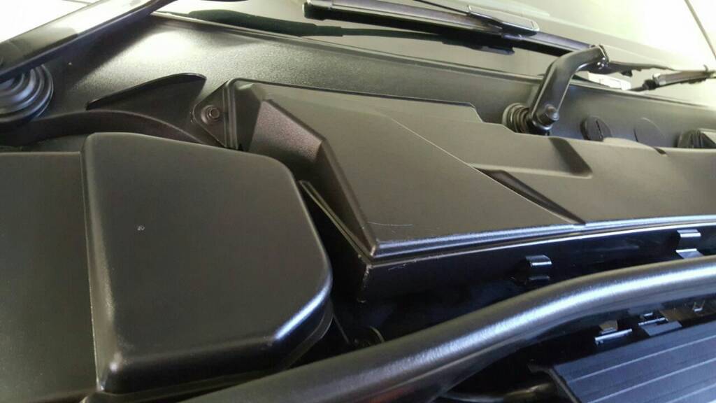

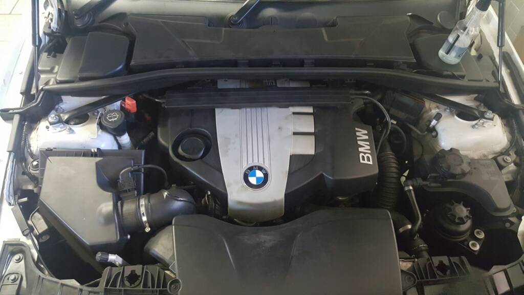

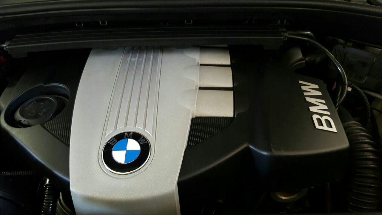

Spend the last 2 Sundays working on the 120d and cleaning it up.
Work involved....
- Engine bay clean.
Products used were from Moe Crazy Rides.
*Meguirs All Purpose Cleaner ( APC)
*Meguirs Trim detailer.
Before:

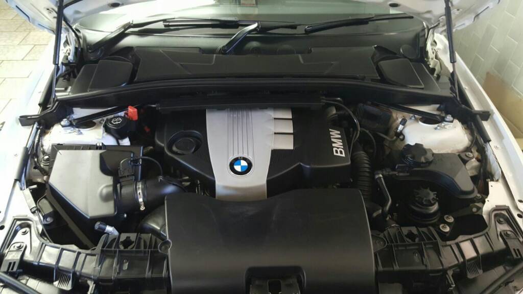

After :

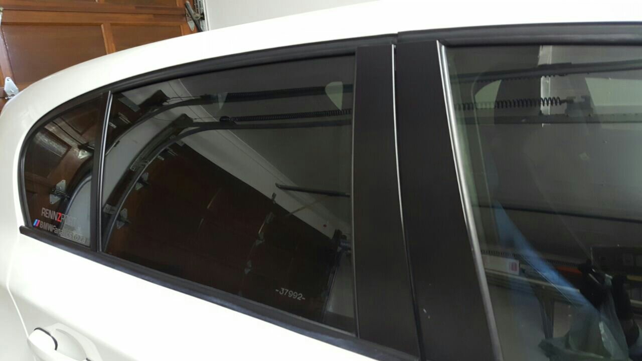

Also applies AF Revive to all the rubbers on the car, this brought them back to black.

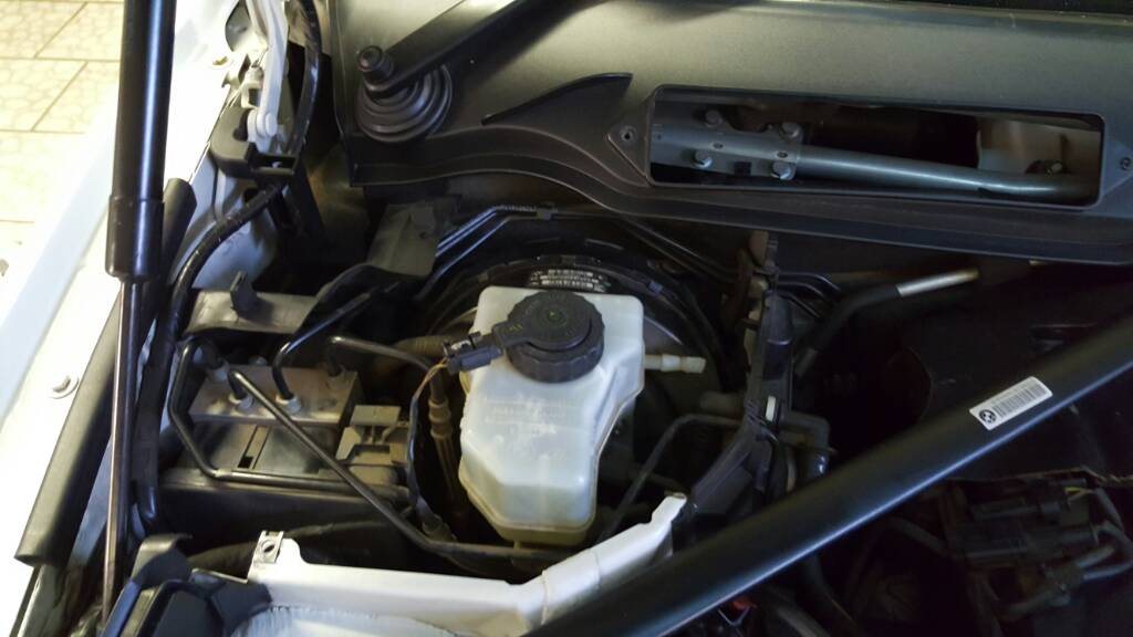

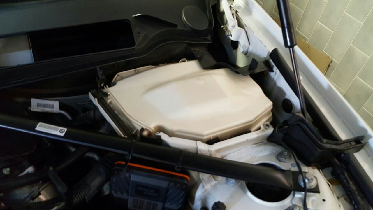

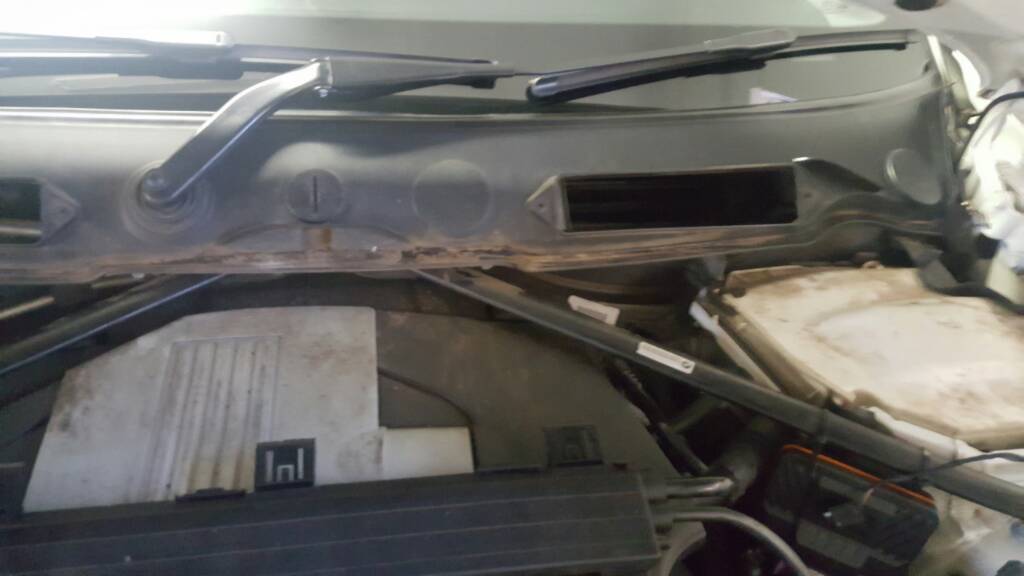

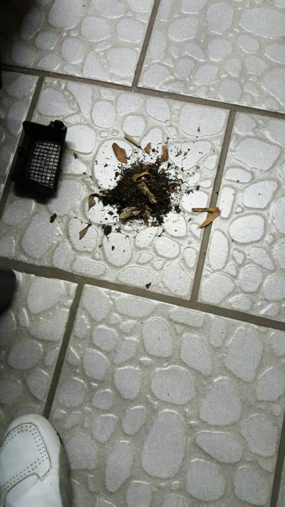

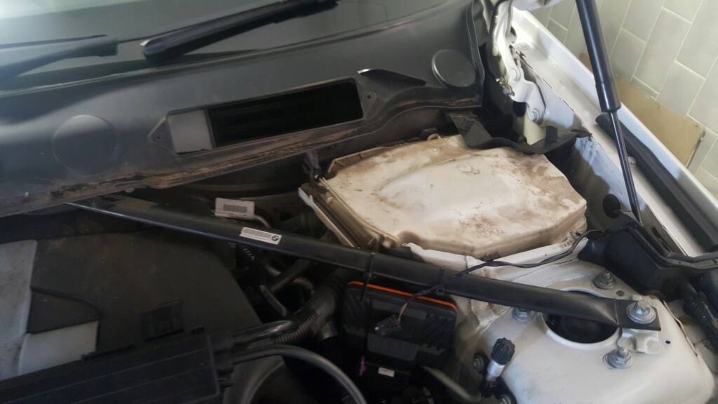

One thing that Gert from OBDWORX suggested is to clean your leave catches, but more so to remove the plastic catcher and check is its blocked underneath. I've always taken this for granted and boy was I relieved he gave that advise. If clogged, you run the risk of water collecting and overflowing into your ecu box. I would recommend everyone does this...specially E series guys.
Cleaned it out and stuck a vacuum inside for good measure. Then threw some water down to check it flows out quickly.

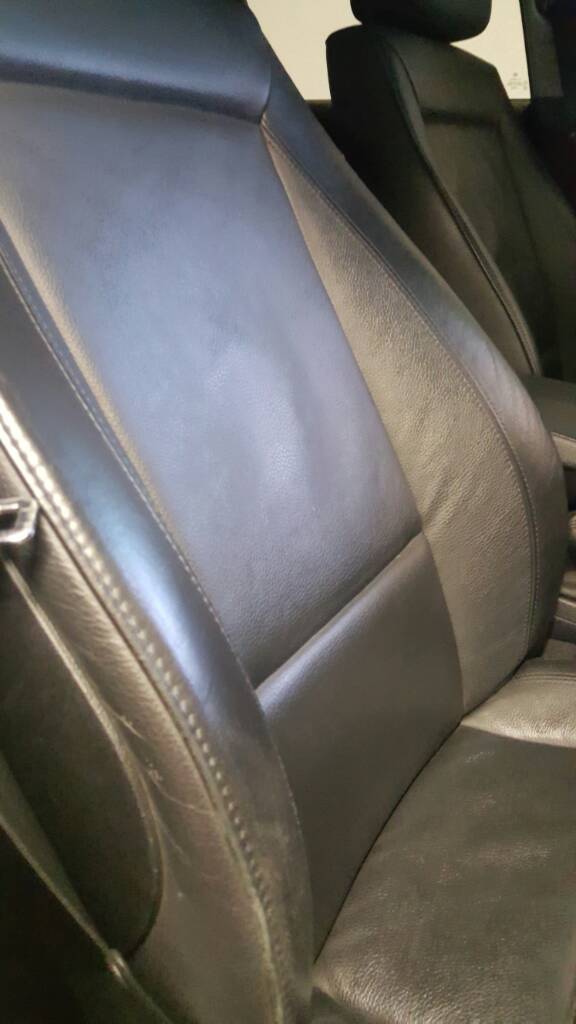

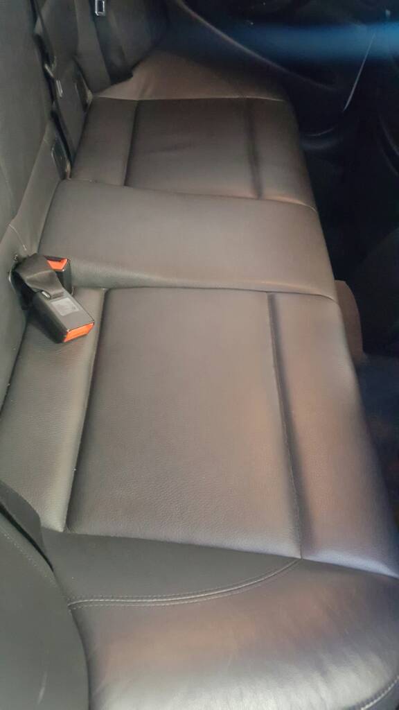

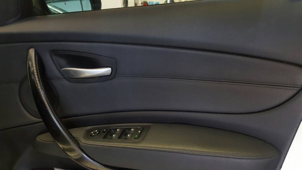

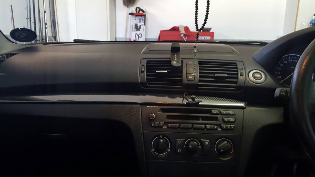

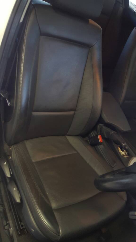

Yesterday I got to tackle the interior of the car
Cleaned up the all the seats and applied Collonite which I've been using from Crazy Detailer. Use Megs trim detailer on the plastics again.
Don't have any before pics as phone was charging.

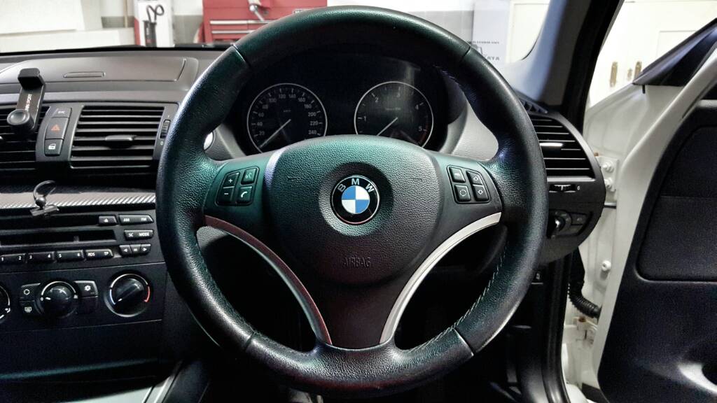

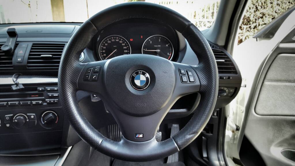

Whilst I was working on the interior...I remembered I still had my Msport steering from the 335. Took and out and perfect fit onto the e87...
The Msport wheel is much thicker and softer, inspired confidence...not that a 120d requires it
Before :
After:

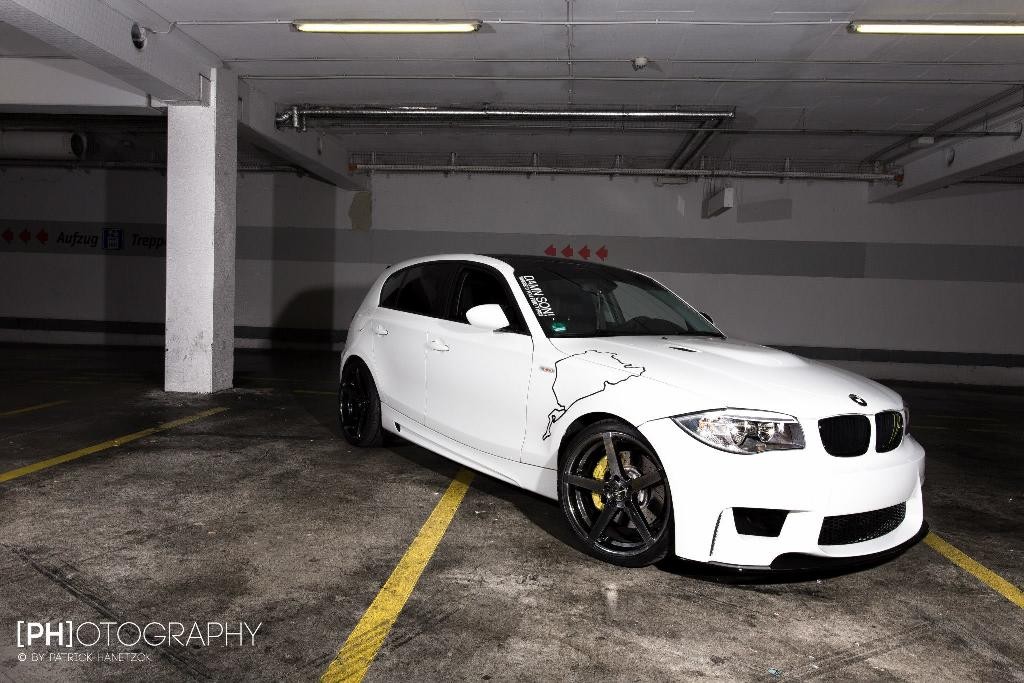

FiRi@Rennzport
tyronejames said:

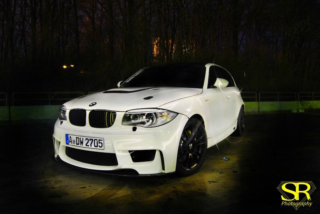

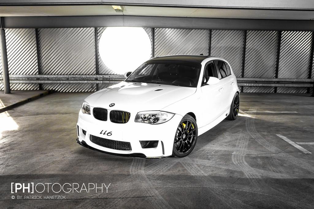

Just some inspiration :rollsmile:
Firi's upgrade stages :=):
Lol...that was the plan when I bought the car. We had no stock of the bumper when I bought the car hence I went 135 bumper. But daym...it looks sweet.
