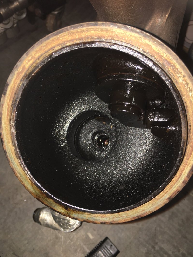

Cat was full of oil , Not too full as leaking out in gushes full , but there was oil in it . The turbo was about the same , I guess because we didnt run the engine after the first sign of smoke , that probably limited the amount of oil that would have gone into it , The O2 sensors at the back seemed ok , but the one at the front is caked in oil . I will attempt to clean both .

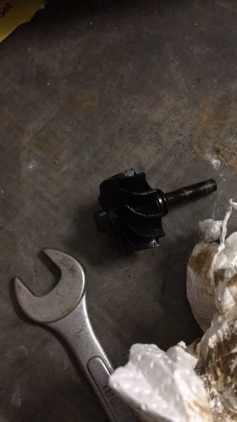

After taking off the cat , a small swirl (turbine?) fell off out of it . So this is where im at with the F30 and its turbo issue .

This fell out of the front part of the cat , by the piece that attaches to the turbo , isn't this shaft supposed to be connected to the front turbine? Has it broken in two?
This is inside the turbo where the turbo attaches to the cat , I think the turbine goes in that hole .

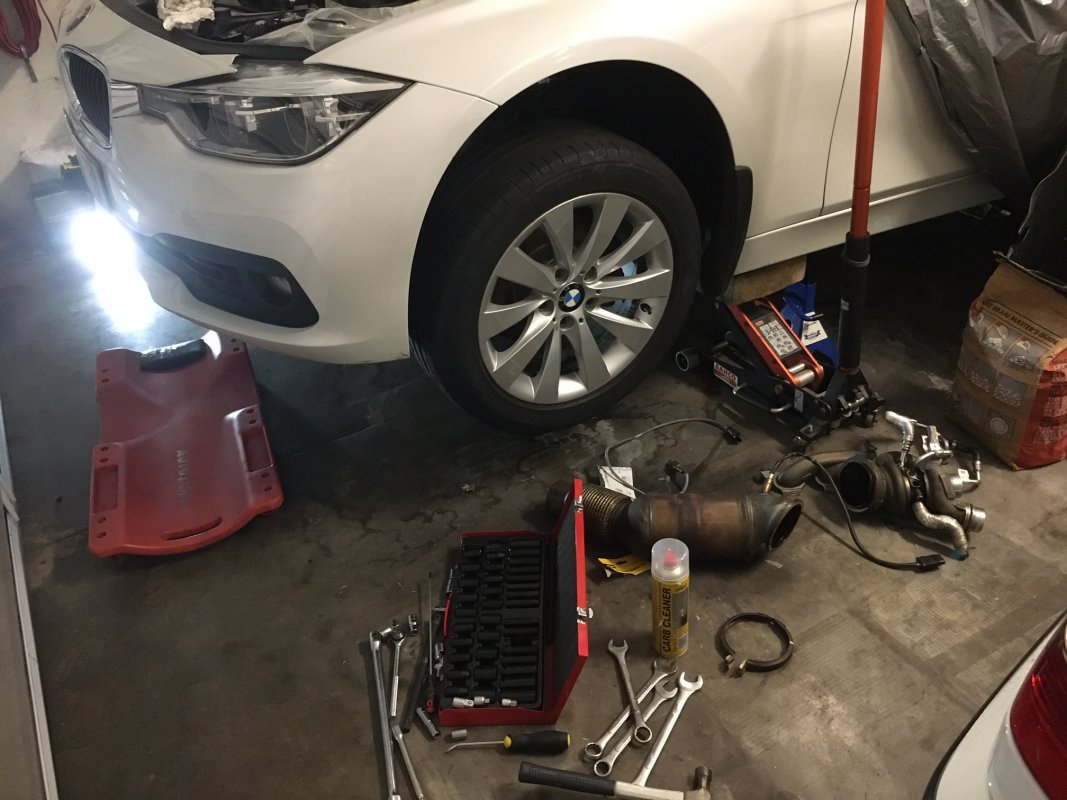

This is the mess I have made in my garage lol , there is the cat and the turbo out .
I feel as if Iv accomplished something today .

Eina, yup your shaft broke, hence having oil everywhere , could soak all your parts in paraffin or diesel it cleans out oil quite well. Gabby from fastec should be able to help with repairs on the turbo, replace oil feed and return lines on installation. Things also to remember on turbo cars, after driving hard do not switch off engine immediately, idle for a while, these shafts spins at a very high rpm when boosting and take some time to slow down. If engine is switched off there is little to no oil going to the bearings and this also causes the shaft failures.

@Gordvisr Yup it does look like the shaft has broken in two , Do you think the Turbo can be saved? I cant see any damage to the housing , im assuming a rebuilder will replace all the inner pieces . Fastec is in Jhb I think , would love to have sent it there but its a little far , Im in Durban , and the guys at BMW advised me to take it to Turbo Exchange in Prospecton .
