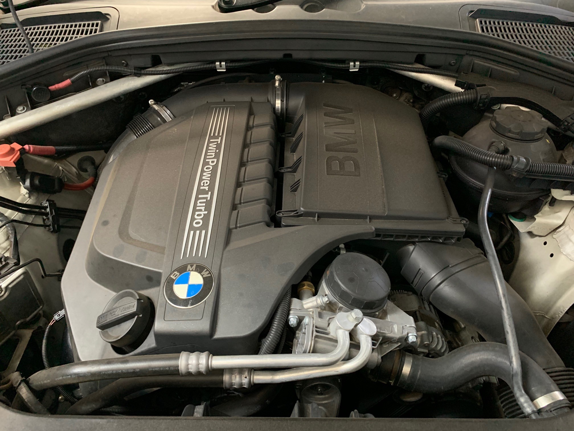

Hey guys!
So, I took the X3 in for a oil change, but decided on doing the rest of the service myself (it's out of motorplan), which I will do shortly.
Just wondering if there is anything particularly tricky or that I should watch out for when I do this? I haven't tried messing with the N55 as yet...
Basically, will be looking to do the following as per the notes:
- Plugs (apparently needs a special thinner tool)
- Air filter
- Micro/cabin filter
- General check
Brakes were done recently, and the Oil filter/Oil just been done by BMW JSN (who were fantastic by the way - exceptional service received)...
Any things to look out for/tips would be appreciated.
Thanks guys...

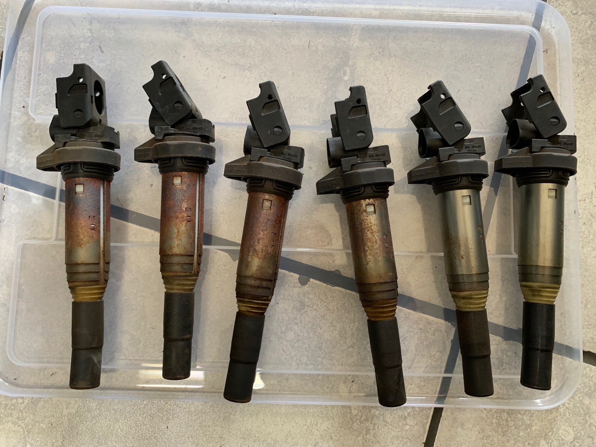

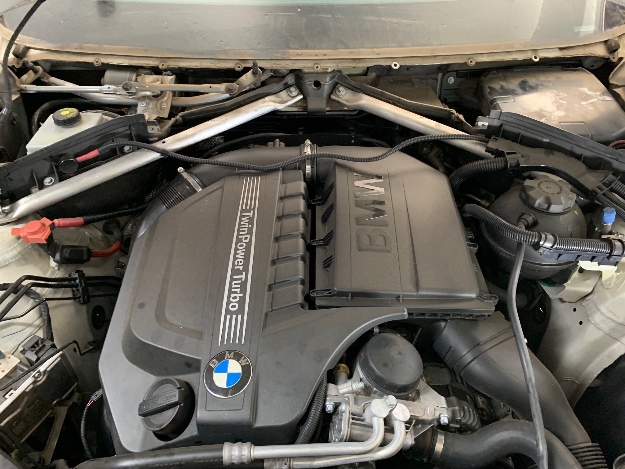

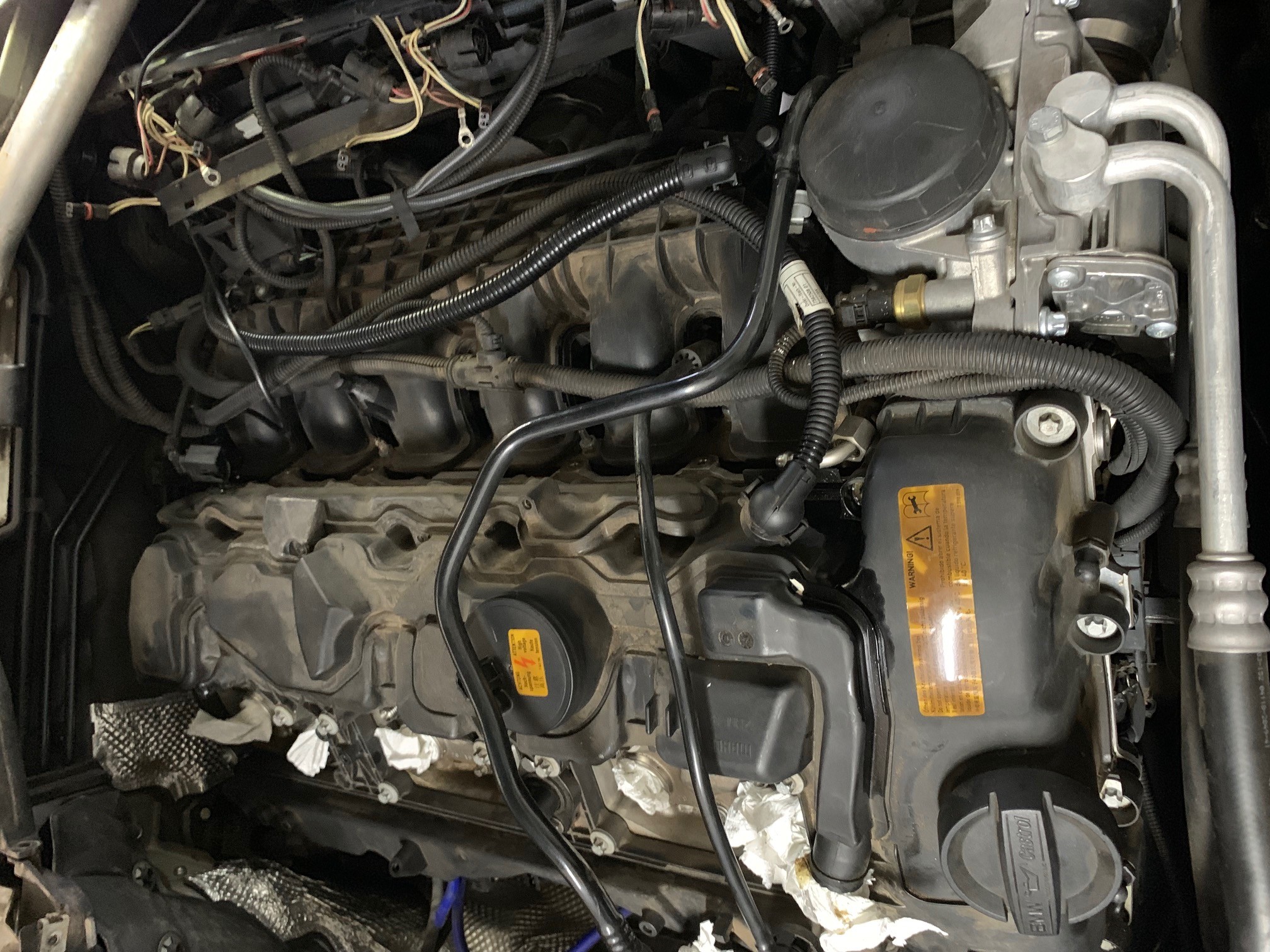

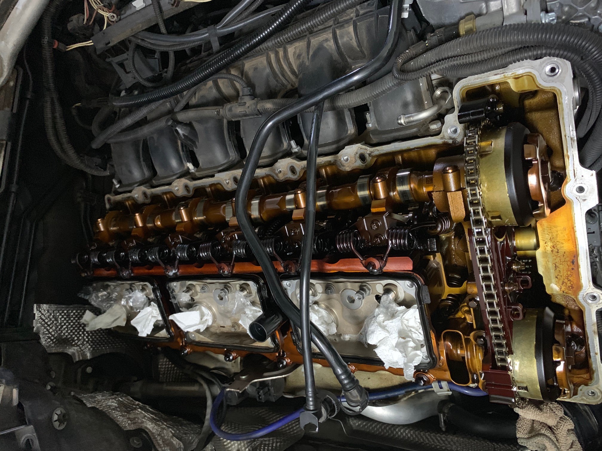

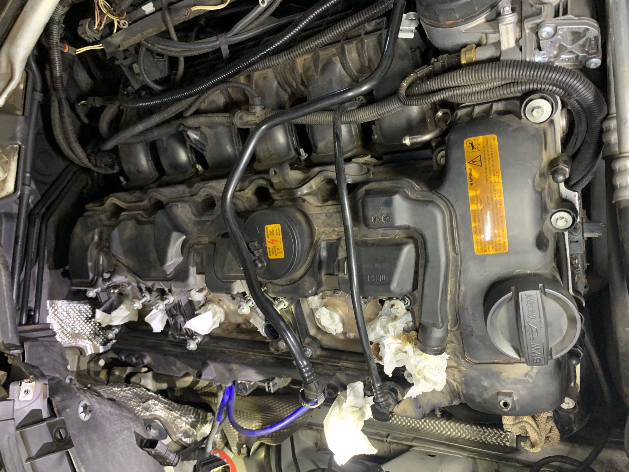

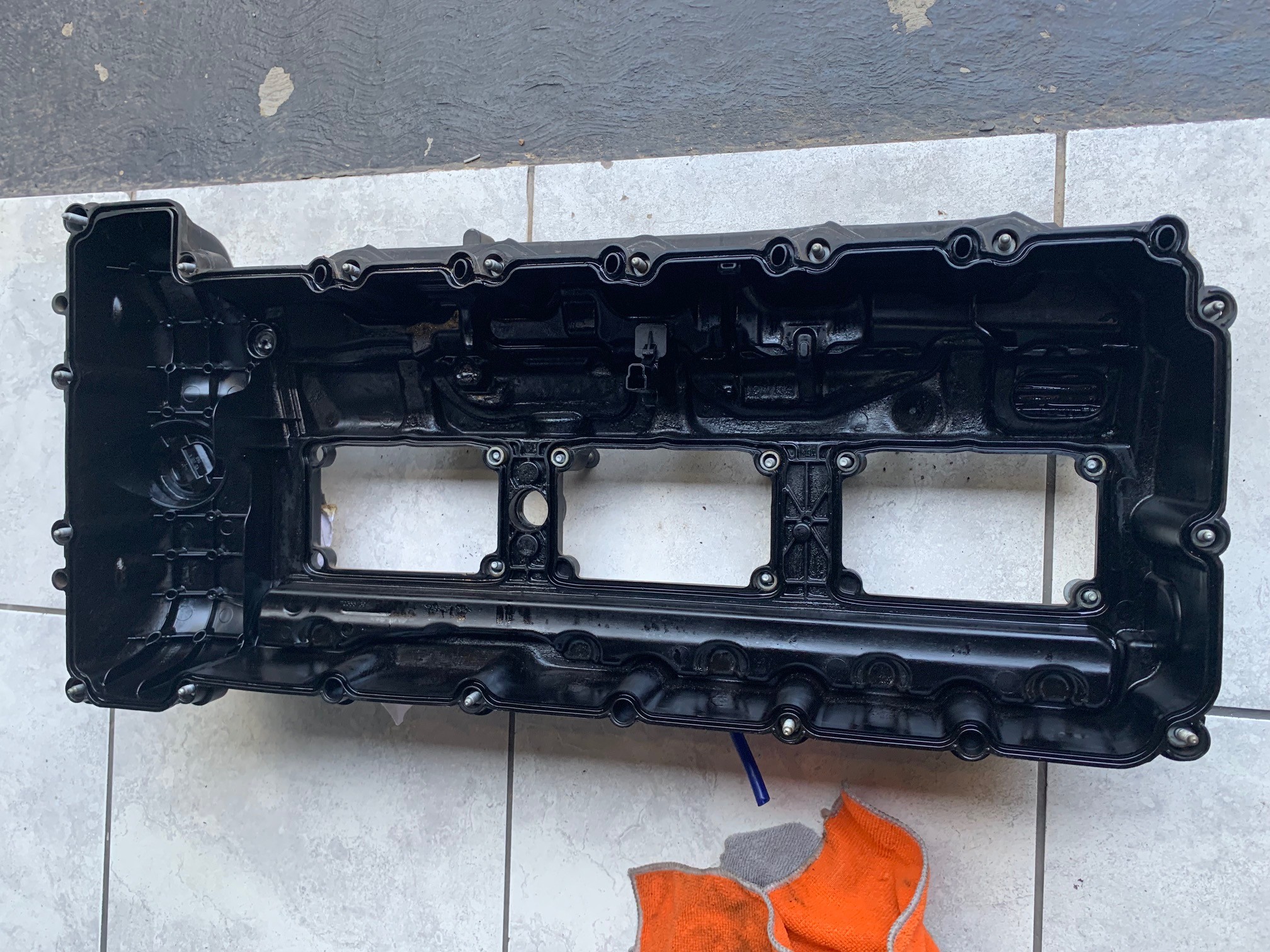

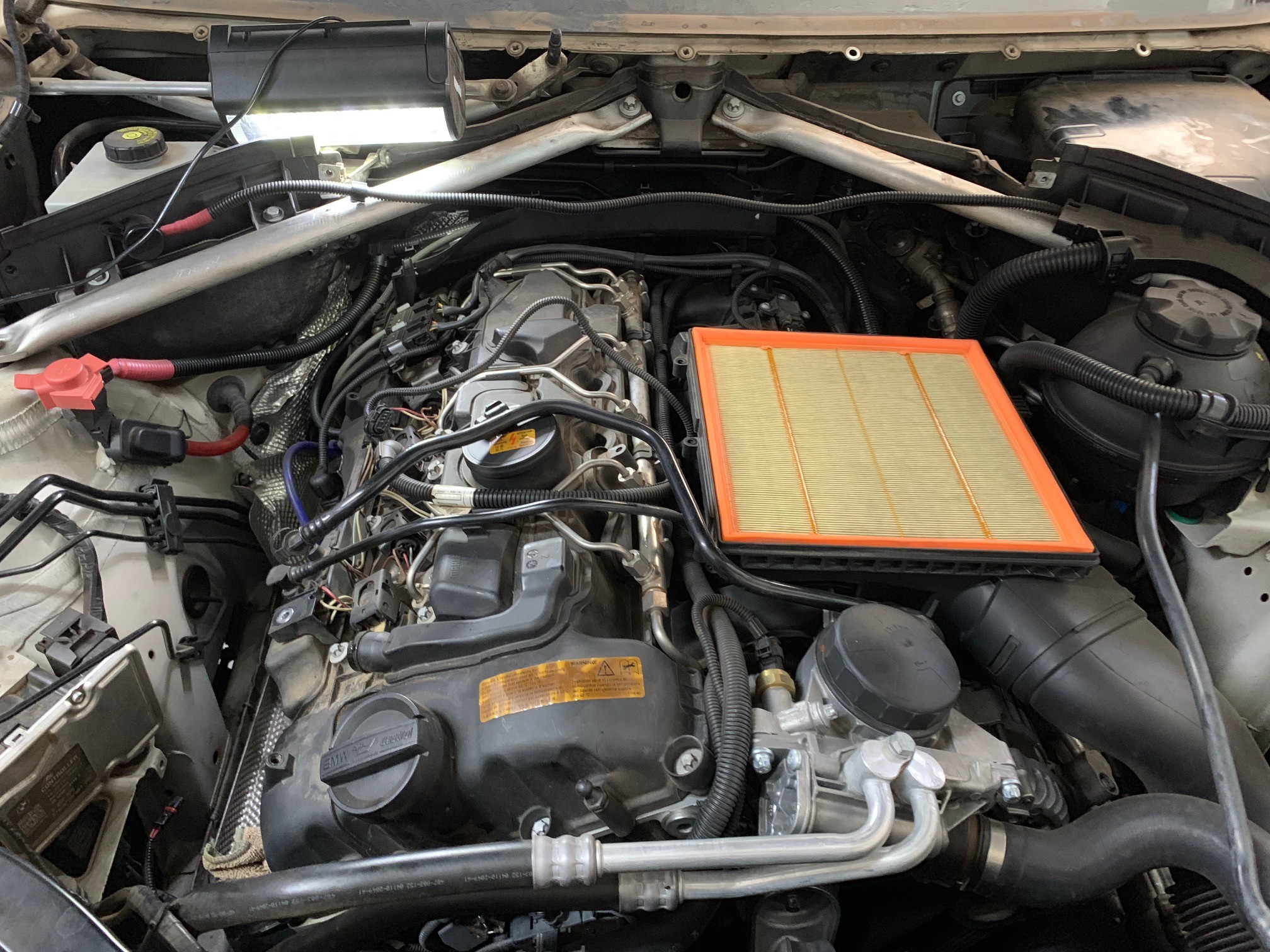

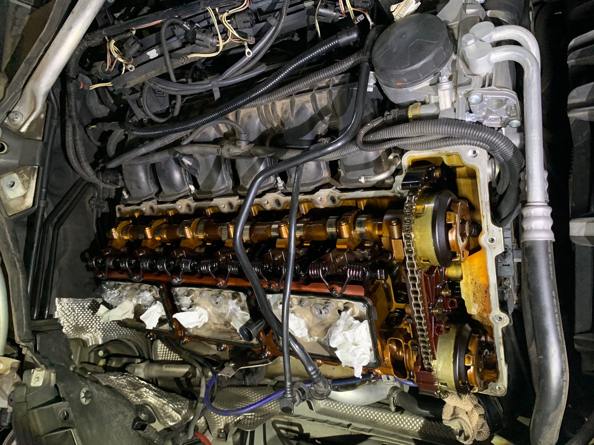

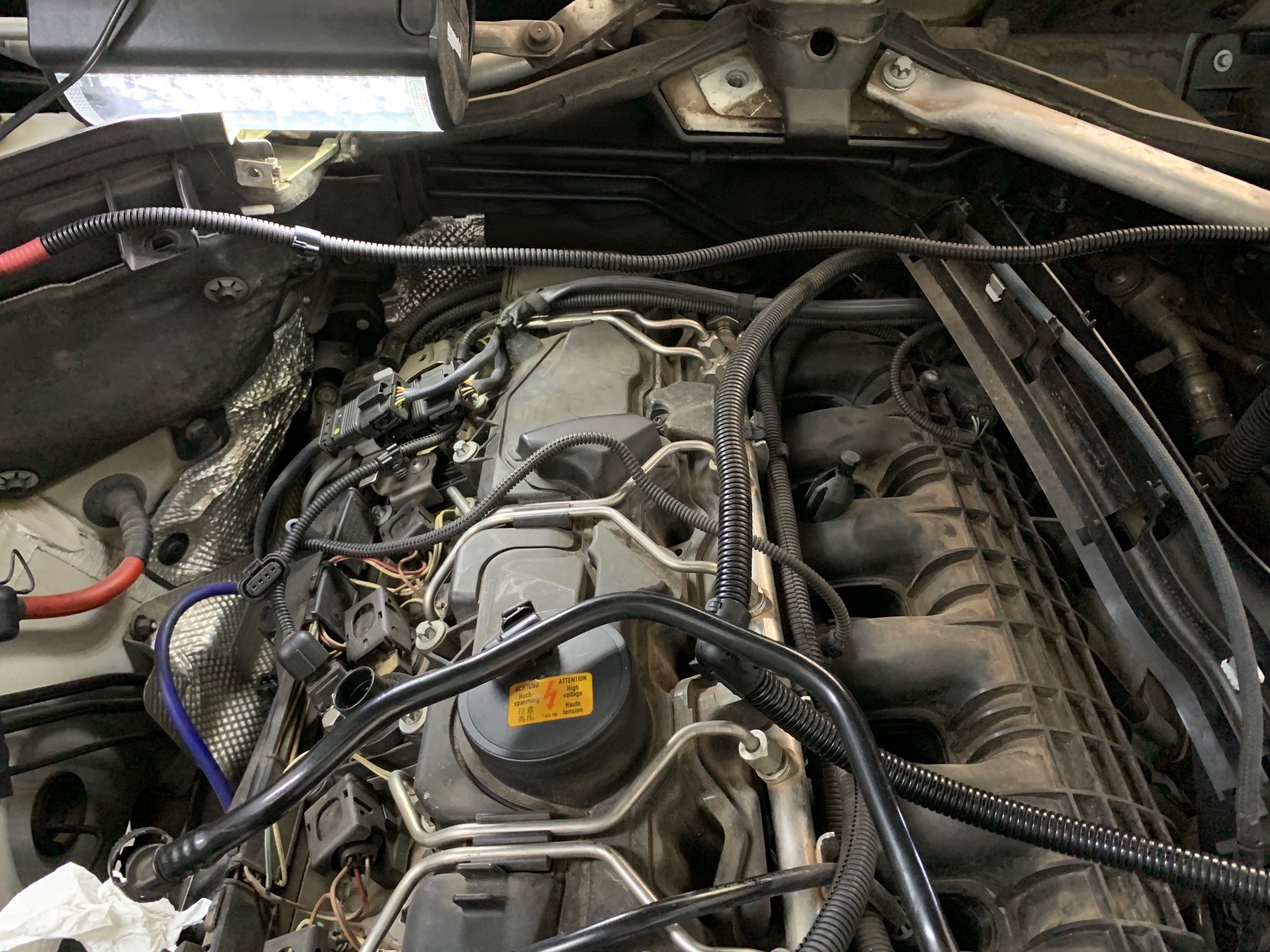

VALVE COVER GASKET DIY...
Yip, a bit of occasional smoke, and oil dripping along the driver's side of the engine bay, and it meant it was time for a valve cover gasket replacement...
This took me quite a while to do... as I really took my time, and wanted to make sure that everything was put back 100% in place and in good condition...

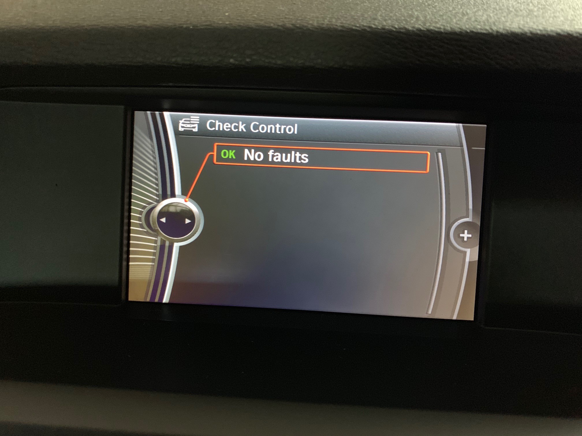

Anyway... next up is the before shot... a few in-between shots... and then the final all together and "no faults" shot... and she drives like a dream and no oil nor smoke!
:smilebounce:
The 5 & 6 look a bit worse for wear - they obviously get more water spray because the plastic cover doesn't go all the way to the back..
Little bit of soot build up on the inside...
And all done!
