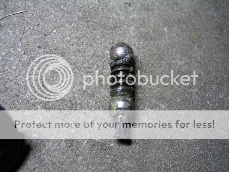

Bekker
i had the same problem and this is the gear that i replaced. got it from Dolphin spears in Goodwood Cape Town for R480.
