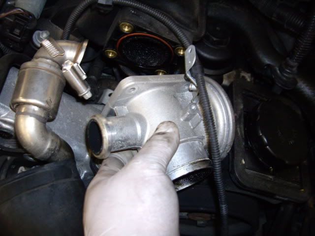

Hi guys,
My wife complained about smoke coming from the the bonnet, and when I checked, I saw that the EGR Valve had a hole as big as a match head and after removing it, discovered that it had another 6 pin prick holes as well (part connecting to the exhaust cooler)
I phoned Zambesi Auto (dealership) [Part No : 11 71 7 804 378] and got quoted R2900-00 excluding V.A.T
After cleaning the unit, when sucking/blowing on it, nothing happens.
Is the plunger supposed to move, or does it only operate when it is connected to the cars vacuum system.
If the valve is indeed faulty, where can I buy a valve that's cheaper, than the dealers.
I noticed that after using Pratley steel on the holes, it starts much better.
Beemo's quoted me R2850-00
Any comments would be highly appreciated.
