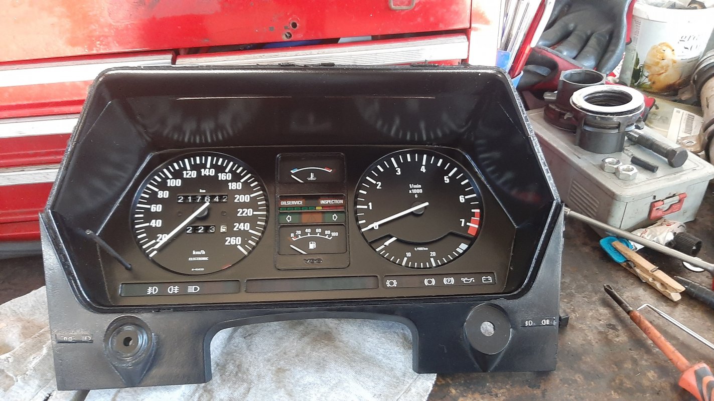

I am not sure why we fitted a face lift cluster but we did.(actually I remembered now the problem arose when we changed the rear suspension and diff from the later E28/E24. The speedo pick up is on the diff so we had to fit a new cluster to get the speedo working.)
The chrome ring surrounds were a finishing touch that I iniatially thought would not work.
I was wrong.

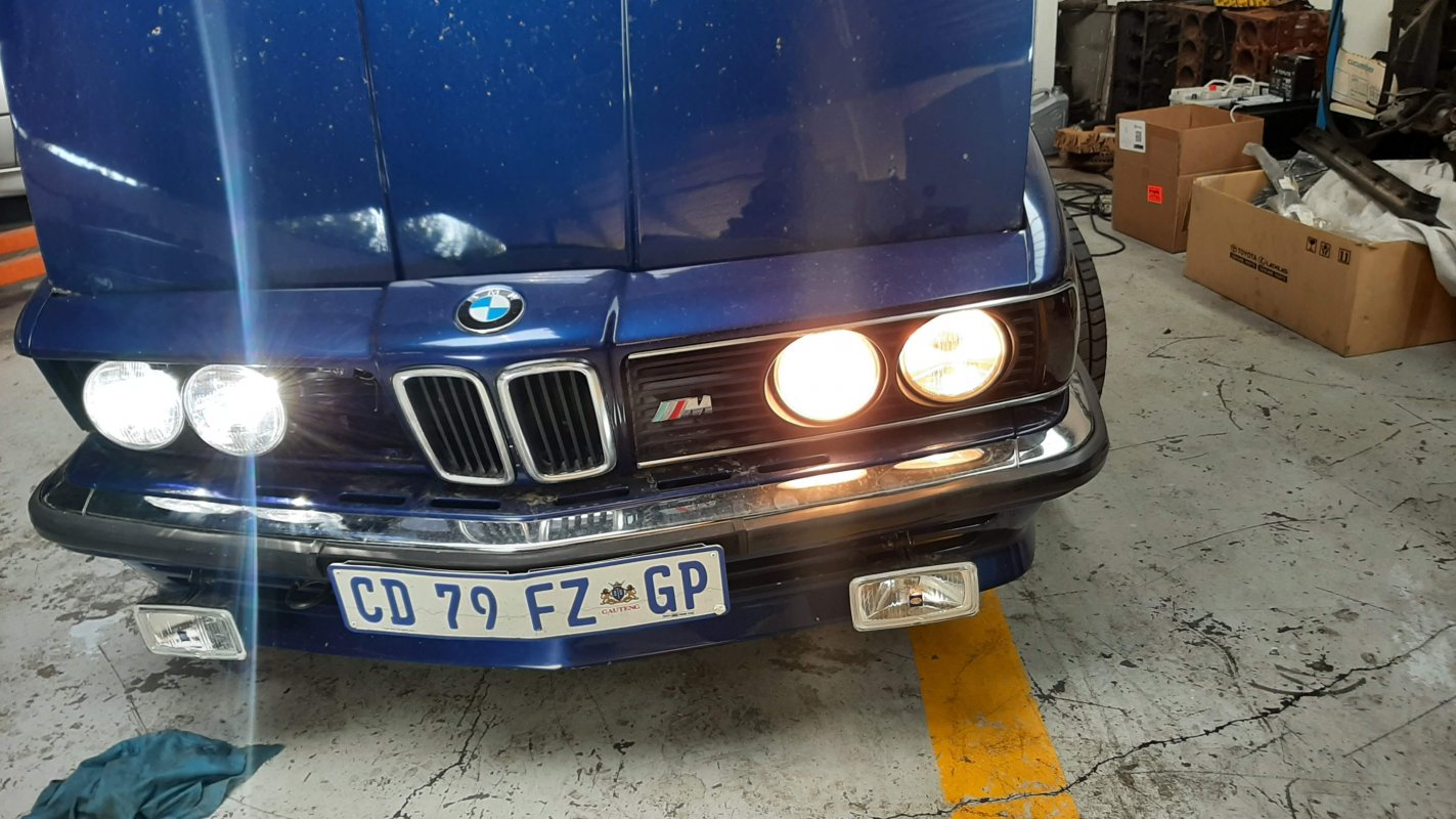

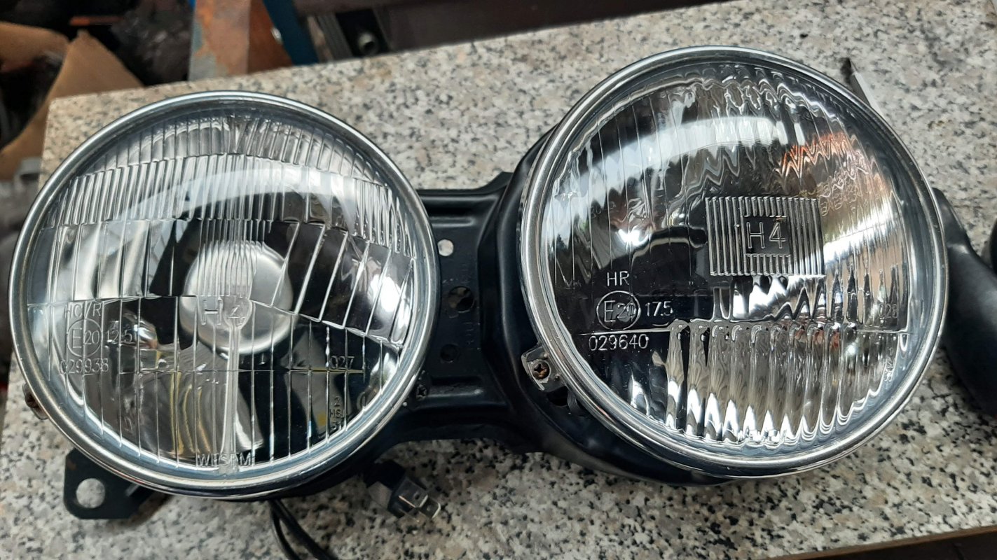

Unlike my previous post I know exactly why we fitted new lenses that are as close to OE as dammit.
Quick comparison between old and new.
Lenses were brought in with LED globes

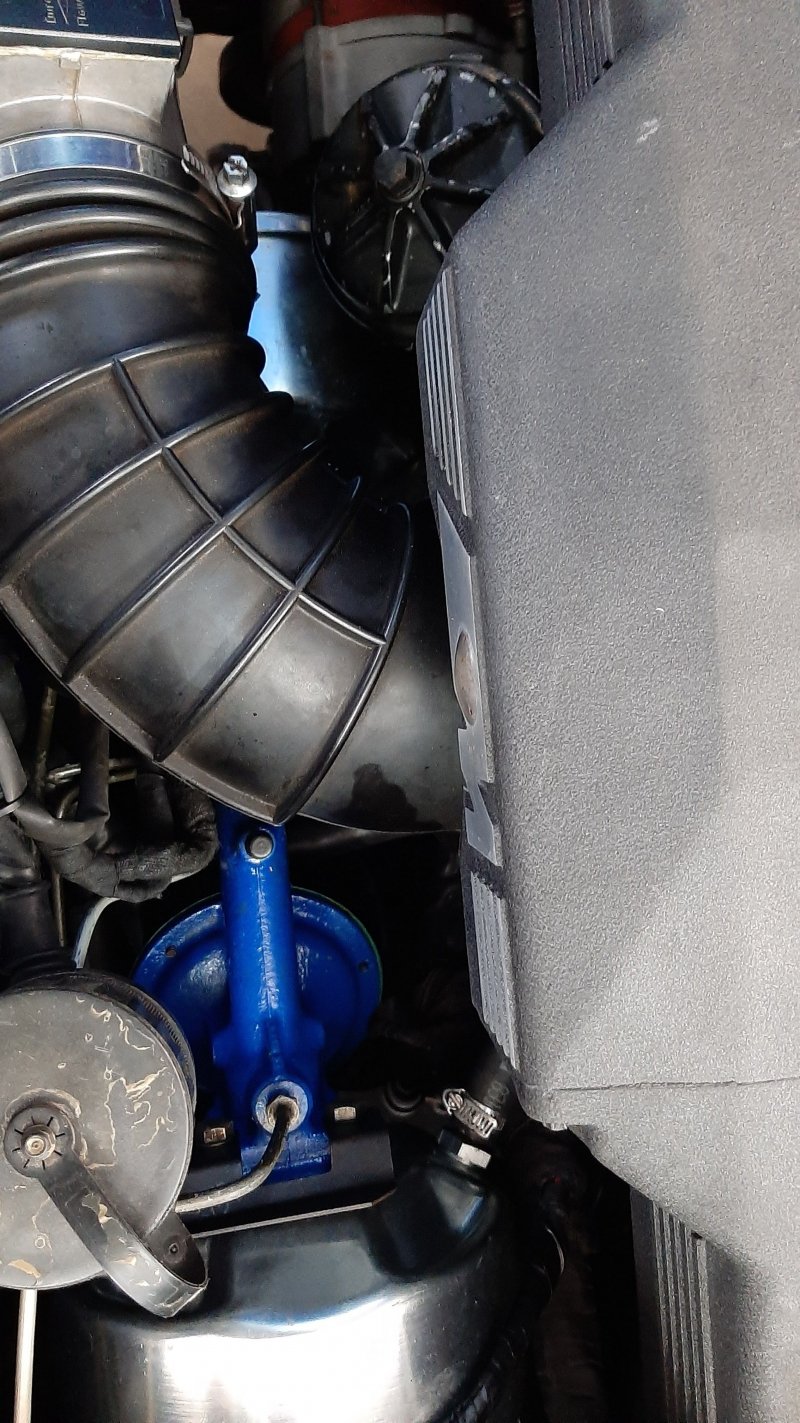

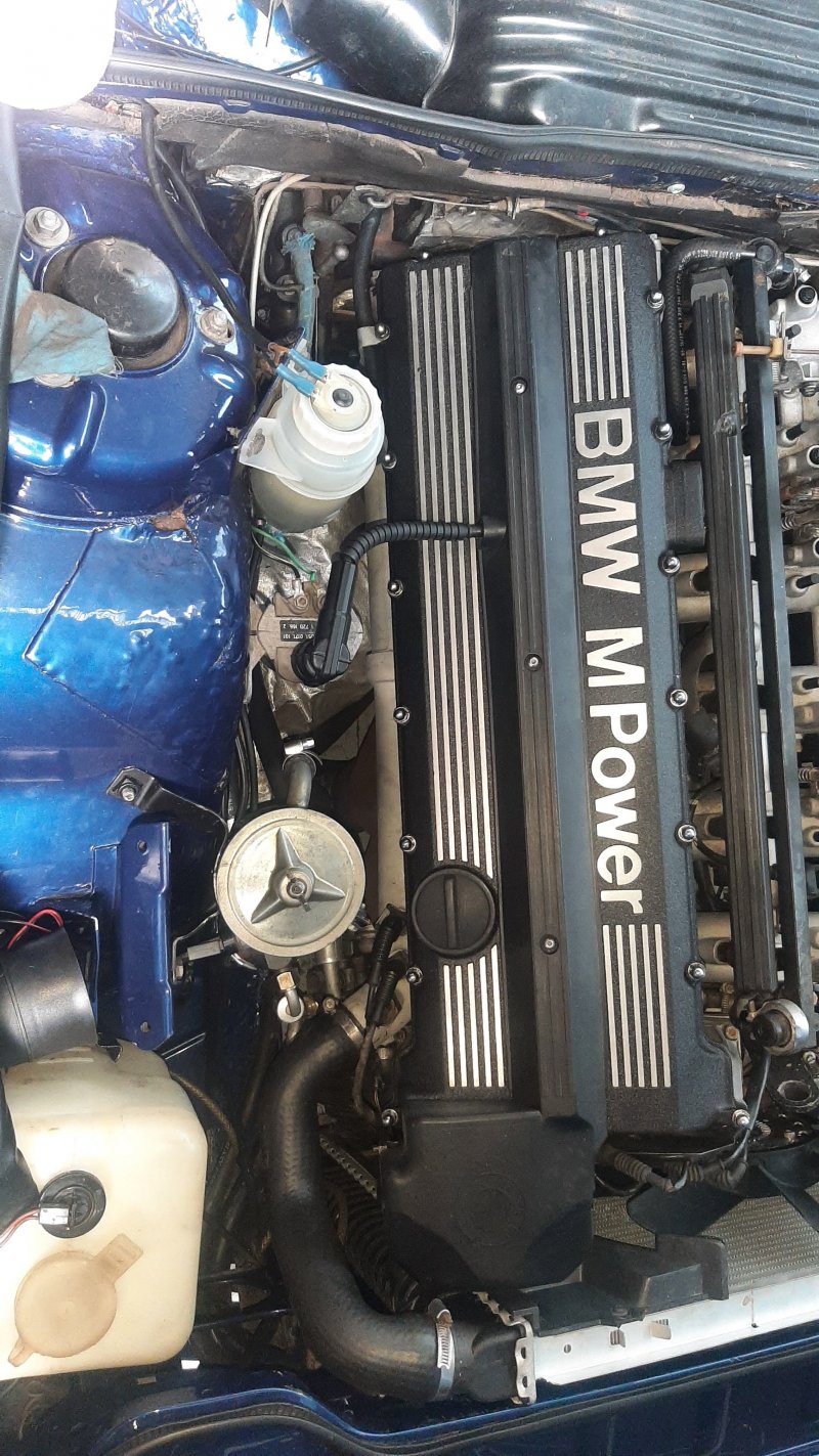

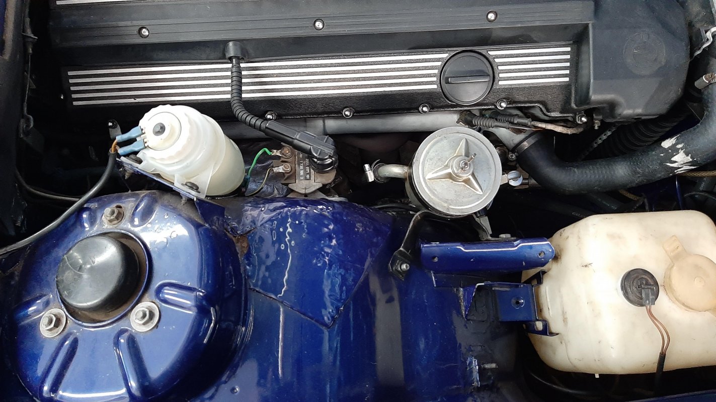

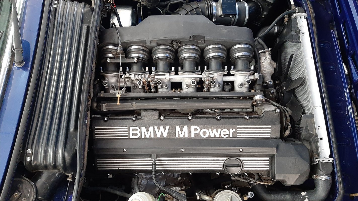

Right side of engine bay with power steering reservoir relocated.
One of the trickier parts of the restoration as I needed the space on the left side of the engine bay for the M5 air filter box

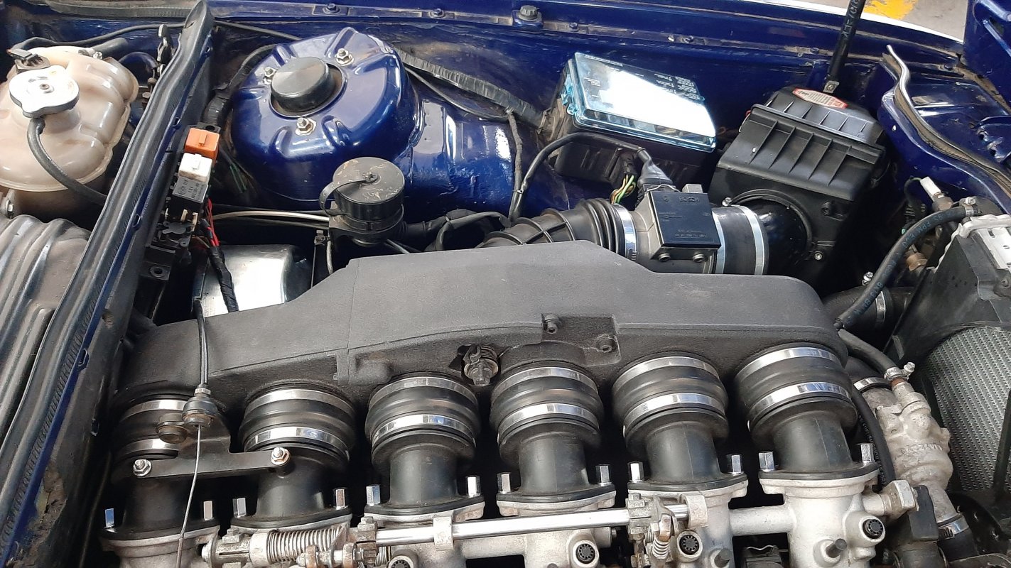

We still need to complete 1 or 2 areas of concern however I have not found a permanent solution for the oil leak from the back of the cylinder head drain which most M88 or S38 owners are familiar with.
The other is the Air mass meter which is not working properly and makes the engine stumble.
Air mass meter NLA so we are looking for other sources and if anyone on this forum knows or hears of one please let me know.

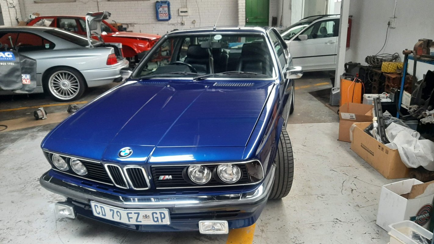

Spme pics after Picking her up in December.
Its only a year and a half late to the party, but the 928 S4 Porsche uses the same MAF.
Since those are readily available and cheap, I would appreciate a thank you gift in the form of a box of chocolates 🤪
PS - last comment only applicable after sourcing one from PorschešŸ‘€
FiRi@Rennzport
Thank you Sir.
I did try contacted bosch with the relvants number as i seen it was compatible with Porsche as well. They said not available.
But let me try porsche as well.

ps. personal choice, but I think this car would look much better with stock indicators/rear lights, the black cheapens the experience for me
