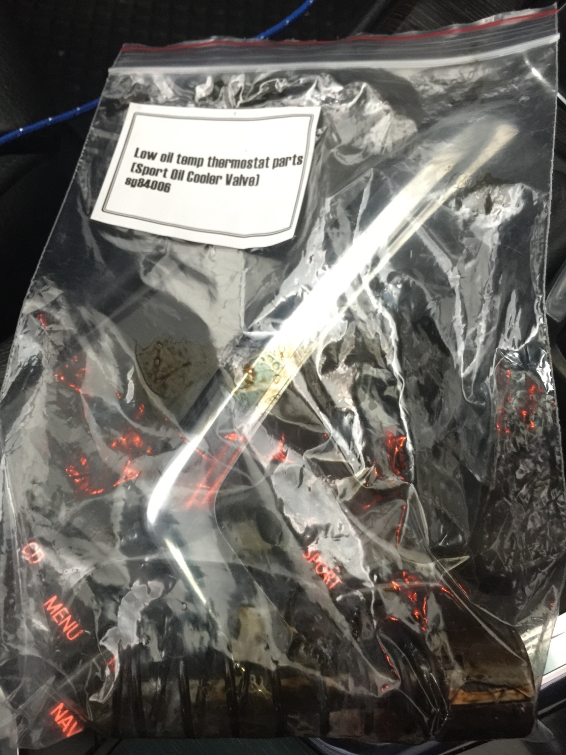

Have a look at the rennzport subforum and take a look at their oil thermo bypass. A simple and cost effective mod which will allow your factory oil cooler to run all the time.
I have seen my oil temp drop from 110/115 degrees to a nice constant 90 deg with no appreacable increase in warm up time.

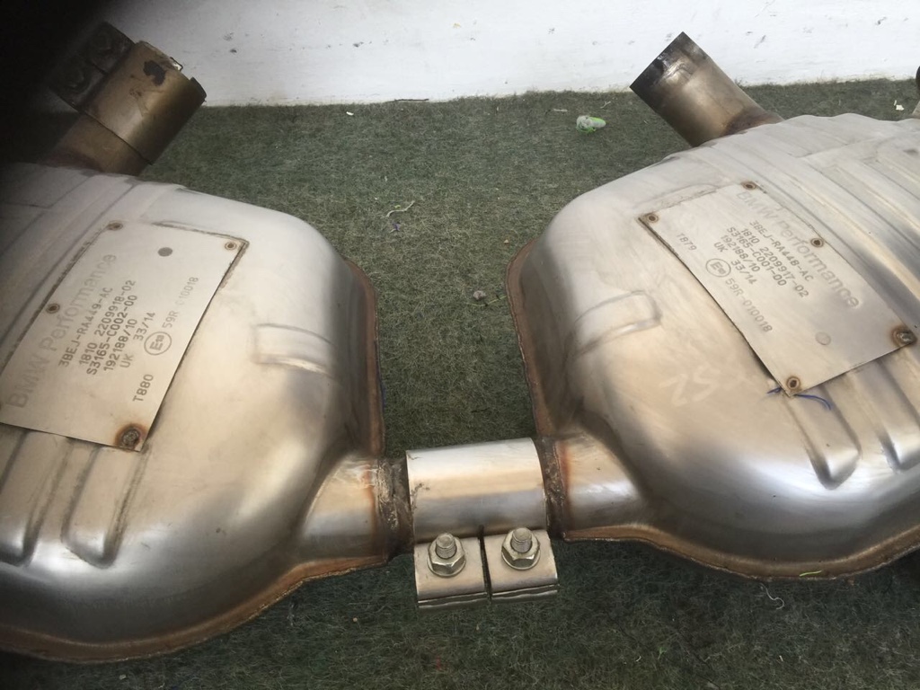

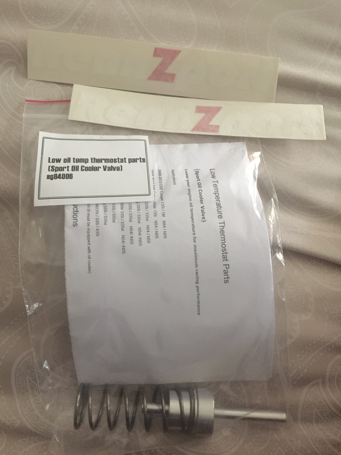

Sooo I bumped into someone selling this for a price I couldn't refuse
I'm fitting it this Saturday morning, can't wait
Snip3r
Fitment done on Saturday I must say, I am very impressed with the results, the car sounds awesome
