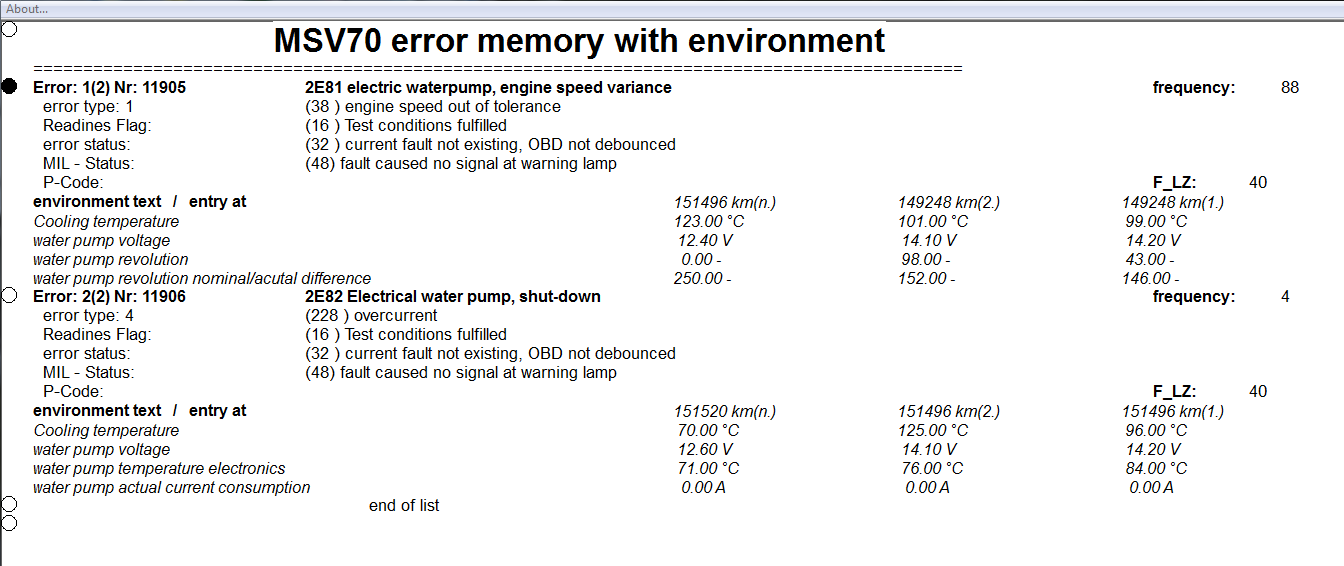

Now finally after a few Pump Speed codes for the last year yesterday on the N1 just before Stellenbosch turnoff the dreaded yellow followed 30sec later by red overheating warning light came on . I was travelling at about 120Km/h ( obviously ) but I think a contributor to this was the outside temperature of 40 degrees . Stopped the car and waited for 20 min while accessing the hidden menu to see what the coolant temperature is, it was sitting at 120 degrees at first , waited until 106 then started the car and drove l slowly home monitoring the hidden menu temperature , traveling 100km/h the temperature fluctuated between 83 -93 degrees all the way home to Brackenfell . Well not taking any changes the car is parked to be fixed. DIY this time. I think I will order the parts from G Drive , pricing is fair .
Oh when I arrived home the expansion tank was a bit low due to water venting , I did a bleed procedure and the pump worked 100% tested it on Inpa at 90% and it fluctuated a bit like it won’t get speed.
Below is the codes on Inpa
