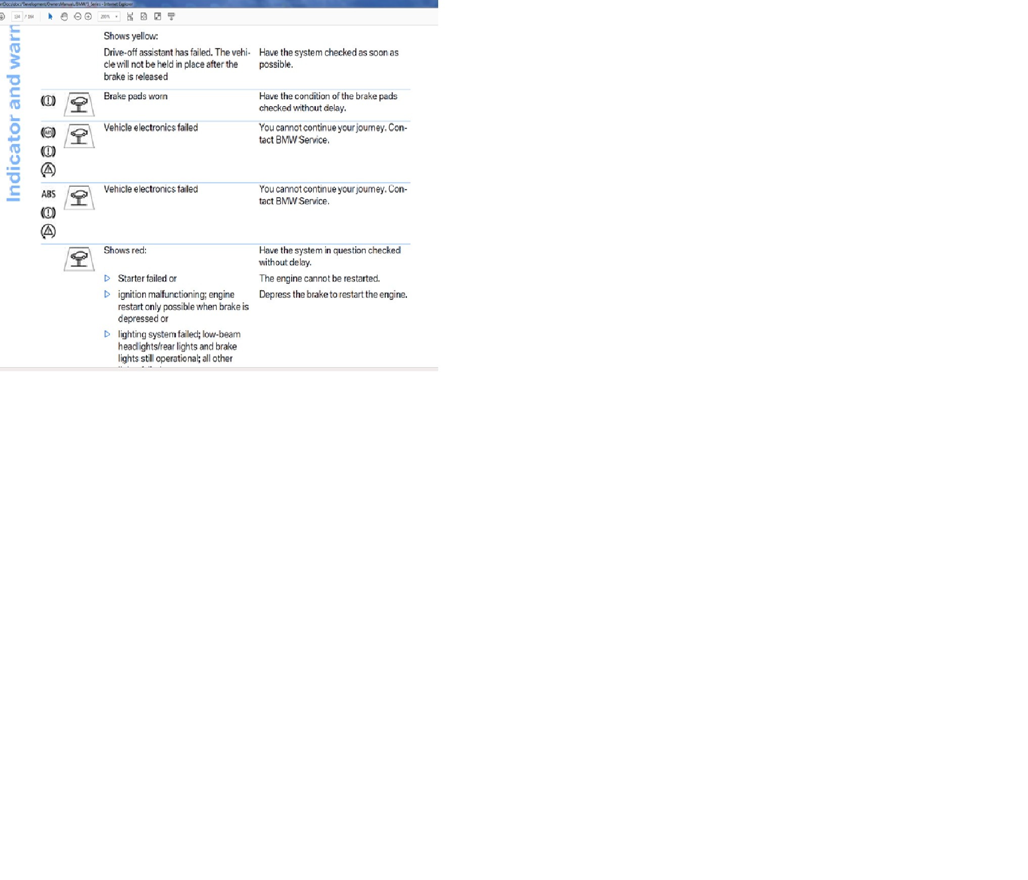

Hi herco,
The fact that there is no idiction of milage is and indication that there may be a problem with the senor, we have had several were the wires have been eaten off in the r/r wheel arch so if it doesn't want to reset it could be this. The vehicle on the lift could be several things, vehicle check as mentioned of some of the listed below picture from the owners manual. The car on the lift may be indicating that there is something electrical wrong on the vehicle. If you are close to Leo Haese Pretoria Hatfield, pop in and I will quickly read the key and see if it shows anything - and don't worry, I wont charge you to read the key, come have a cup of coffee if you like, only takes seconds to read the key. Hopefully I can give you some advice.
