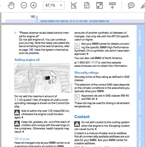

The correct oil grade is 5w30. Dont use Castrol, BMW has now changed over to Shell.
