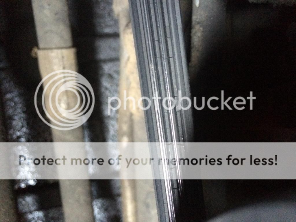

Then this past sunday, I moved the car and the steering wheel was worse, and now there was burnt rubber smell. Popped the hood, had a look around the belts, checked if they are loose or anything, visually inspected the vibration damper - looked solid (considering it's a pirate part).
I had a closer look at the belts and voila - cracks on power steering belt.
At this point, I'm chuffed cause I'm 99% sure I've found the root cause of all these PS issues. I order a belt from dealer - got a nice discount, and picked it up today.
