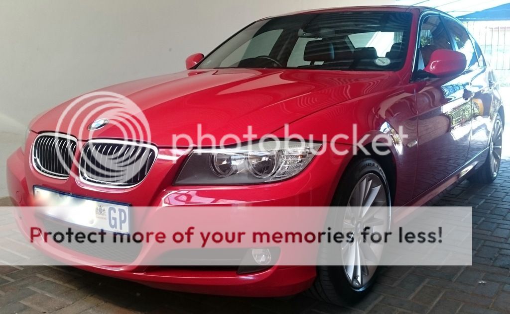

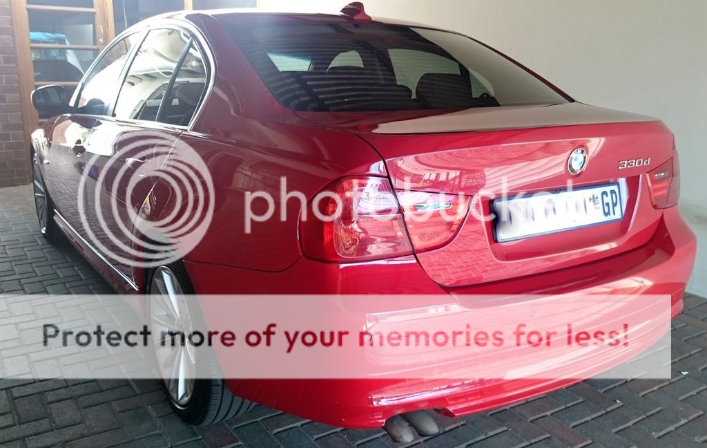

Yours seems pretty normal to me... Any chance of a few pics?

I will do pics over the weekend. But I warn you the car is very red... hehe

When it comes to cars nothing is too red! :rollsmile:
