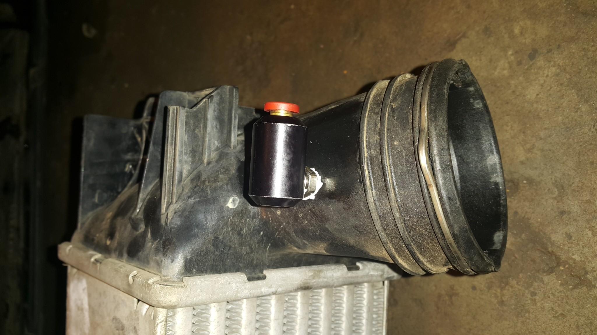

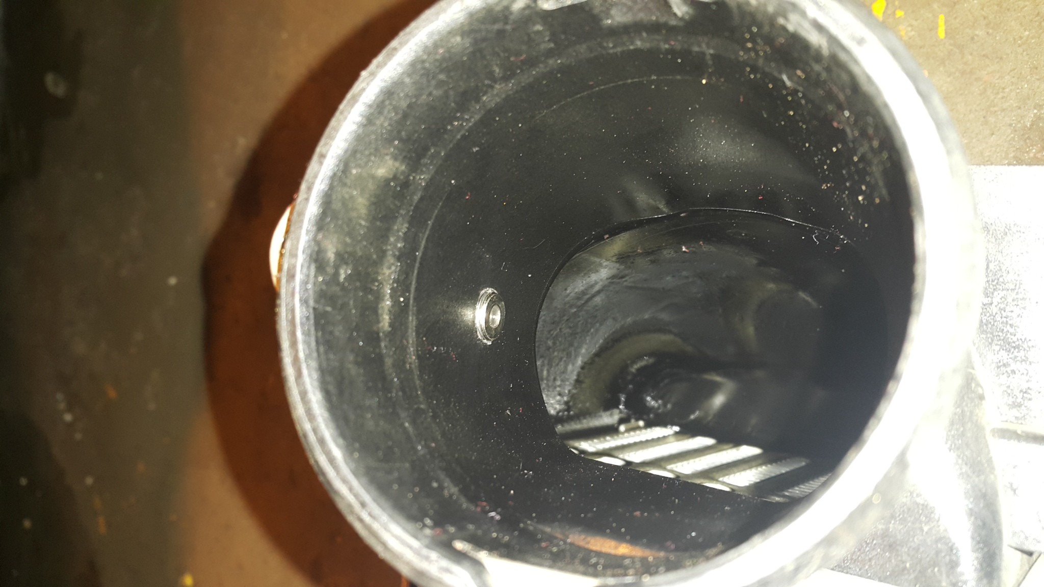

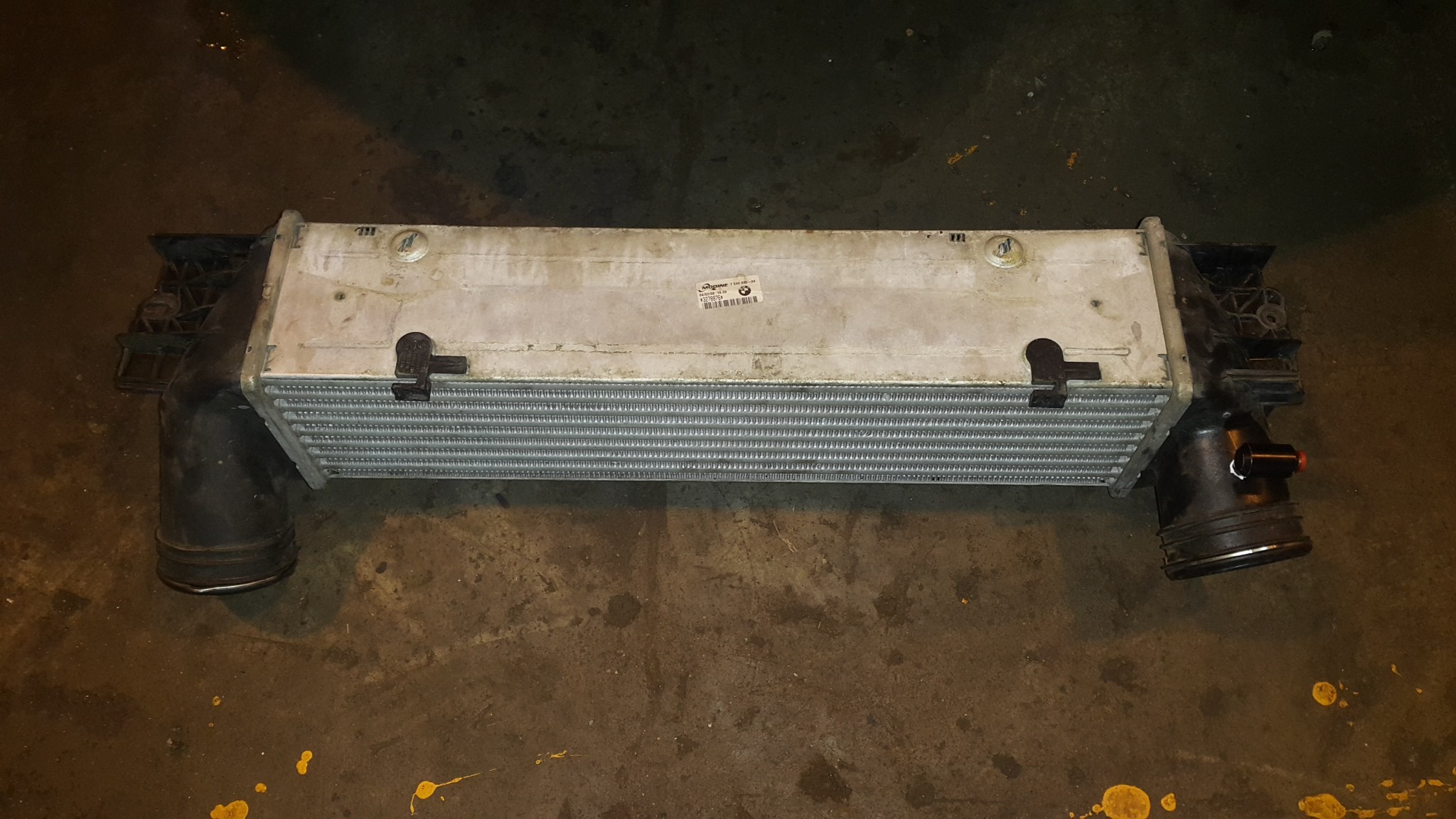

Firstly it was cooler off to install nozzle..opted to drill the cooler as I still have the oem 335 cooler
..drilled and tapped on the cold side and ran solenoid wires and meth line to the boot underneath heat shield and undertray covers.....

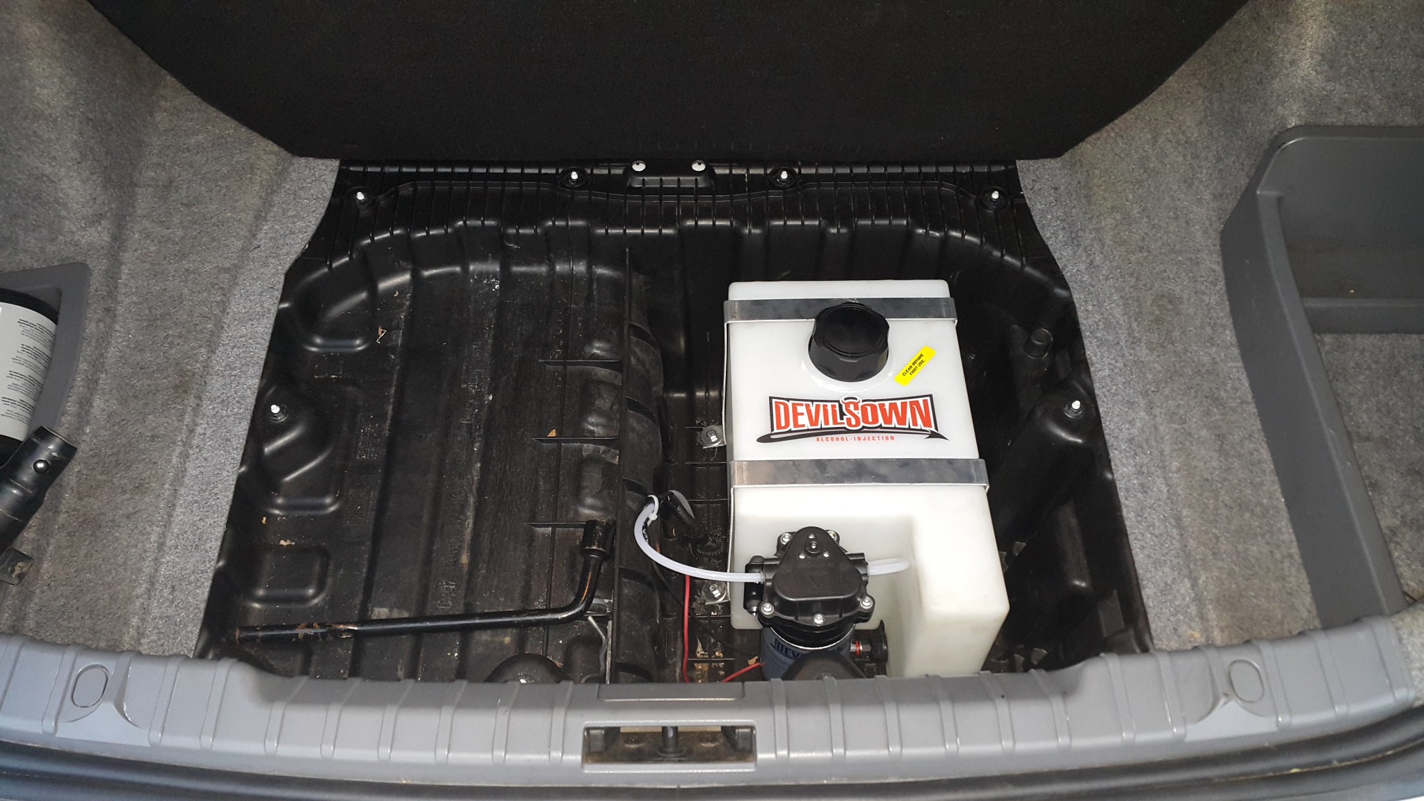

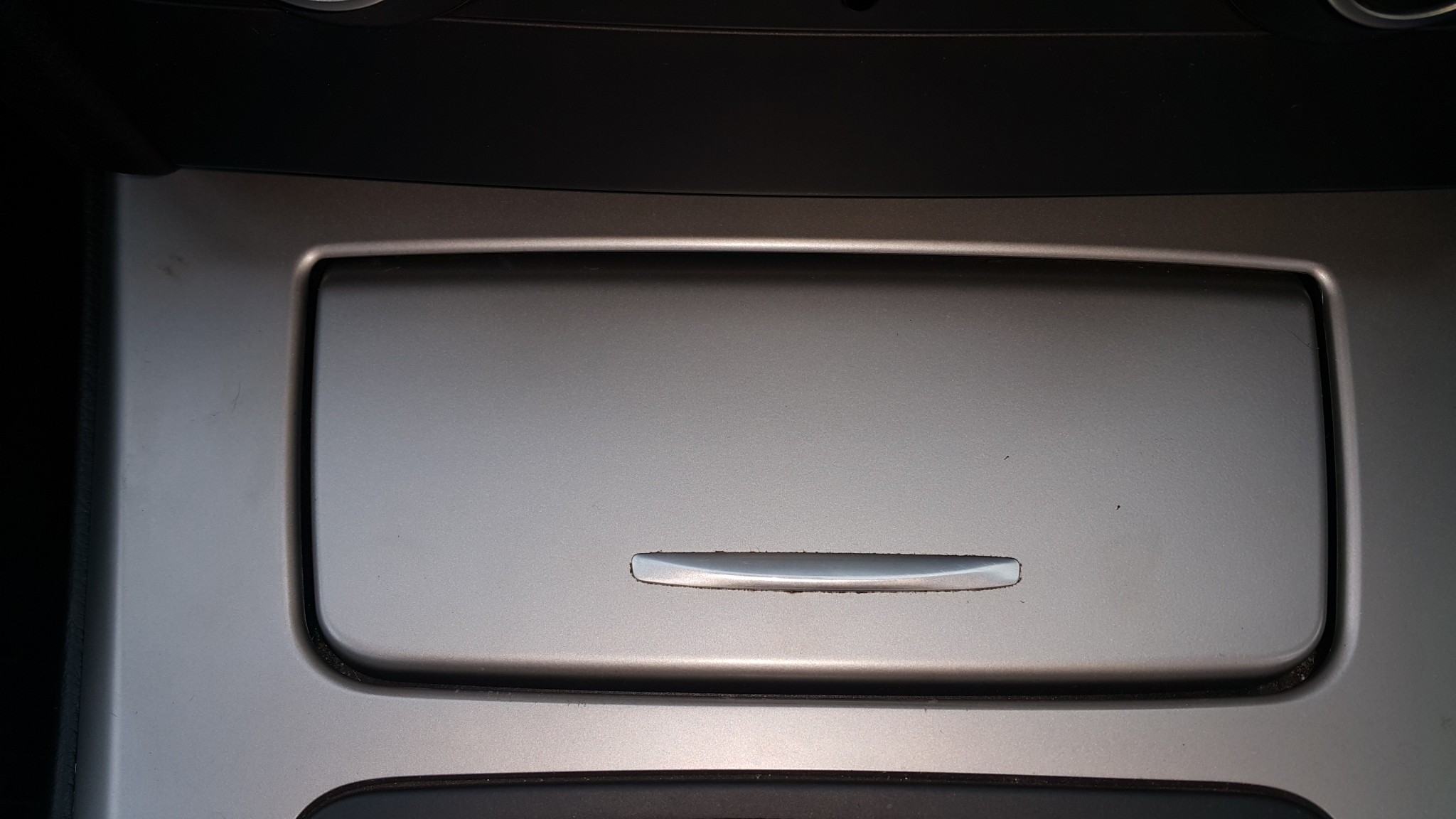

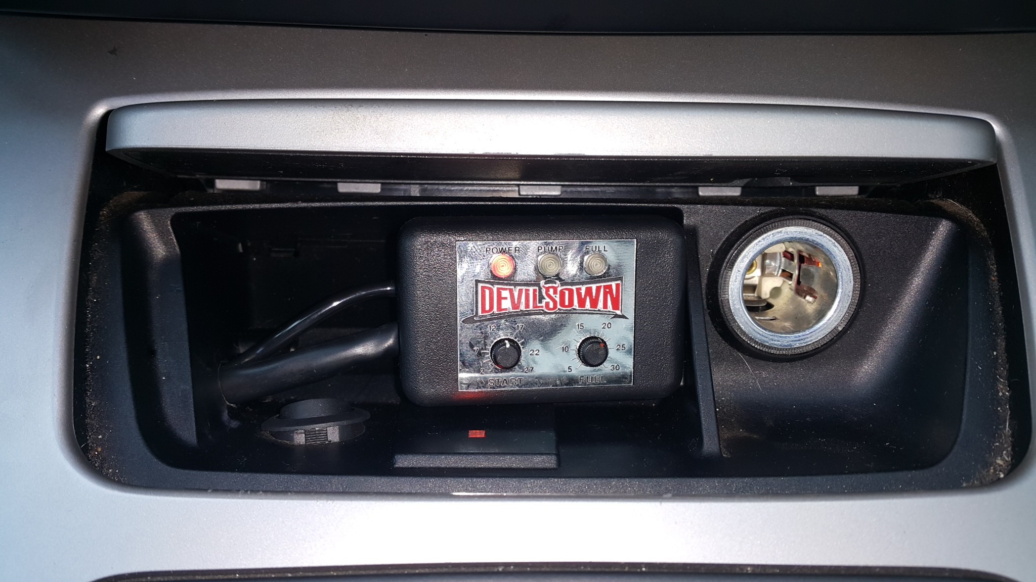

Next I ran wiring and decided for s stealthy controller install in ashtray compartment....I fitted an aditionall power toggle switch aswell....lastly was the tank install with I found another stealthy spot in the lower boot compartment ....
After I closed all covers and tested lines etc went for a drive...I was however not getting any boost pressure to the controller...Chatted to Nihkil and realised I had tapped a vacuum line thus no boost signal. ..I then decide to tap the hot side of the cooler and fitted a fitting to the controller vacuum line....and SUCCESS.......

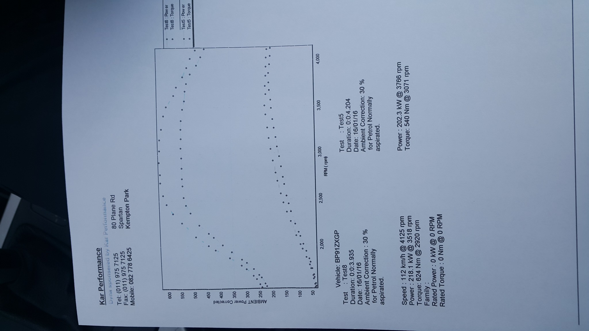

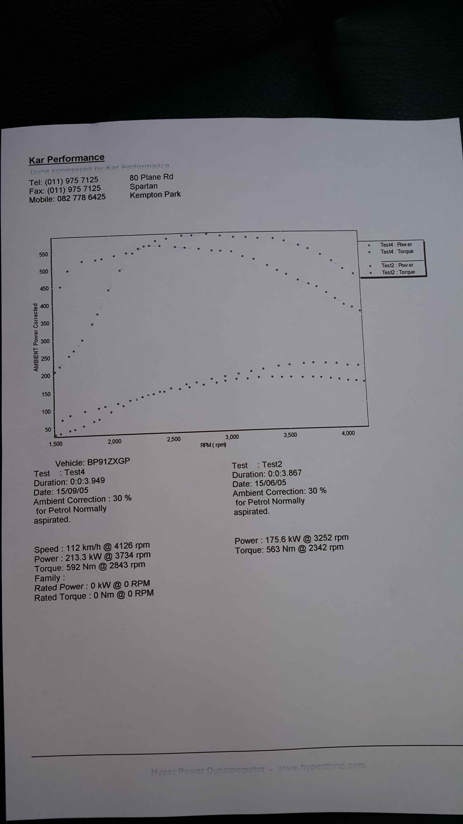

Have a before dyno graph so will go back and do 2 runs ...with meth on and off....
