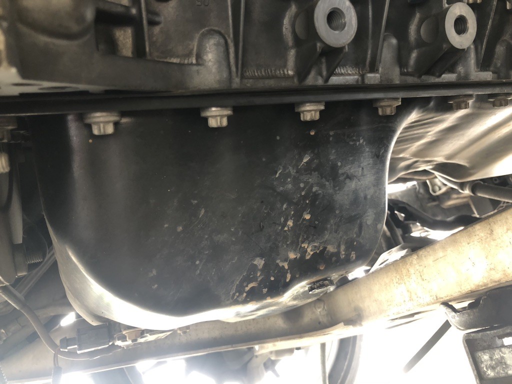

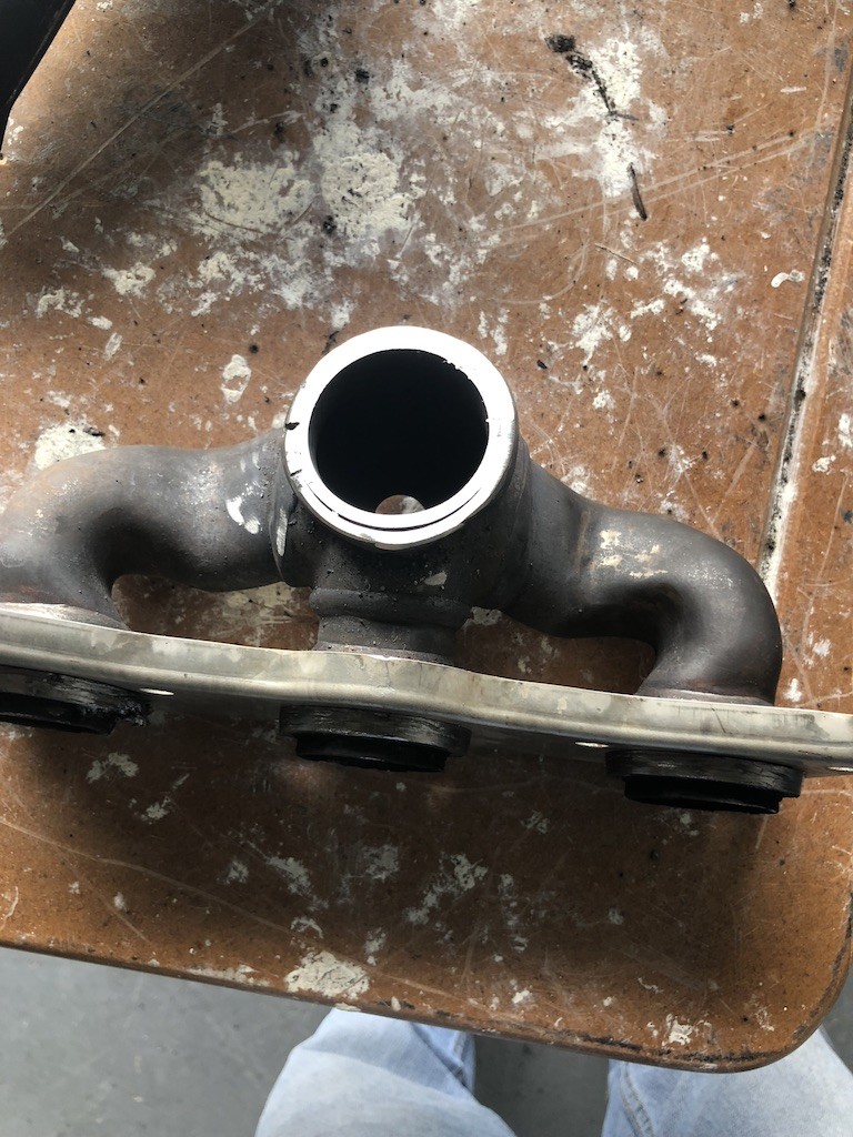

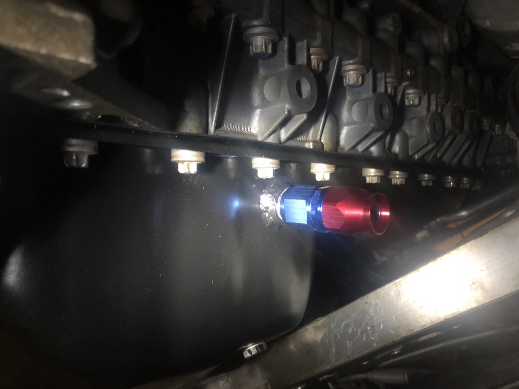

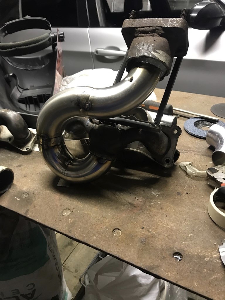

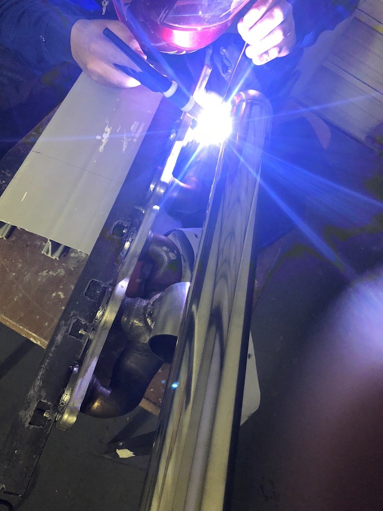

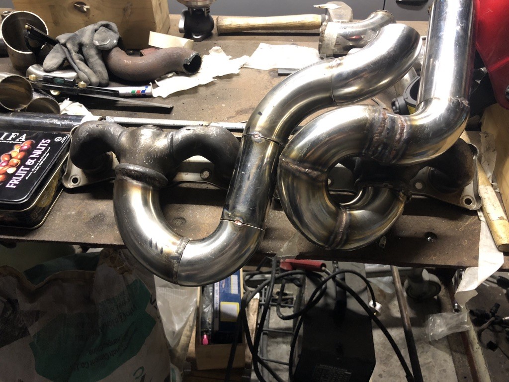

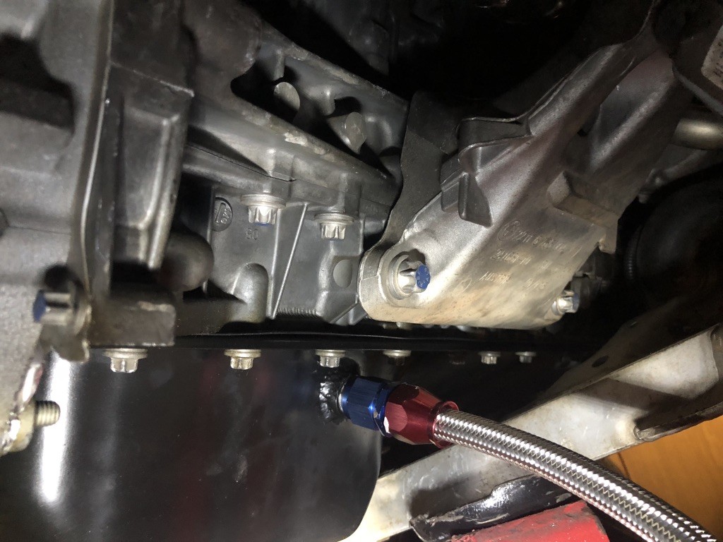

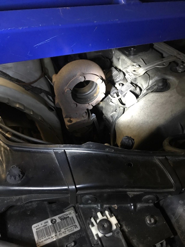

Update to all:
Build moving along, learning curve with this build so need to kinda make up things as we go along.
Things done:
Water Lines and bottle moved to passenger side

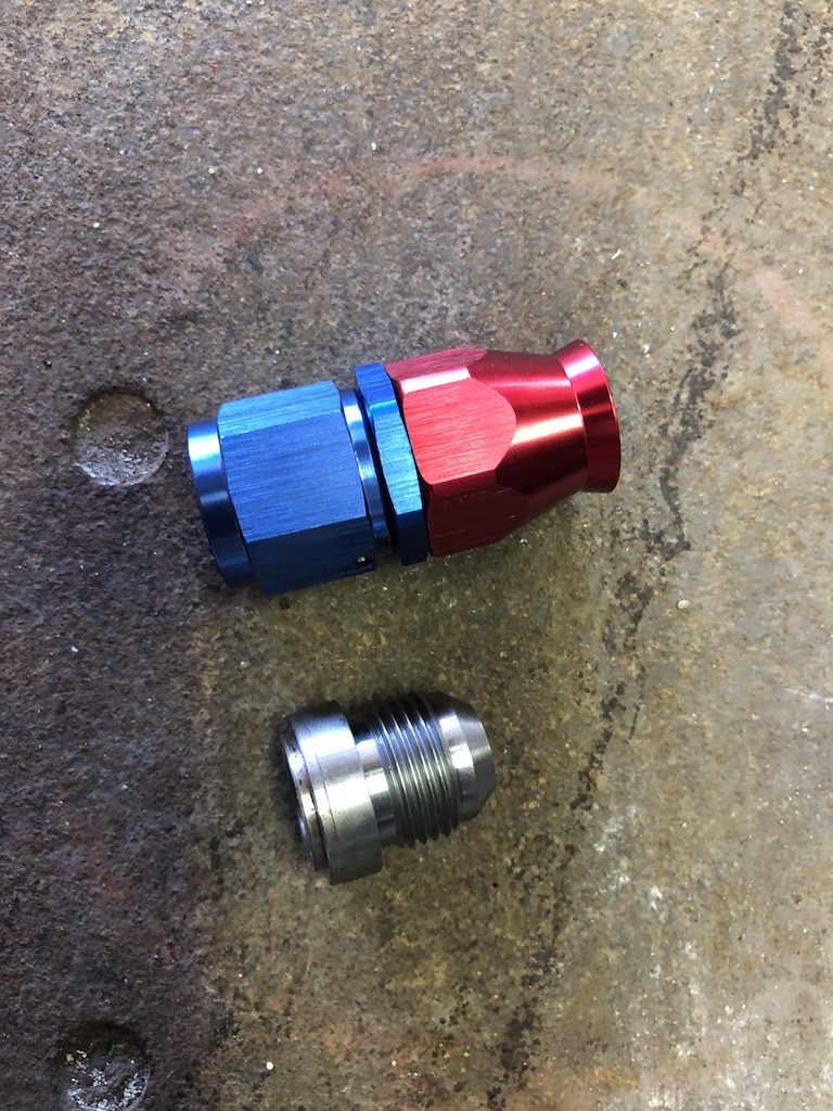

Oil feed tapped into oil switch
Oil return added to sump (Getting sump off not the easiest)

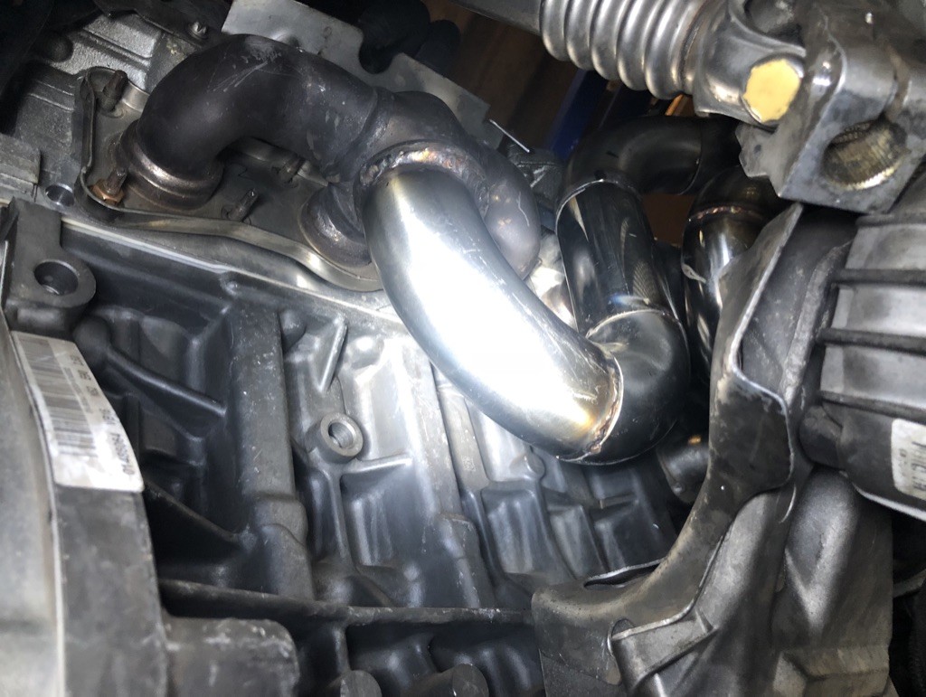

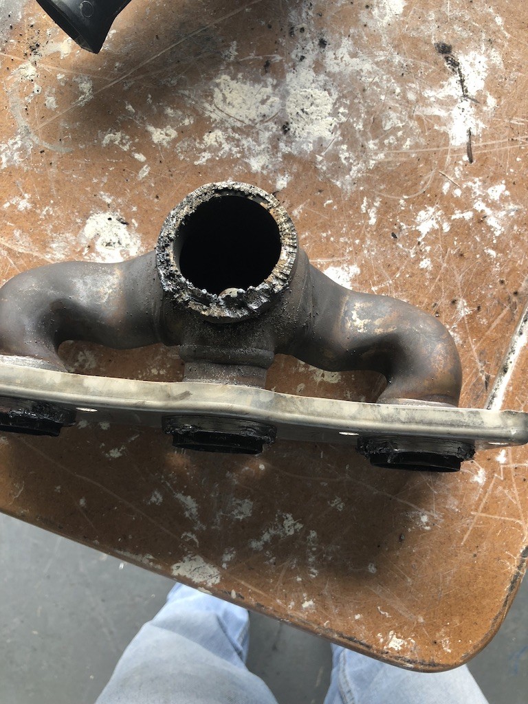

Busy fabricating Moc manifolds & downpipe
Manifold taking the most amount of time, didnt want to take the head off and dnt have a spare so having to to this piece by pice
received all parts needed - Total spent this far - 9K
Here pics of the progress

922-ZN

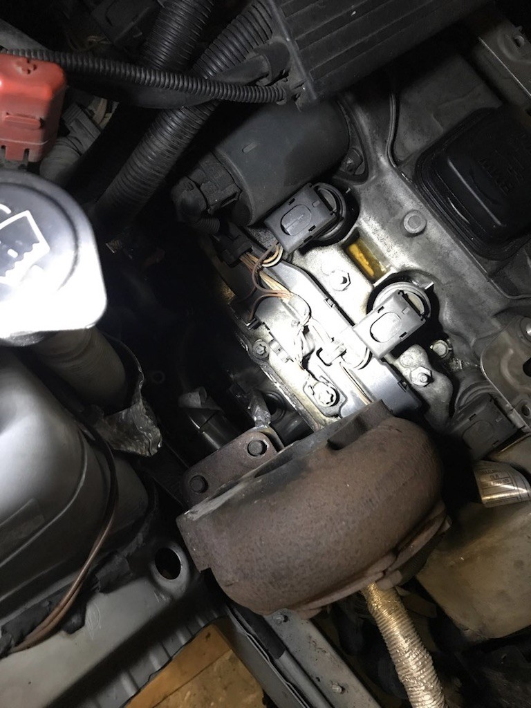

Hot side of the turbo going to be mounted directly on top of the head like that???
Wow, RIP to those wires and coils:fencelook:
husaindindar
A few weeks back I was at SavSpeed. He had a full turbo kit collecting dust for a N52. There was also a manifold. Maybe go and have a look at the design or buy it off him?
I agree about the turbo. Turbine side too close to everything fragile.

was a concern, everything will be wrapped and heat shielded, but still moc unit so will change slightly when completed.
here a link with some top mount installations:
Issue is cost, and would still have to cut them to make them fit vs DIY seems way more cost effective and results pretty much the same

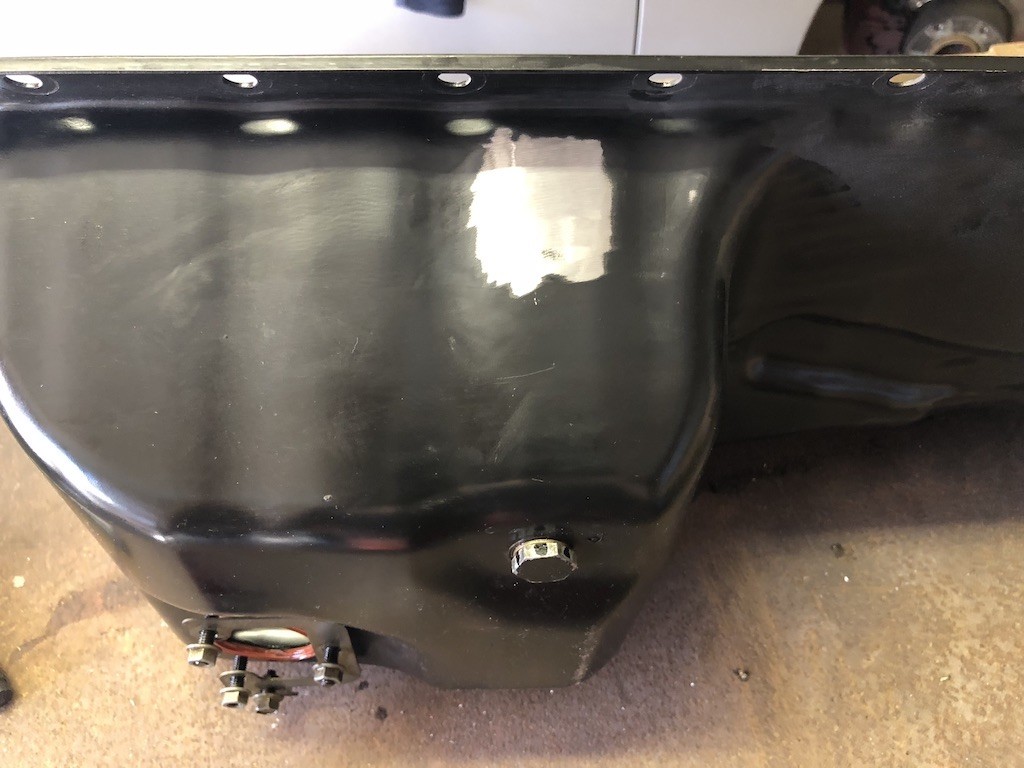

Also drilling the sump and welding it while attached to the engine isn’t the greatest of ideas as you now have metal filings contaminating the oil and engine and no matter how many flushes you do they will probably still be there and at some point will clog the oil pump and boom or block the vanos solenoids or get into the turbo oil feed and boom.

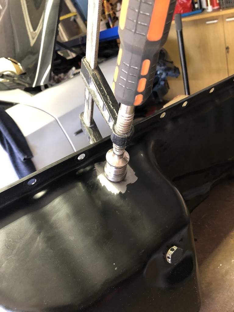

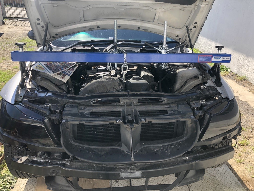

Pic 3 and 4 shows the sump off the motor there.
Nikhil
sash said:
i just see "Image can not be displayed" for the first 4 :hammerhead:

Sump plug added off the car, for the intent we will be running low boost and testing as we go along.
Compression research “machined piston tops seems to be better route to take” researching into this luckily a good friend of mine has all the machinery required to have this done so if needed will be considered.
MAF will be looking at using an aftermarket one based on how stock one performs
Head bolds, once again should be fine under low boost application, milling machine will do the work if it becomes an issue,,, bolts on 335 much larger so it is being considered as an option
