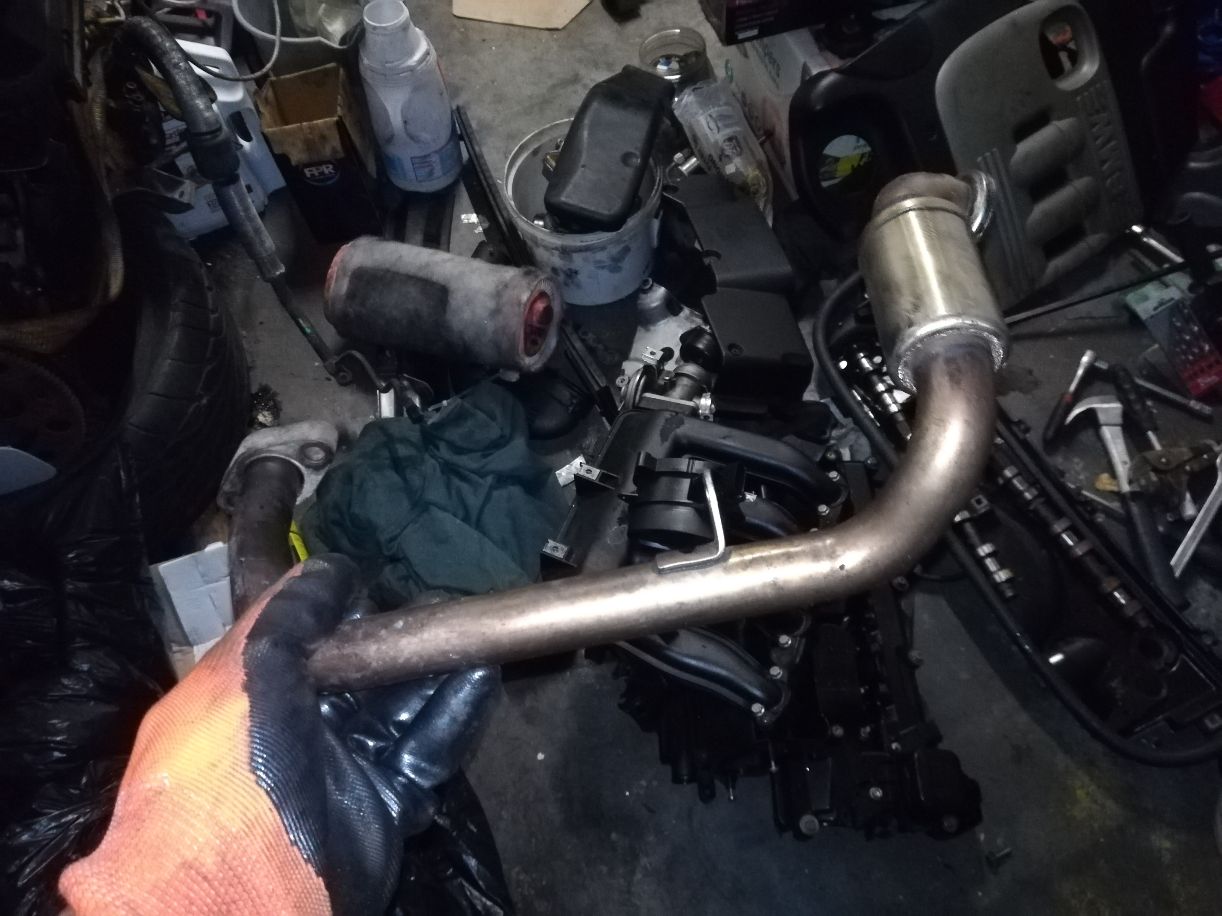

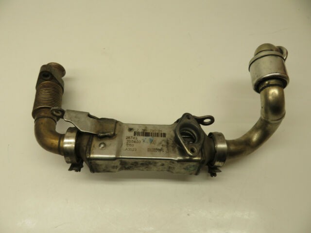

so the 2 E46 320d Facelifts i had ( M47N ), The "EGR coolers" were actually different
2003 model looked like this
2002 model looked like this:
I dont have the answer as to why, Not a real Diesel Fundi.
Is the First part the one you refering to?
