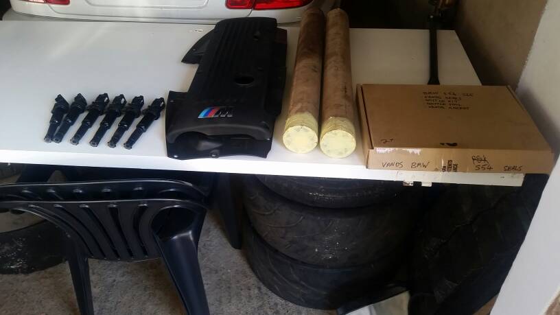

Here is a glimpse of things to come
Exhaust
Intake
Andy1GP

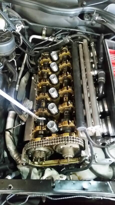

Here can be seen the TDC location for the pin

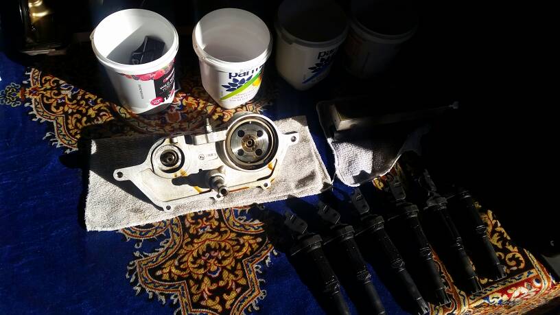

Manipulating the cams slightly to help release the vanos unit

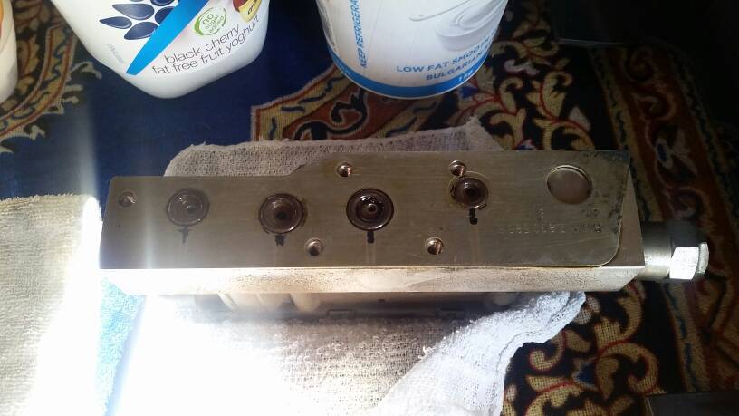

Solenoid pack is fairly straight forward to remove hence I didn't take pics of that

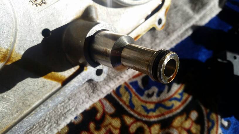

The besian seals Peter fitted still looking great

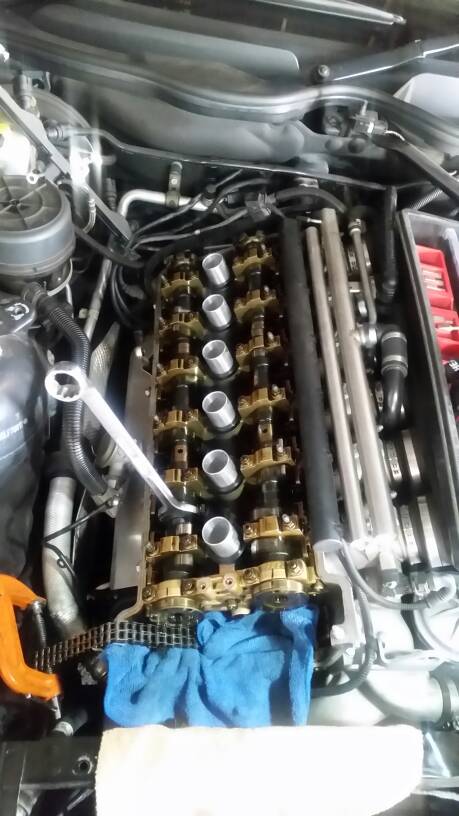

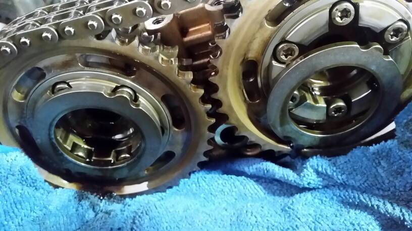

Chain tensioner out

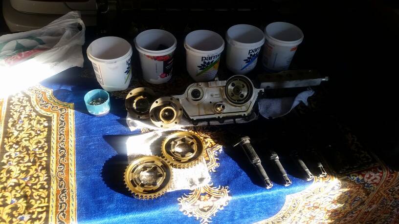

Cam sprockets coming off and bolts replaced with new oem ones. Also fitting loctite on them for peace of mind
Keeping a Gclamp on the chain to weigh it down. So the chain doesn't come off the bottom idle gear

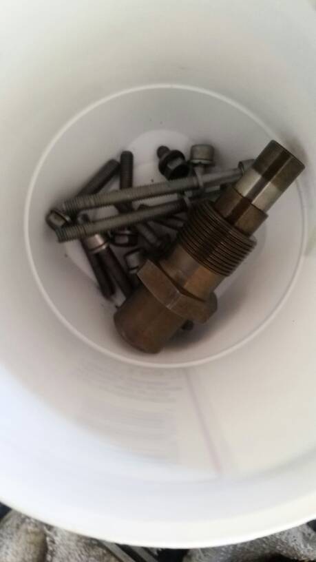

All the yoghurt tubs coming handy to keep the nuts and bolts in sequence

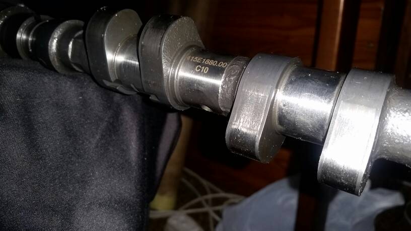

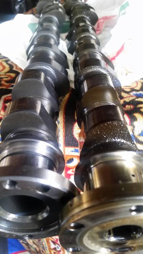

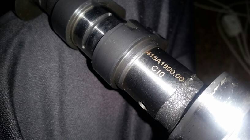

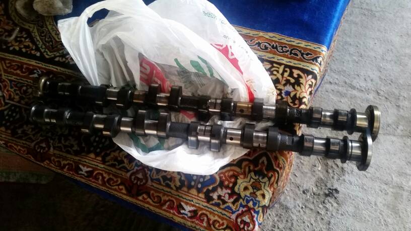

Oem vs Schrick

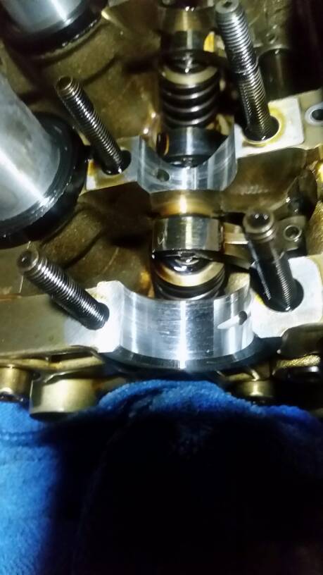

Some wear on the cam caps

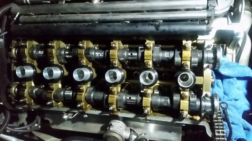

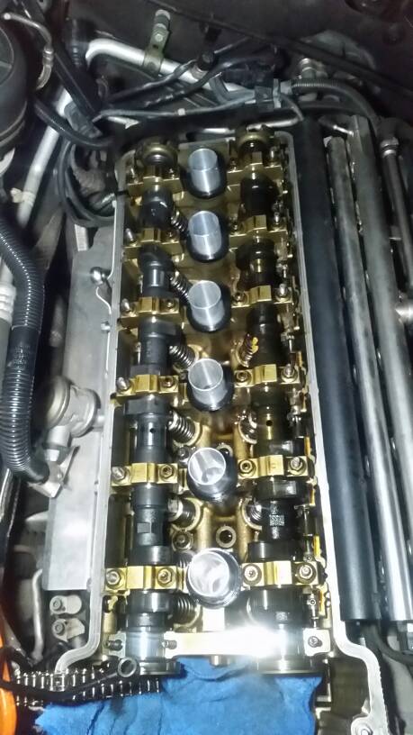

Exhaust cam installed with impulse wheel swapped and spline inner swapped
Both cams installed
Thats it for tonight :)

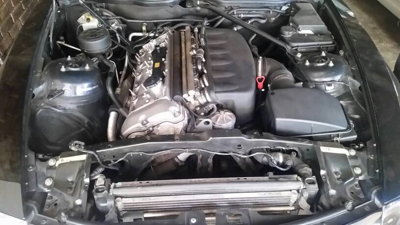

Started the car this evening and quite chuffed at the result :) Slightly rough idling with the warm up process but once the secondary pump stops things smooth out almost to a stock nature. It sounds slightly deeper than before which is exactly what I was hoping for.
