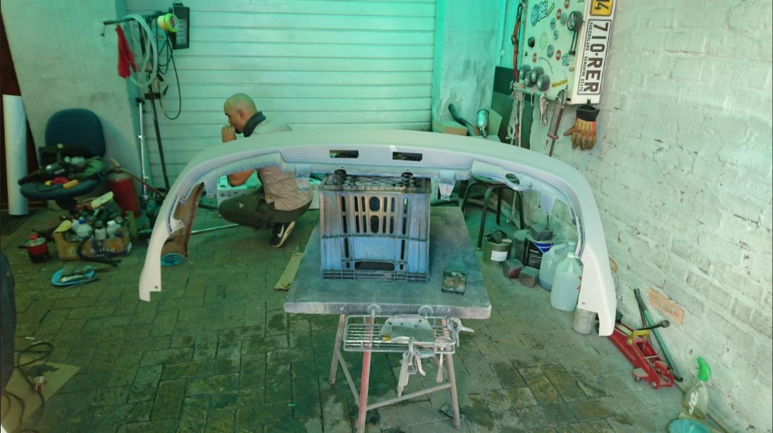

Paint prices aside, I told the B-I-L that I was there to learn, not hold him back, and so we cracked on. Turns out its quite simple when things go to plan, there's a lot more patience, skill and attention to detail going into it than I initially anticipated, and some techniques for when things go wrong that just come with time.

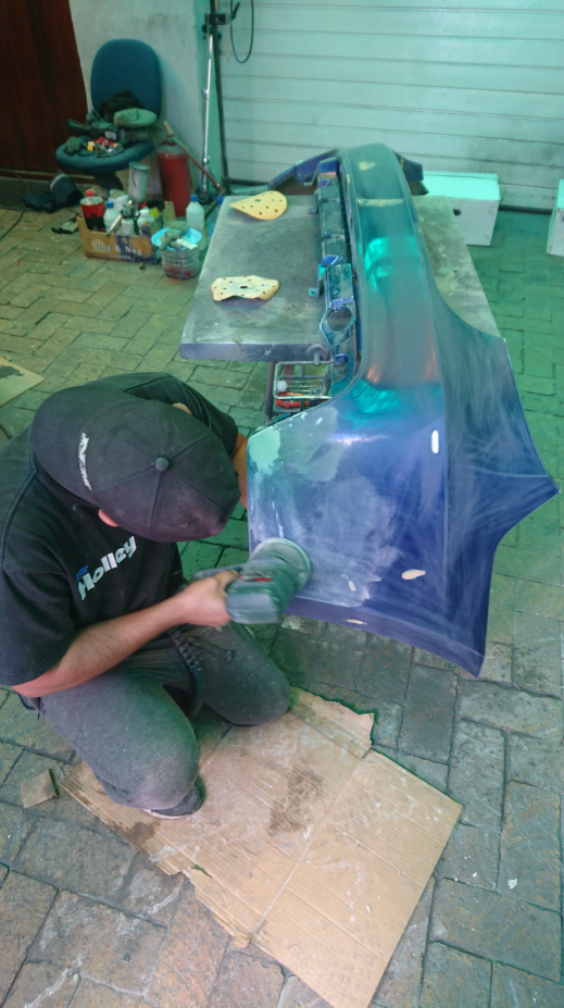

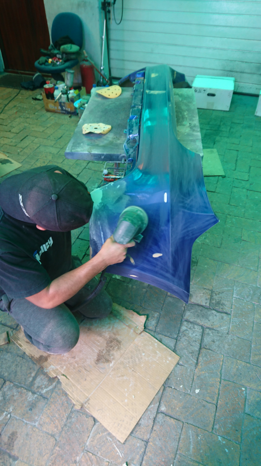

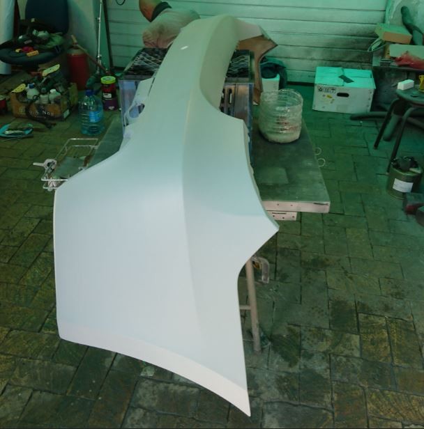

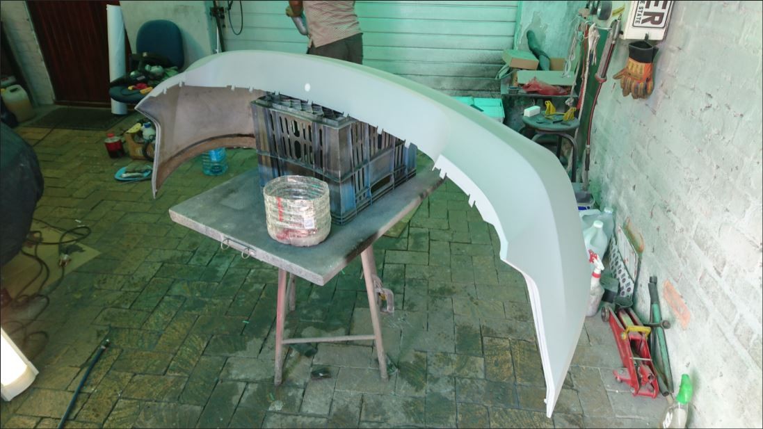

It starts off simple enough, step 1: flat down the entire surface, and smooth out any scratches, gouges, and dents.
step 2: fill all the scratches and dents

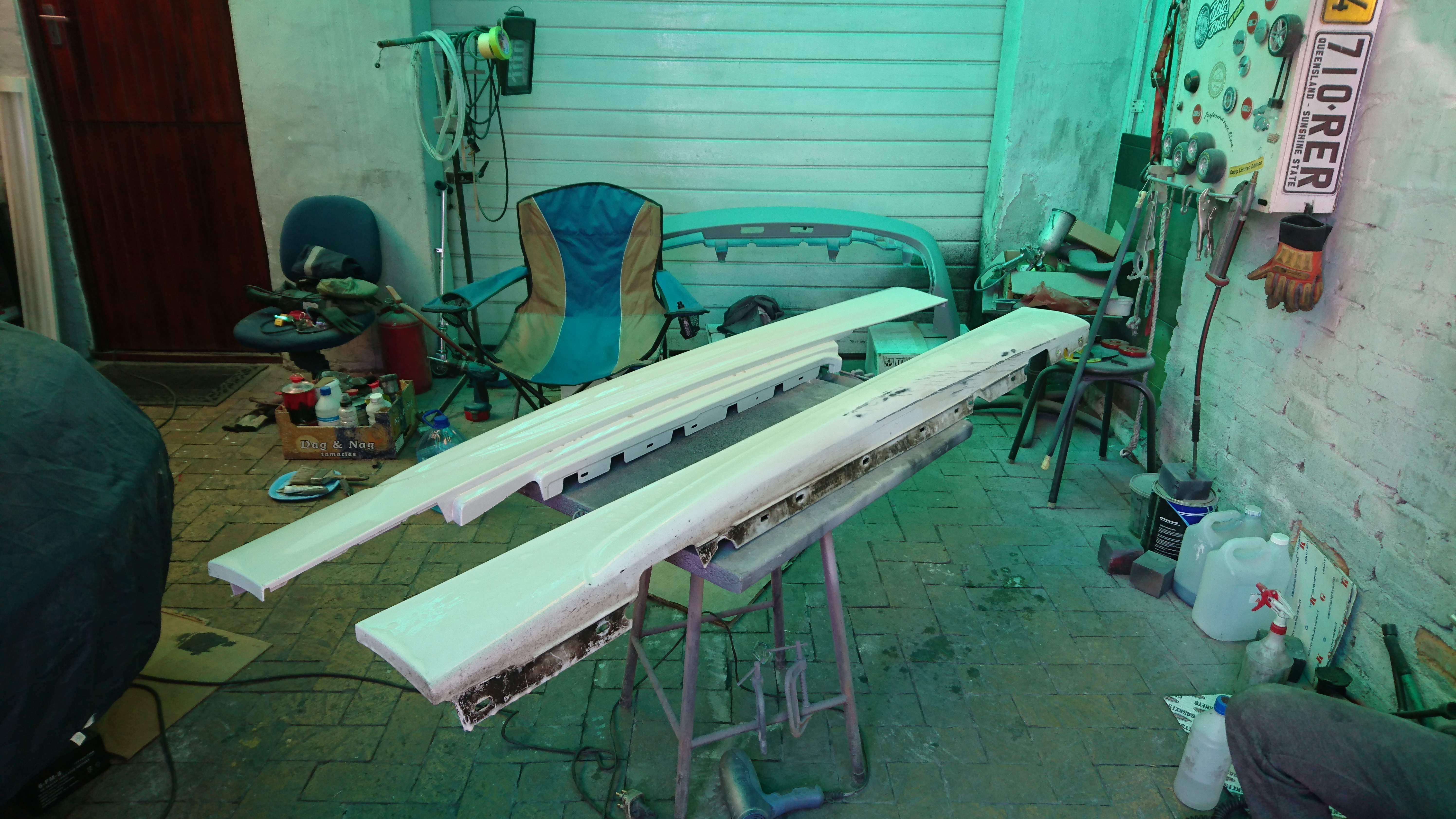

step 3: wipe down, and apply primer
Rear bumper primer pt2
This will be the abridged version

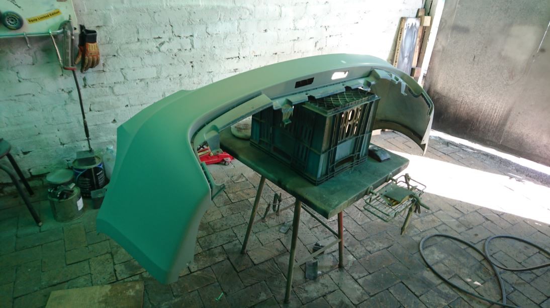

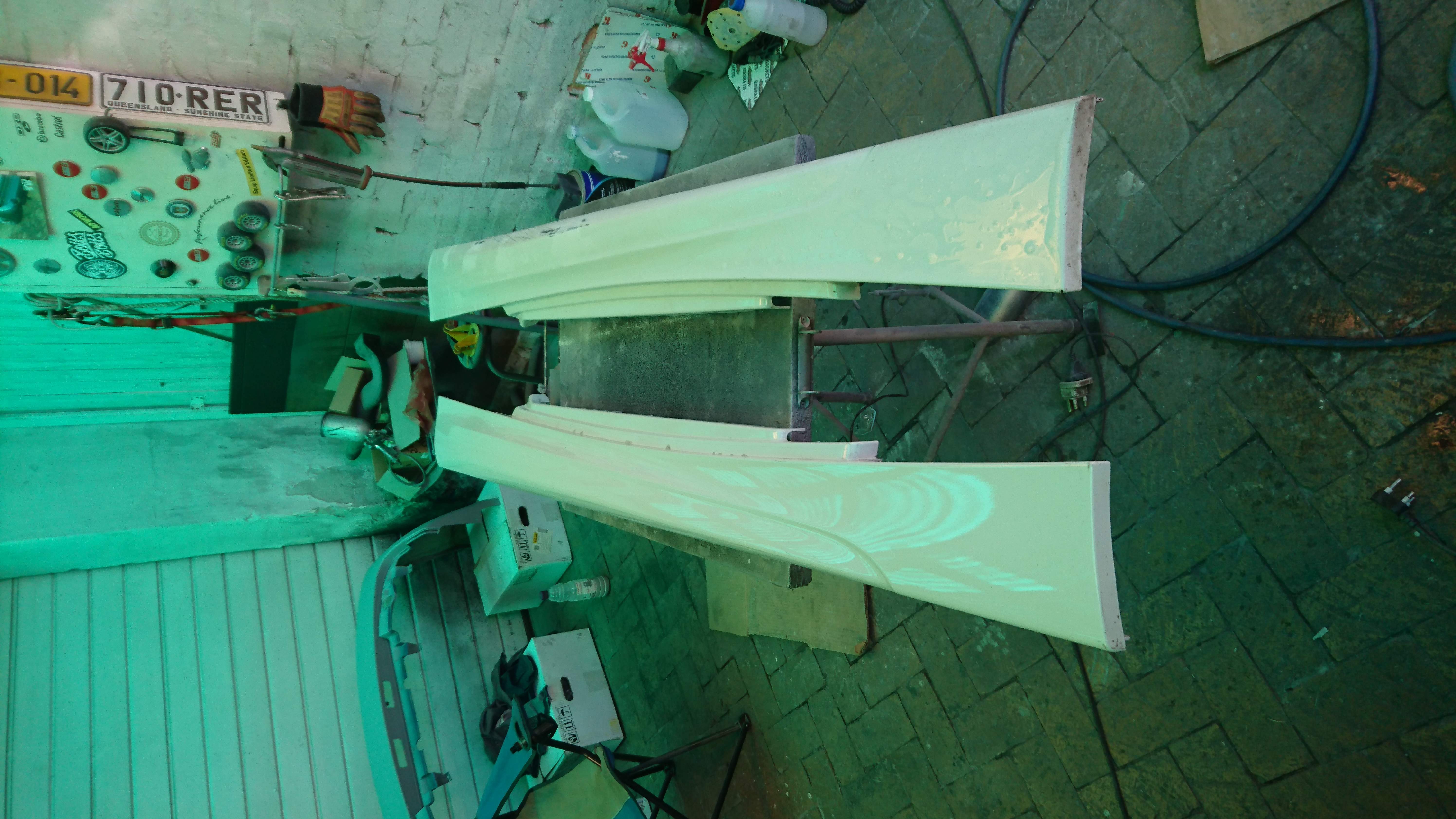

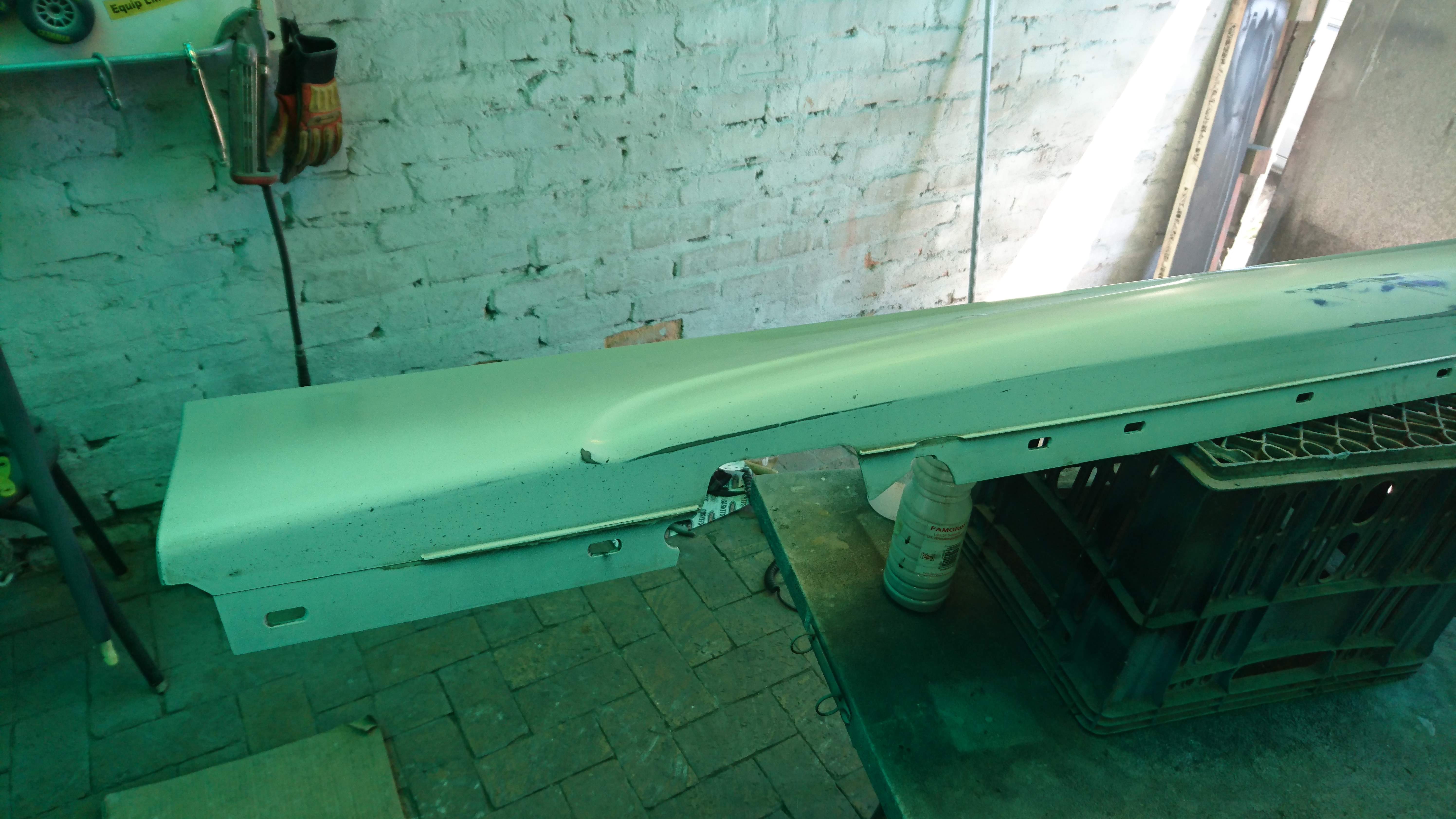

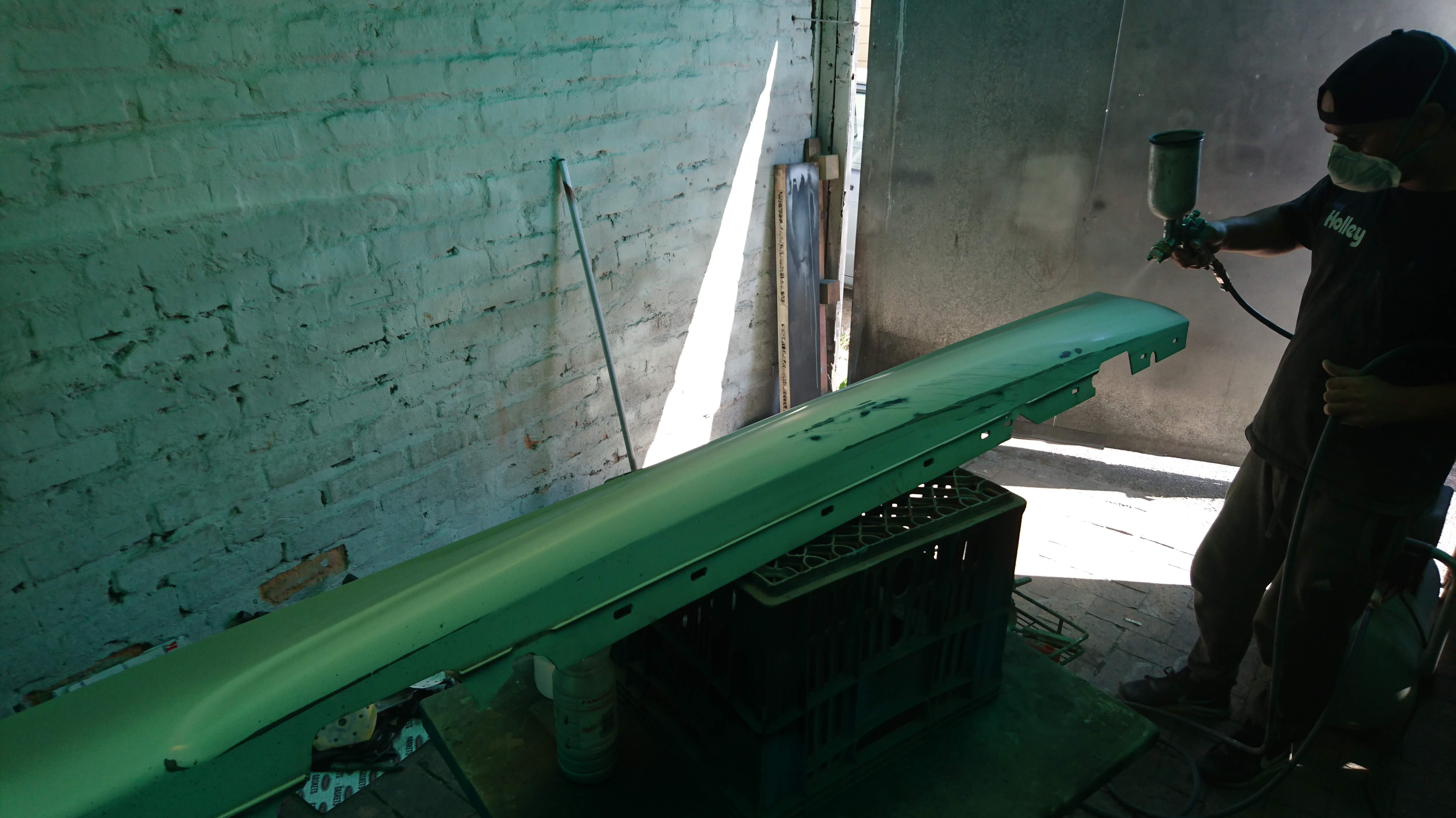

Step 4: fix, fill and flat and imperfections.
step 5: scuff and wipe down the paint surface

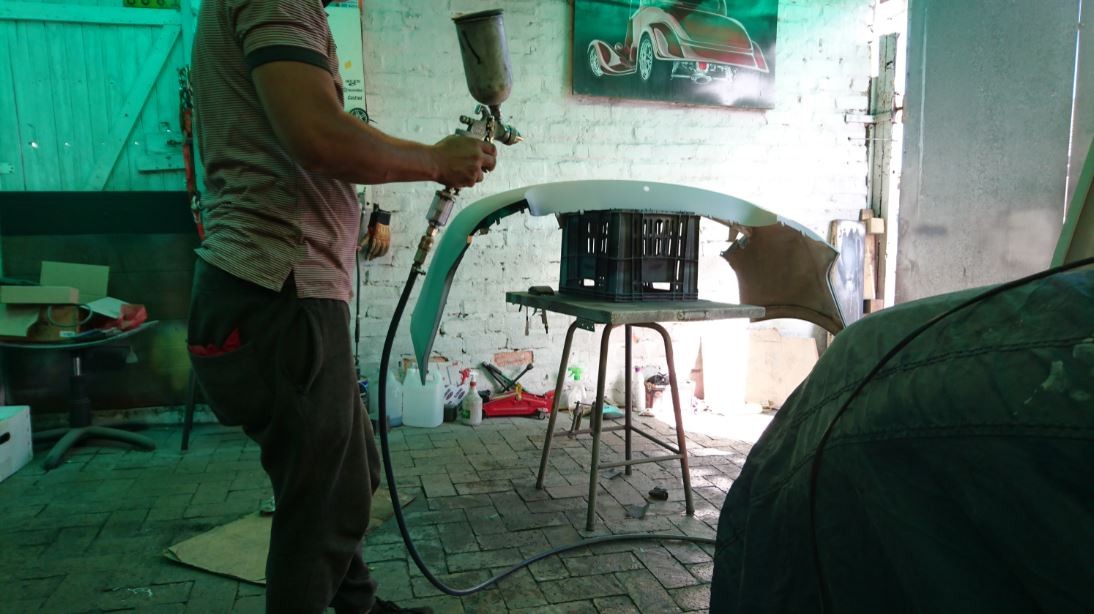

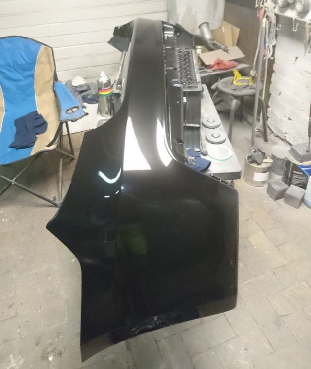

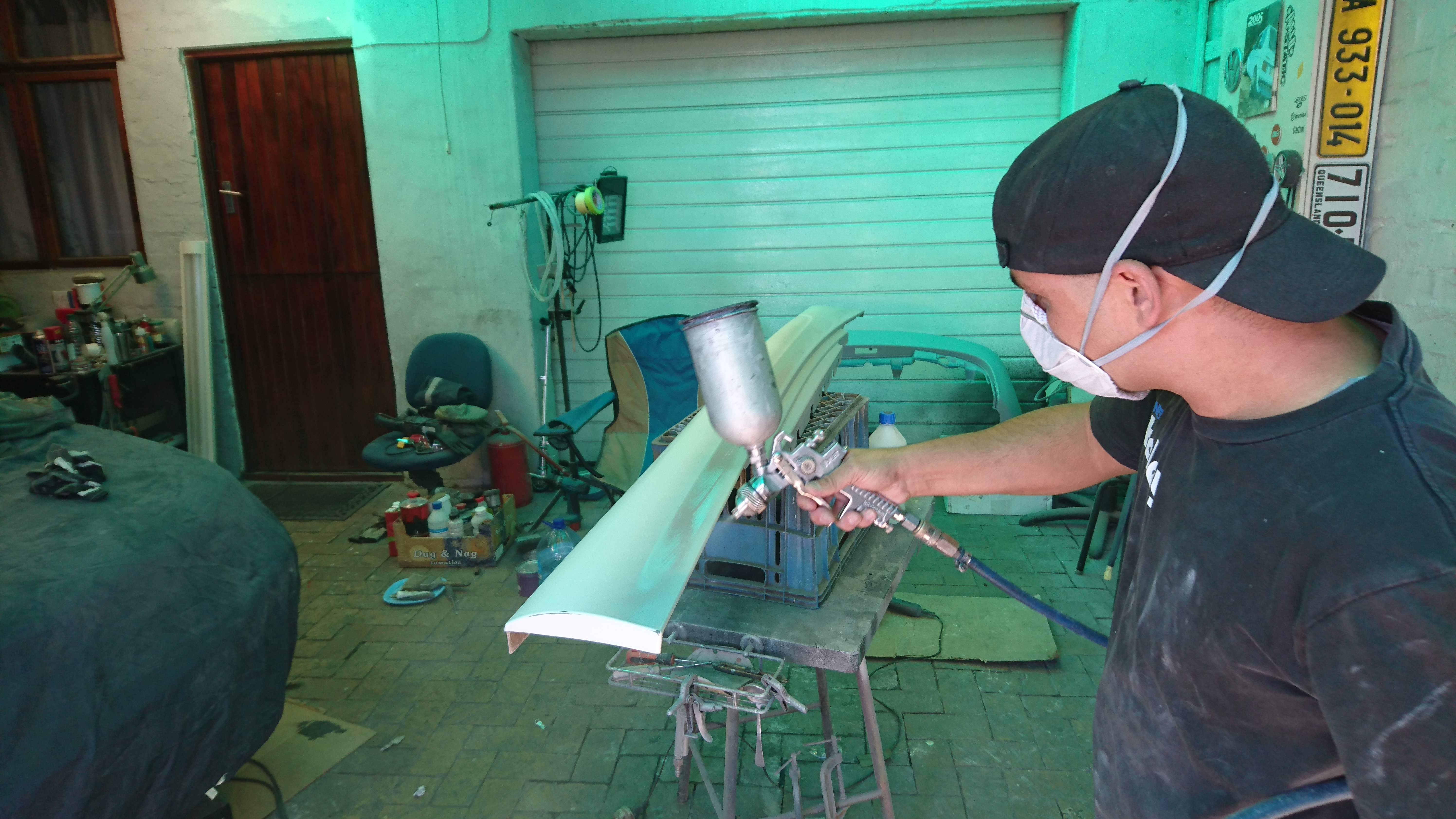

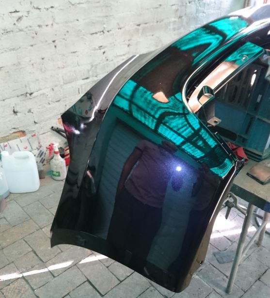

step 6: Apply color

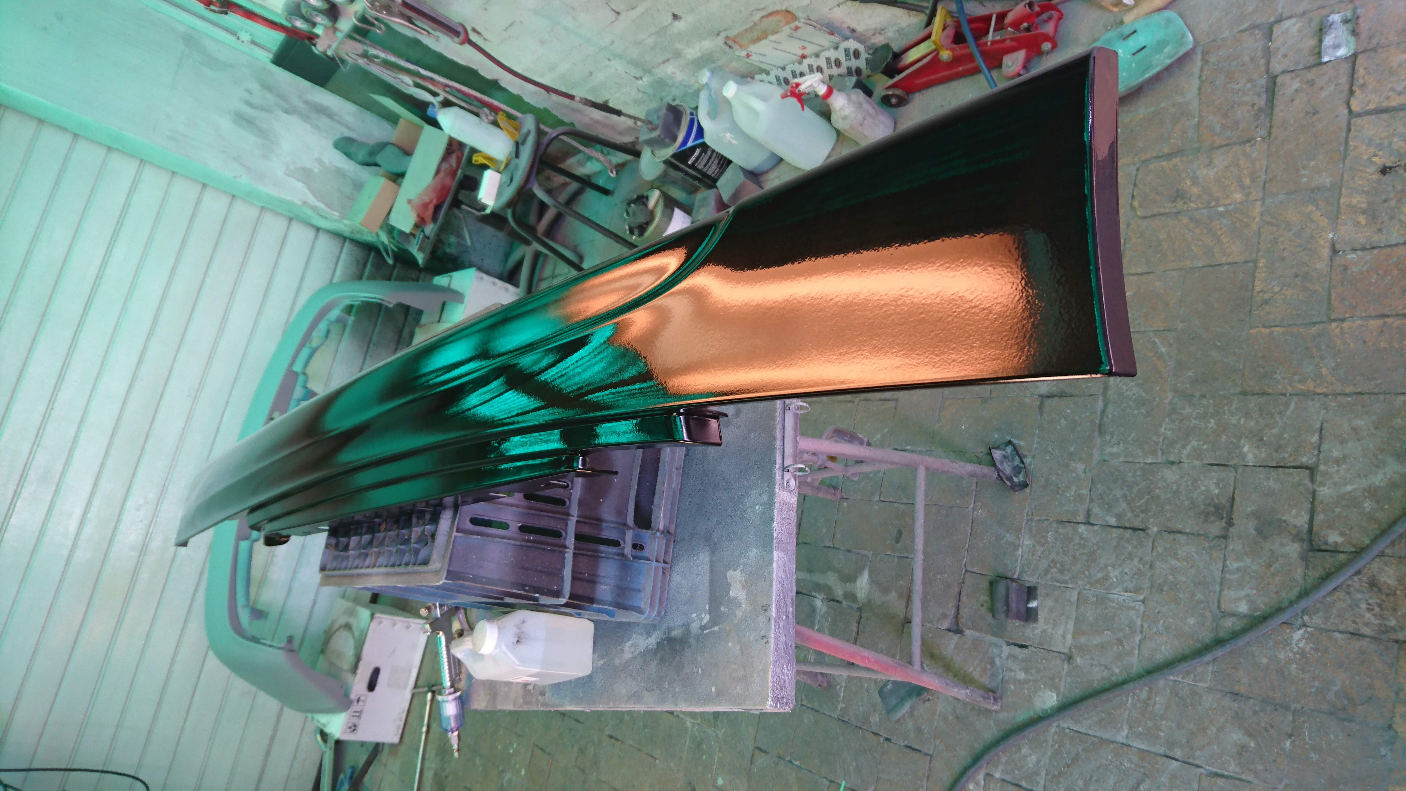

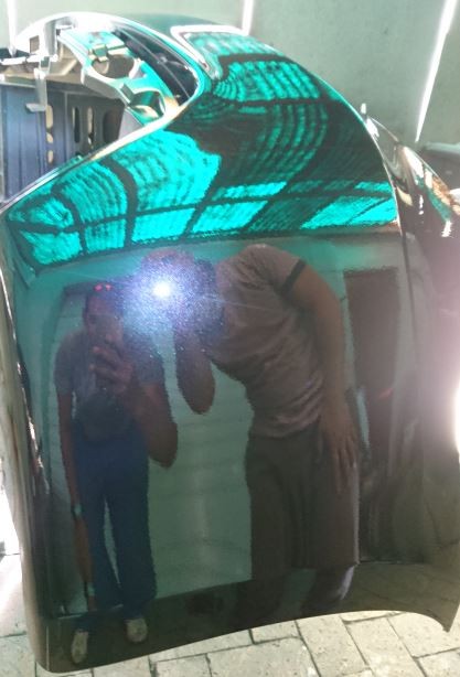

Step 7: apply clearcoat, and hide your erection.

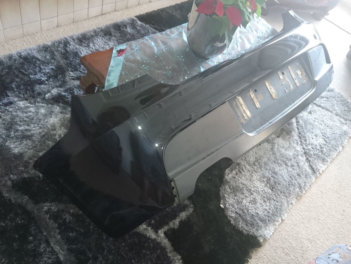

Some before and after pics
