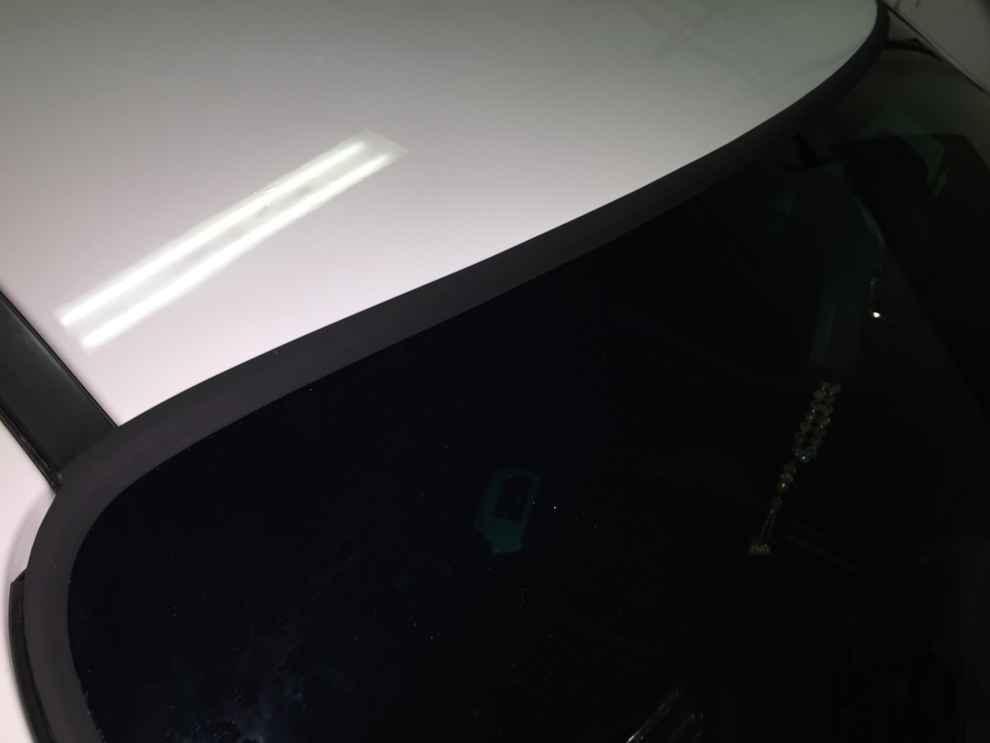

Well I couldn't wait , and I didn't really believe that I would have to remove the windshield just to add a clip on trim piece so with a little digging through the TIS , I found instructions on replacing this piece. Windshield on my car is original . So I didnt want to remove it just for this.
Step 1 : Remove old rubber by folding the edges in towards the windshield.
Step 2 : Remove rubber
Step 3 : Clean up the area ( the gap between car metal and glass)
Step 4 : Lubricate that area as well as the new rubber piece with soapy water
Step 5 : Slide new rubber onto windshield glass
Step 6 : Check if everything's fitting tight and the ( Aluminum grips are holding onto the glass edge .
Took me around 30 minutes.
Done :)
I have attached a pictures of the completed job (sorry if its to large , I don't know how to resize it)
Will take the car for a spin tomorrow and see how it goes.

So I drove the car today,High speed (not that high) , parked it in the hot sun , and shade , as well as washed it .
Happy to say , No leaks , no wind noises , no issues . Piece stays in place and is very secure.
So in future if anyone says that in order to replace the windscreen trim on an E46 , you need to remove the windscreen, Don't do it , Removing the screen (unless you wish to replace it) is a risky , inconvenient and unnecessary , costly task , and you never know if the screen guys are going to reinstall your screen again properly or crack it and ask that you fit a new one.

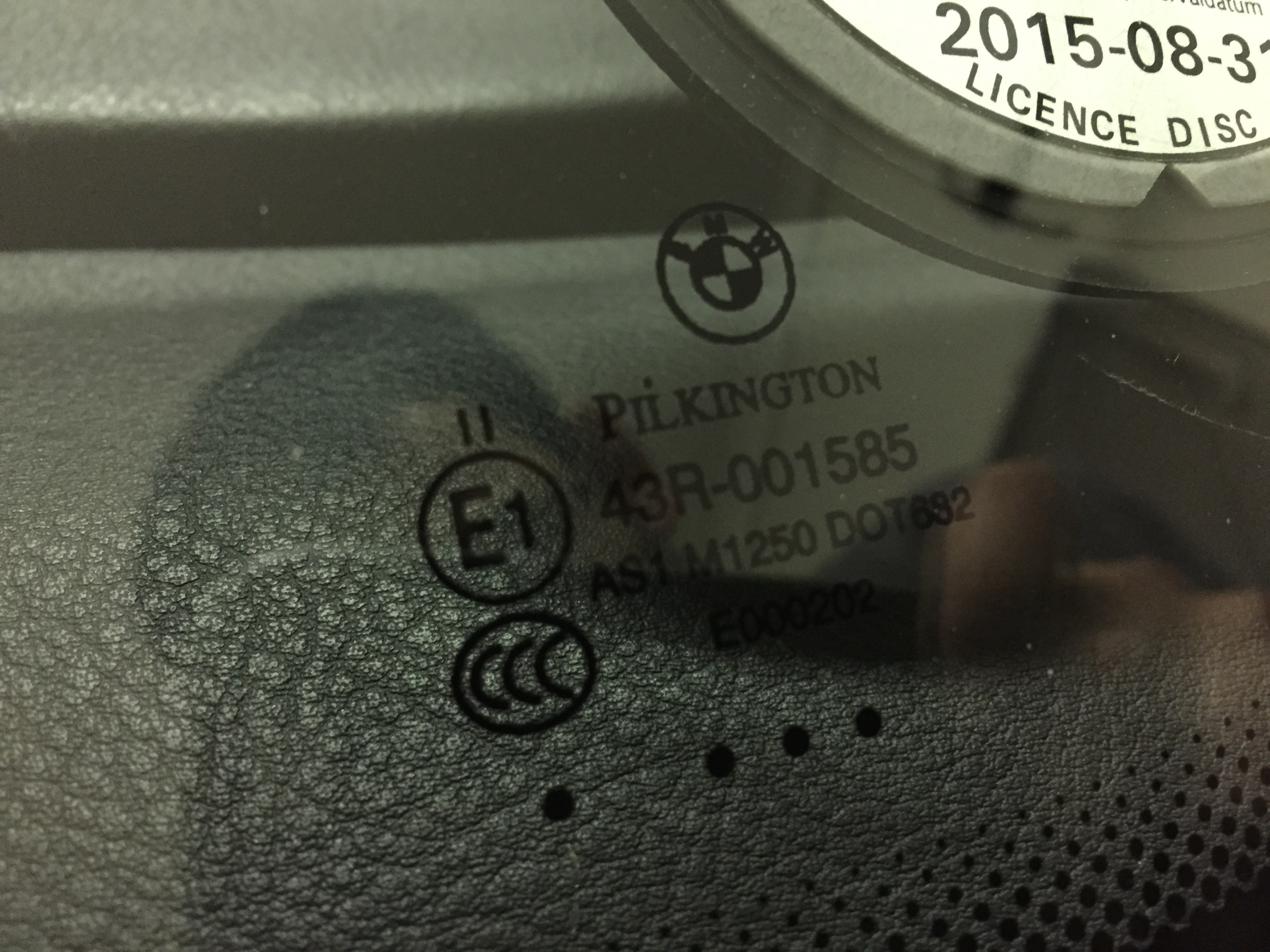

I don't think my windshield has been replaced, we had the car from new , and i don't remember replacing it , The windshield is original BMW pilkington. , I taught maybe with age , the rubber probably shrunk or has became hard. The Windshield on our E30 is still original as well,has a few chips and nicks , as well as that sandblasted sort of look, but we have never changed it, Had that car from new as well. Its rubber has started to do the same thing, around one corner, I haven't gotten around to replacing it , thought I might as well replace it when the time comes to replace the windscreen , though the cars hardly used now.
