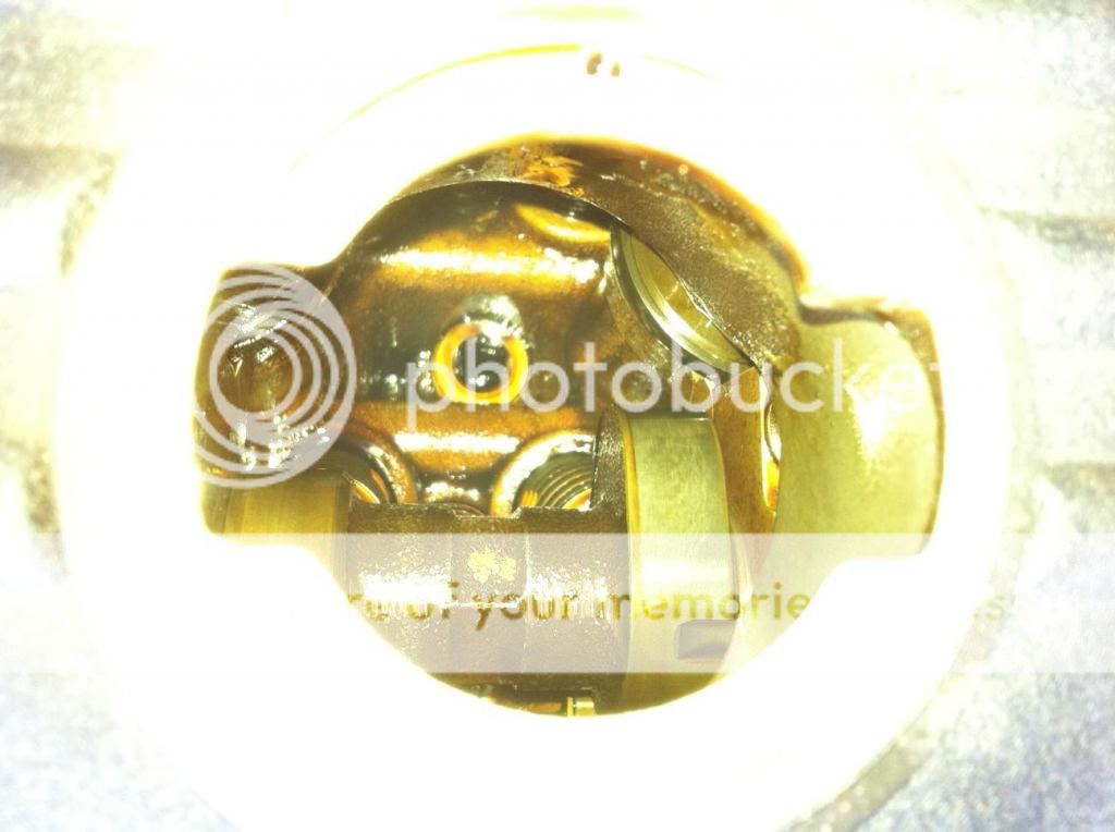

I managed to get a view of the cams.
Your thoughts would be great to hear.

Rather opt for a well maintained higher mileage than a neglected lower mileage one. The short answer is yes. Unless they can prove that a lot of the expensive maintenance items have been done, it will cost.
Knowing most people they just ignore it until something breaks. Like that knocking noise. Rear diff bushes, or prop coupler/guibo. Diff+gearbox oil never changed etc. But on the bright side it's not uncommon to see these motors run well over 200k km. Also you know at least this motor isn't suffering from any of the recall issues with the mileage it's on :thumbs:

Well, it seems to have everything done when it has needed it... That being said, that noise has apparently been there for a while. Wonder if it could also be a broken floor? Apparently this car is still on its first clutch, which does say alot about how it has been driven.
