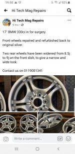

In tune with the sleeper theme, the road wheels got a little adjustment.
This setup will allow 245 / 255 front rear respectively,  with a flush fit.
