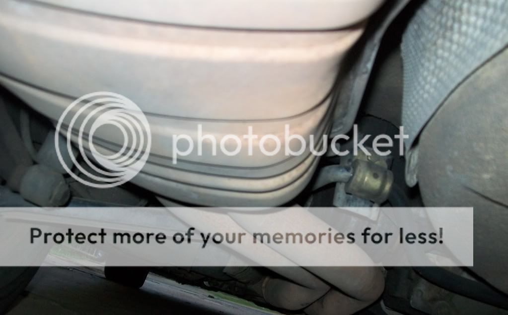

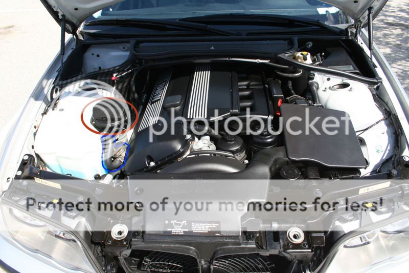

Hi guys need some help on my Bmw 330i 2001 f/l ,since we bought the car last year i notice that there is pipe just hanging there not connected to anything,at first i thought it was a breather pipe but then found these pics and saw it is connected to something.
The part circled in orange is not there ,but the part circled in blue is there .
Any idea what the part circled in blue is ,where can i get it ,how much will it cost and is it important

What I know is that's the part that recycles the air for even better co2 emitions control.

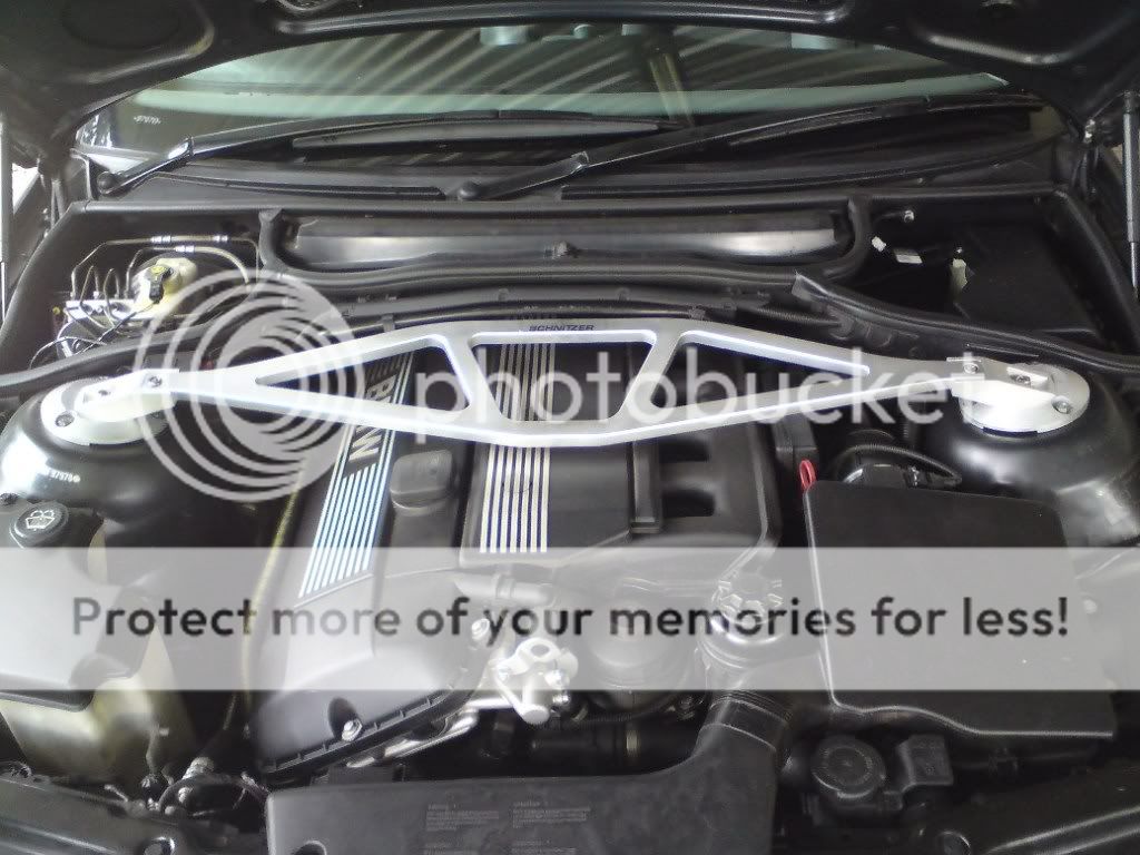

My car doesn't even have it at all... see picture:

Coisman said:
:pimp:
I see that i wonder why the previous owner removed it ,would this affect performance

Strange that you even have the pipe, as the axillary air pump on the non-M's came on the US models where the emission laws are stricter (the e46 M3 did come with it this side however)
Can't think that it will cause any changes in performance.

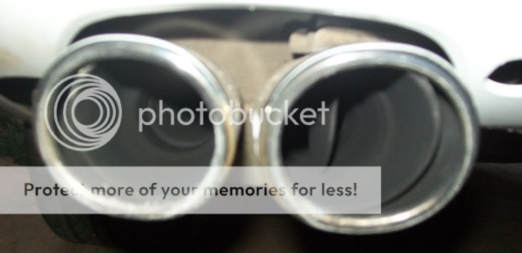

Mo,maybe that's why your car sounds like a bloody v8 :roflol: On a serious note that's really strange that the other guys don't have that piping or even know what it is..
Do me a favor and please check your back box as to whether or not it's a standard one as I suspect your car could have been modded especially now with this discovery. Maybe ask the guys to post picks of their back boxes and compare

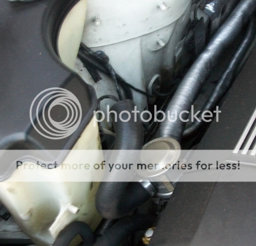

Maybe also post a close up pic of the pipe on your car as well if you have time, find this really strange...

Updated the pics ,leme know if yours is the same as mine
Exhaust tail pipes
Close up
