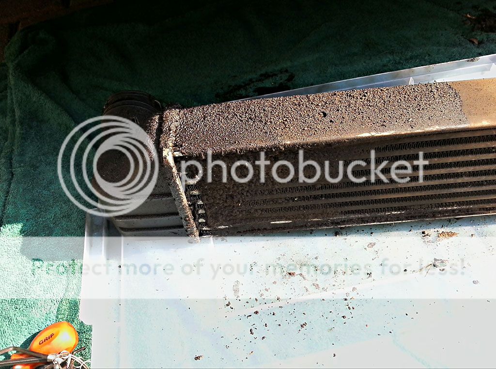

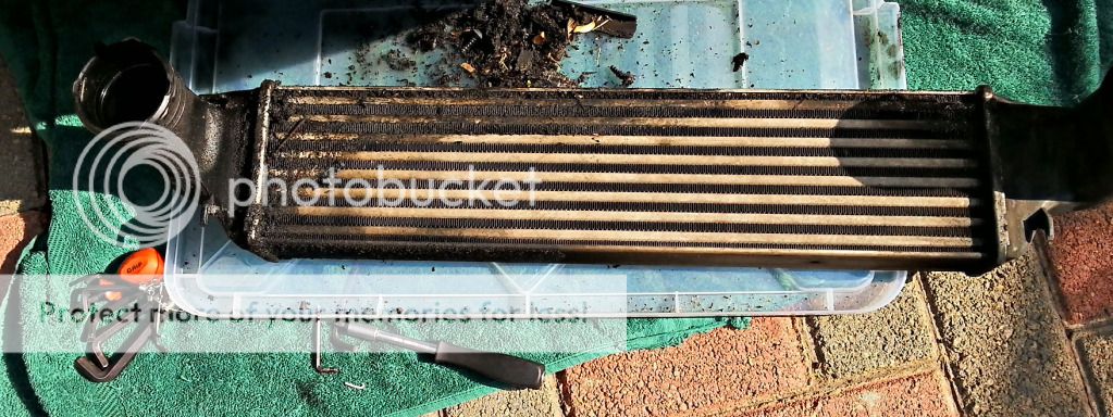

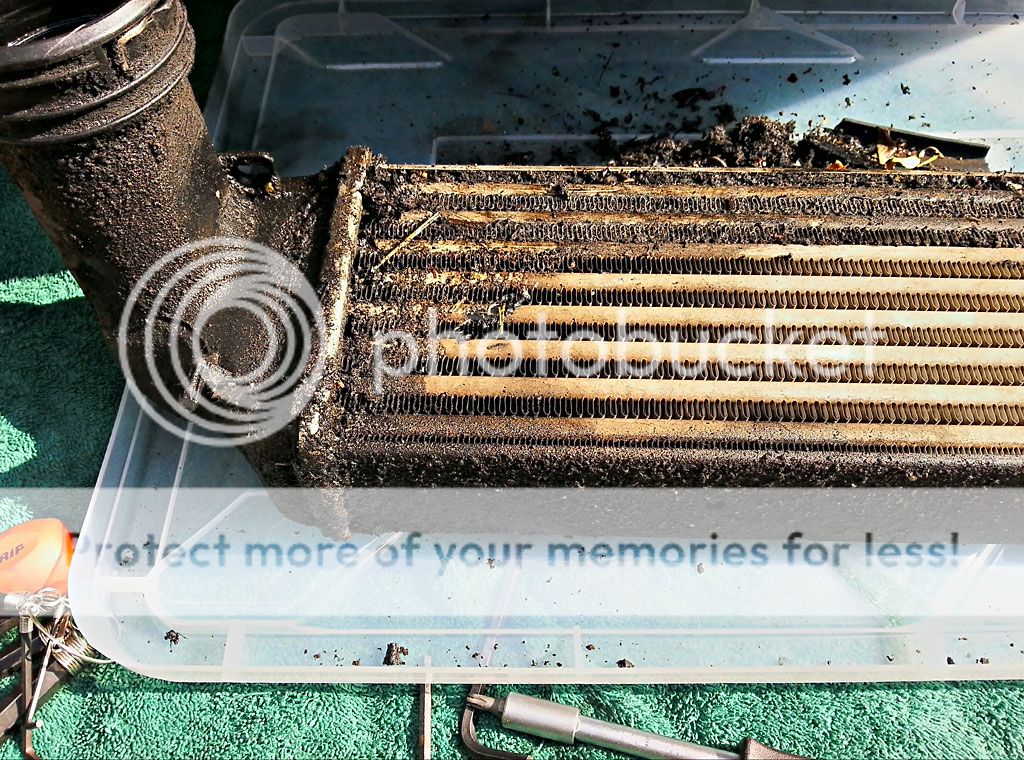

Here is how bad the old intercooler was! you can see where all the gunk build up is there is a boost leak, when I filled it with water the water just dribbled right out!

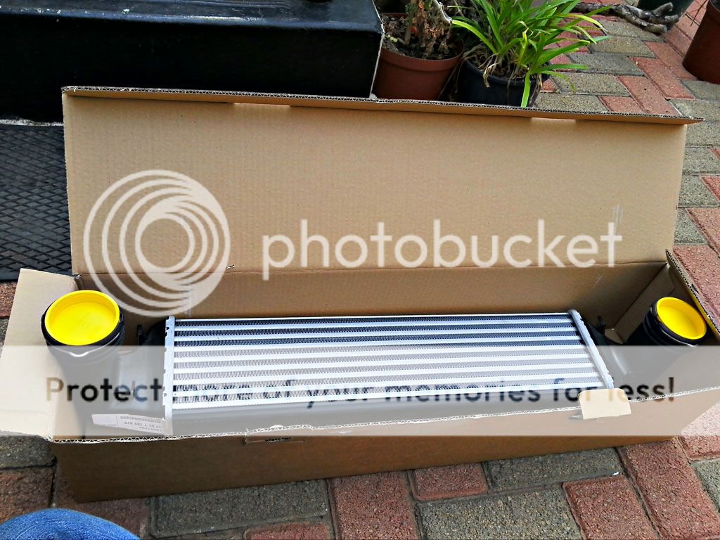

and here is the nice new one
