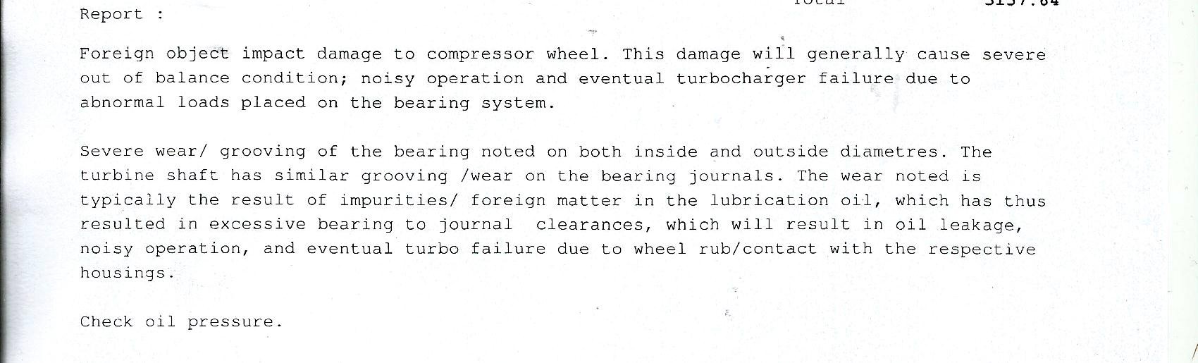

can someone help me,i had a turbo failure and replaced my turbo,changed all the filters even the breather vortex filter and the 3000km later the turbo failed again(my air filter pipe that goes to the turbo had a small little piece of metal properly from the other turbo`s failure in it and damaged the blades abit)so i just wanna find out what other precaution i can take to prevent this from happening again and is there something else i need to do before fitting the new turbo again.i will attach the report aswell what they send me
