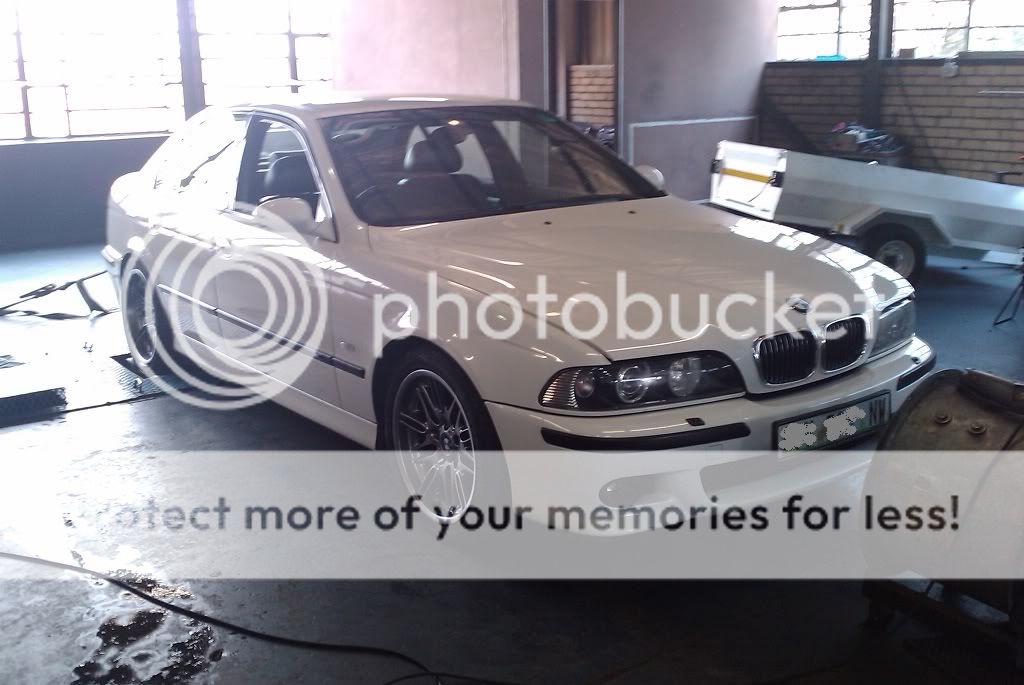

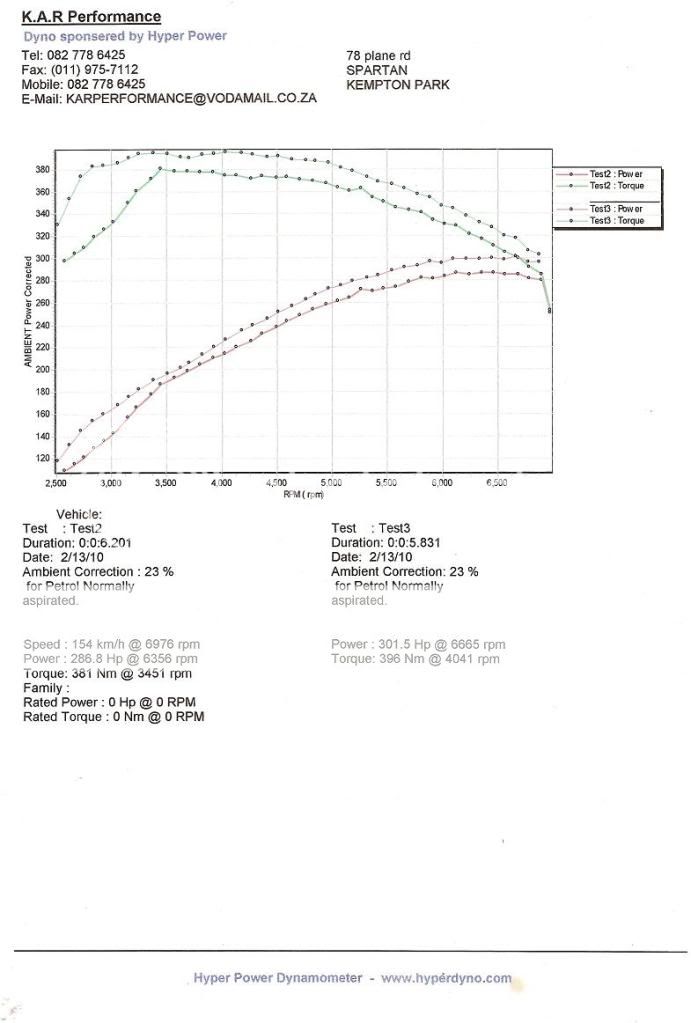

Car came in with exhaust & induction. All we did is remap. Fixed a big hole at the bottom as well. 60NM gain at 2800rpm, by fixing the fuelling at that point. Car pulls like a steam train from low rpm now & hits the limiter hard, still wanting to rev.
