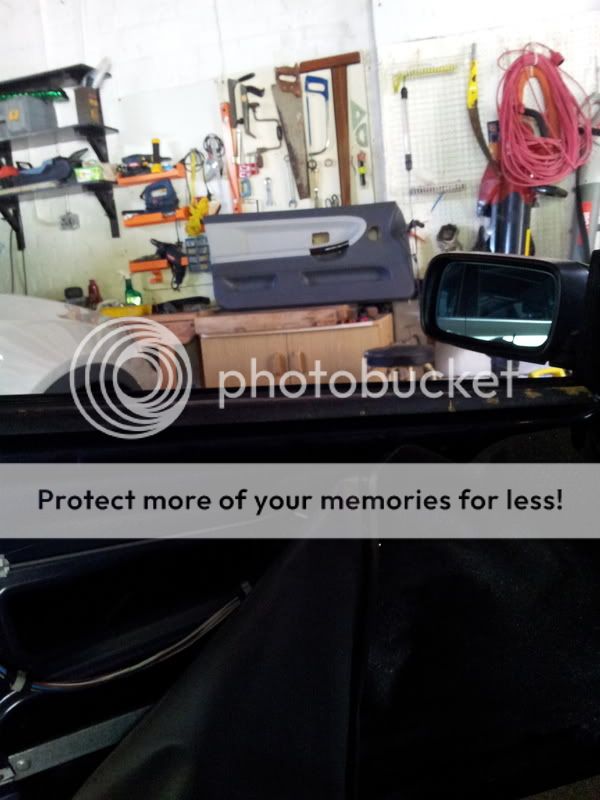

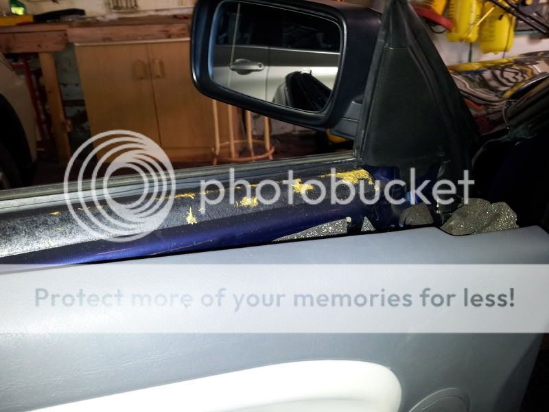

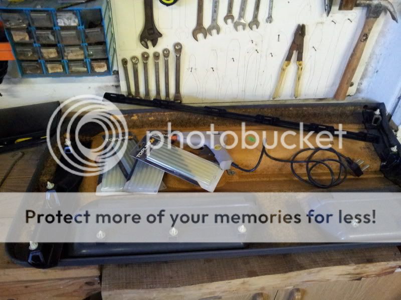

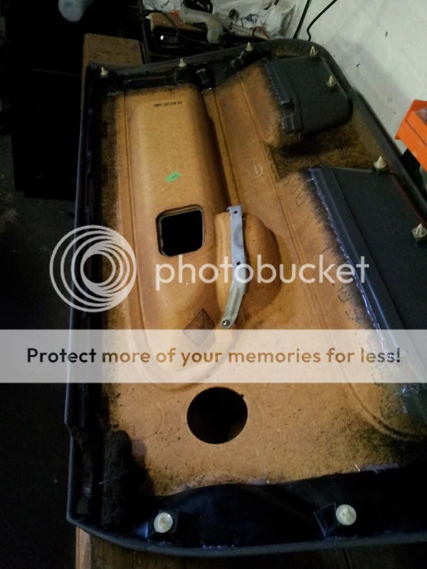

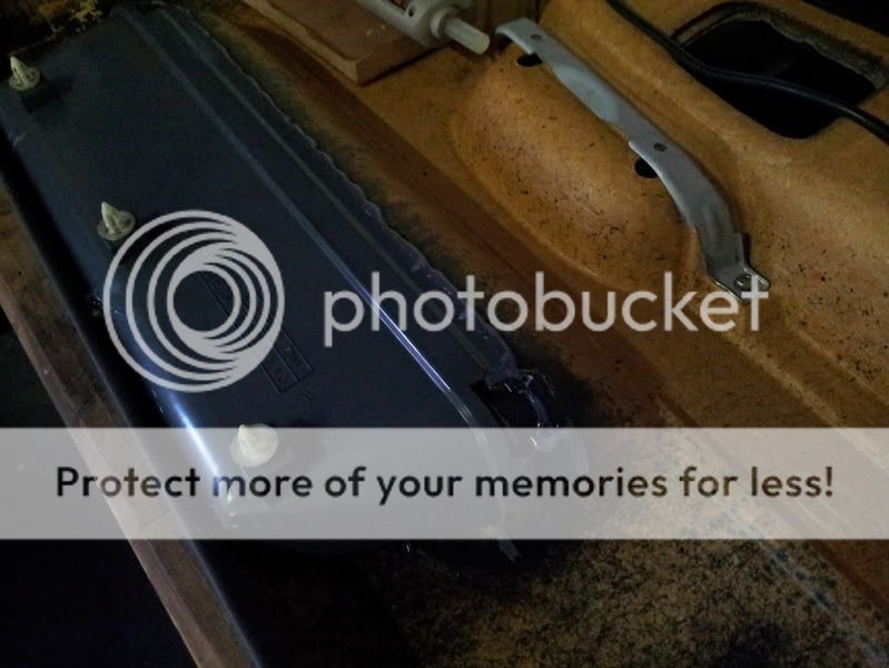

So I spent some time rebuilding the door cards today. Couple of the magazine holders where loose and there were a couple rattles.
Got very lucky, only one broken clip, but I didn't bother changing it. Not yet anyways.
This was my basic method:
[video=youtube]
Here are a few pics, I know us fanatics feed off pics.

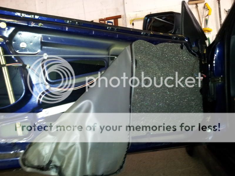

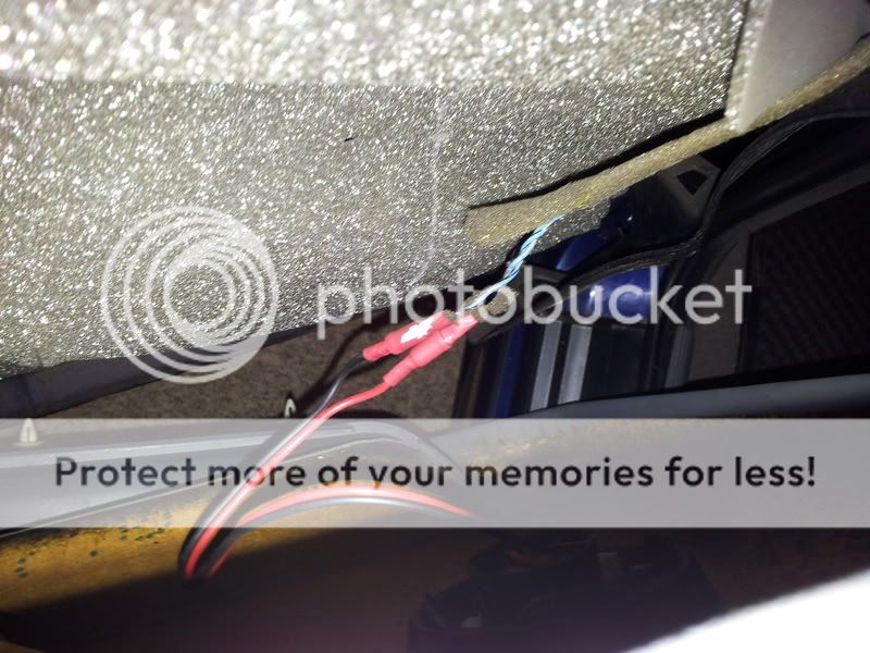

FFFFF... They cut the stock plug off for aftermarket tweeters :argh:
Door Card off
Time for the glue

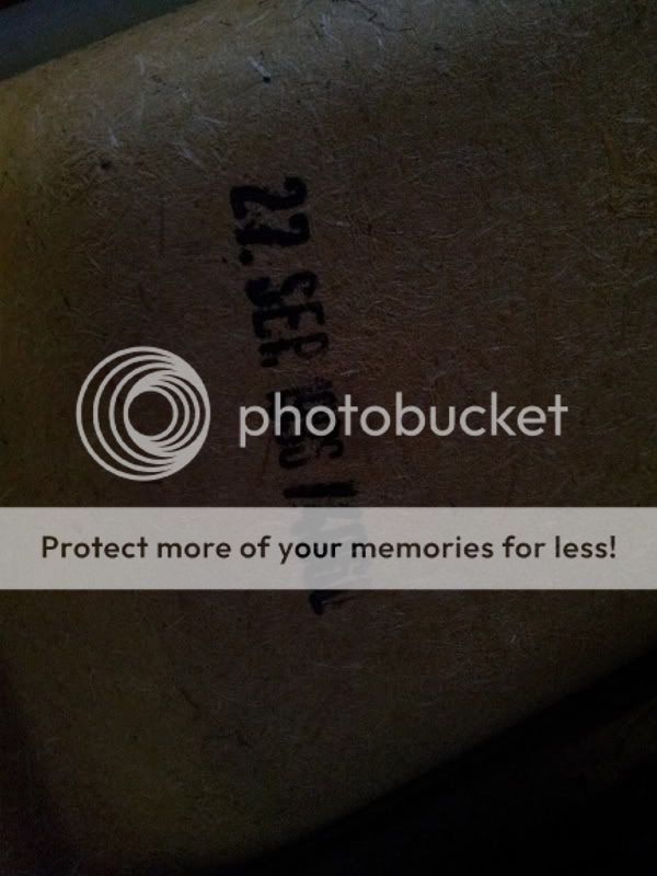

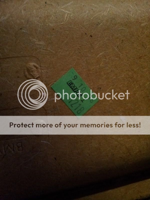

A couple dates:
First the production date of the card, drivers side is 31 Aug 1996.
Confirmation of the car build date 9/10/1996.

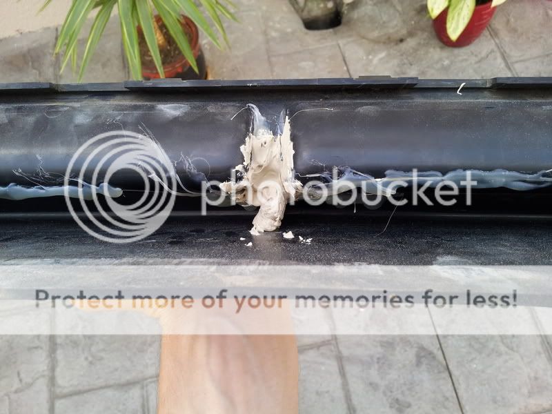

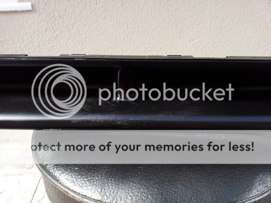

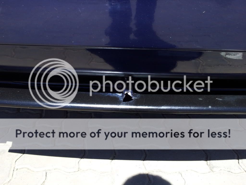

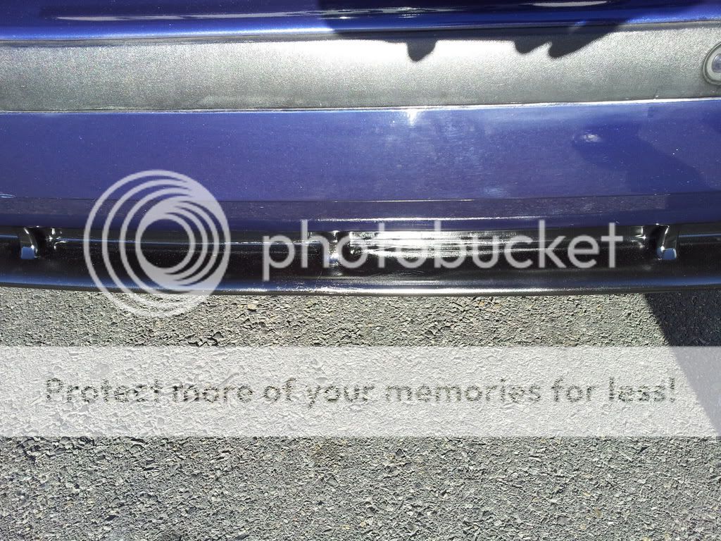

So over this weekend I decided to do a repair on my diffuser because it will be quite a few months before I have money to replace it.

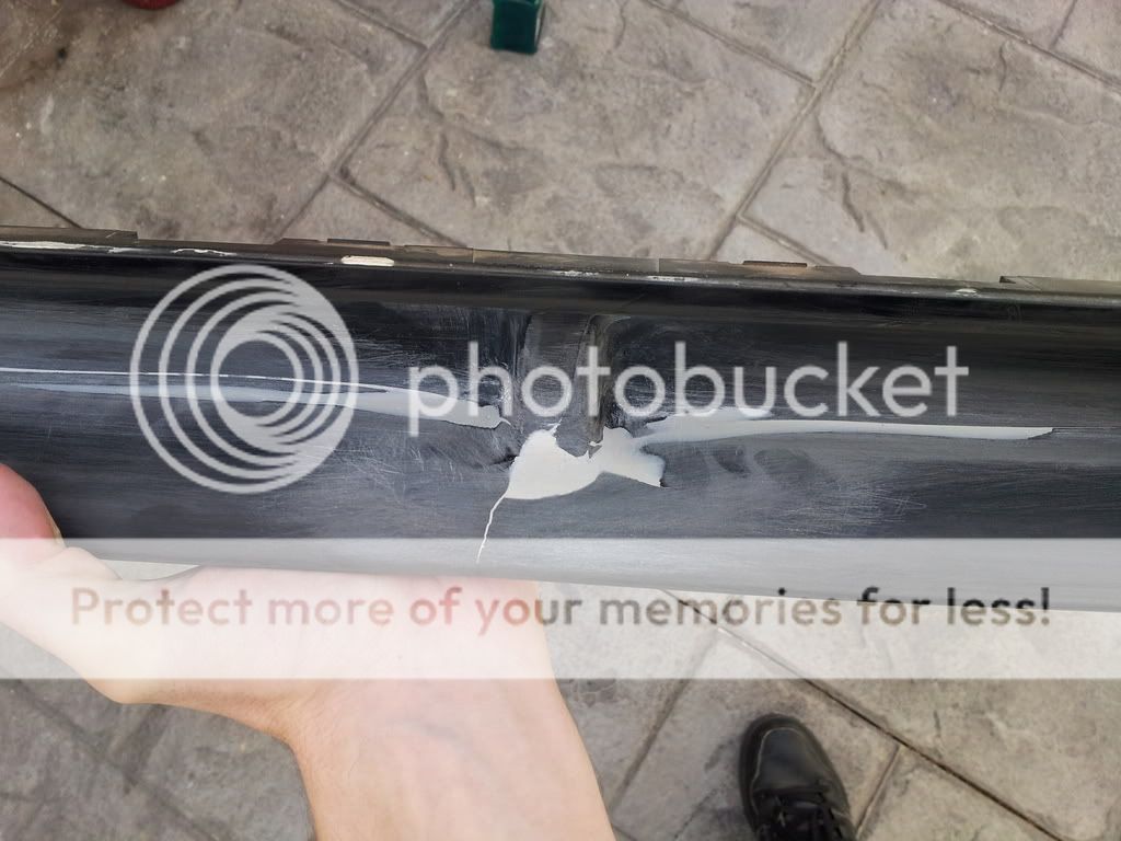

Here is what it looked like:
So I bought some of this and got started:

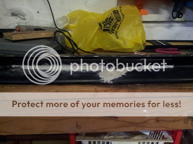

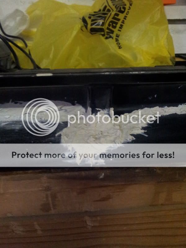

Here is the filler applied. (The hole is backed with a small metal plate that I glued in from the back so the putty has something to stick to):
As it turns out I used waaaaaayyyy too much putty, and it took me more than three hours to sand.
This is the sanding result:
After priming and painting. (Stupidly, it didnt occur to me to get a filler primer to help with the scratches caused by the initial rough sanding):
I am happy with the final result, if it wasnt for the sanding marks it would look like it was never even broken. looks much better than it did. If it lasts I will sell it cheaply when I eventually buy a new one. May also give it a very light coat of matte black because the semi-gloss I used is slightly too shiny.
