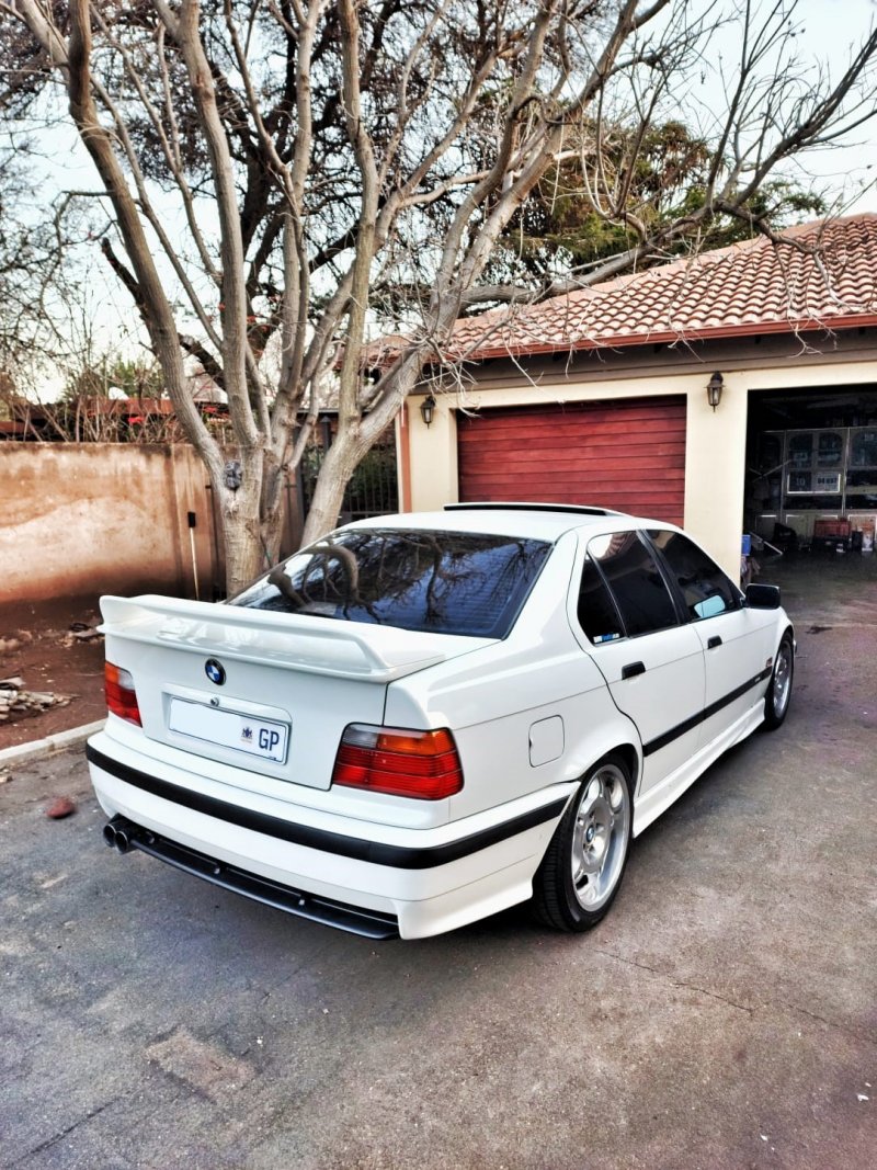

My Rear lights were giving me endless issues and i wouldnt find decent replacements so i went back to the OEM ambers and i actually prefer them this way.

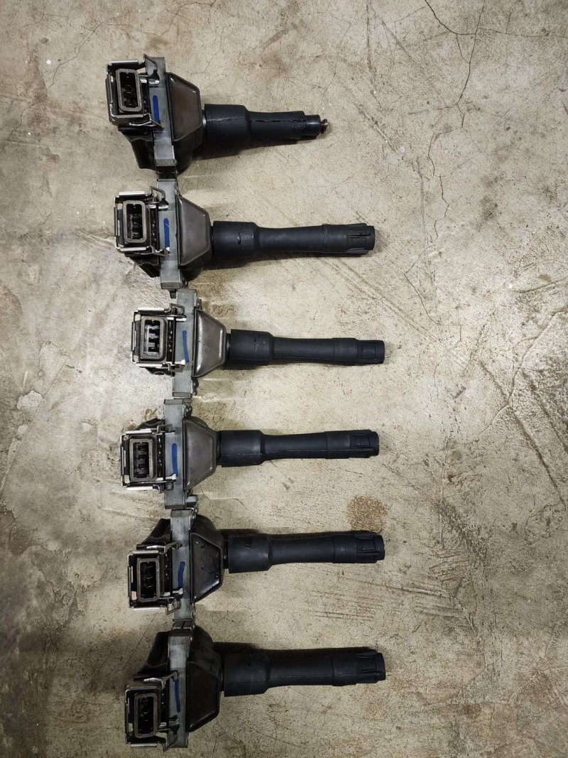

Was also having an issue with intermittent power at low RPM. Found that the intake boot by they vacuum line had a tear. Replaced that and although it was much better i still felt the power was not were it needs to be so i decided to put in new spark plugs. When removing the coils i saw that number 1 coil suppressor was broken. 1 hour mission to get the broken piece out. Finally replaced that and no more power issues :)
I still need to do the vanos seals but thats a mission of a job by looks of it.

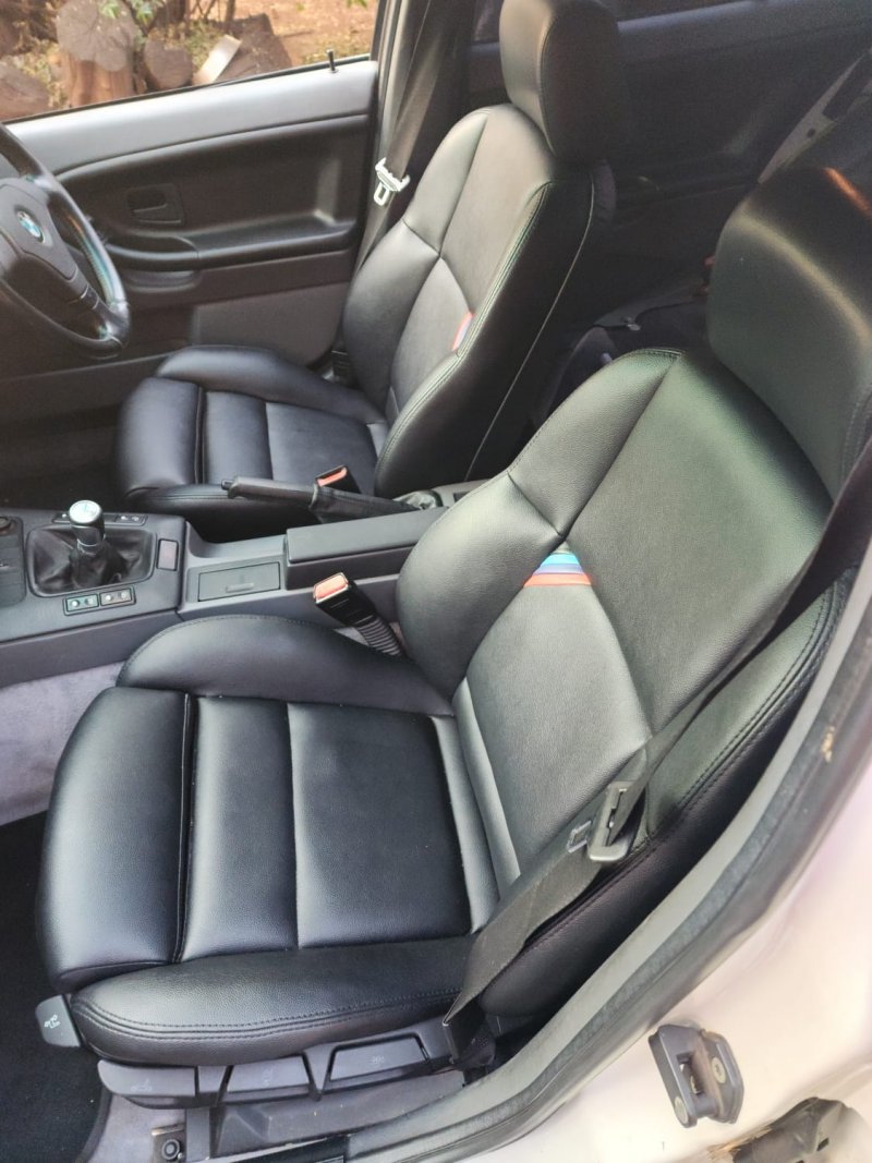

Found a nice set of Sport seats. Cleaned them up and fitted.

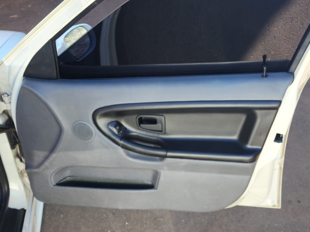

The seats are black so i decided to make the door card inserts back. Compliments the seats well.
Used the Rust-Oleum Fabric & Vinyl spray. Works amazing and covers well.
I need to recover the rear seats as they not as great as the fronts.
I forgot how comfortable these sport seats are compared to the standard ones. Feels great.
