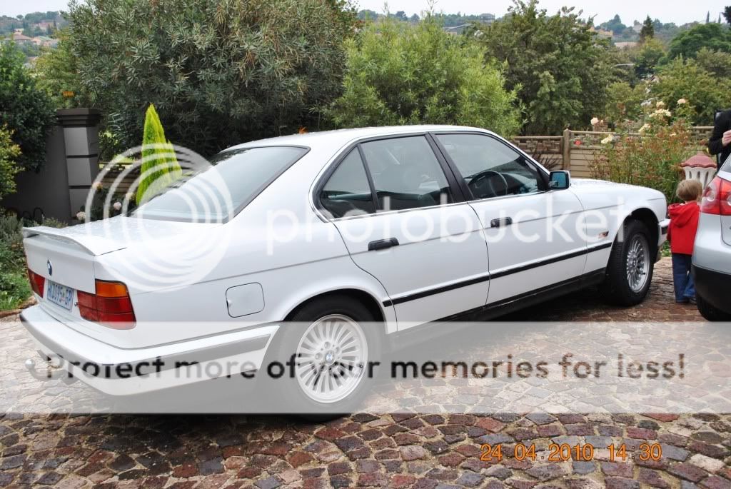

First is, the horrid sagging bumper.
As you can see from the pic above, the bumper hangs at the point of the wheel arches, making it look crap, this is due to broken clips.

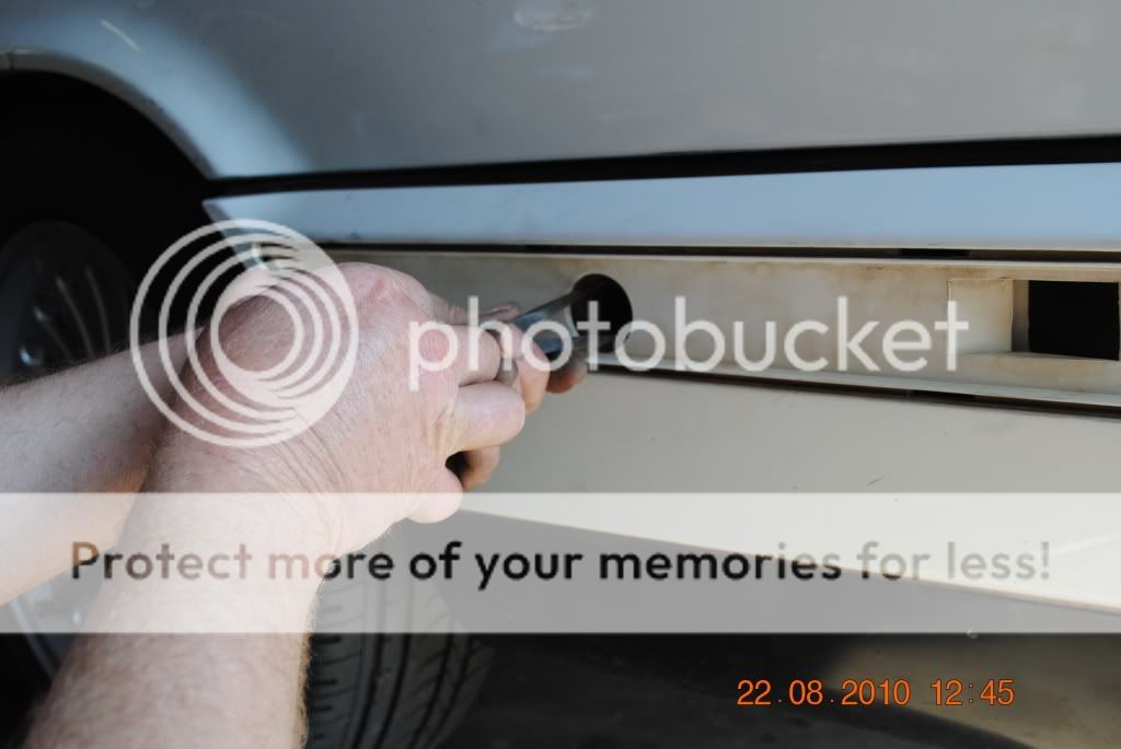

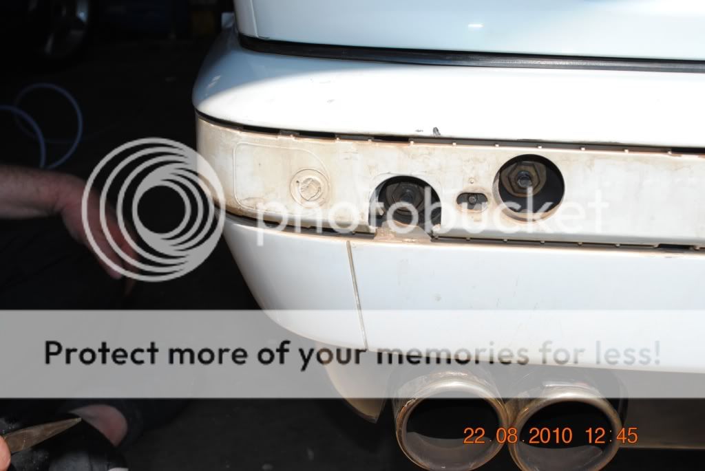

If you pull off the black trim, you will find 2 bolts on either side of the rear bumper, undo those.
Then on the side of the bumper there is another adapter that sits in
their, and is locked in place, using a flat screwdriver will get this out.

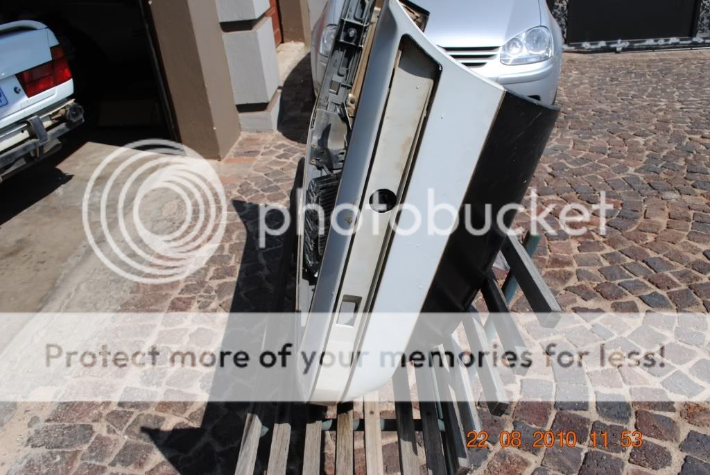

Then the whole bumper will just pull out.
Identify what componets are broken, and replace them from BMW..

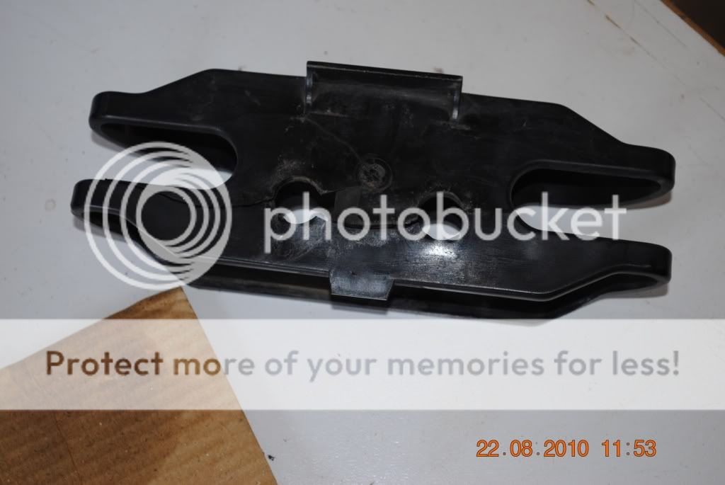

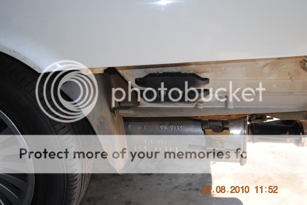

Here you can see the carrier strip already bolted to the car

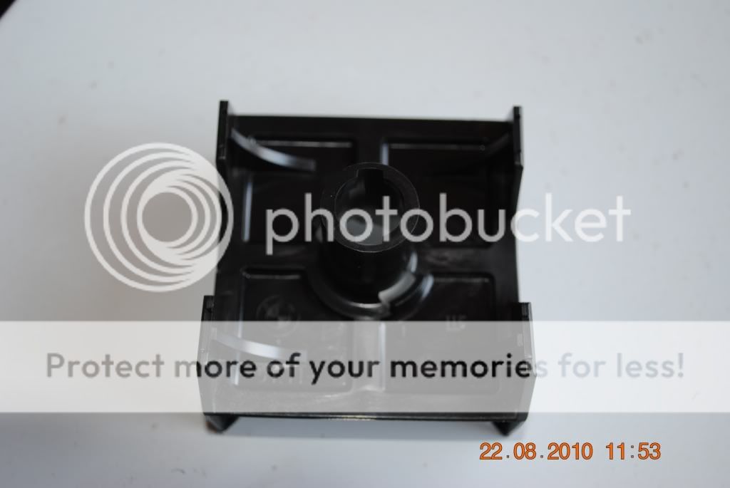

Here is what the clip looks like that fits into the side of the bumper
It has slots on it that needs to go over the carrier strip already on the body.
