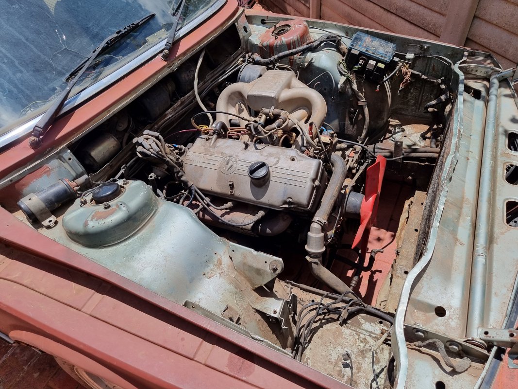

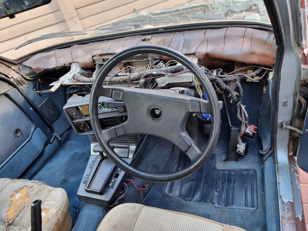

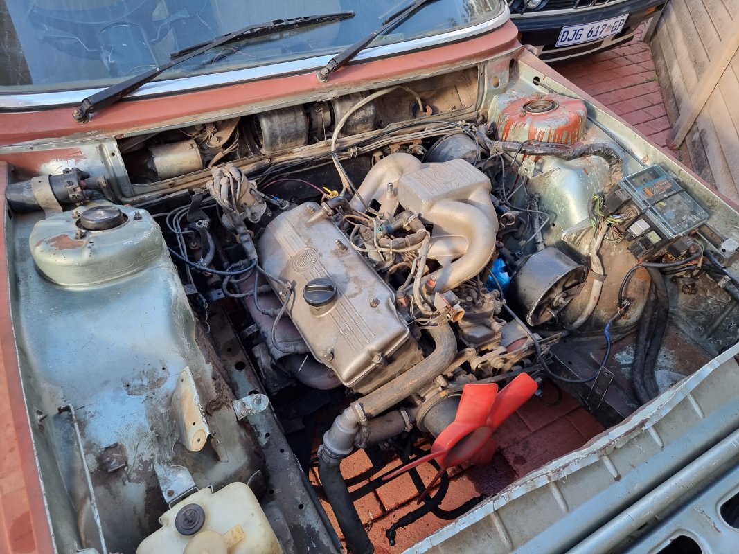

As promised in my previous post on this thread I mentioned that the past weekend was going to be busy with the e12, firstly got down and dirty on Saturday with a m30b35 which was not pumping oil to the cylinder head, the finding was that the guys who built the engine didn't care and left the oil pump sprocket nut loose, only because they had initially stripped the thread on the oil pump shaft, we were lucky enough to still have the original oil pump as these cost 10k at the agents and were able to rescue the engine, it's purring like a proper 535i now. Then the resto e12 which I have, consumed my entire Sunday but was fun, put together the m10 engine, sorted the wiring connections in the engine bay, hooked up the second servo on the braking system (complicated e12 braking system) and cleaned up here and there in the bay with a brush, engine wash to come soon. Enjoy. I will keep updating as I go along.
