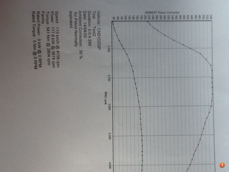

Part of the percentage by default on the dyno at set conditions will vary from dyno to dyno as Hyperpower uses it for calibration purposes. I.e on one dyno if the temp is set at a default x temp y barometric pressure and z humidity it will result in the correction factor of 19% and the next dyno down the street 28%. I think KAR's new default sits at 29%. It use to be 24%. It doesn't really mean it's added power onto the true power. Whatever weather conditions where changed added a percentage point. Probably higher temp and humidity.
The petrol normal aspirated, turbo etc does not change the outcome of the run. Not even sure why they have that but it's been in the software since day 1 in 1997.

Default correction factors are normally NOT shown on a graph.... why should they? They are part of the calibration and therefore not of interest to the client.
As many people correctly stated, it's only worth if you are able to compare two of the same kind or before and after.
Impressive standard figures like the ones of the OP's car are -in my view- fantasy figures and worth nothing as long as they can not be compared with some reference.

It says petrol normally aspirated?? And ambient correction of 30%?? Thats a tad high...
