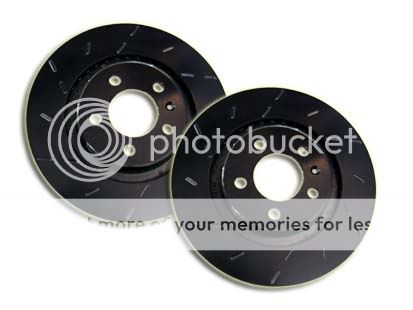

Been wanting to do a brake upgrade for a while now and the place where i've been to get the stuff i need has offered me this......
to go onto this....
should i go for it ????? but what about the rear discs as they're silver ????

What brakes are those ? They look better but are they better ? You have an M not many brakes are better than oem m brakes

They are EBC and they match with the EBC redstuff brake pads.
Total = R3500
The current ones are ok but under hard braking they terrible.maybe i should change the pads and take it from there !!

I dunno to be honest , I would go with OEM and just get new pads as they probably finished but each to their own , also heard stories that aftermarket brakes create more dust and black powder or so ? Not sure , just wait for one of the other members to help you as I'm also not too certain

rather stick with the oem floating disks I can Cryo treat a set for you it will make them last 2-3 times longer so then you can run high friction pads on them and they wont get eaten... your other option is to look at other floating disk upgrades, but they are going to be pricy...

I agree on staying OEM...upgrade the pads or consider Moranor's idea :thumbs:

floating disks are the best no two ways about it... just be careful if you run better pads that can take more heat they normally are also higher friction which is good for performance but not so good for your disks... LZ ran some ebc pads on his M5 and they have eaten the disks quite badly from what he says...
in contrast Ive been running the EBC disks you thinking of getting with ebc pads for a year now and they look almost new but im getting a slight vibration now so ill just skim them an refit them...
but i would never go from floating disks to solid because solid is by far more inferior...
