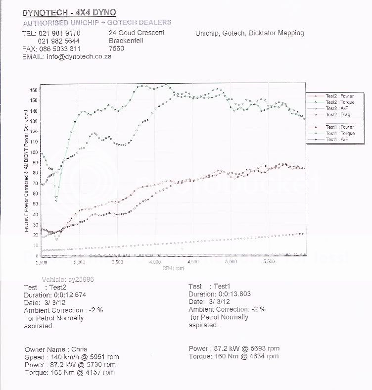

ChrisBrand
Staff - Legal
MiniMike19@DefinitiveDetailing said:
I noticed that the 3.0 Litre motors were struggling a bit.
However I found the Dyno quite accurate as the Smart made its factory specs and most of the people there said they got results which were expected and in line with their expectations.
Chris, how is your BMW driving? I hope it isnt anything serious. :thumbdo:
Hehe thanks Mike. I checked all the figures you printed and realized i was doing the same numbers as the Citi Golfs :flyfun: But car feels okay now. I noticed coming off the dyno it struggled a bit so maybe it freaked out and went into "limp" or something.
Noticed the guys had to tie my car down differently. My bumper clips broke so they couldnt find the hole to fit the tow hook and tie it down. Not sure if that would make a difference but i will take it to zeemax for a check up. Run their dyno and if all goes well i would love to bring it back for a proper run at Dynotech!
