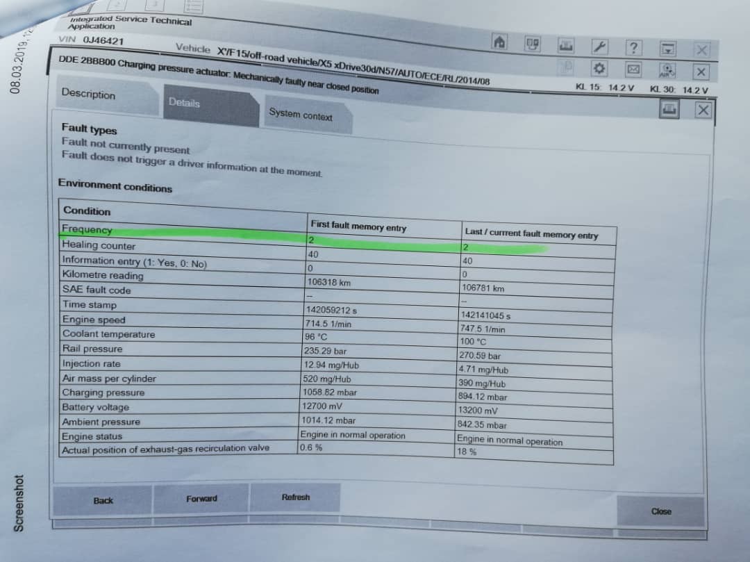

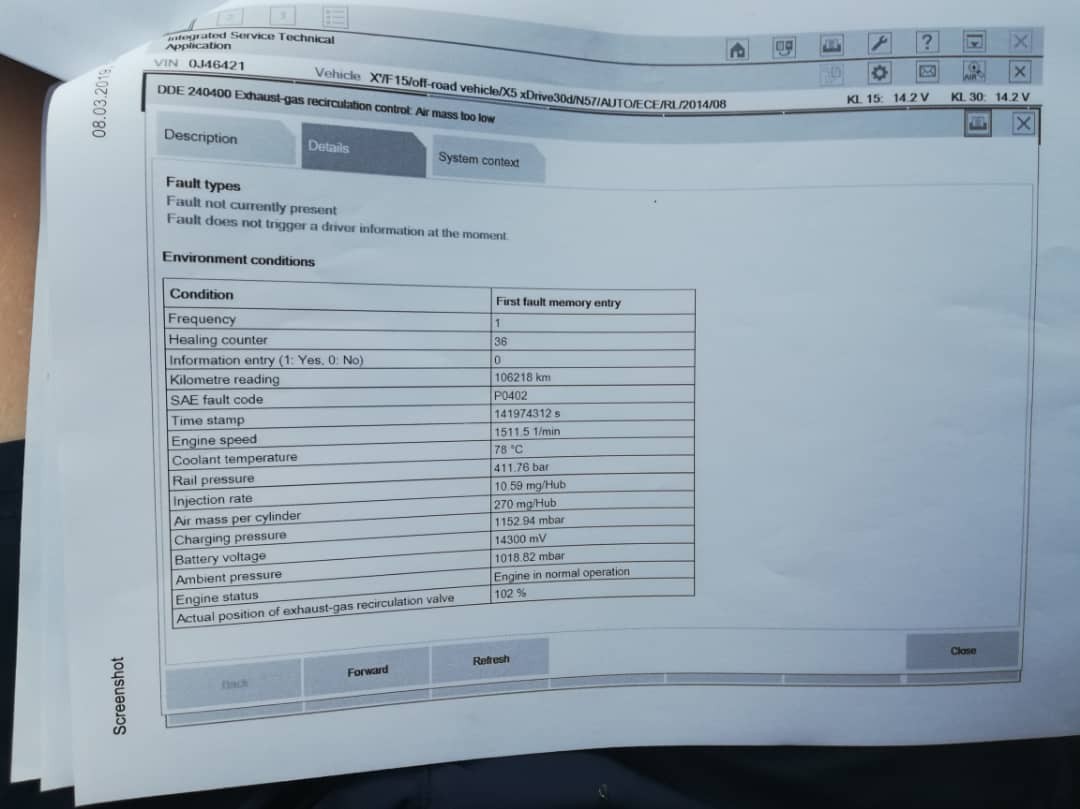

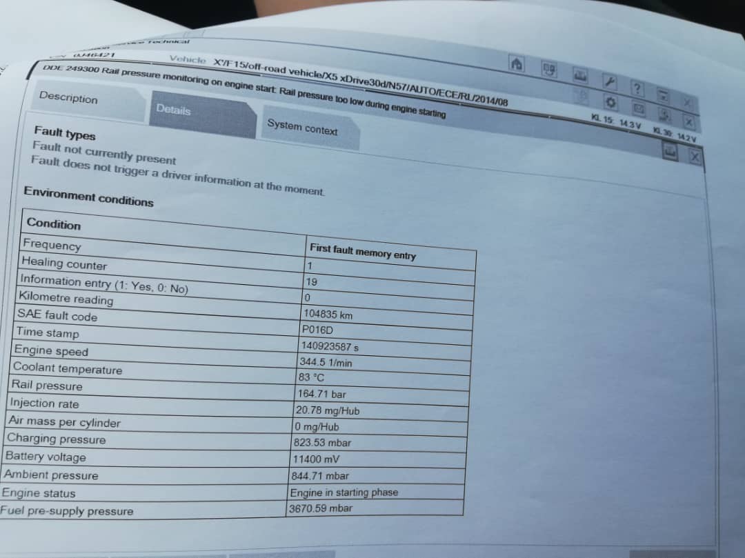

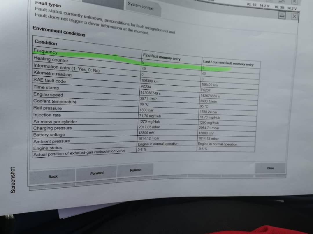

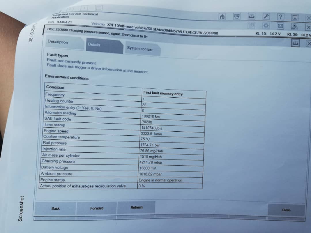

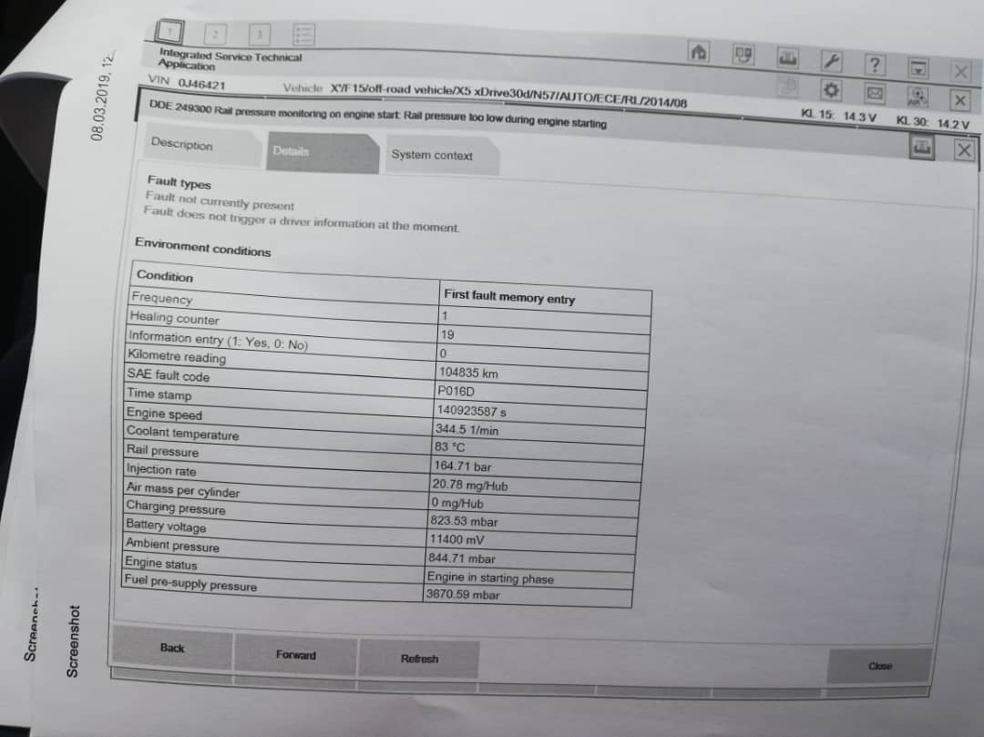

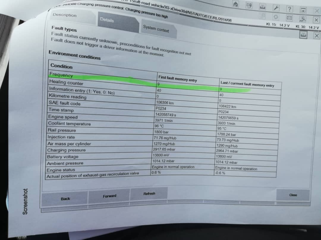

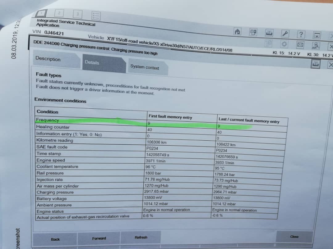

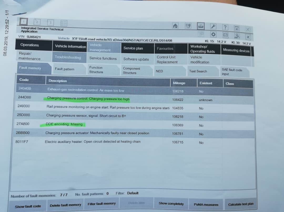

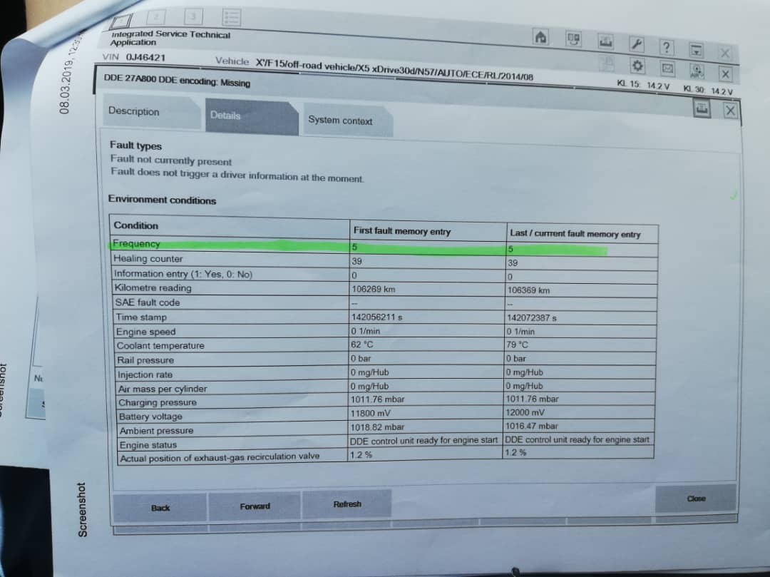

Errors as per bmw. All after decat and map to delete cat
Drive from swakop ro whk the car had normal power ( before cat delete --- except a nice growl at low speeds when floored) only when toppoing out speed warning came on ..... in either comfort and sport modes.
S1NGH 911
Egr error - did your tuner not write out the egr on the file?
Rail pressure too low on start - won't cause limp at high speed
Charging pressure too high - the car is over boosting, mean it's exceeding the requested boost - in your case it seems like the actuator on the turbo is the culprit - this is definitely the cause of the limp mode
Actuator fault - actuator is shot, from what I've heard you need to buy a new turbo as the actuator is not sold separately, I could be wrong though...
DDE error - your tuner could have messed with something on the ecu

Thank you . Will def ask. Why actuator now defective after cat removal ? Through error only now kilo wise
S1NGH 911
Flash the car to stock, test it and take it from there

So you have definitely had a variation between actual and requested boost - in your case the car is over boosting which can be dangerous.....
