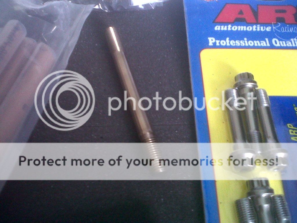

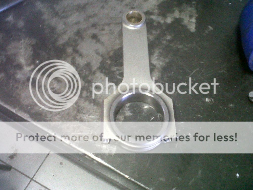

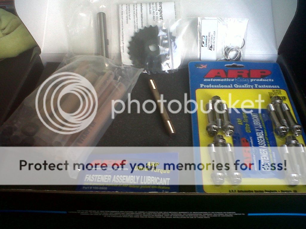

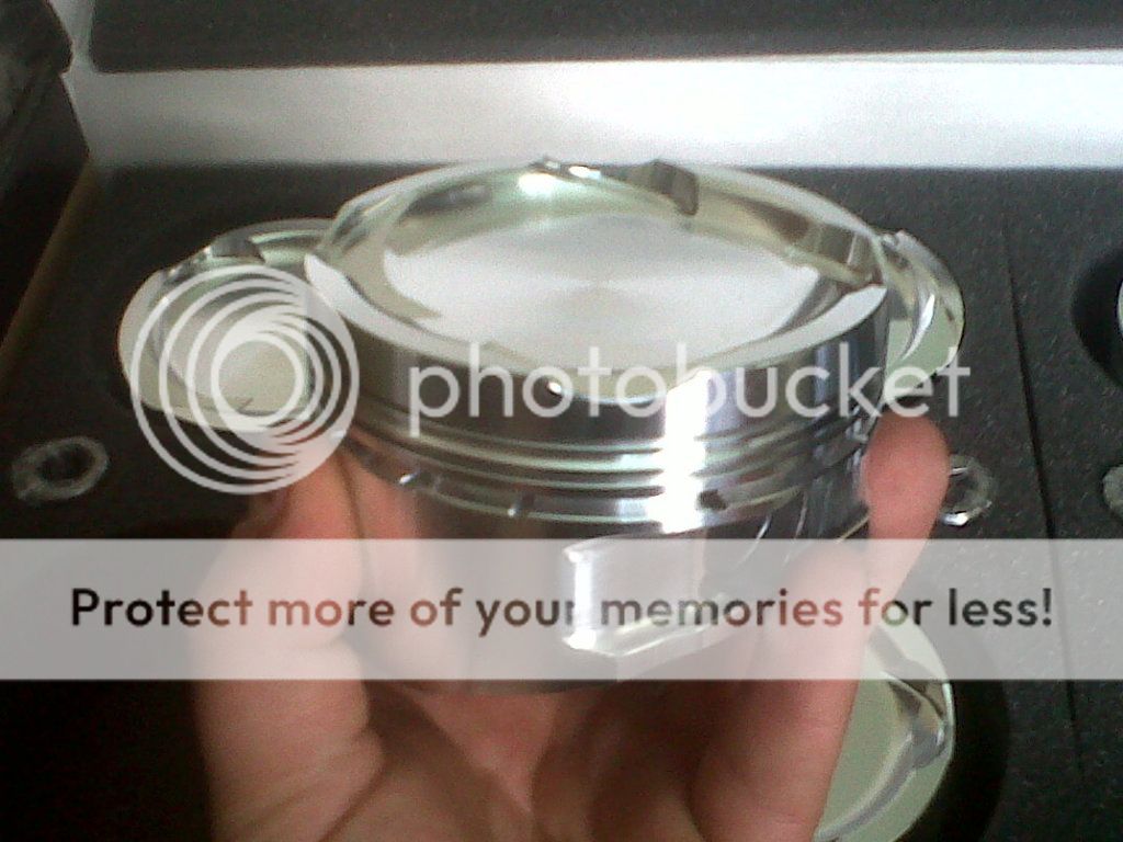

Full motor build consisting of CP pistons, Vac bearings, Eagle rods and ARP's everywhere..
The block was honed to CP spec pattern, a few other secret bits and bobs were done, and the motor is assembled!
Just to add, The first mechie that assembled the motor made an absolute mess! I had my current mechie redo EVERYTHING..

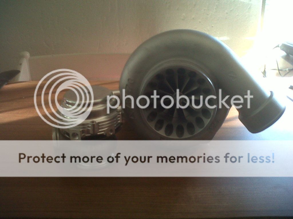

More Turbo kit Pictures!

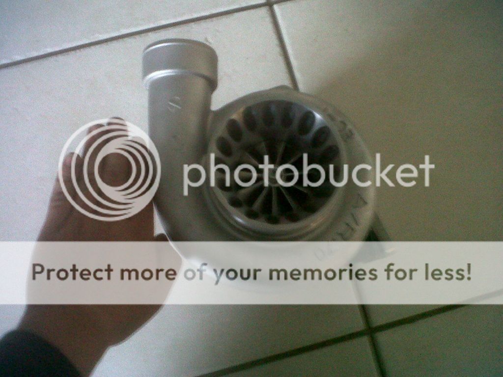

GTX3582R with T4 .82 exhaust side. Tial 44mm Wastegate

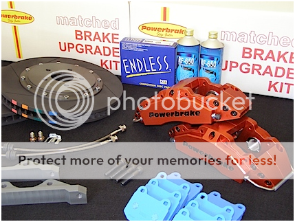

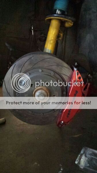

Added a Powerbrake BBK

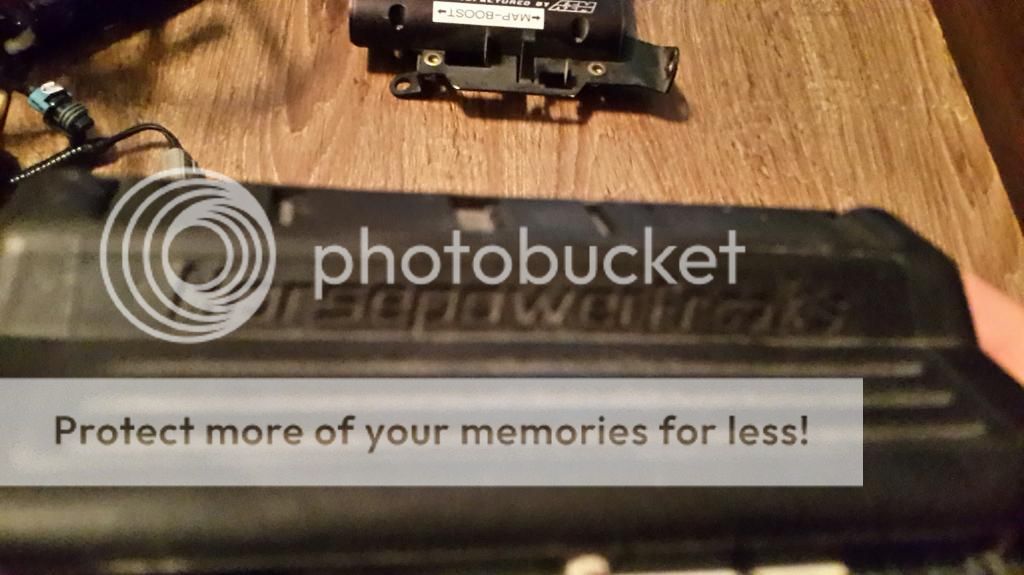

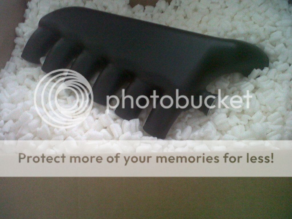

HPF intake manifold

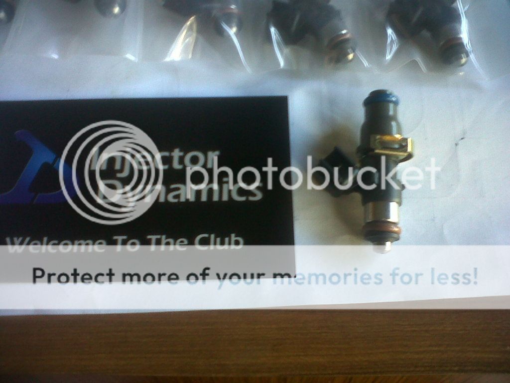

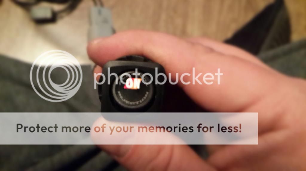

Injectors:

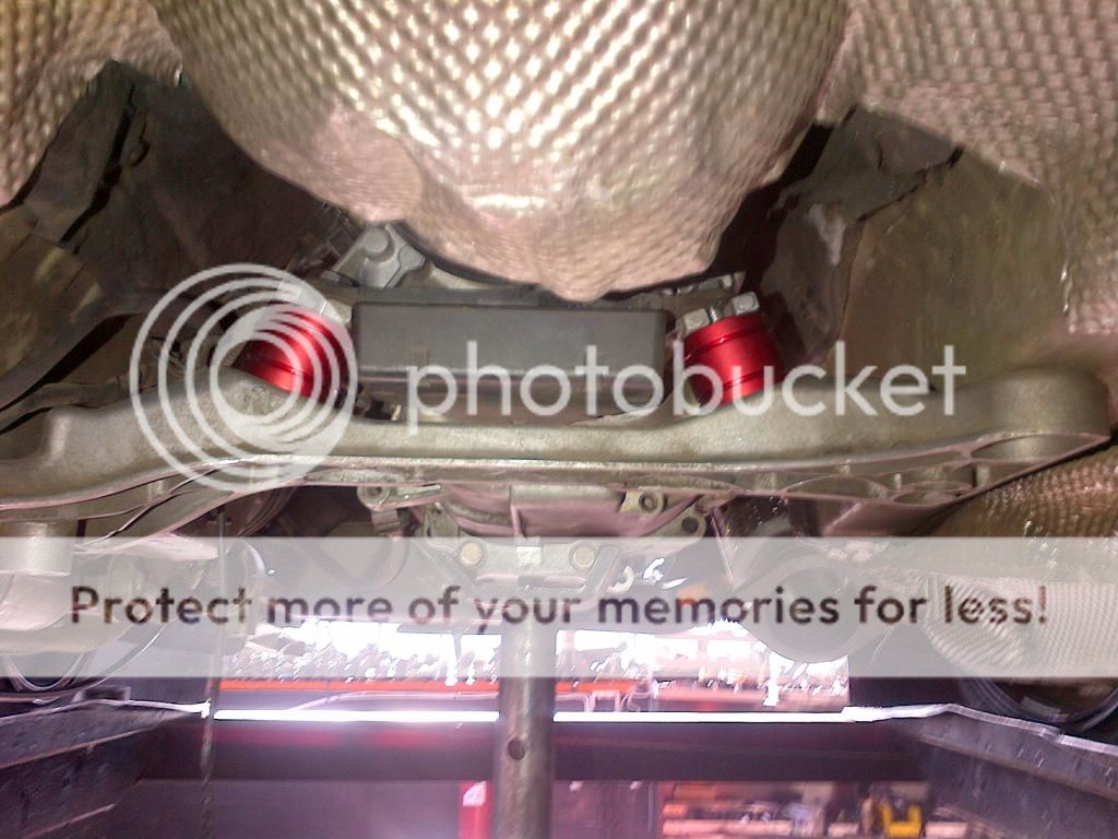

HPF Engine and Gearbox mounts

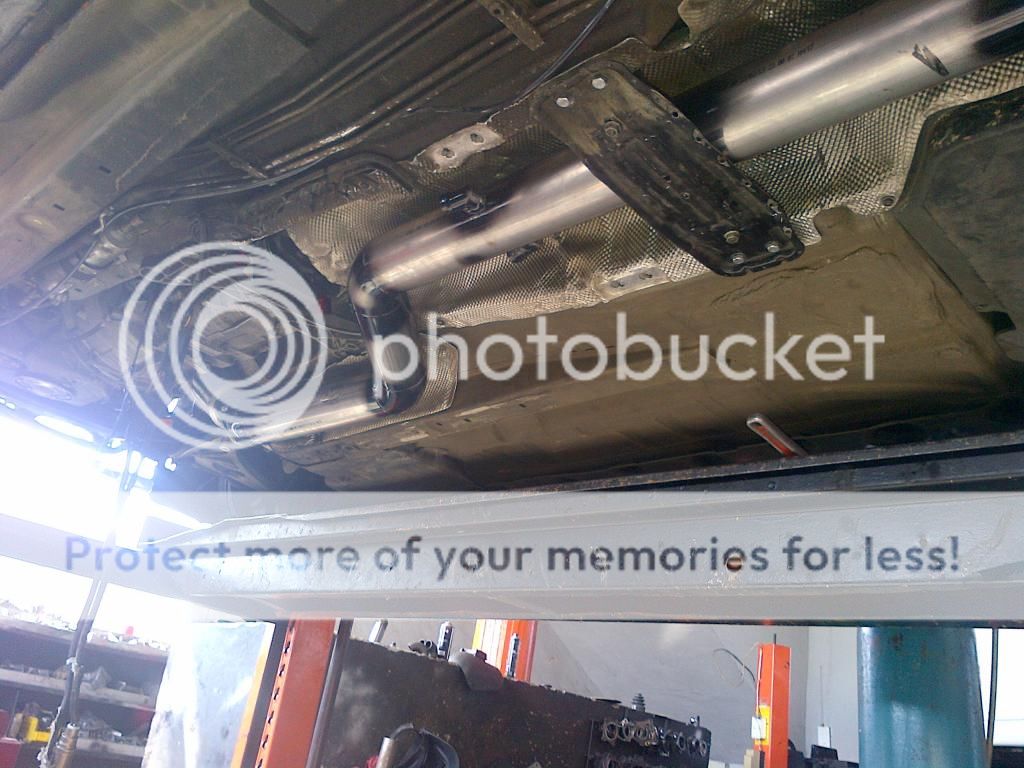

4" Exhaust (splits to 2x76mm into 2 boxes and quad tailpieces)

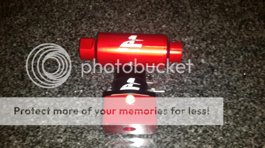

Aeromotive Fuel pressure regulator and fuel filter

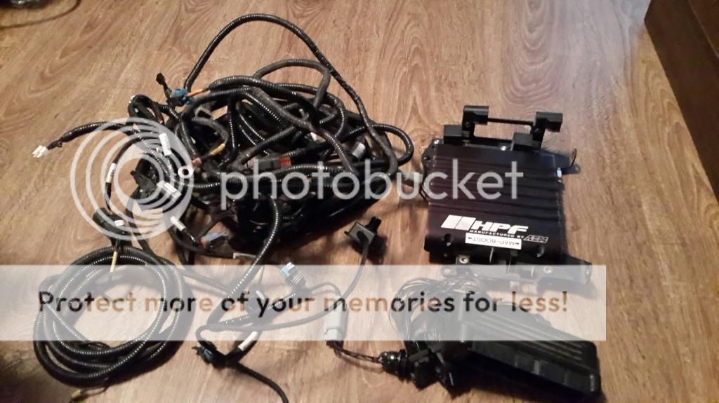

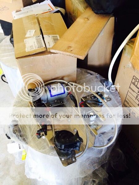

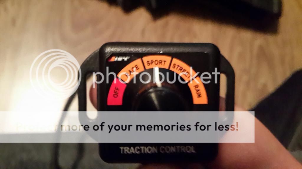

HPF AEM V2 management with Traction control, Methanol injection. Full system is plug and play

Main HPF components are: Intake manifold, management, integrated meth.
All the other components were bought with a big picture in mind, they are also all spec'd according to how I want this kit to turn out.

Im a little stuck on where to mount the Profec and the HPF traction module.
I want them to look neat and out of the way without them being in the cubby..

Peter@AEW
Next to the relay box as there is ample space in there and you have the added advantage that you can remove the plastic curved shield for easier access to the modules.
That part of the engine compartment is relatively cool AND if you so wish you can channel cold air into it.
