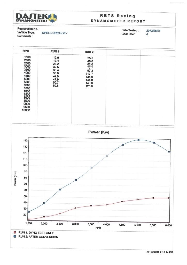

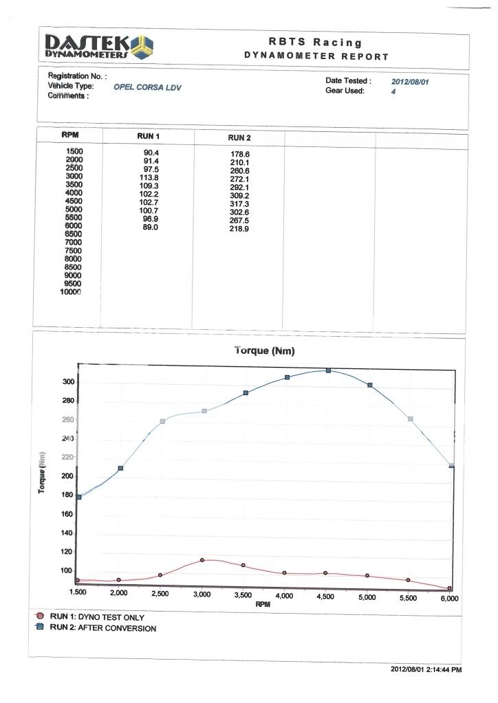

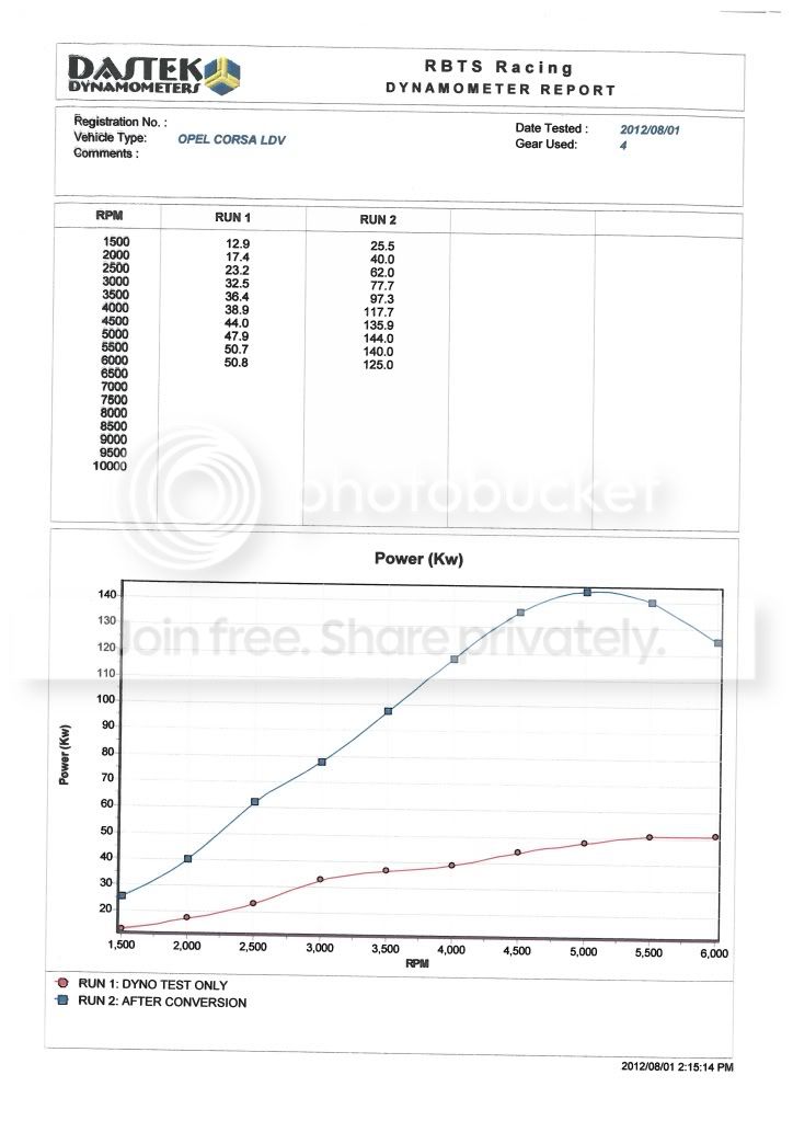

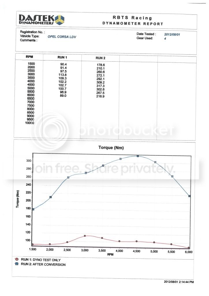

I guess you're also waiting for the numbers??? Well here they are:
144kW @5000rpm (at the wheels) - approx. 180kW on the Flywheel
317Nm @4500rpm (at the wheels) - approx. 382Nm on the Flywheel
I took my Ute to Ross a few months ago for a baseline figure. It made 50wkW and 114wNm. So the new figures represent a 188% increase in power, and 278% increase in torque! I can't complain about that.

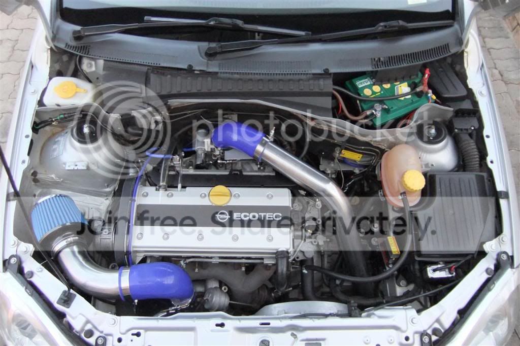

Here's a better pic of the engine bay now that everything is done:
And here are the dyno sheets. The baseline run was with the 1400 motor :D
I'll post some videos soon, just need to edit them a bit to make them smaller, and then upload them to Youtube.

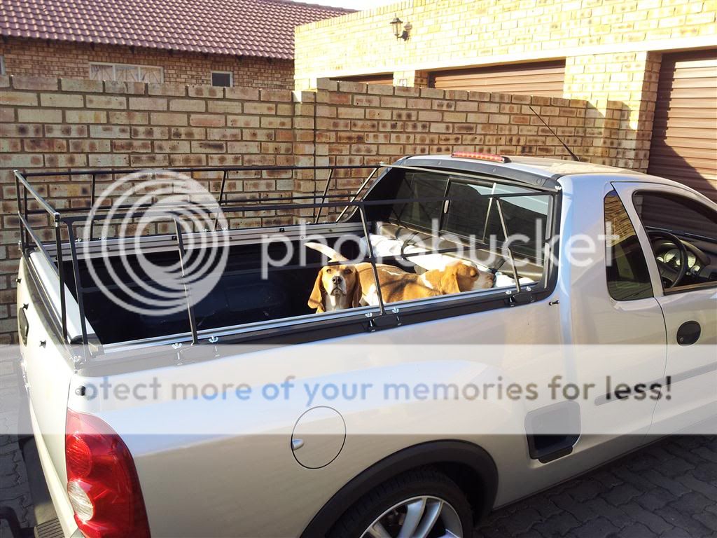

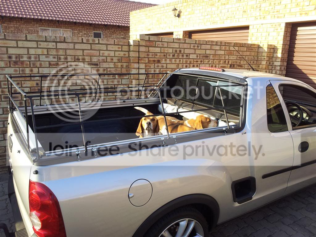

Then, moving away from the performance side of things, I tackled a long overdue project: I made up a portable / removable frame to fit on the back of my Ute. Now we can chuck the dogs on the back if we want to take them for walks or something, and there isn't a risk of them jumping off to attack some vagrant on the side of the road, lol.
This was also a bit of a mission, but I'm happy with the outcome. The dogs are also busy with quality control checks :D
