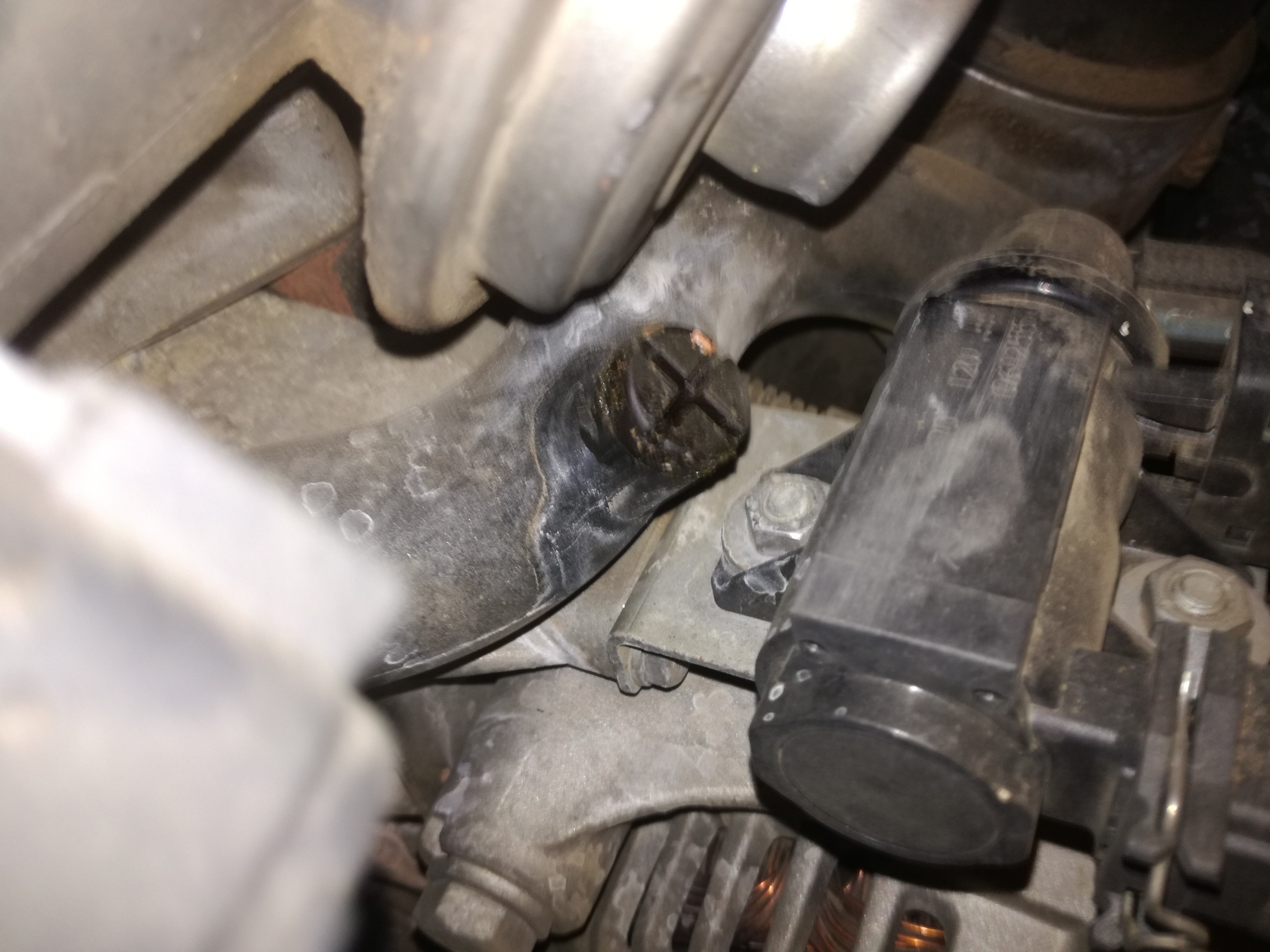

ok guys! I removed the engine cover and checked. now under neath the EGR there is a water/coolant pipe that has some sort of a valve and it looks like the coolant is leaking from that valve. Some guy tell me there is pressure inside the engine and I must take off the head send it to the engineering. Help!

Maybe try inspecting the pipe and the valve a bit more closely? Post some pictures.

Do you have a pic?

theres 'add picture to post' above the reply button. on tapatalk theres a paperclip which allows you upload a picture.
Bennit
there

Thats an easy one. Get a new bleed screw of agents. They are not expensive. When fitting it please please do not over tighten. Snug fit should be fine. If you over tighten you could crack that pipe which is not cheap. If you in the east rand you can pop over by me. I have a couple spare bleed screws. No charge.

A trick I was thought from this forum, use some Vaseline on new one when putting it in,

As long as you don't over tighten. I learnt the hard way. I cracked to pipes. R3k later. With age they become very very brittle.
