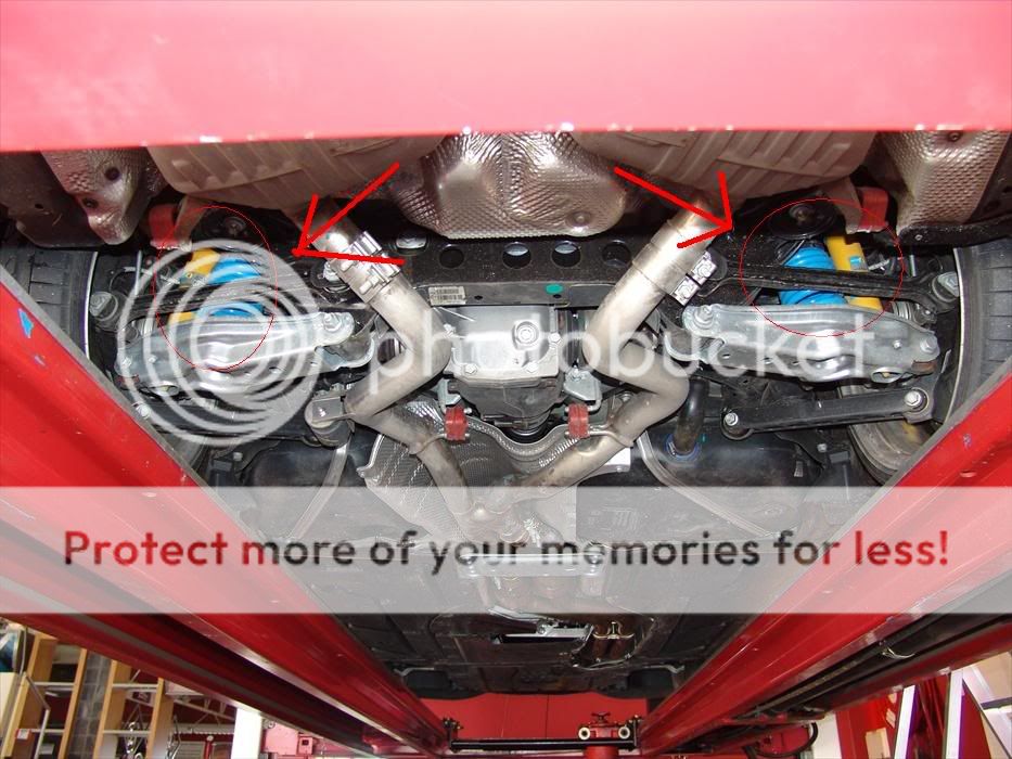

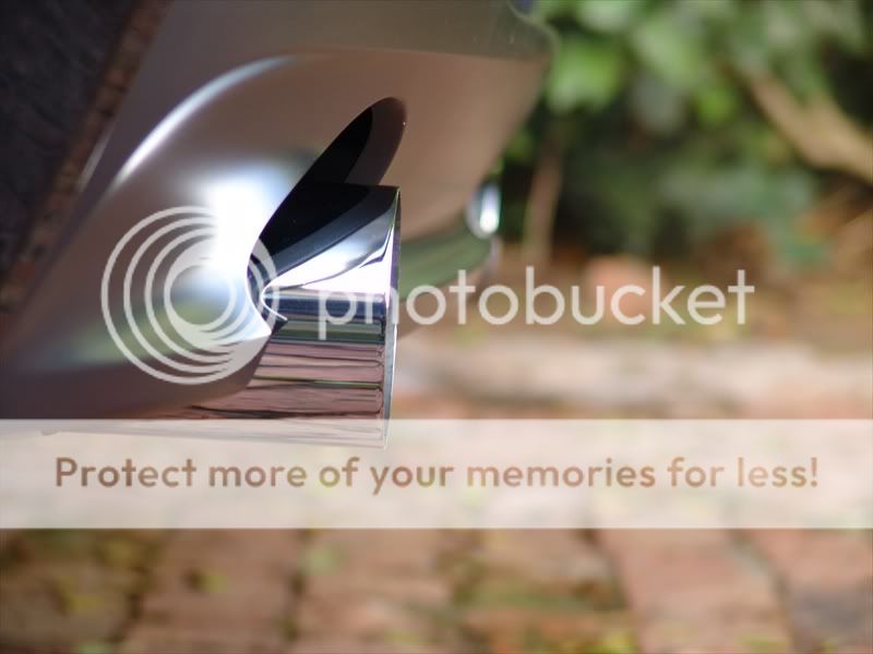

On first sight the performance exhaust looks completely stock and does not “look†the heavy price tag. The mufflers and X pipes are not the good looking crafted polished types either such as Hamann, Active Autowerke, Remus or even RissRacing. Except for the corrosion resistant chrome-plated stainless steel tail tips everything else looks stock. The chrome tips are far more attractive compared to stock though, but are also the same size in diameter as the stock tips (80mm exactly; the stock outlet tips are just thicker). I would have preferred larger and more aggressive tail tips (101mm) to fill the diffuser openings more completely. For the adventurous: since the performance tips are the same as stock one could consider the aftermarket tips with 90mm and 101mm diameter – this could be interesting? Revo has a local contact on the larger tips.

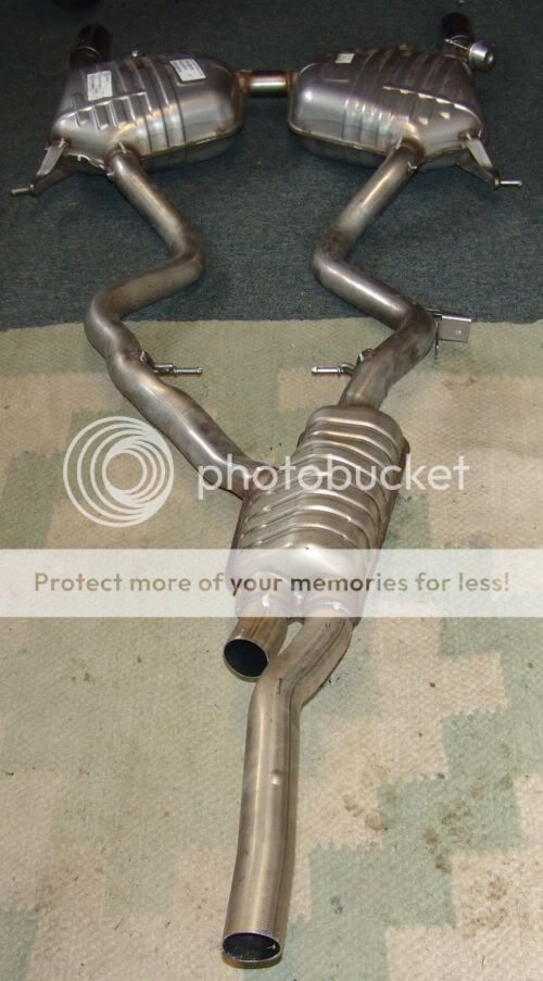

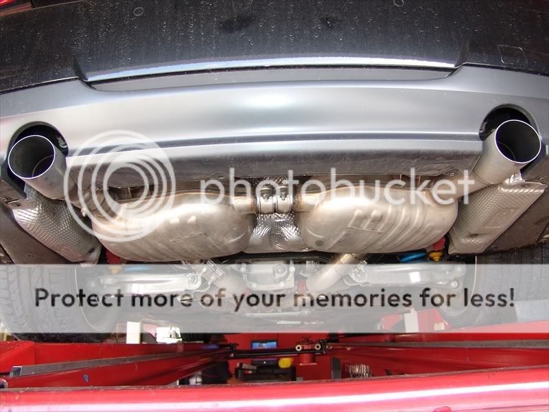

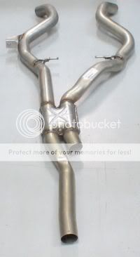

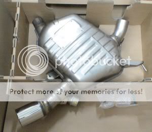

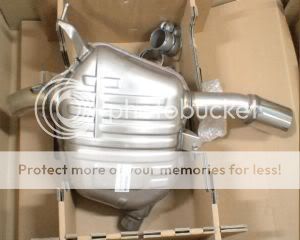

The performance exhaust comes with two silencers or mufflers (separated) and two mid pipes running from the second cats connected by an X pipe which replaces the stock resonator. The pipes are bolted together with 10 clamps (instead of flanges) which alone will set you back over $600 (R4,000).
The performance exhaust improves air and gas flow and reduces backpressure. BMW claims a weight saving compared to stock and when I held (tried) the two exhausts in my hands (one after the other) I could certainly feel the significant weight difference in favour of the performance exhaust.

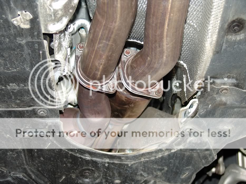

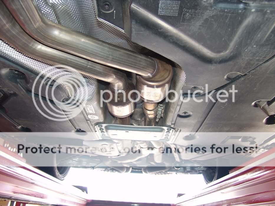

The installation was done by my local BMW dealer and took about 2 hours. The stock exhaust had to be cut (after the second cat) to attach the new exhaust (see picture inserts) but is essentially a perfect fit. :thumbsup:

The above makes up the full BMW Performance Exhaust System:
Below is the stock/old exhaust:
