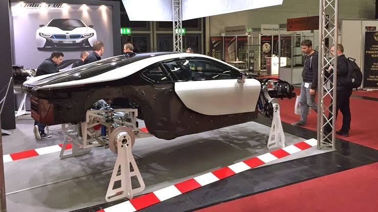

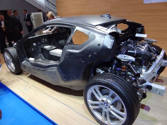

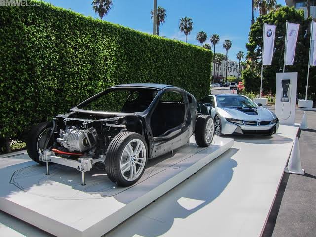

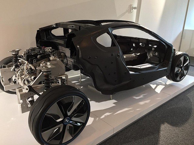

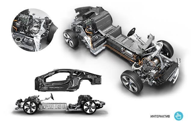

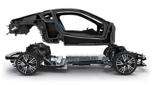

So I've got the car motor has been decided (B58)
Drive train
If you look at the construction of the i8 it is 4wd so retaining a 4wd drive train should be simple, if you look at everything it really would make sense to put the gearbox up front

If you look at the construction of the i8 it has two separate drivetrains separated by a battery pack, one of which is totally electric. There is no 'retaining 4WD'. you are going to have to engineer a solution to this. :ROFLMAO:

I wasn't sure about it so didn't respond, but I'm pretty confident the FWD aspect of the I8 is battery driven (while the engine powers the rears with some additional electrics).
