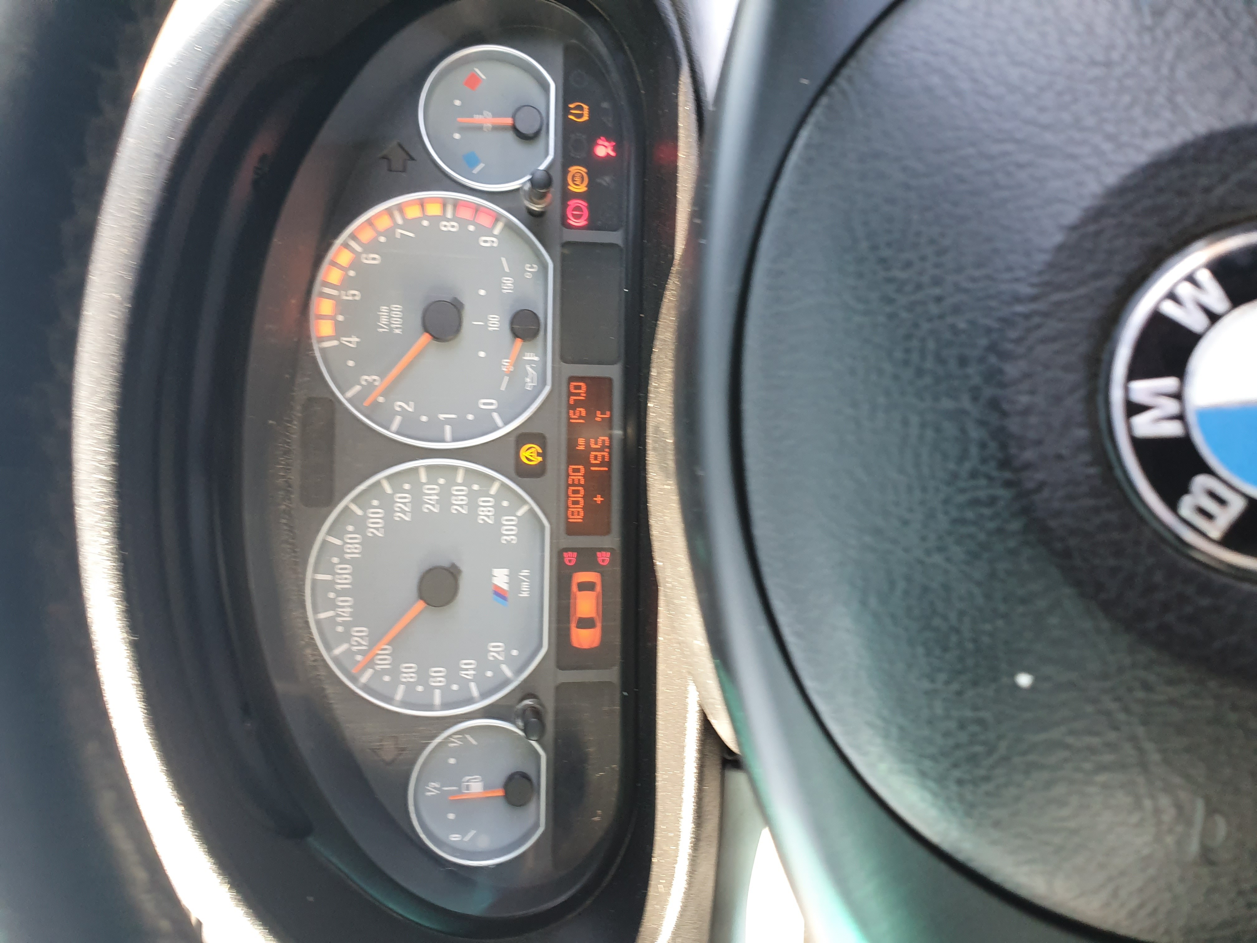

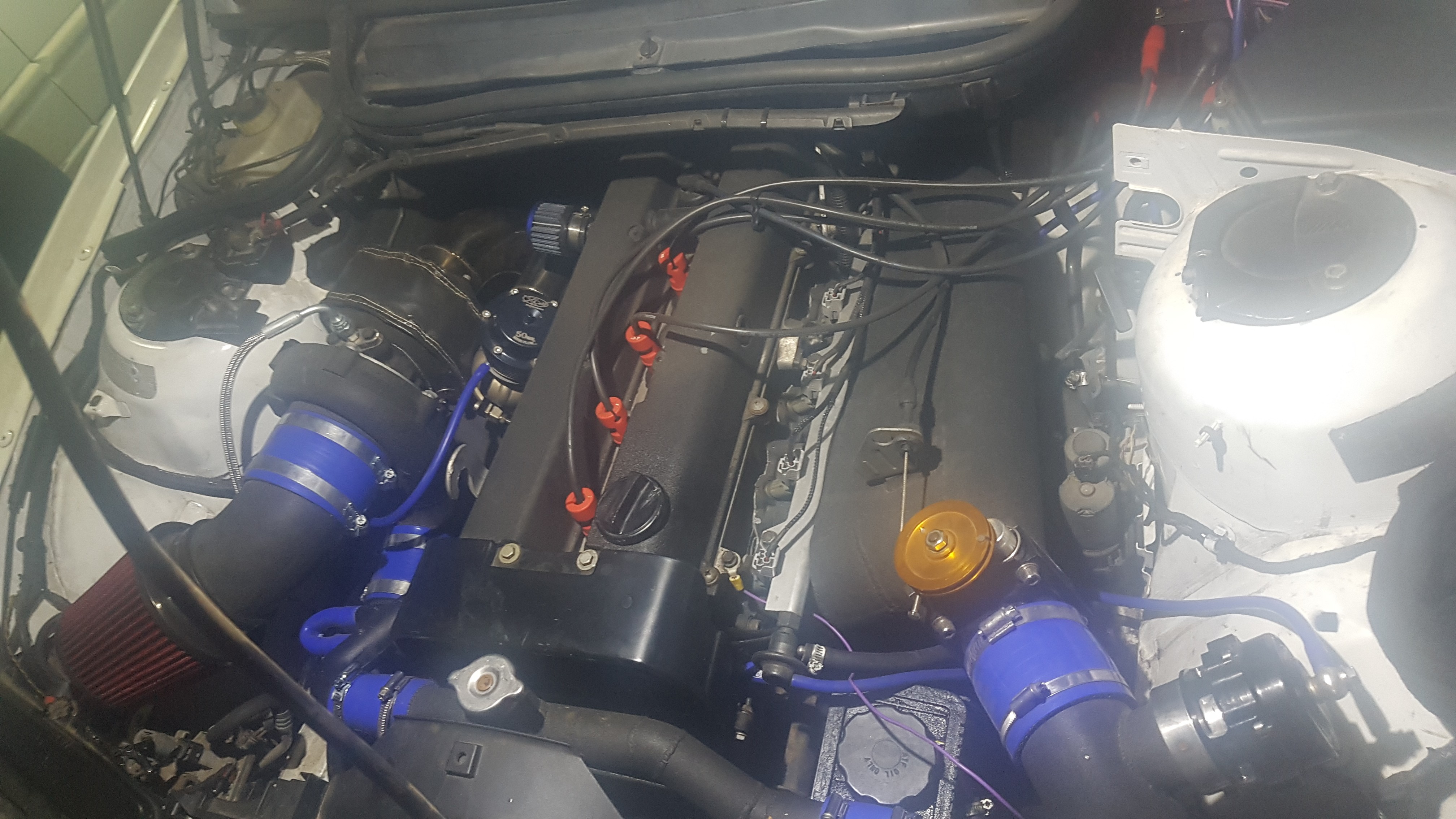

I did mine on my own. E46 m3 body with 1j non vvt on a 6 speed bmw box. Running powermods management with canbus module. Cluster working 100% made shift lights with the warm up lights. Made my own mounts. Still need to sort the AC. Rebuild the diff with new bearings and clutches, also added subframe support. Used the bmw steering rack on a 330d pump

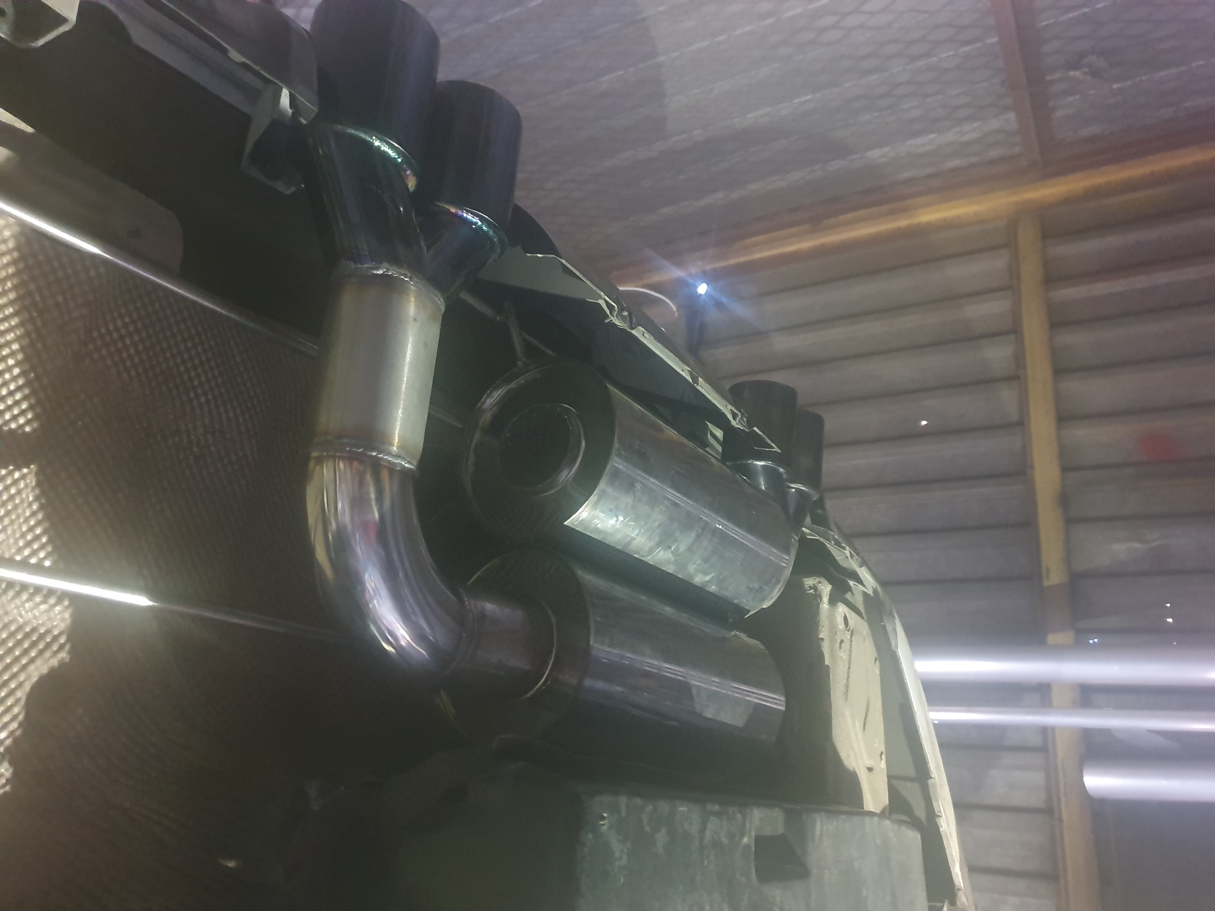

Used the standard back box on the car but that didnt work choked the car a bit so we build some new back boxes
