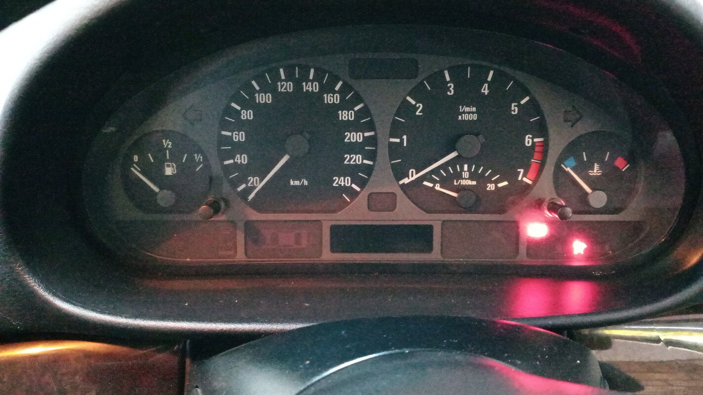

OK so my cluster went all haywired last week.
First the outside temp went crazy.... - 40,-12,50,-30 random beeps etc.
Then it all just died. No lights. Except for the 2/3 lights on the bottom right hand side when you start. But everything else is dead. The needles are also stuck in the position they were in while I was driving.
Im. In CT at the moment so will only be back next week most likely. But the little investigation I did didn't change anything. Pulled fuses as per this video but no change.
It's e46 330d uk import so it has the miles and km on the clocks. But in sure a normal local 330d cluster should work fine?

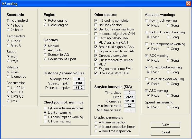

Then, reprogram the cluster, and tell it, its a diesel. I think you can do that using pasoft, but unsure now.

				So managed to get rid of the abs and dsc warnings on the replacement cluster. Have also coded to diesel as per above - not sure if there is anything else required for the petrol to diesel change. I still have the petrol backdrop and checked if the revs were accurate according to inpa. If I swop the diesel backdrop which goes to 6k vs 7k then it will be slightly out. Any ideas if recalibration is possible?Use the backdrop from your existing cluster, on the petrol cluster. So it still looks like diesel at the fuel gauge.
edit:
yip
I think you can try to do this in INPA.So managed to get rid of the abs and dsc warnings on the replacement cluster. Have also coded to diesel as per above - not sure if there is anything else required for the petrol to diesel change. I still have the petrol backdrop and checked if the revs were accurate according to inpa. If I swop the diesel backdrop which goes to 6k vs 7k then it will be slightly out. Any ideas if recalibration is possible?

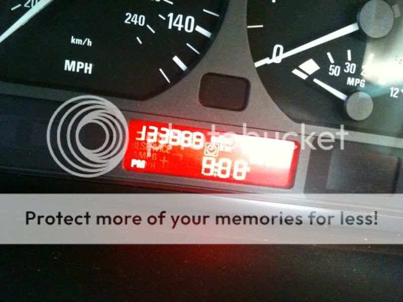

Read current needle calibration:
Now that you have modified the file to remove the VIN and mileage, save it as IKE_wr_0_miles.bin, or anything else you want to differentiate it from your backup. You will be restoring this file using PA Soft when you finish installing the new chip.
After you have made your backup, use INPA and go to the "Activate" then "Activate Analog" menu under the cluster section. This will let you set an angle or speed manually. Then you record the needle position for a given angle or speed. I set the angle to specific marks on the gauges so I can easily see where to set the needles when recalibrating them later, for example setting the angle of the tach so that it lines up with 2500 RPM. Using the speed value instead of the angle for the speedo will let you decide how much additional mph it reads over what you actually are going (5% correction that is built-in to the cluster).
