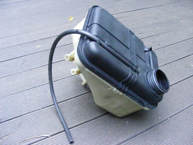

SO after the short trip from the shop to home, I noticed the temperature just slightly higher than the normal "vertical" position.
When I shut down I could hear a "hissing" sound, so investigation time
Discovered a fine steam spray coming from the expansion tank on the gap where the white plastic meats the black plastic.
I have removed the tank, and so I decided to see if this could be a D.I.Y. job by seperating the two halves and possible "renewing" the seal between the two.
There is just no way to seperate the two halves, short of total destruction

I tried using a soldering iron to melt along the seam to get the two pieces of plastic to fuse
it looked OK
So re-fit, fill water, bleed system....wait for temperature to pick up
:cry::cry:
:argh::argh:
still leaking !!

+2 on no scrapyard and OEM.
It is a pressure vessel, any temp fix that you do is probably not going to last long anyway.
I have one that there is nothing wrong with out of a E60 that you can have, but doubt your going to be able to fit it without serious butchering
You can try the goldwagen stuff, but on this, I would go OEM..
