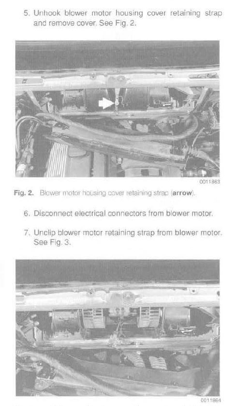

Also, have you checked all the youtube videos for the E34 and E32?
The Bentley manual has the following picture for the M50:
bmw69
I wish i could move my harness that far out the way.
Perhaps someone that worked on the car previously didn't put the harness back on correctly but there is no way i can move it that far.
