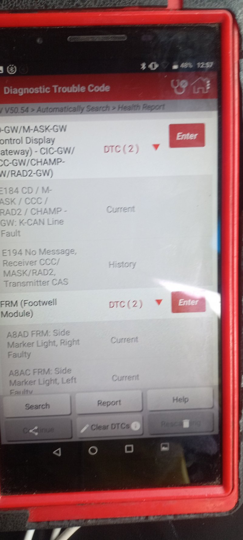

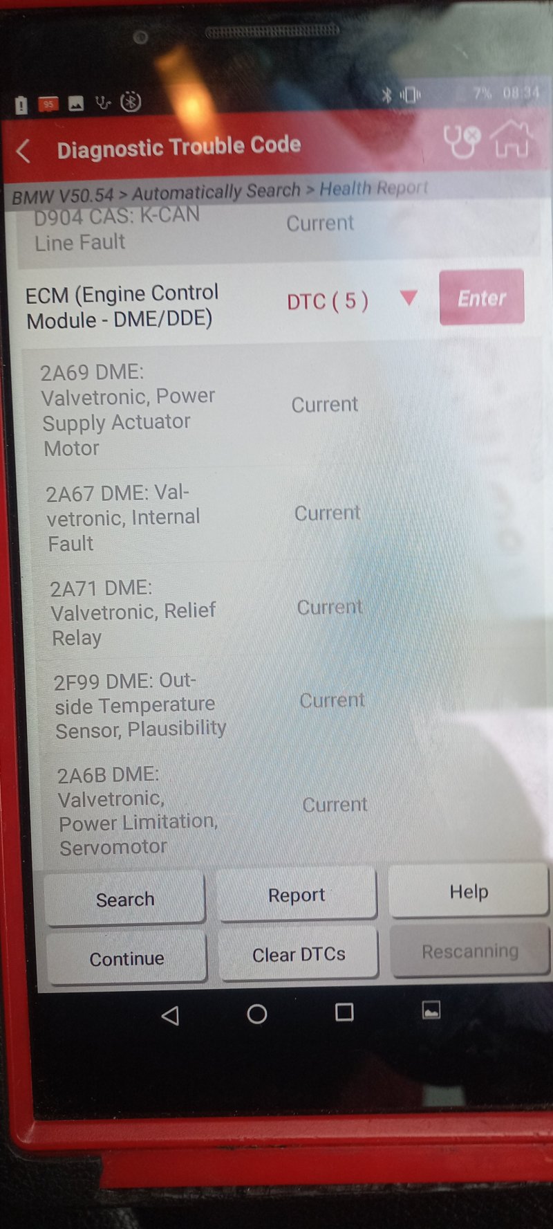

Recently purchased a 320i as a non runner car cranks and no spark at the plugs I have the attached diagnostic report and I don't know where to start as I will like to use this bmw as a gate way to solving further issues and having a better knowledge of the Bmw e90.
Diagnostic report

Could be quite a variety of things:
Crank sensor
Camshaft sensors
DME
Coil pack ground
That would probably be first place to start.
If you unplug the coil plugs and and check voltage between live (green?) and ground (brown?) or the engine and you get voltage when cranking the engine then you know at least you have power going to the coils - should be 12v.
