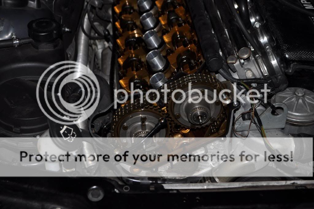

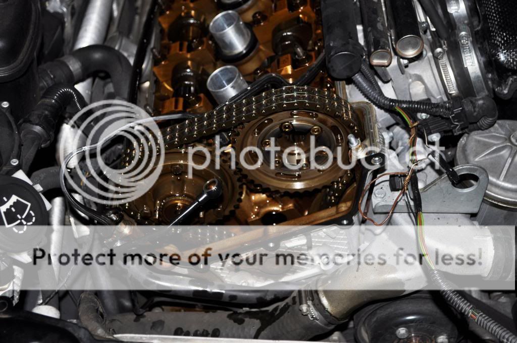

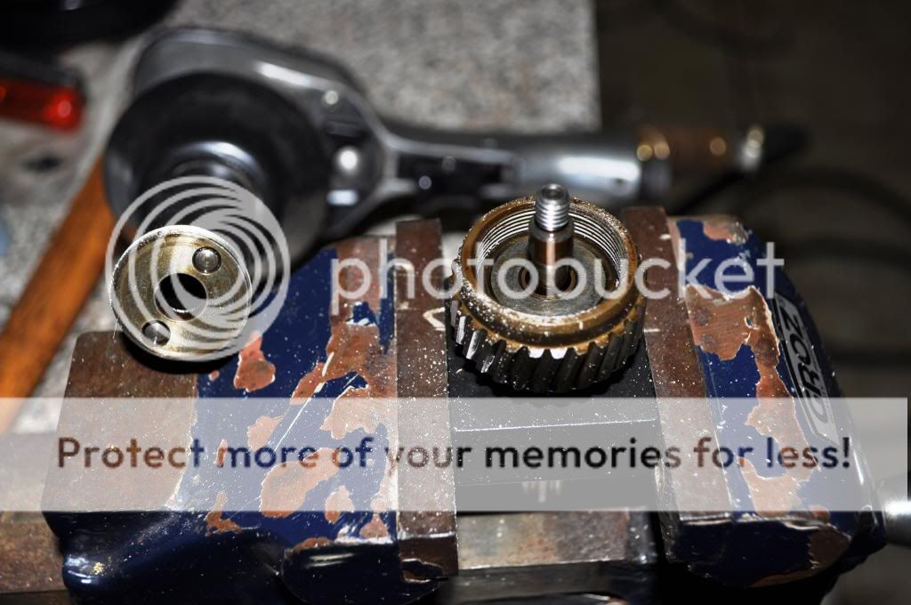

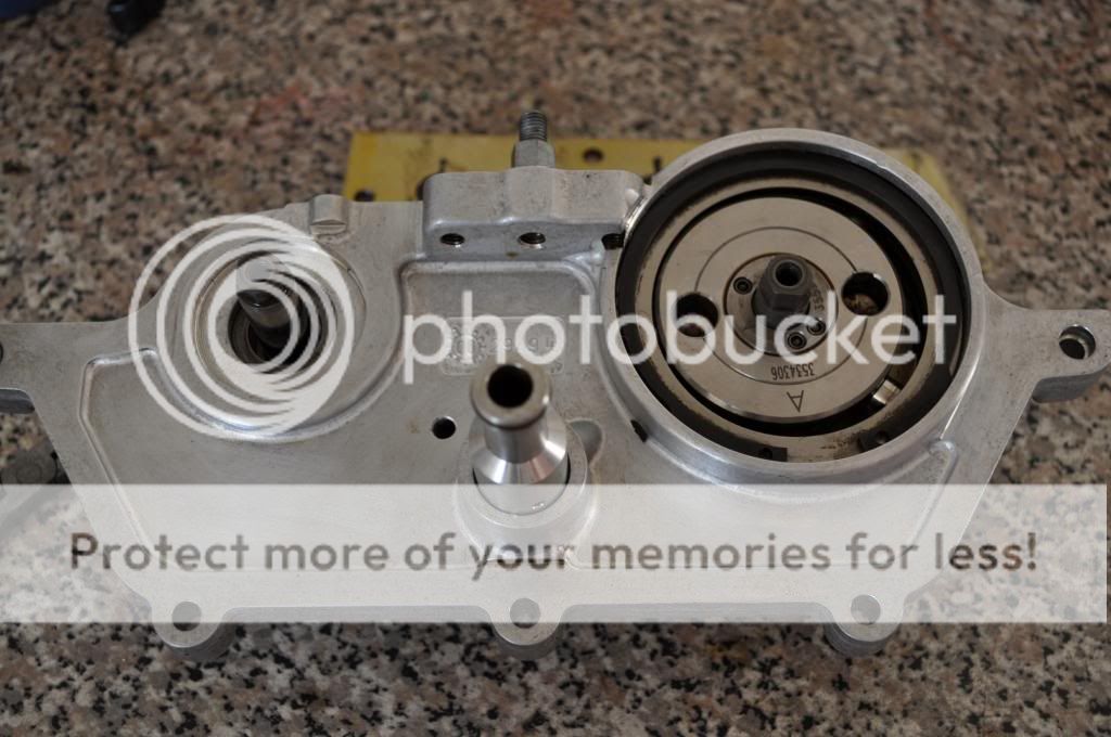

BillyBob brought his E46 in for Vanos and valve clearances.
Car was on rough idle and generally down on power.
We did VANOS- RATTLE KIT-CAMS RESET and CLEARANCES as well as checked the cam bolts which are all tightened to +15Nm and some work on the intake box,wiring and hardware.
Car is idling sweetly pulls like a demon.
Crash who visited whilst the car was there remarked as how sweet the idle is.
Here are some of the 117 odd pics we took.

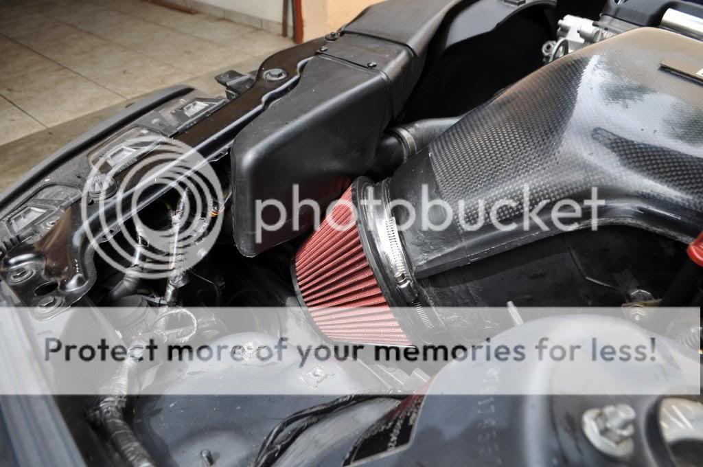

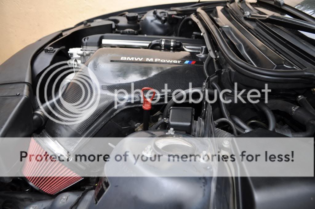

This filter will be enlarged as it does not flow enough air.
