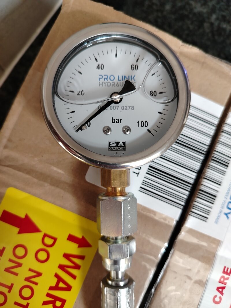

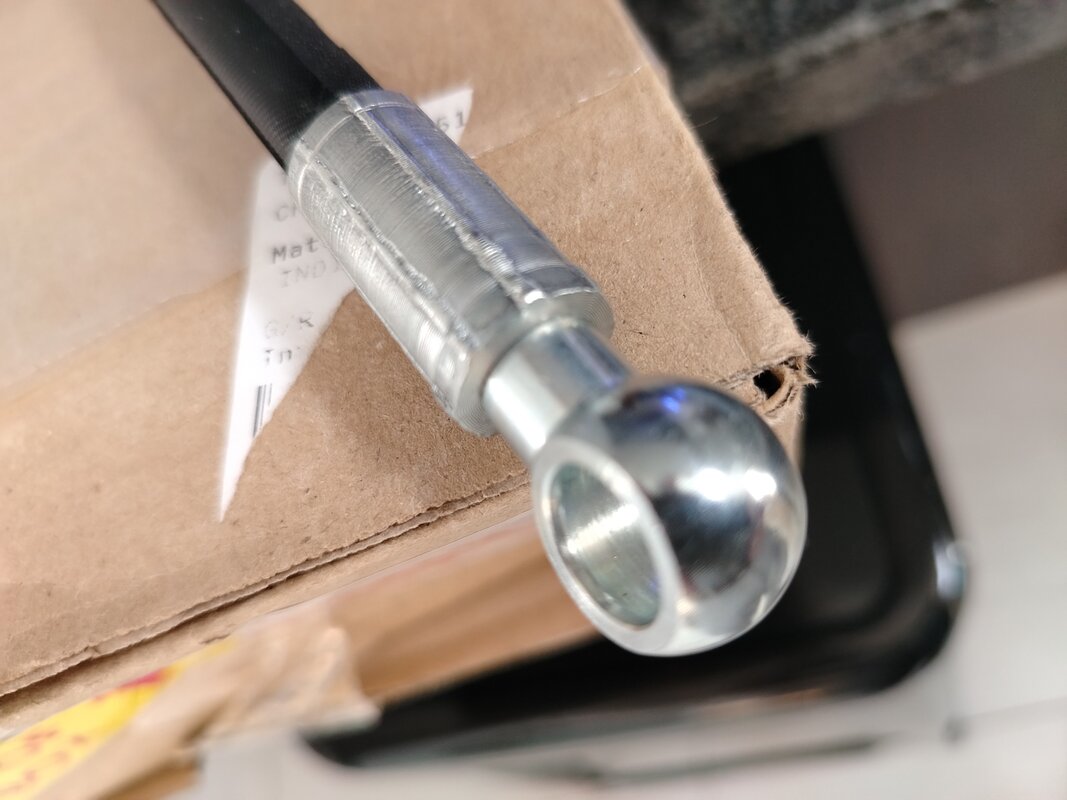

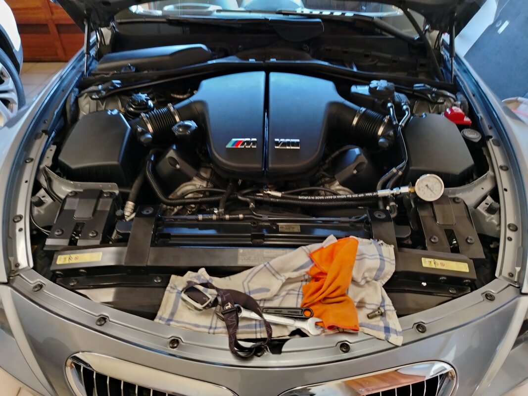

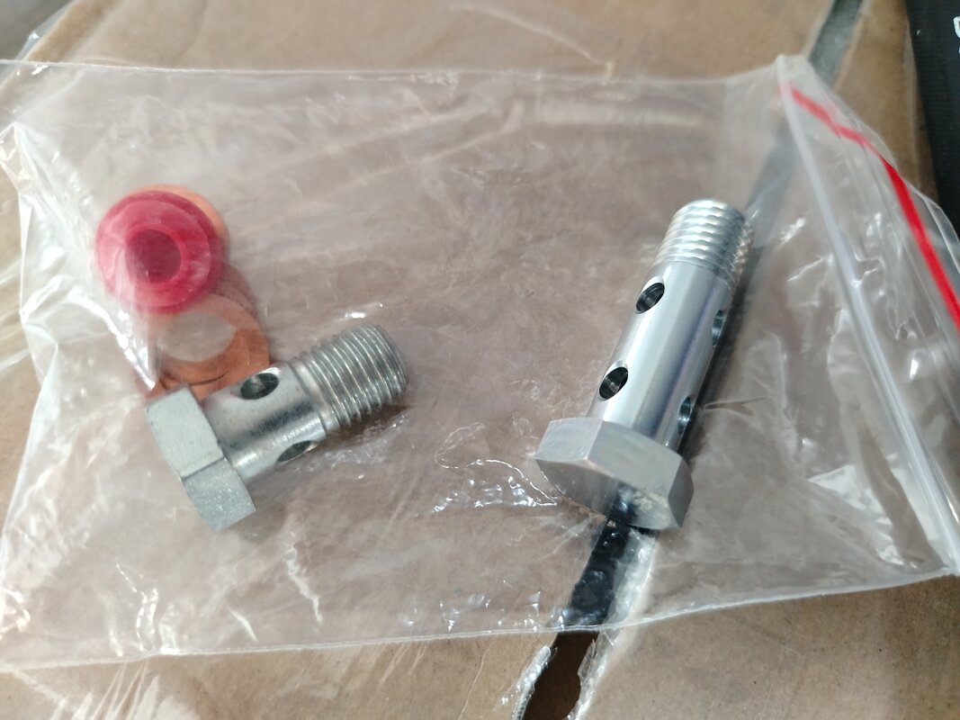

Received my pressure guage made up today. Will post some pics when testing the vanos pump pressure.

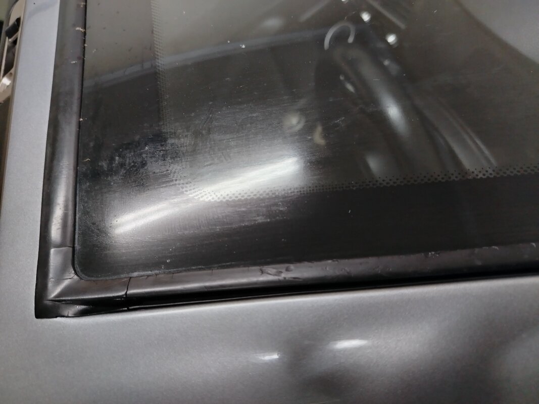

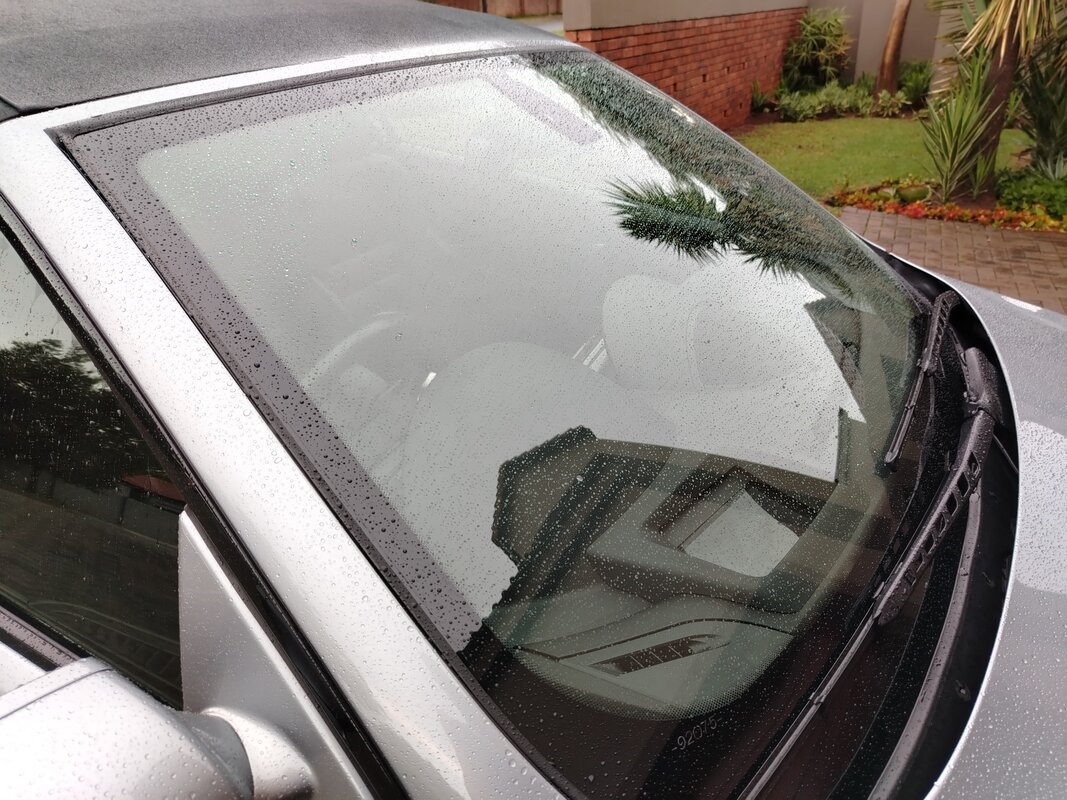

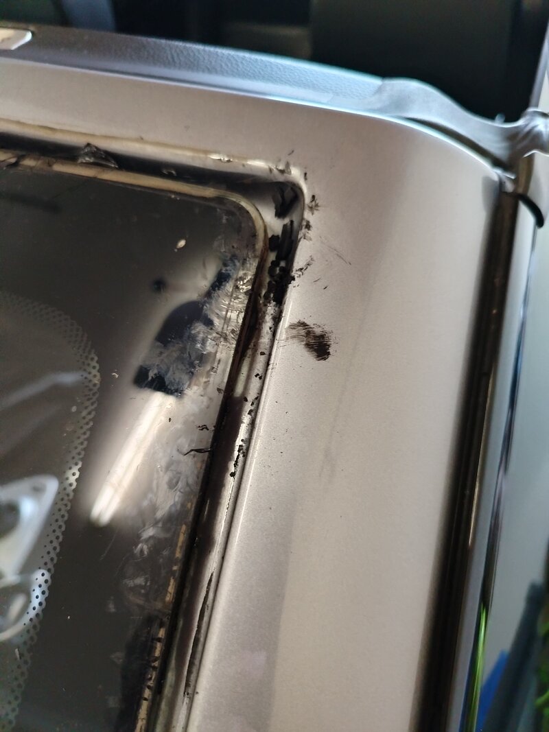

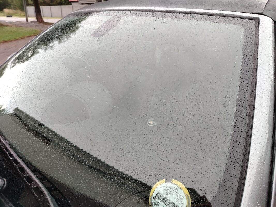

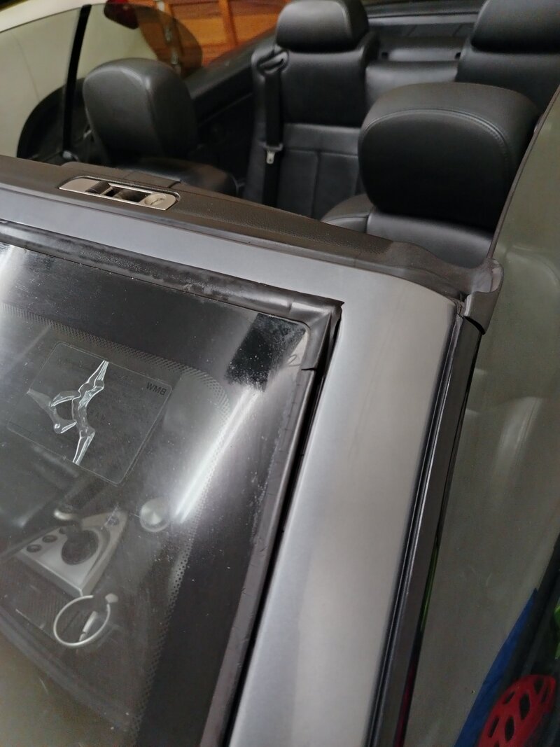

Swapped out my front window rubber last night. Old one had texture closer to putty than rubber. Makes a huge difference. Will post some new after updated pics soon.

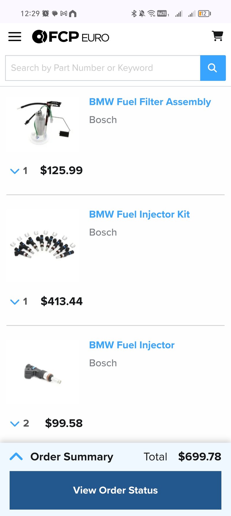

Decided to add a last checklist to the S85 sleep well list. New injectors and fuel filter. Decided to go with the S65 Bosch injectors, if imported prices are not that bad. S85 Injectors are unaffordable for most at current prices of 200 usd per injector.

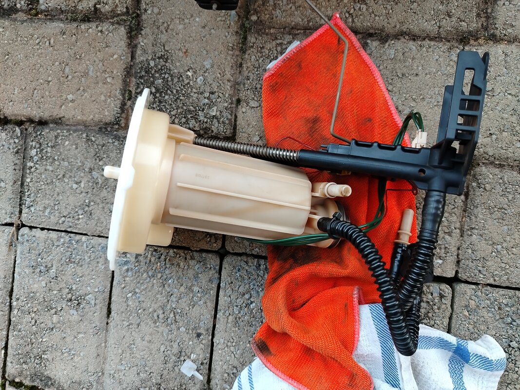

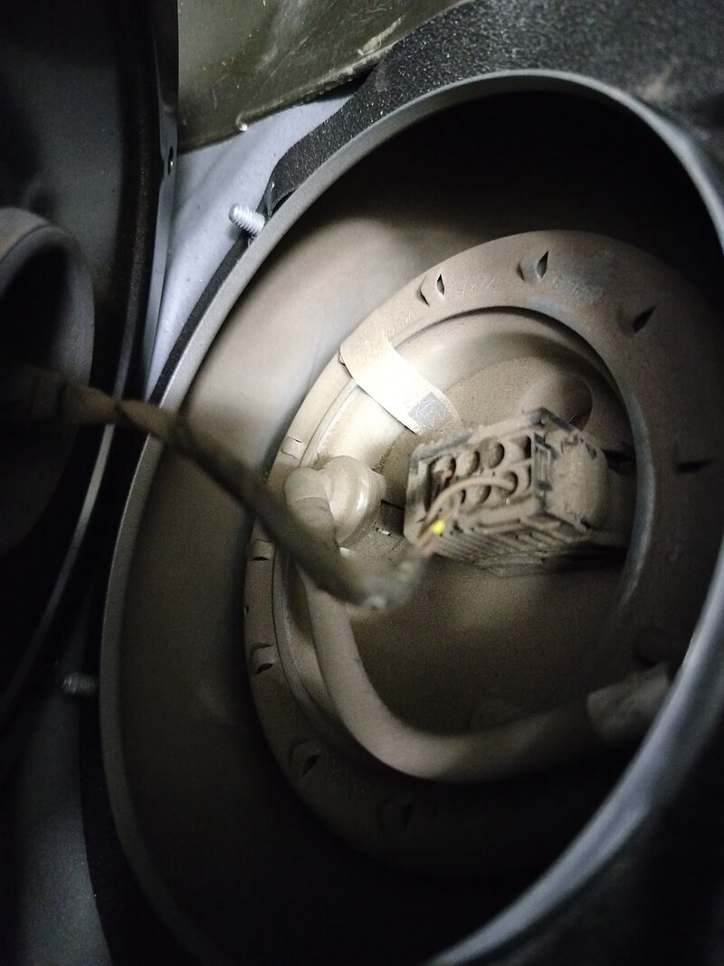

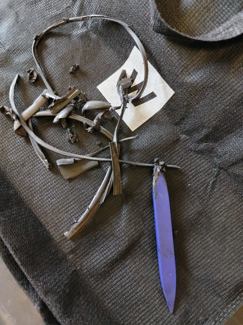

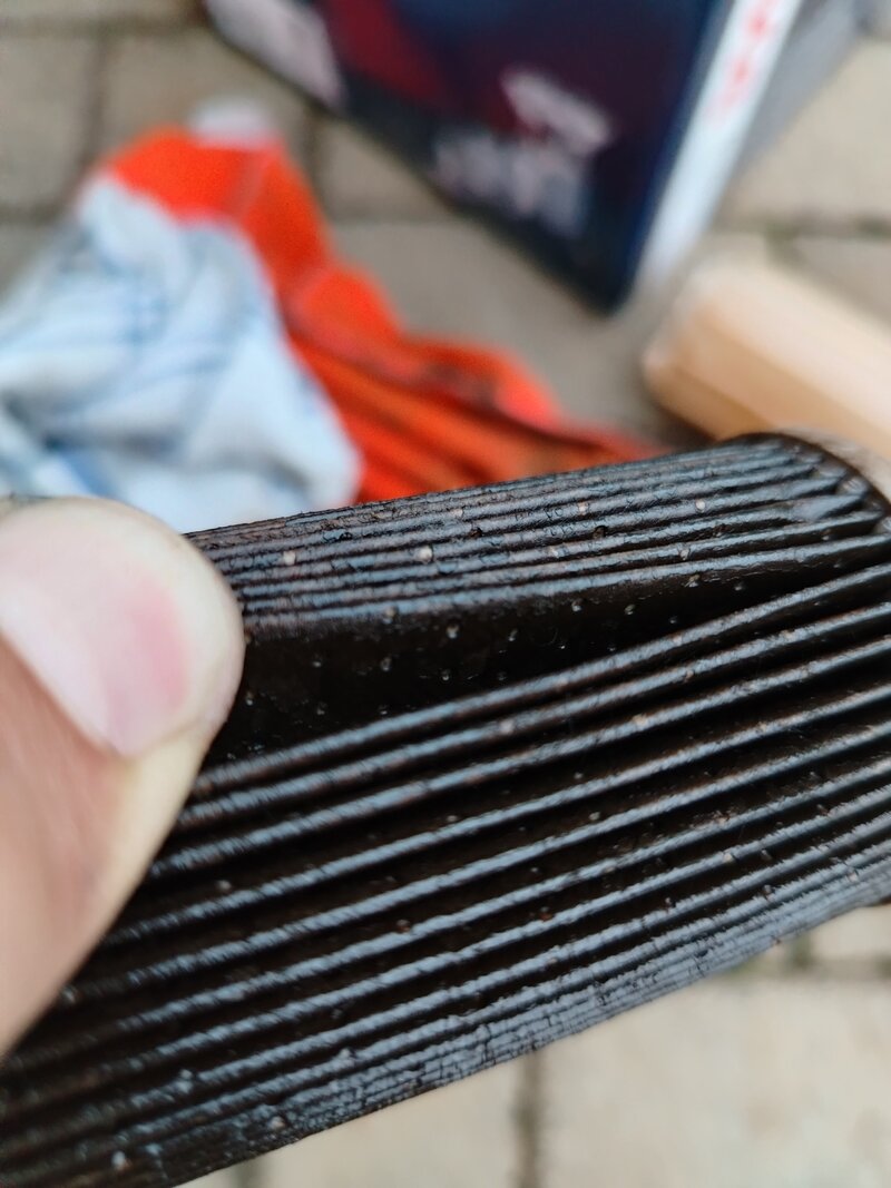

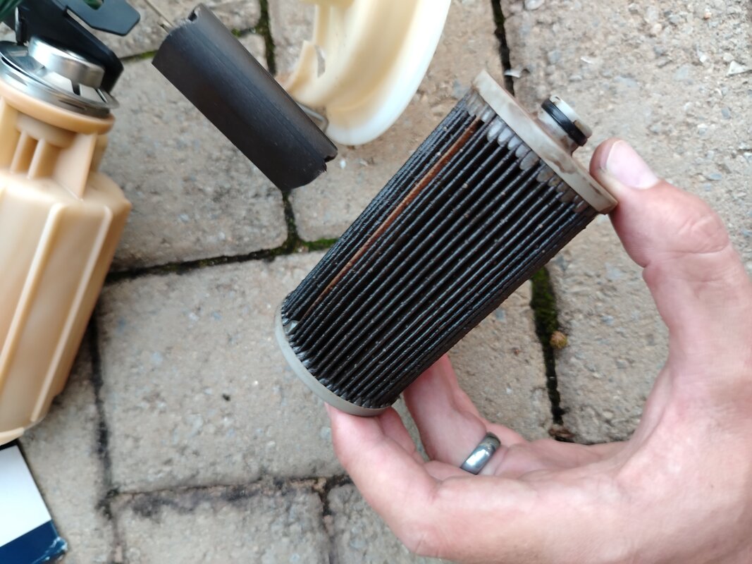

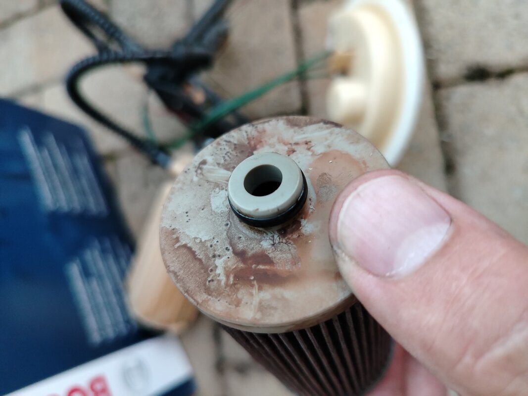

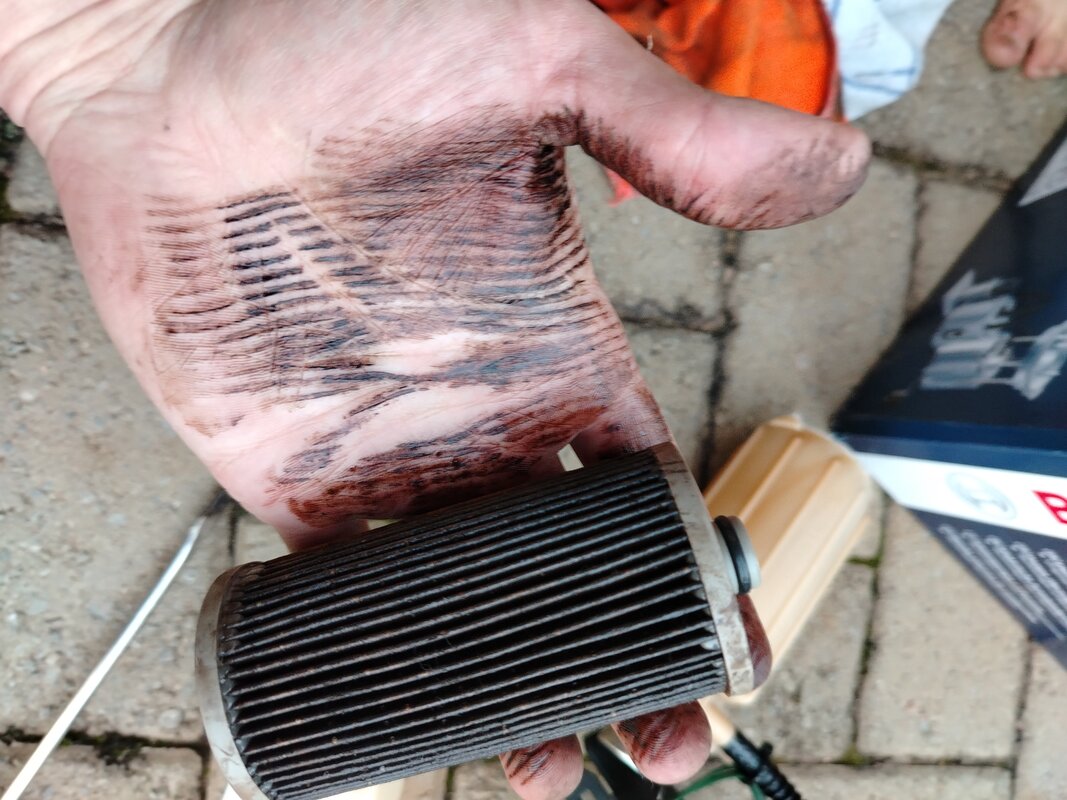

So today was fuel filter day. Decided to do that before injectors so that any possible sediment disturbed whilst changing will not go to the new injectors.
New Bosch filter, was very dusty around the hole so first had a proper clean.
I managed to get the seal ring loose with my hands and 2x screwdrivers.
For the sake of science I broke open the old filter. Remember only 96000km on it. It was very nasty, would strongly suggest to replace this earlier.

Benji
Good work, good to see these cars being looked after properly.
That fuel filter is nasty! Z4 has something similar, but one needs to drop the tank to access it...mine is sitting on 170,000km...wonder what it looks like :rolleyes:

Katanator
That filter I removed must definitely have restricted flow as there is a brown flaky layer that covered all the surface area on it.

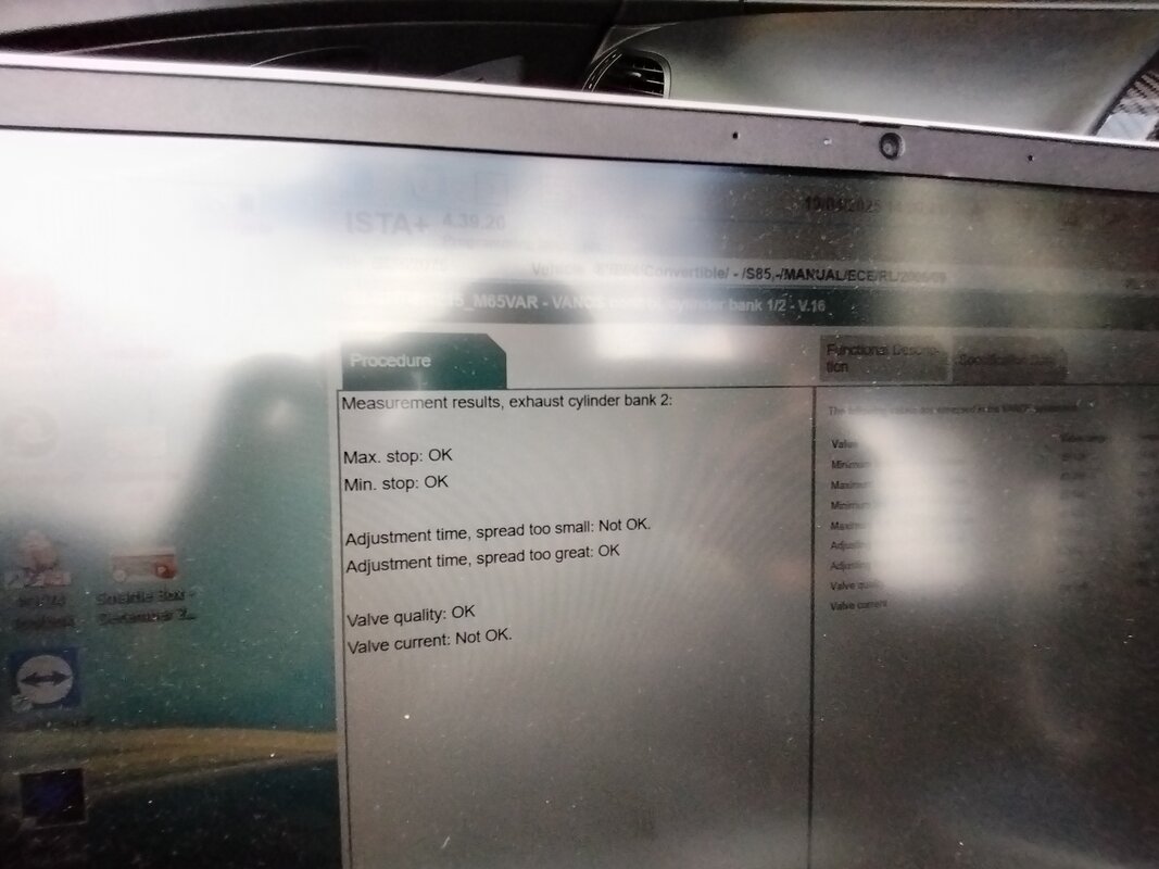

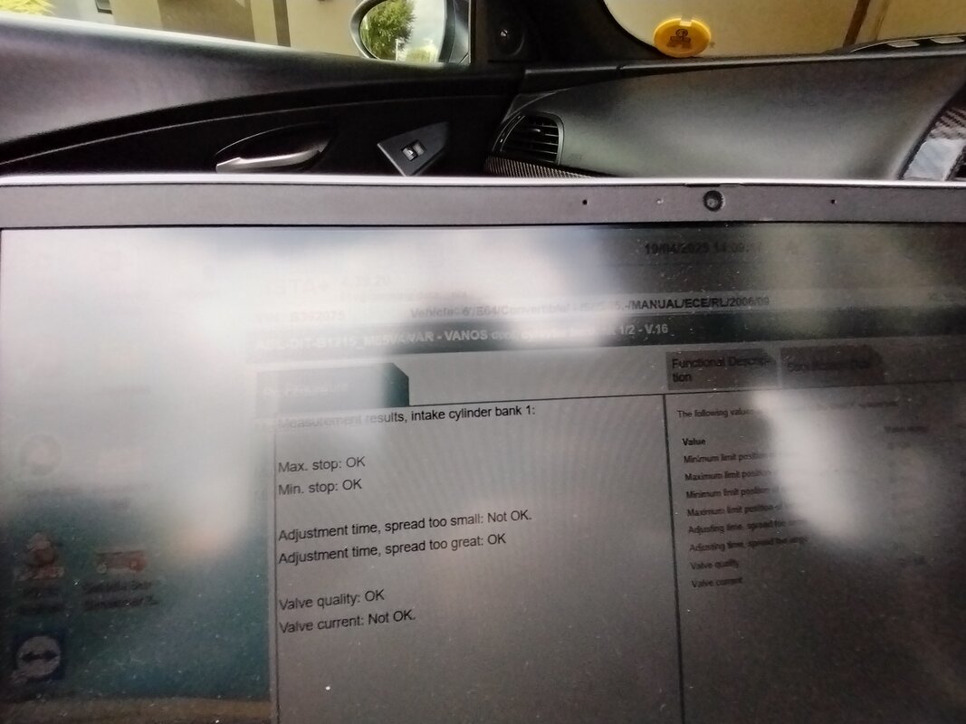

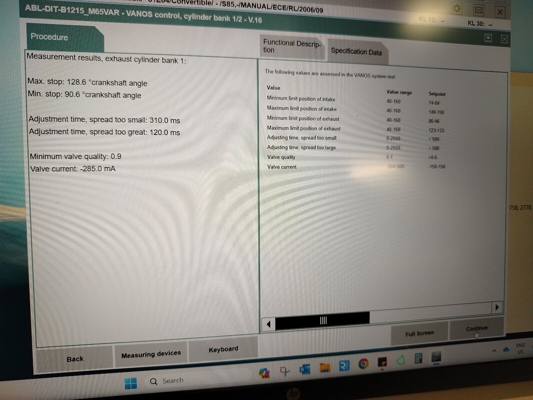

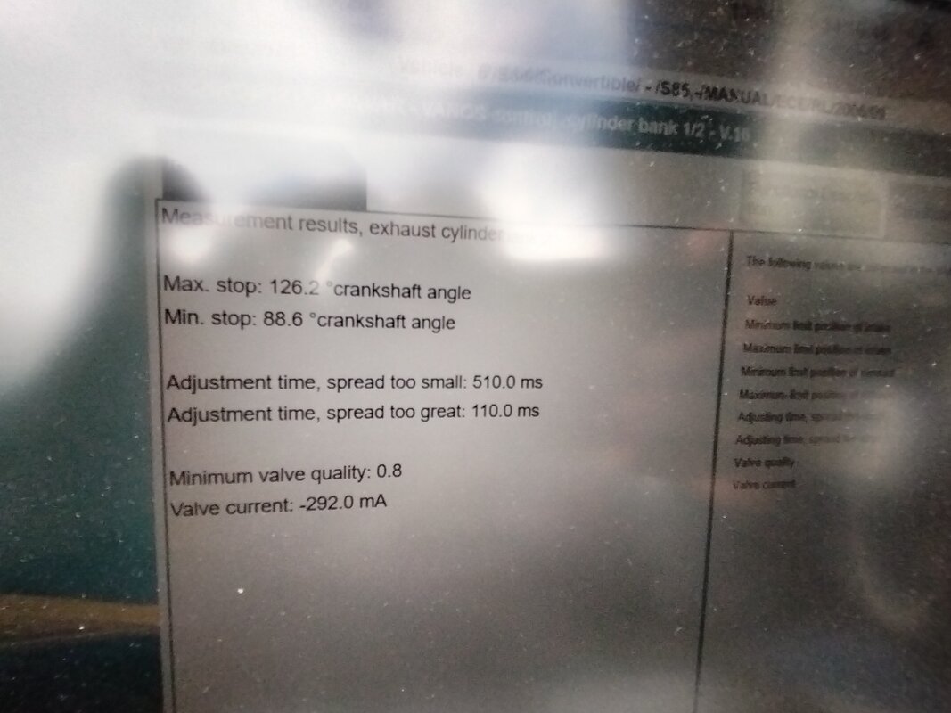

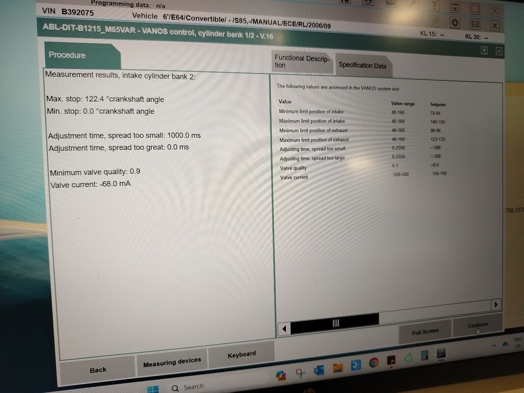

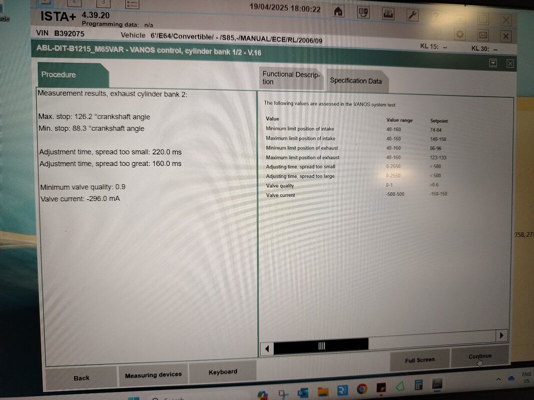

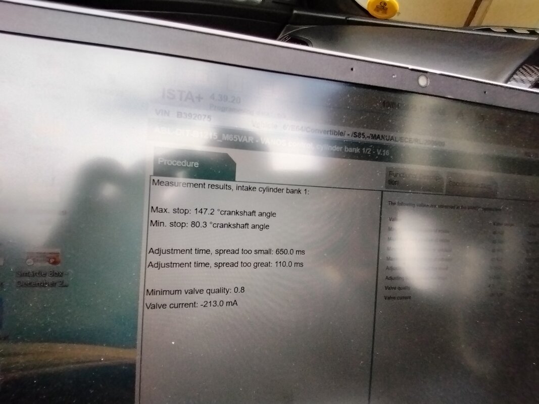

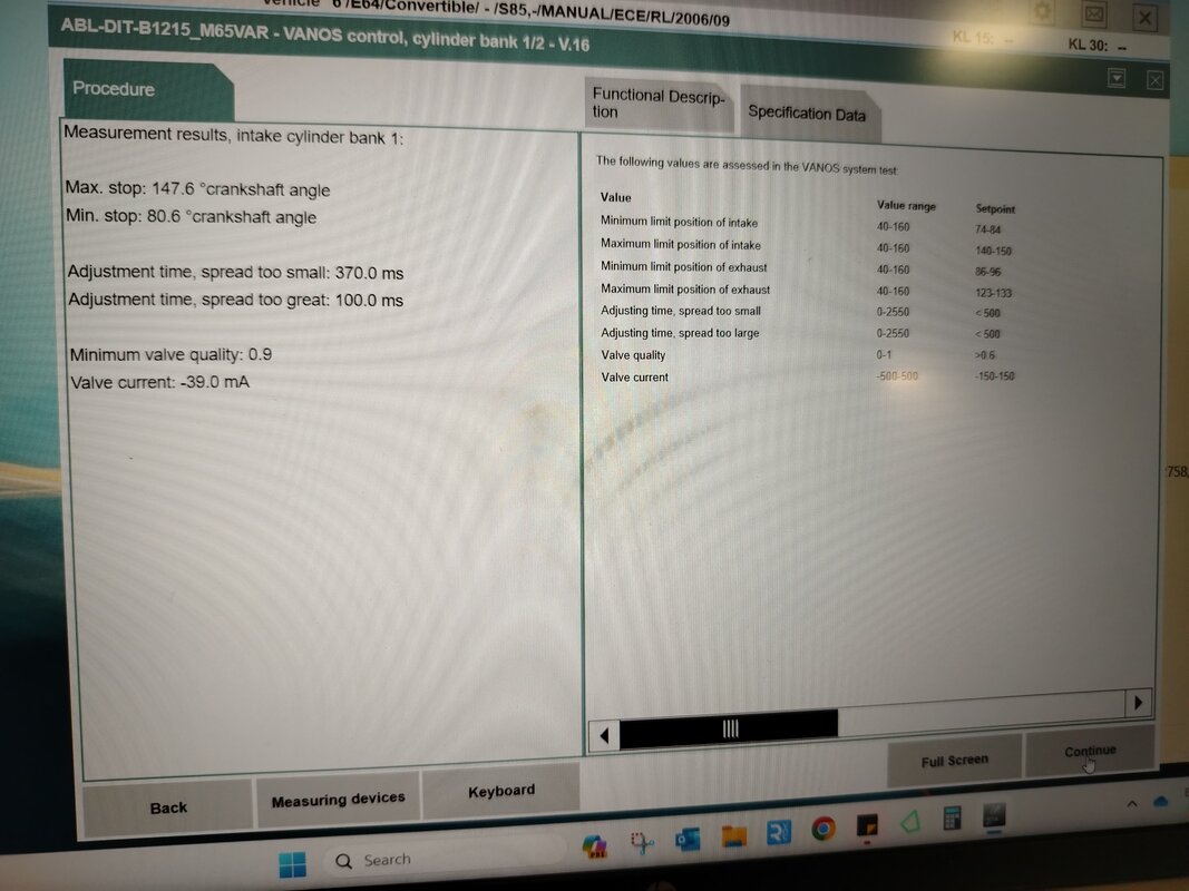

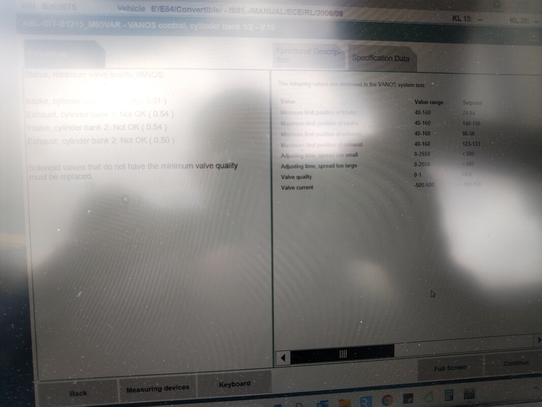

Some new items needing attention showed up. Then vanos solenoids read between 0.5 an 0.54 on ISTA and rates not okay. Here I need some advice, do I clean then and replace seals or replace them as a whole $$$?
See ratings below. Issue is with intake 1 and exhaust 2 on the spread too small. IMG_20250419_141047.jpgIMG_20250419_141009.jpgIMG_20250419_140942.jpgIMG_20250419_140919.jpgIMG_20250419_140903.jpg

Measured my vanos pressure as well. Sits nicely at 70 bar and goes up to 80 bar at 5000 rpm so at least that seems perfect.
Peter@AEW
If you can afford it change solenoids (no insult implied or intended)
Make sure you are sitting down when you order them.
Katanator
Thanks @Peter@AEW.
I think that might be the end destination. If im going to do the effort I might replace the o rings and swap bank 1 and bank 2 and see if error goes with them.
I did the 3x bleed procedure and the results seem to differ now. Issues are both on bank 2 intake and exhaust now.

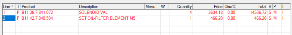

Us prices actually seem half decent. About 275 usd each, add some shipping and import tax.
Dont know if local dealers will be cheaper. Might just replace the two faulty ones and monitor from there.
Katanator
Well this seems to show how finicky the solenoids are. Over the course of the weekend I bled them about 3x times with ISTA. This morning changed oil for good measure and to visually inspect. Went for Castrol Edge 10W60.
After oil change bled the solenoids once more, reset adapations and ran test. Now al 4 are reading above 0.8 and withing spec. So seems I can postpone the cleaning for now.

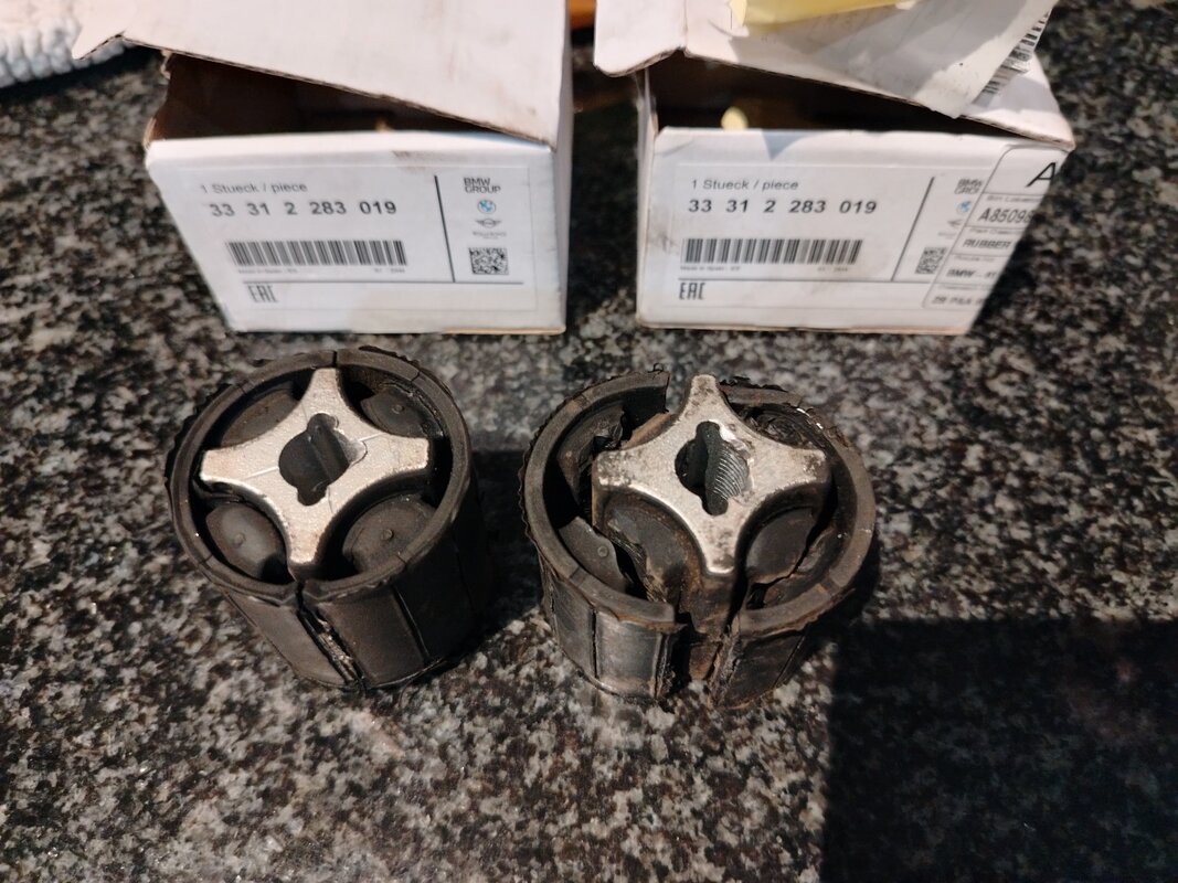

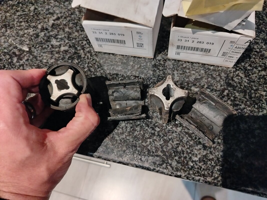

Rear diff mounting bushes after 96000km 😂.
Replaced with OEM
